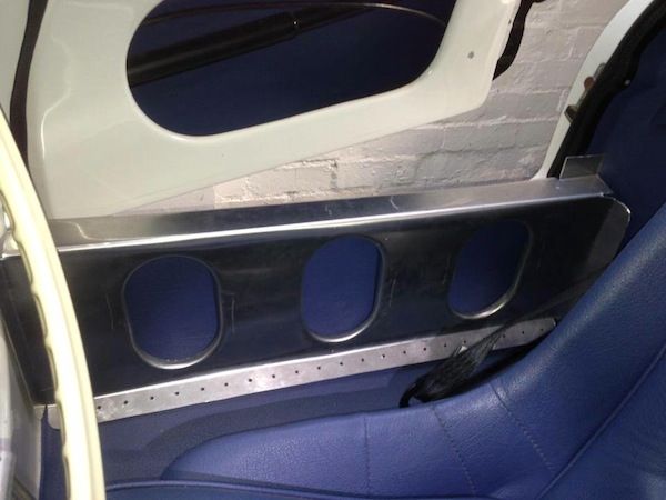

I had some time over the weekend to try and make a panel for my spyder. Unfortunately I only have hand tools (besides a drill and a jigsaw) so everything is shaped and bent by hand. I am happy with the finished result, but it would be nice to get crisp right angles on the folds. I just need to tweek it to fit properly to the car and then move onto the other side...
http://i227.photobucket.com/albums/d...psd649fa69.jpg
http://i227.photobucket.com/albums/d...ps0144c732.jpg
http://i227.photobucket.com/albums/d...psb37bced3.jpg

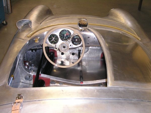

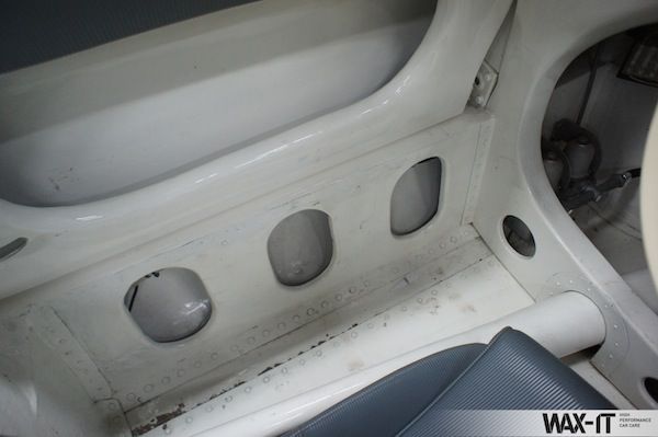

At the end of the day, when it is painted, I want it to look like this original one...
http://i227.photobucket.com/albums/d...ps8d03fbb7.jpg
Doug M 09-02-2013 02:59 AM
Andrew,
I'd say you came really close.
with hand tools you can tighten the crease with a wood "V" and a made of wood chisel work from the inside of the fold, OR clamping the panel between 2 stiff boards or angle iron pieces and tap on another board along the fold from the outside.
I don't see a need but you're there and know more what you want.
type550 09-02-2013 03:03 AM
Thanks for the tip Doug. I sandwiched the sheet between two pieces of timber and viced it then slowly bent it by hand. I didn't want to hammer it as I didn't want the dents to clean up after - another board is a great idea!

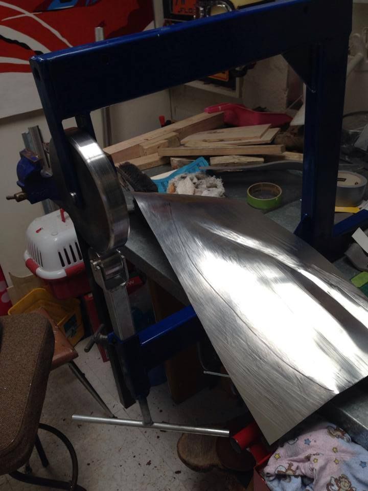

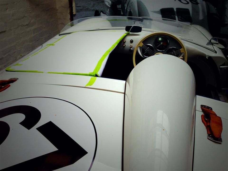

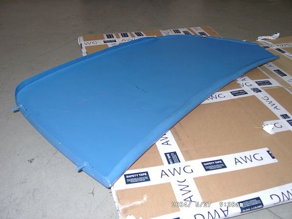

Things are slowly progressing with my spyder panel fabrication. I have formed my sill panels and also side panels under the cockpit. I am going to line the whole inside of it with aluminium now which shouldn't be too difficult except climbing in under to make the panel templates.
I have got myself a simple english wheel which the previous owner has kindly modified to make it work better. I have been spending some time getting used to it and it will do the job for the purpose I need.
I have the confidence now to try and make a tonneau for the cockpit. I have measured it up and made a pattern for it. I will use the wheel to get the slight convex shape, and I have ordered a stretcher/shrinker to help with the curved edges.
My challenge is creating the rounded curved edge closest to the driver. As it also tapers off, i would like to know the best way of going about it to create it. Please remember, I am very much a novice, but will give anything a go and hopefully to perfection!
