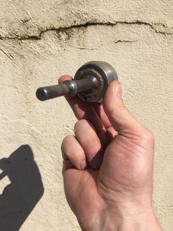

Ed... out of the four attempts at making a welded shank, this is my most successful to date as it hasn't broken at the weld yet. And it's had some abuse! It's a cheap hammer headed air chisel shank, to which i welded a homemade machined insert holder. The hammer was a light press-fit into the machined holder prior to welding.
Matt
Matt Keene
www.air-Kraft.com
