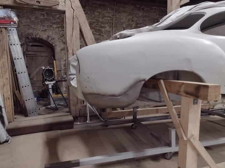

Thanks a lot guys!!

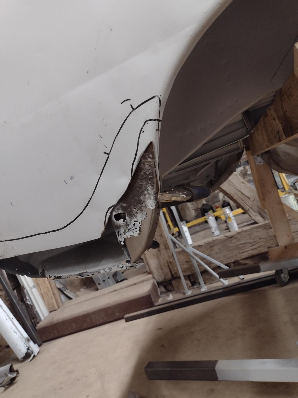

Sorry, I did work on the ghia but did not took the time to update since then..so let's do it !

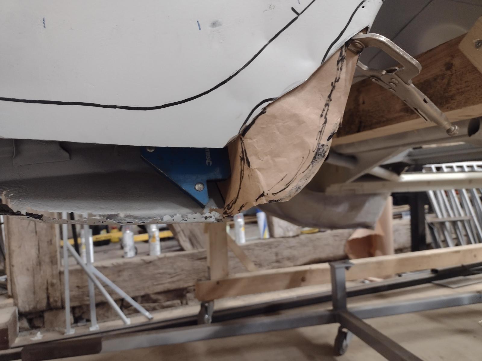

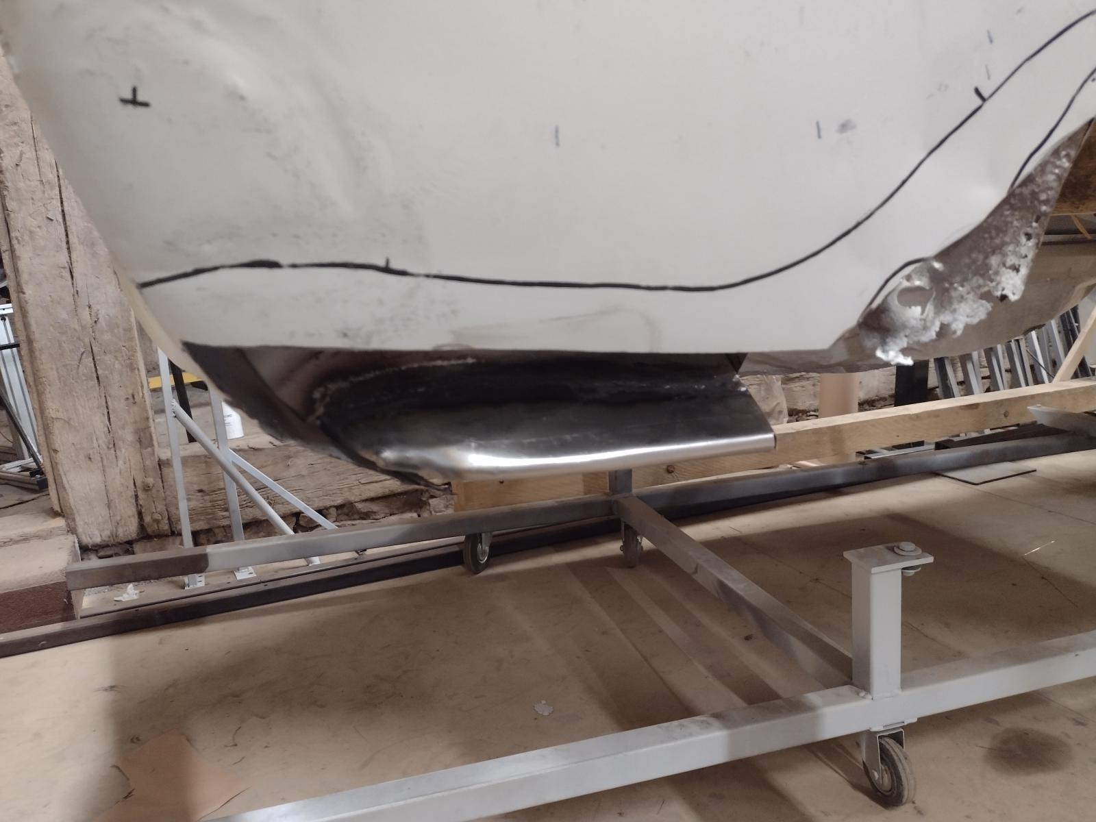

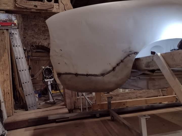

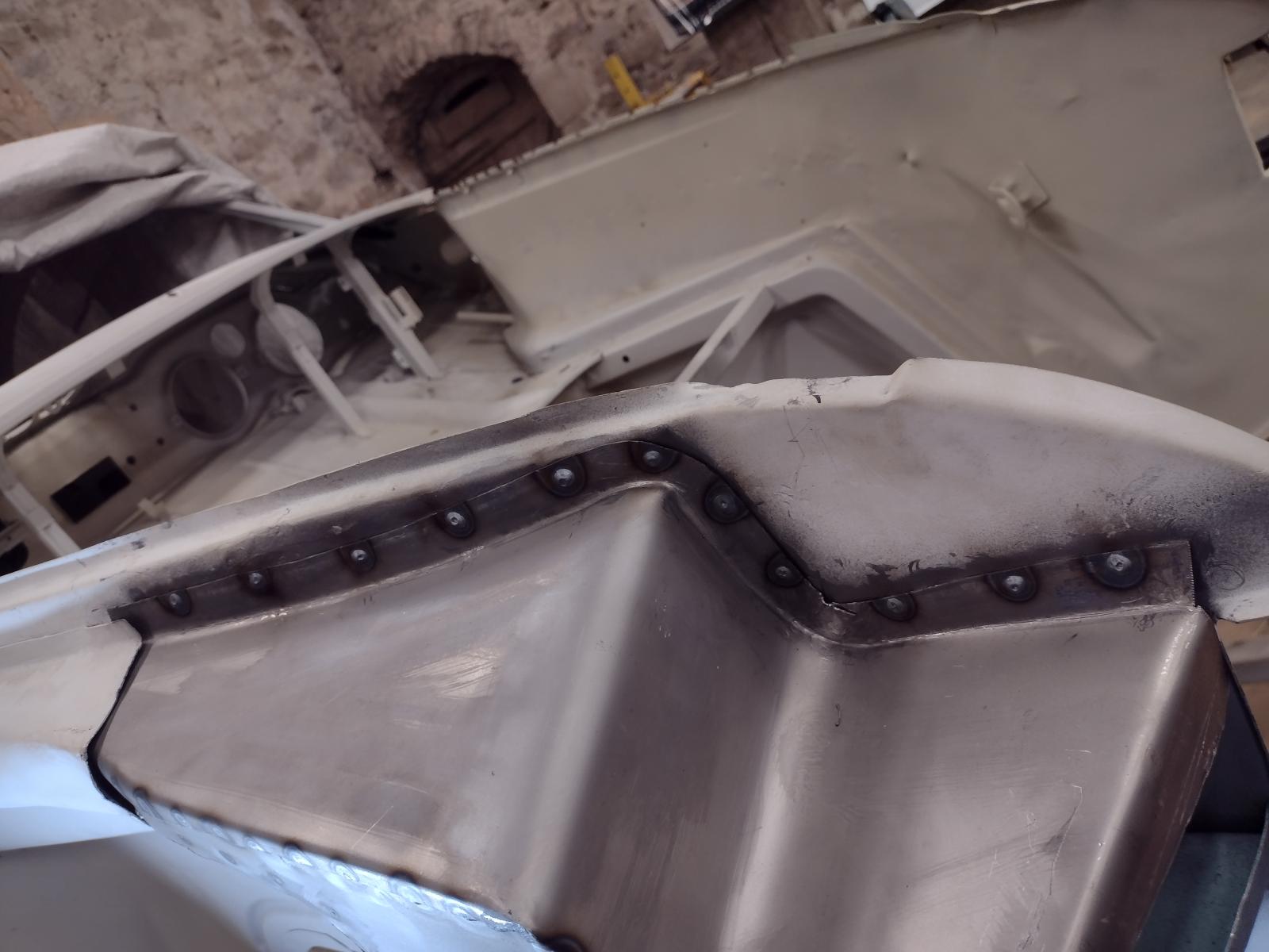

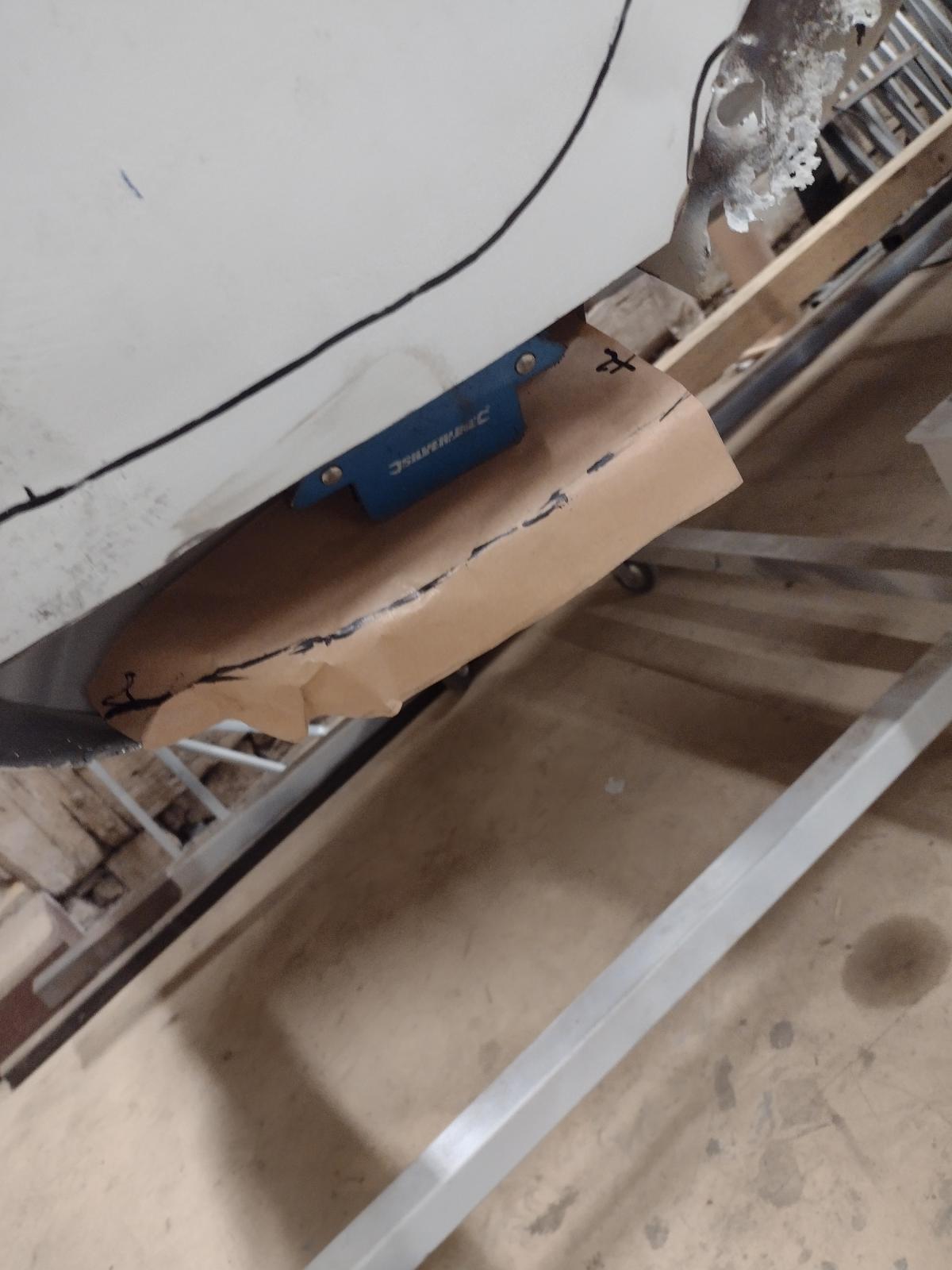

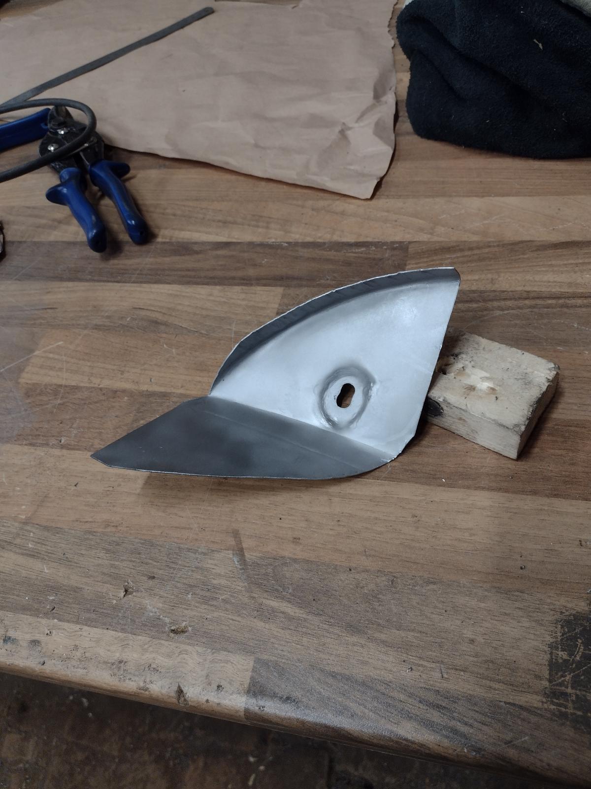

Next patch, here template building :
And putting the metal in form :
Ready to cut:
Cut:
Tack-welding:
Stay tuned, next update comes really soon and not in 2 months, I promise!

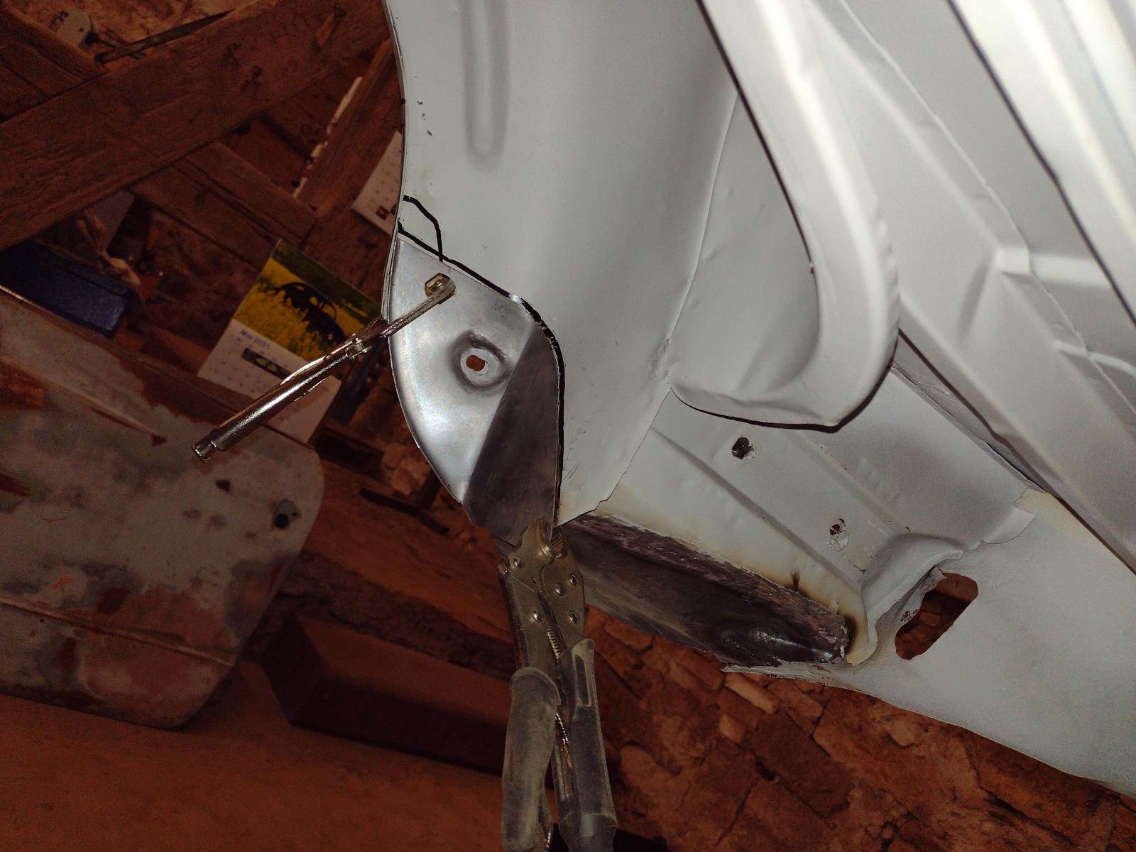

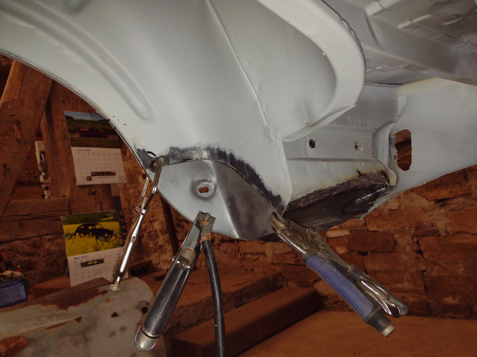

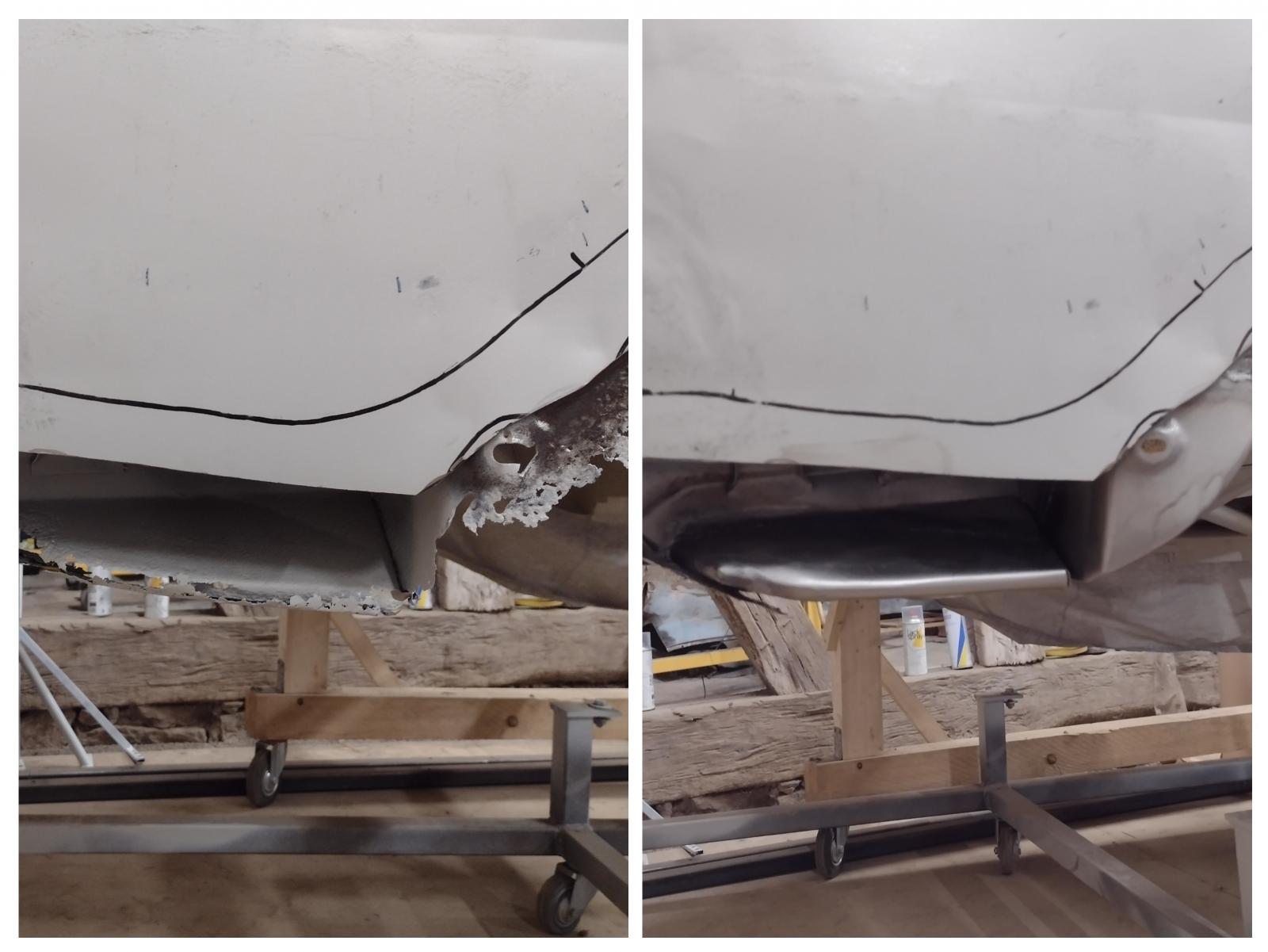

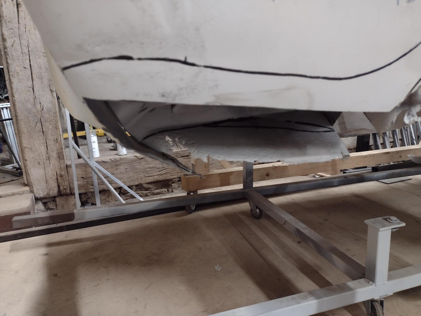

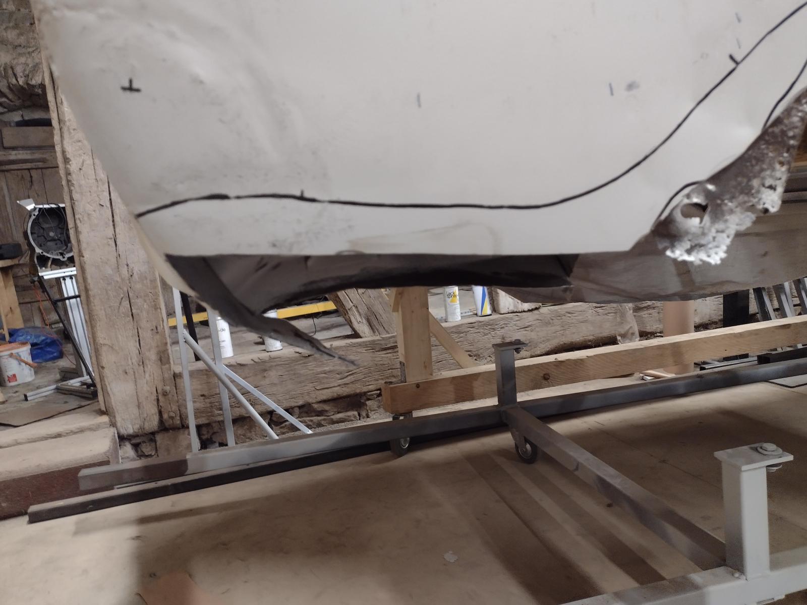

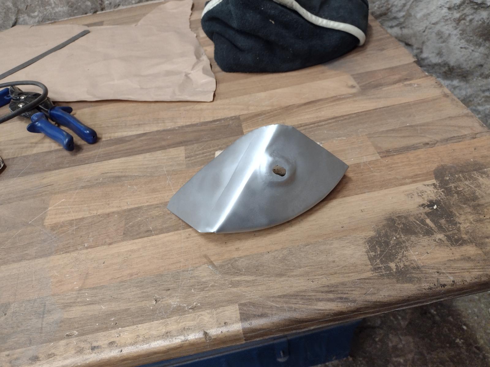

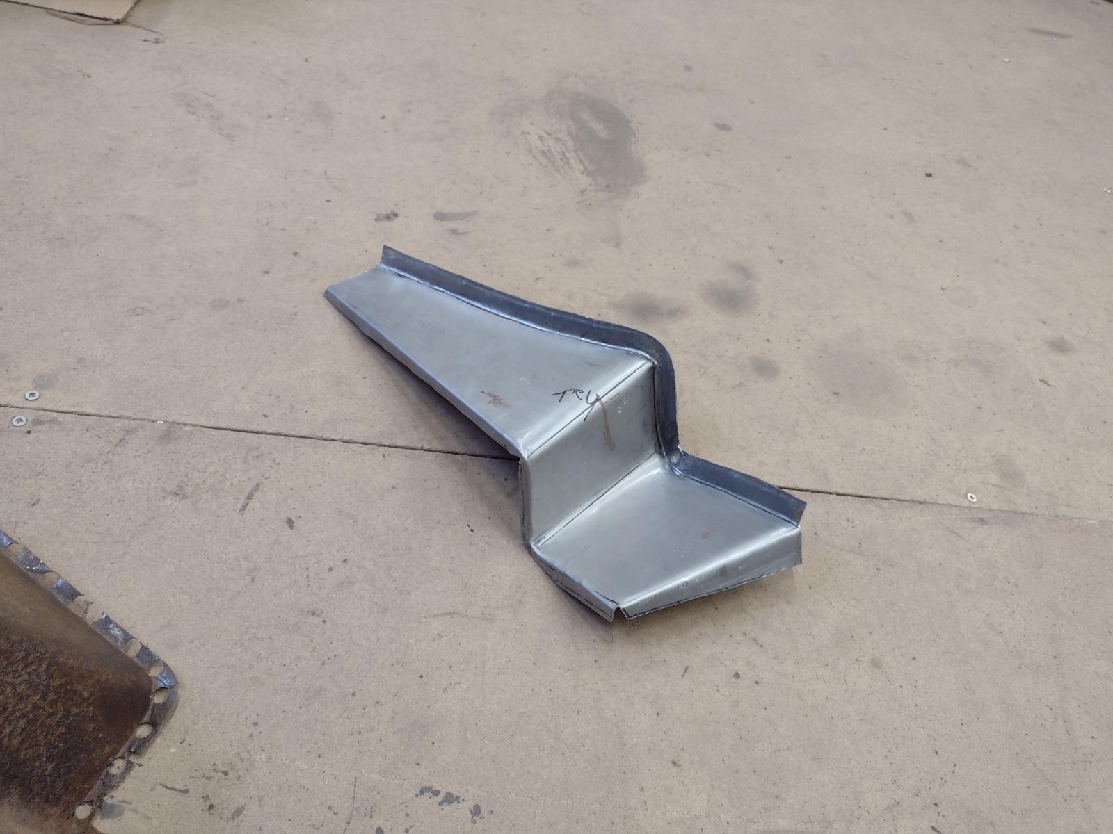

So next step was this closing part, so first the template:
And the part :
Ready for welding:
Welded:
Before/after:
Stay tuned!

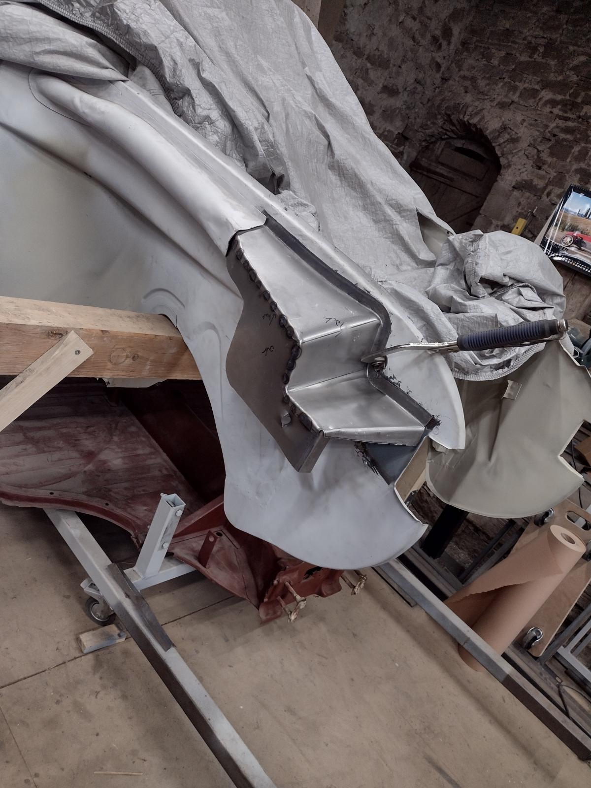

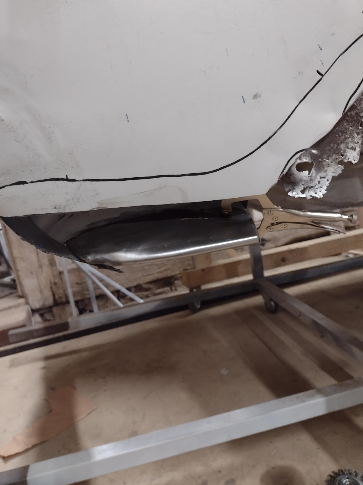

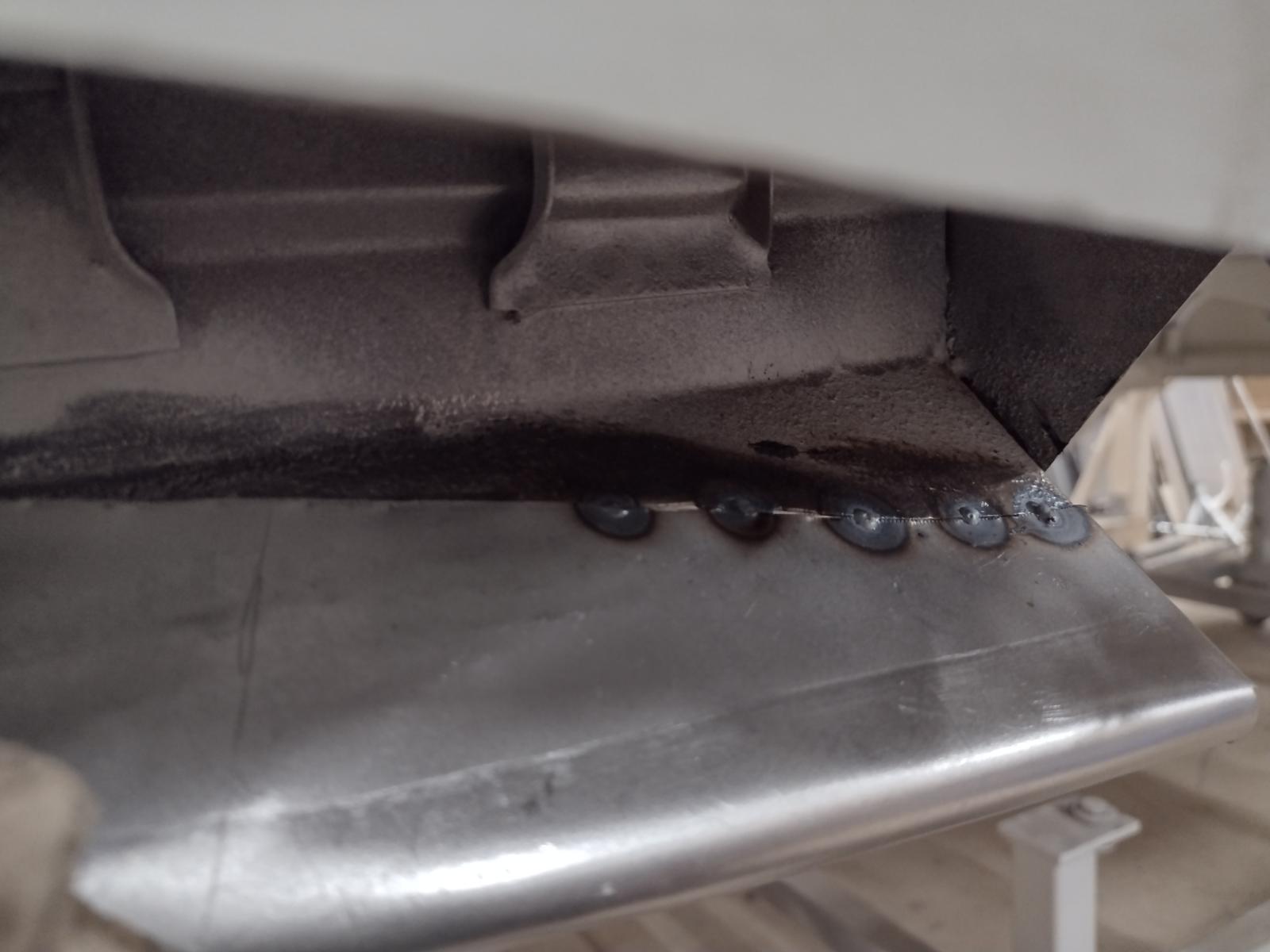

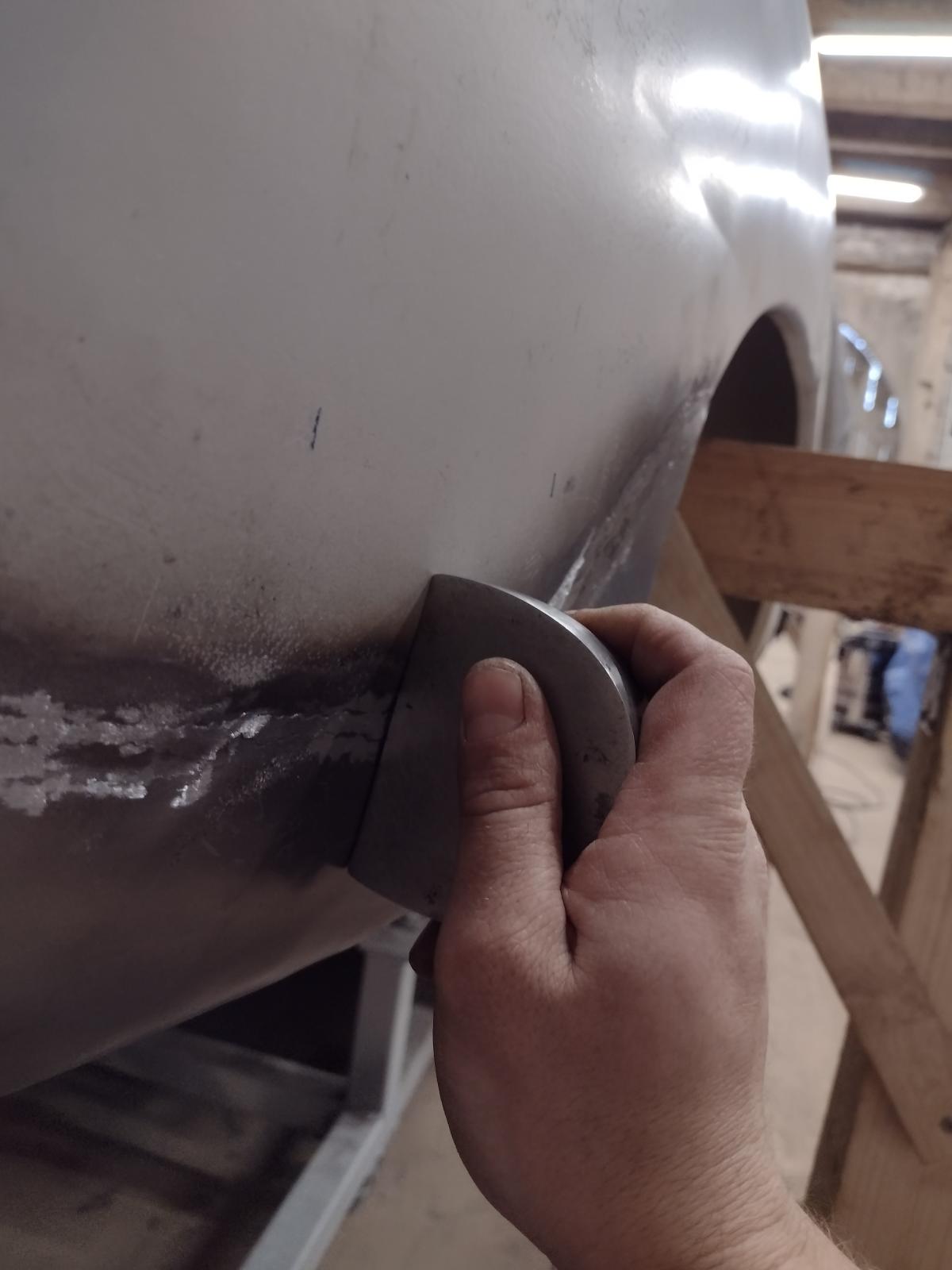

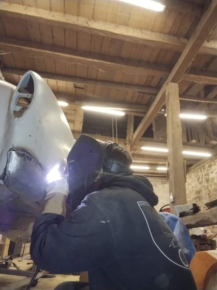

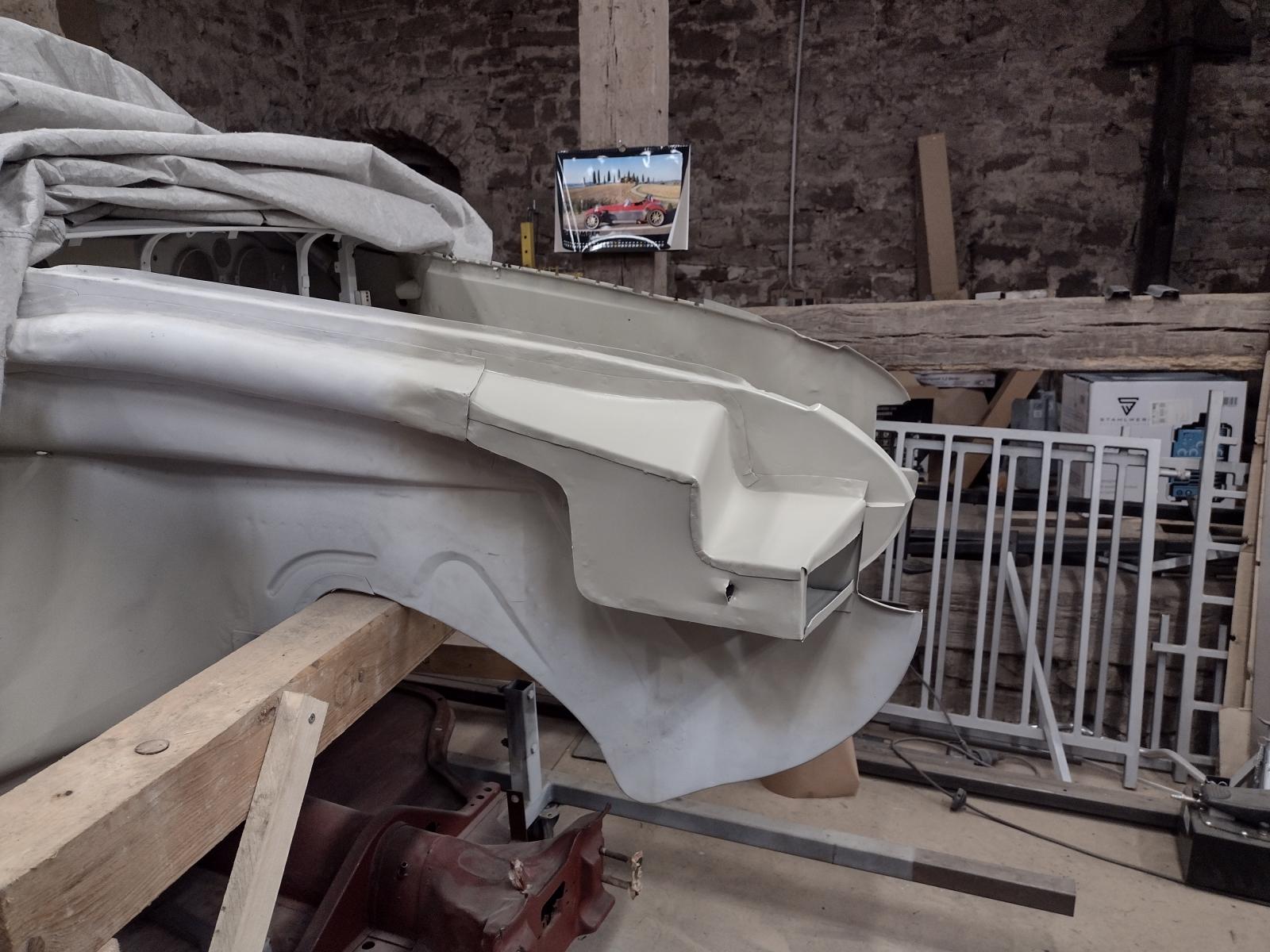

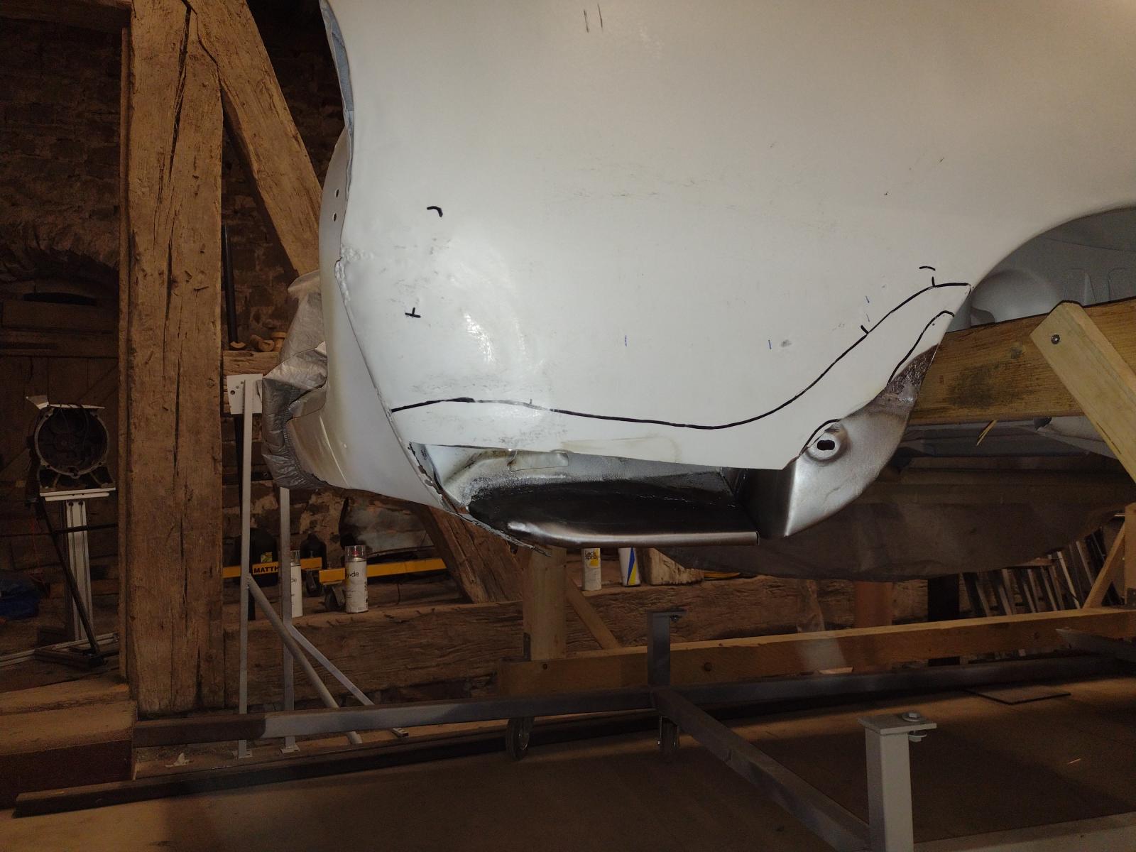

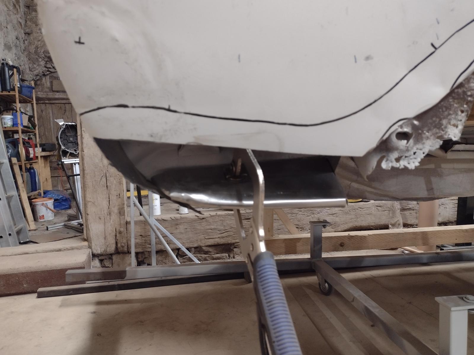

So, the next logical step: closing it..so positionned the part :
First tack:

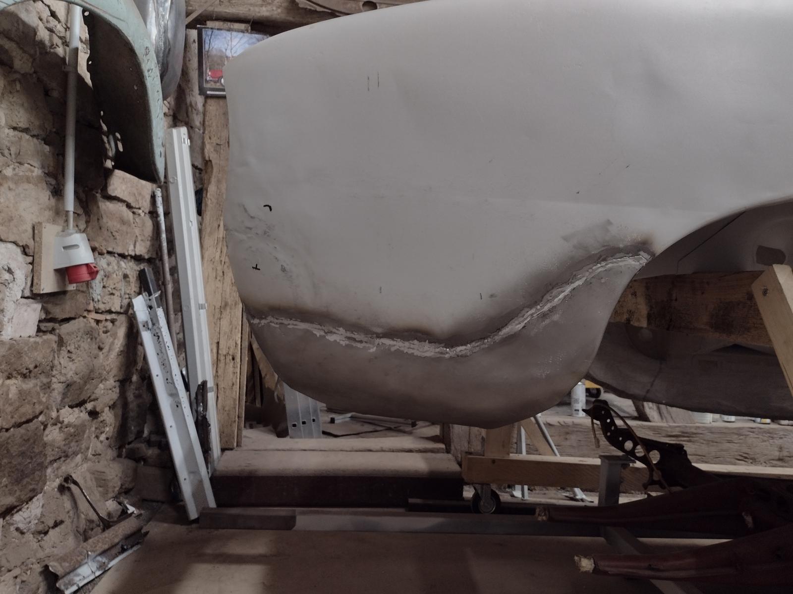

And then welding:
Welded:

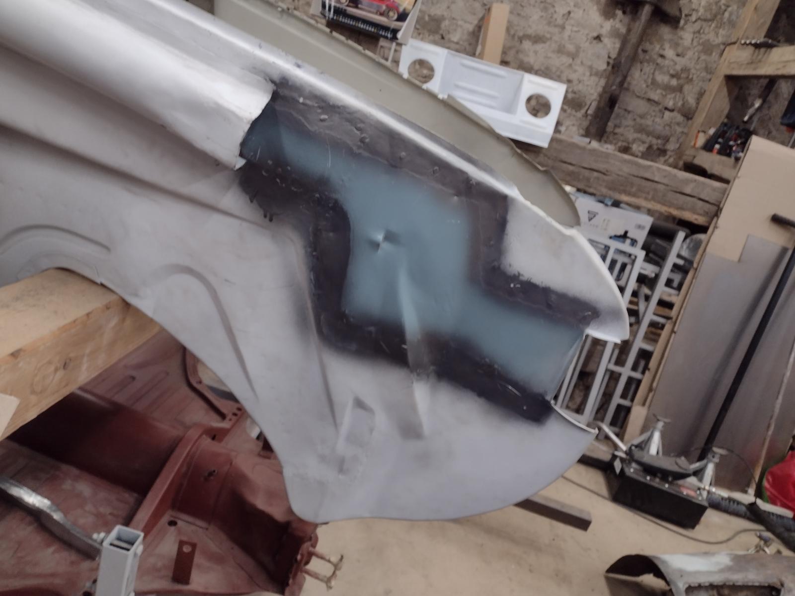

Some planishing left but getting close:

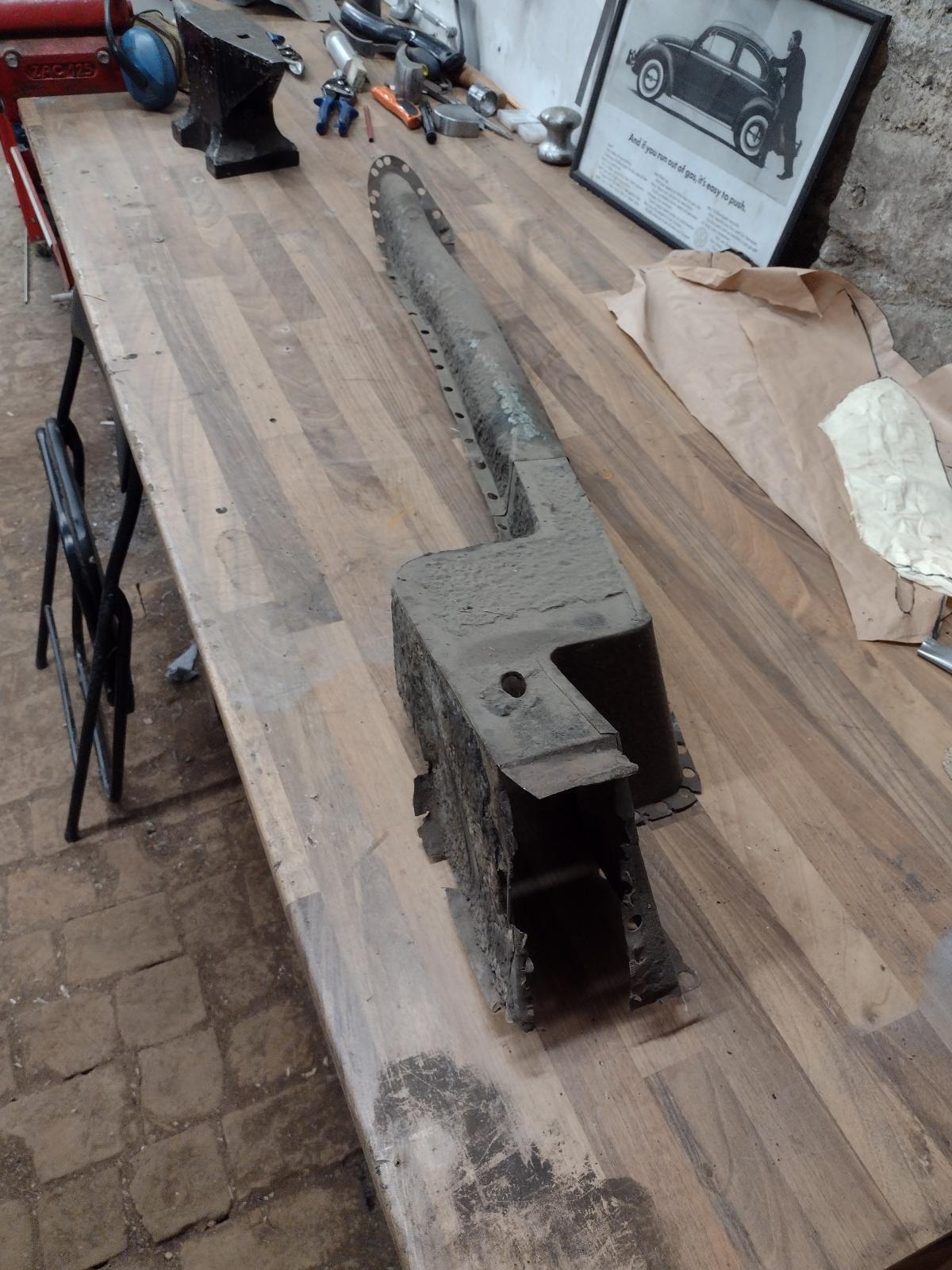

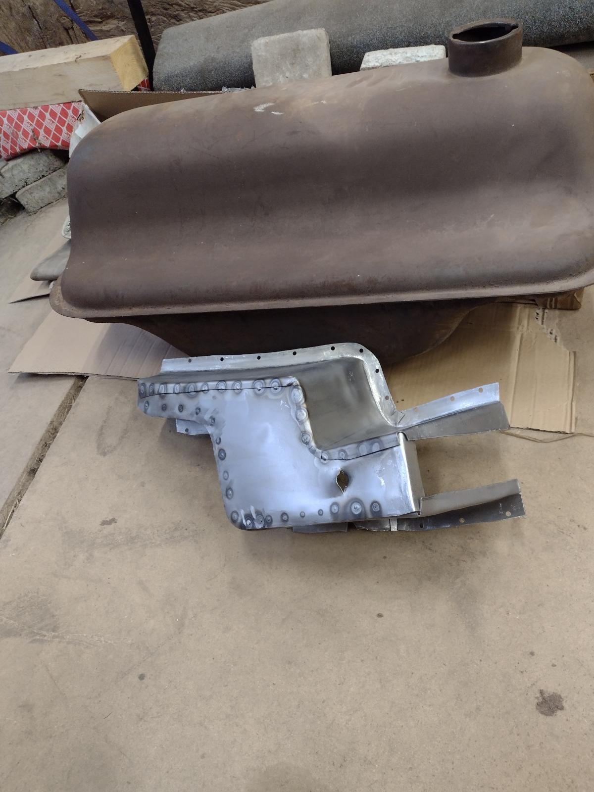

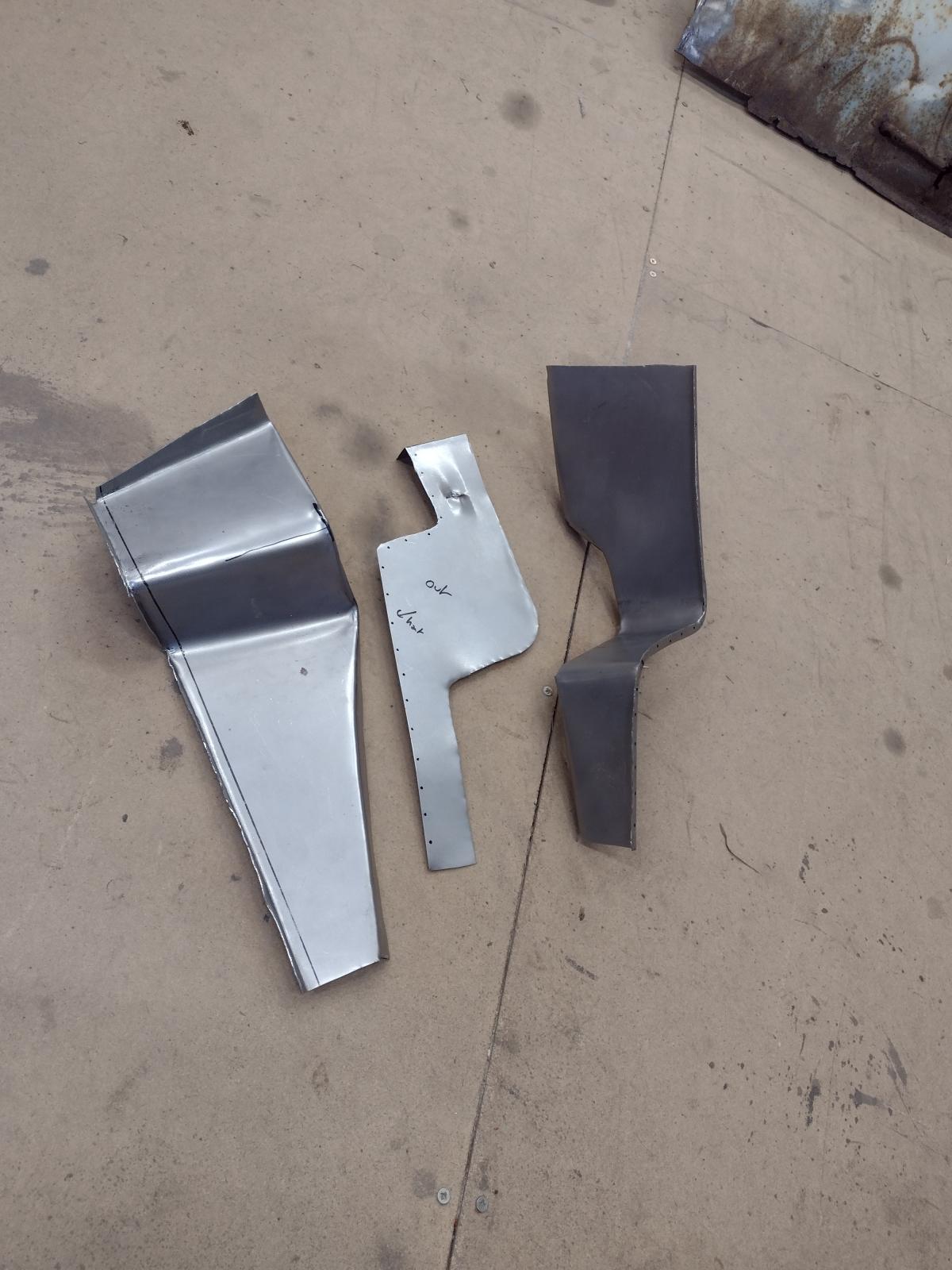

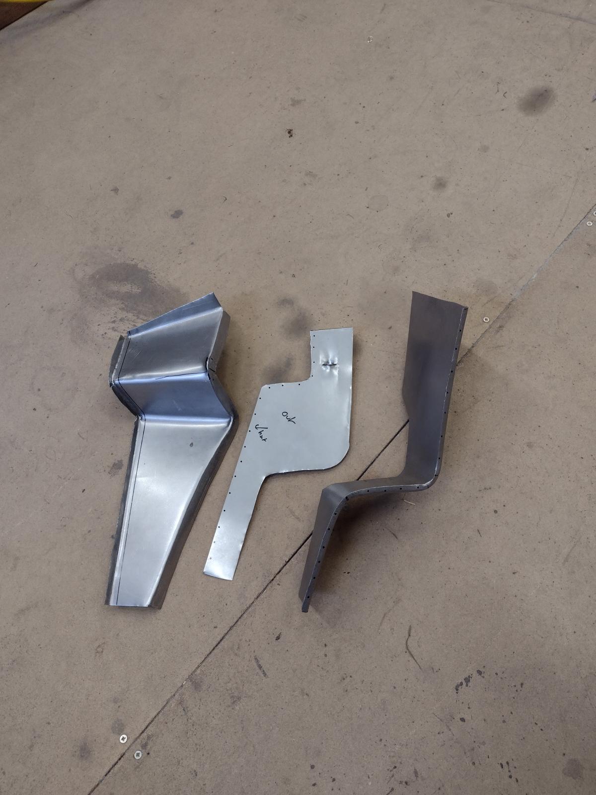

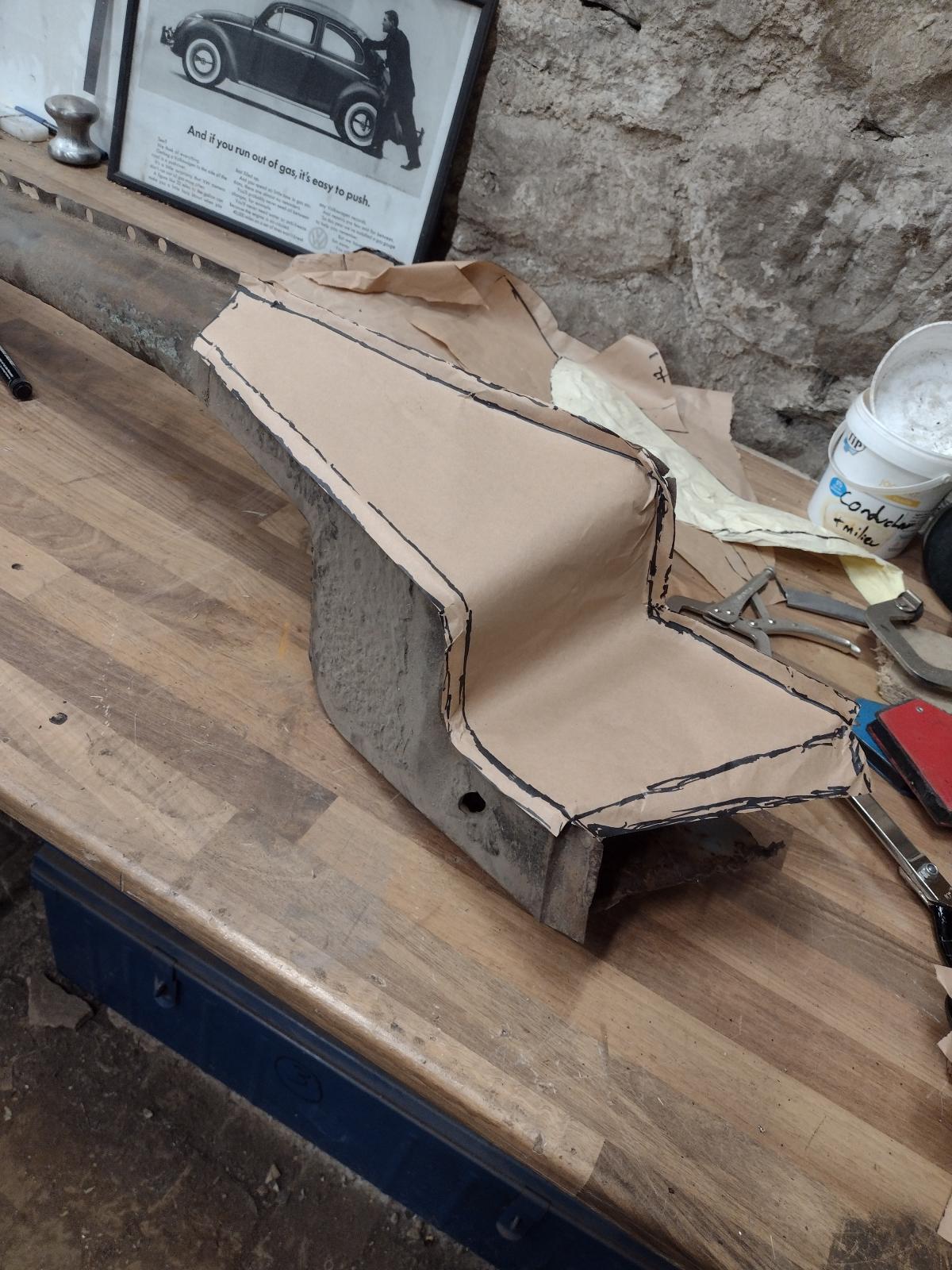

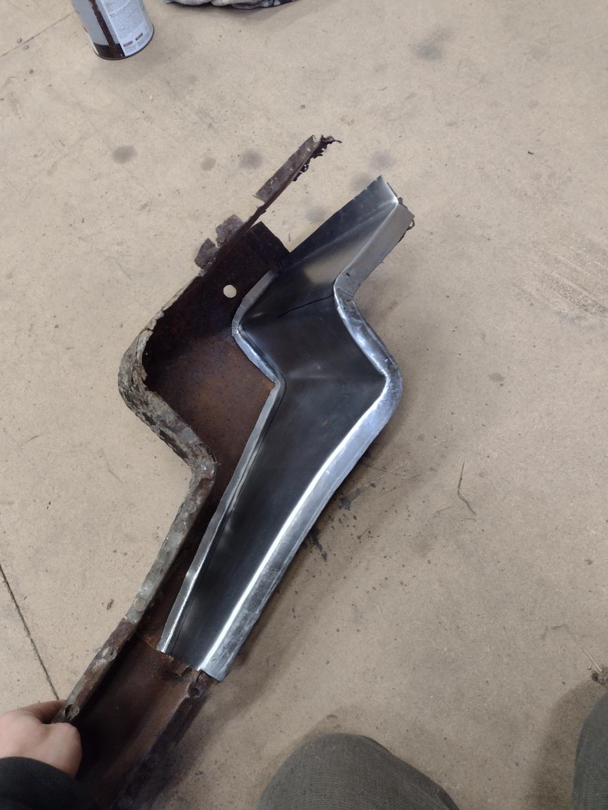

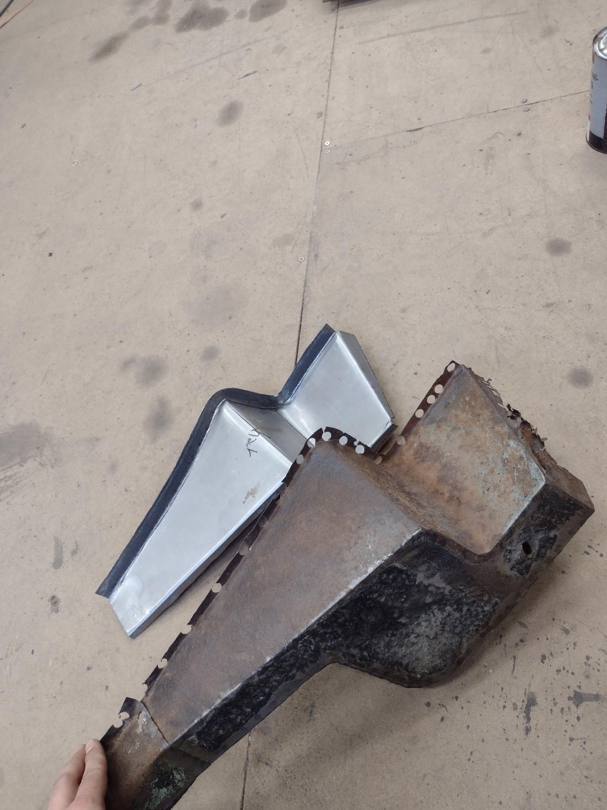

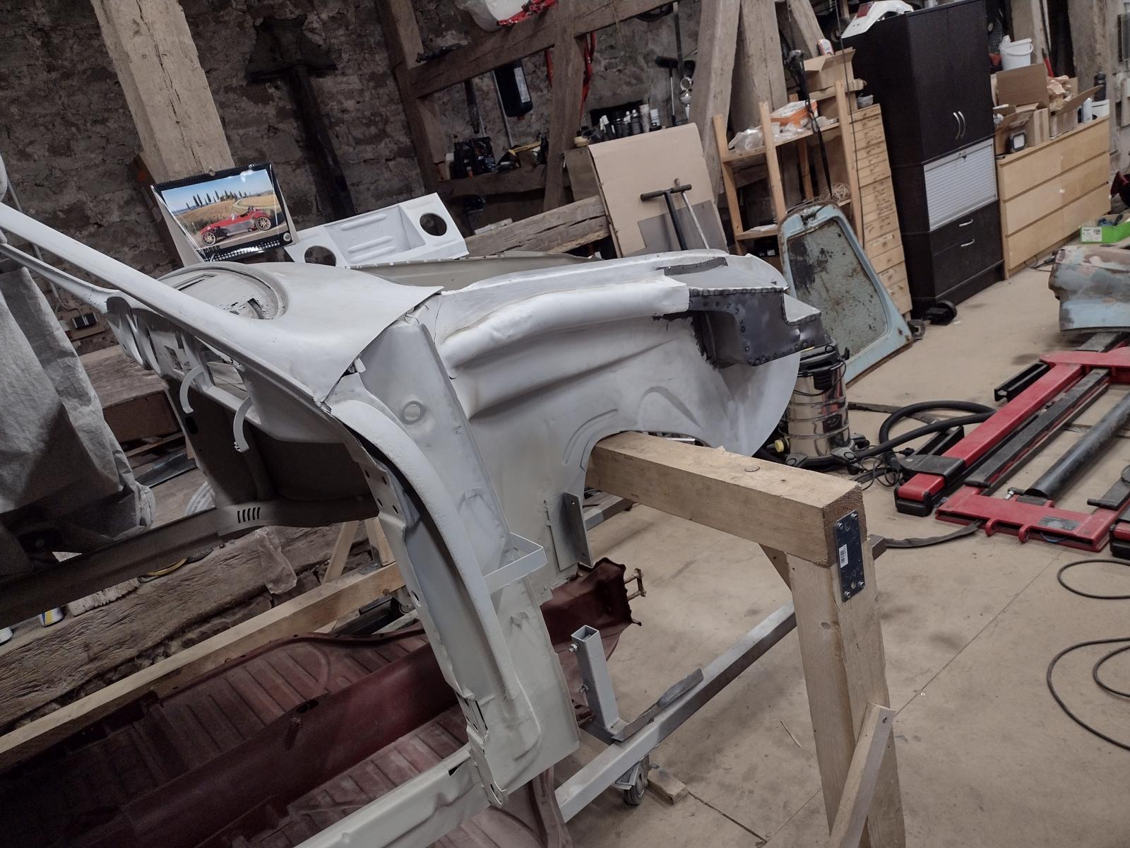

After that, it was time for me to (re-) do the fresh air inlet using the original dimensions. The original one for the template :
Template:

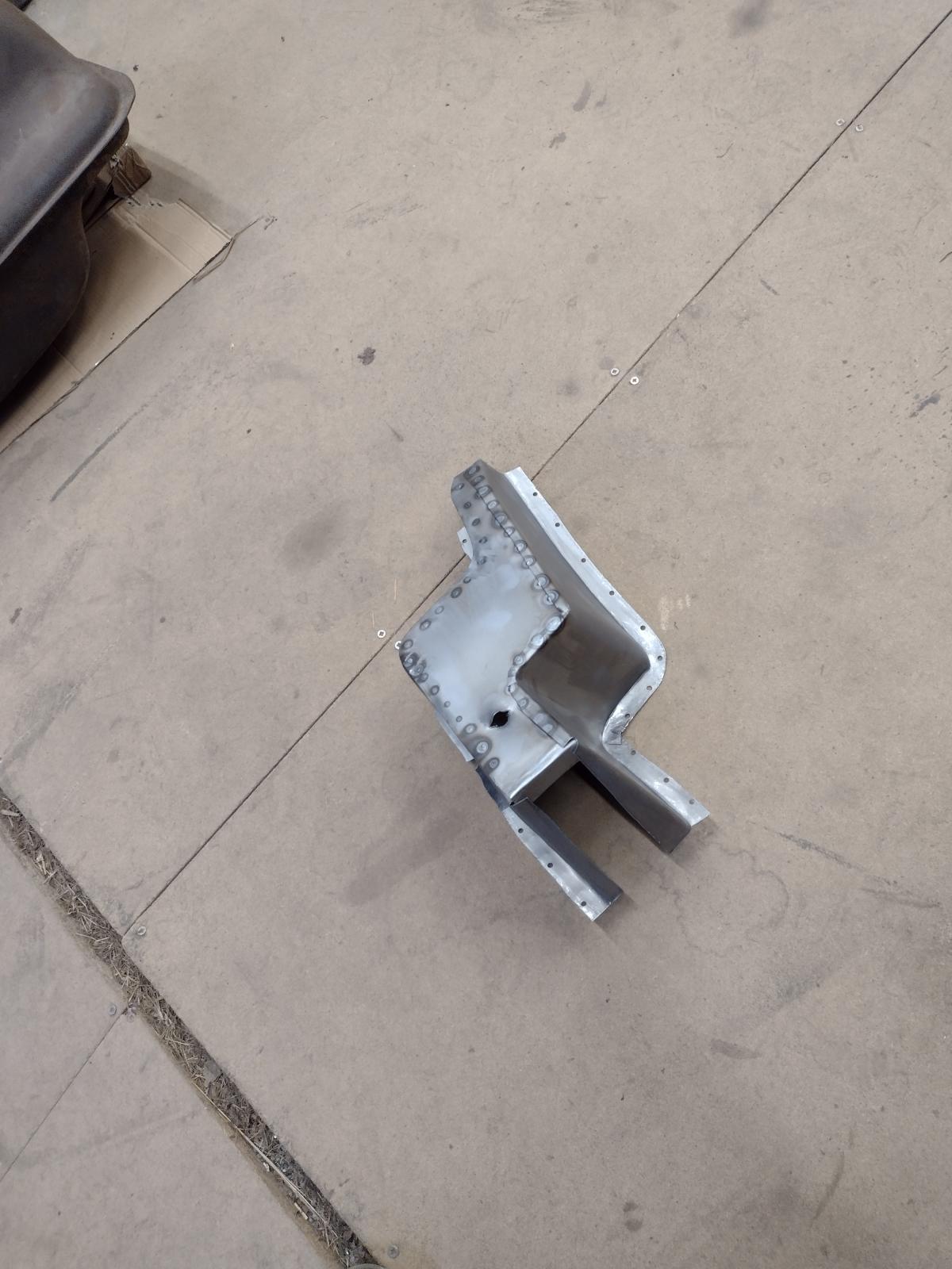

And building the parts one by one:
Ready:
Stay tuned!
  #218
Old 05-31-2023, 02:18 PM
Posts: 257

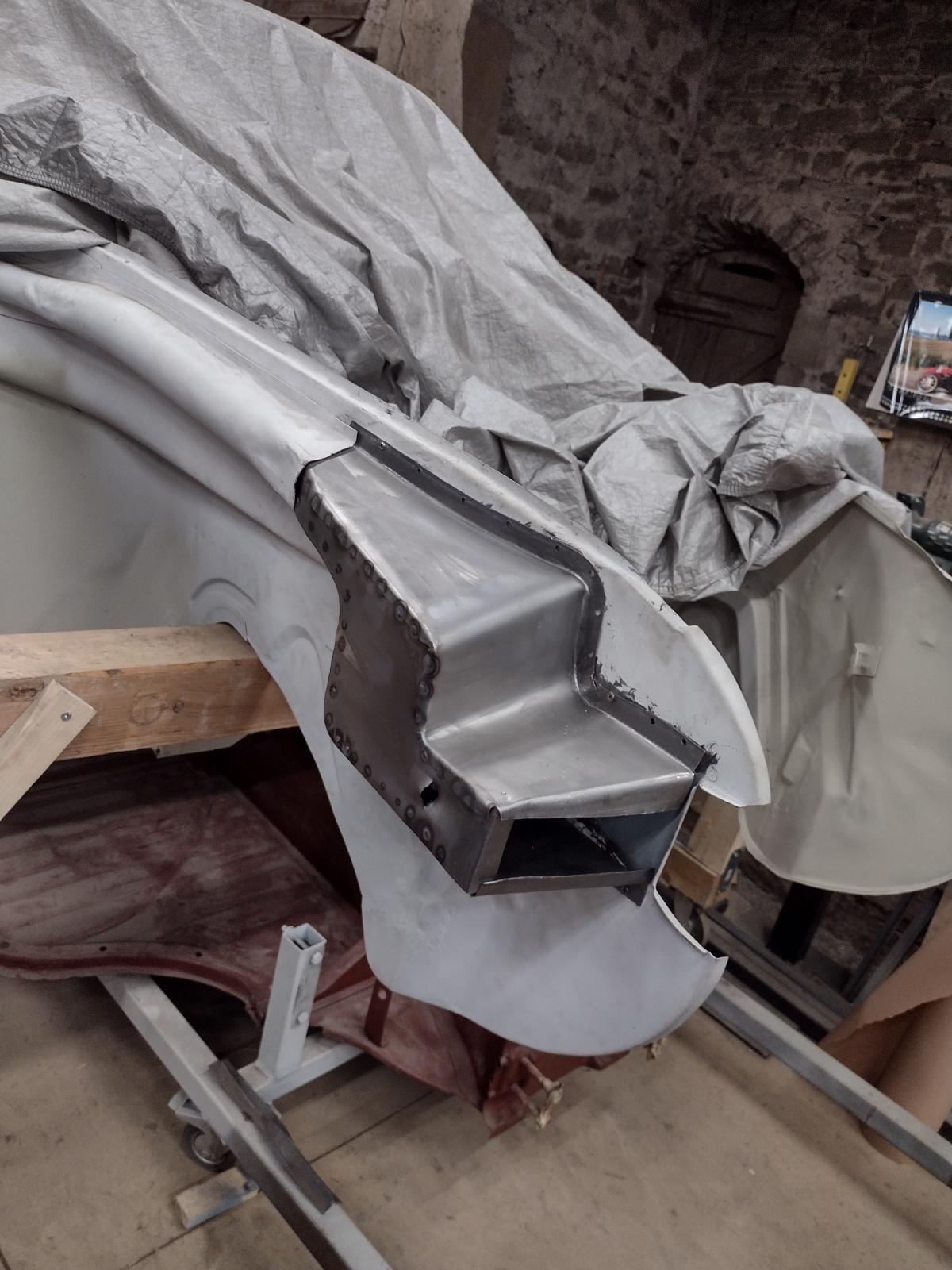

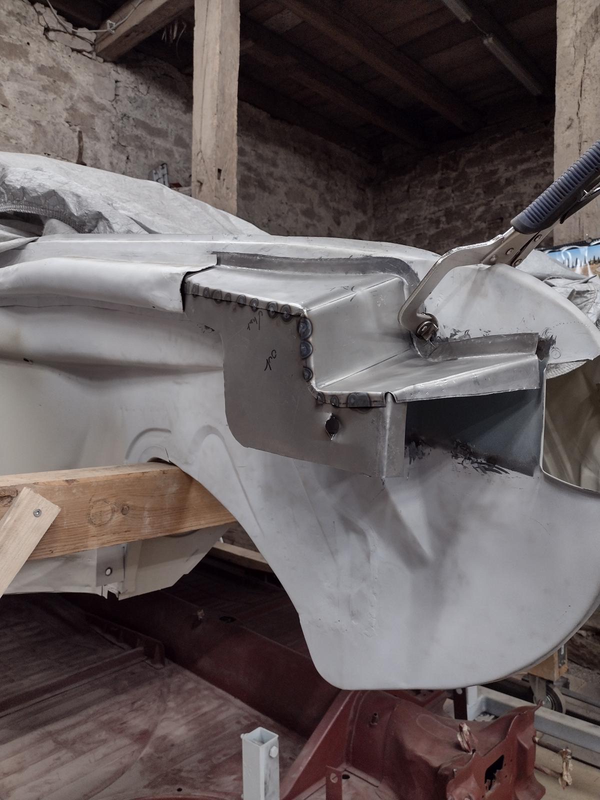

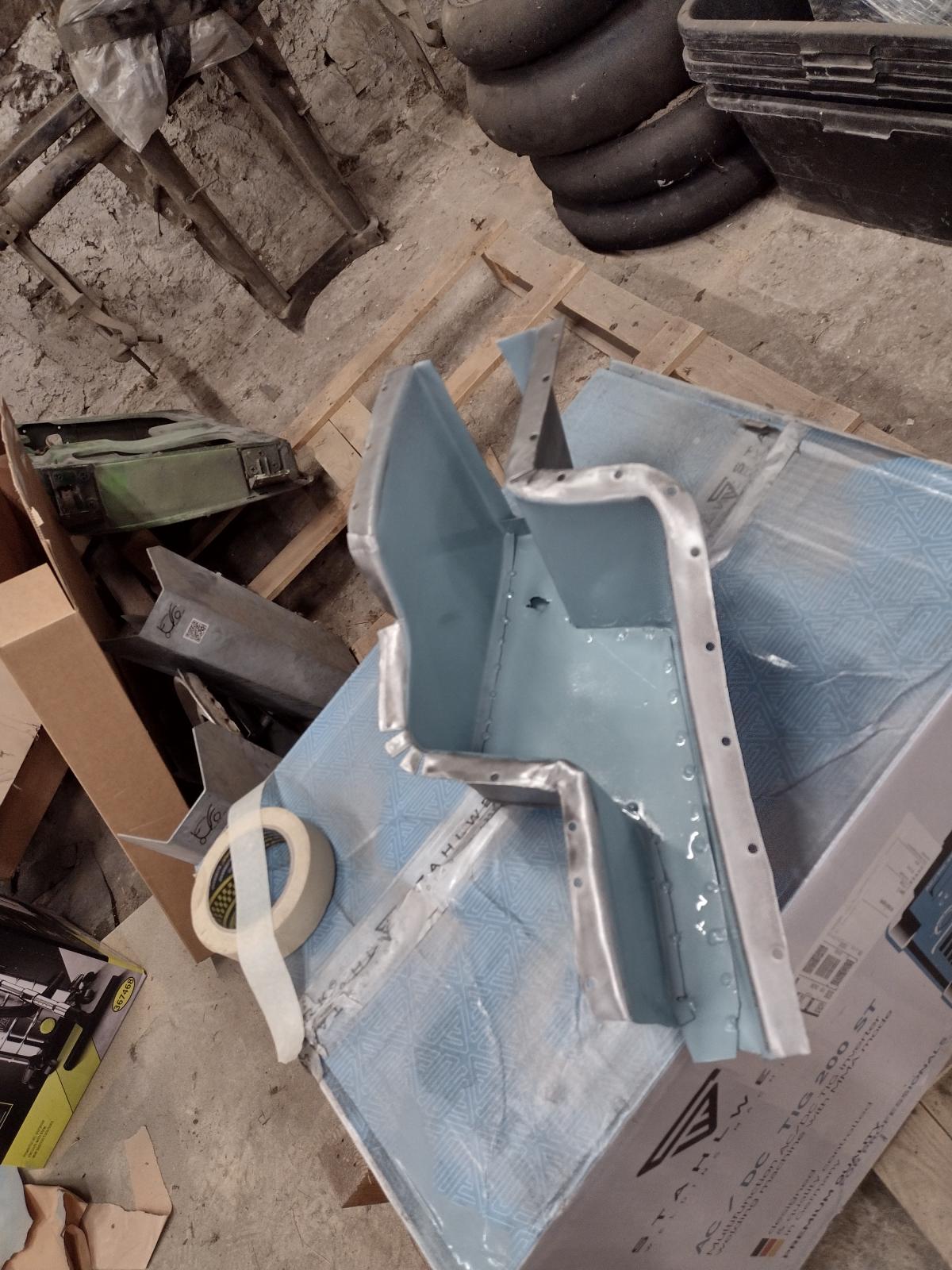

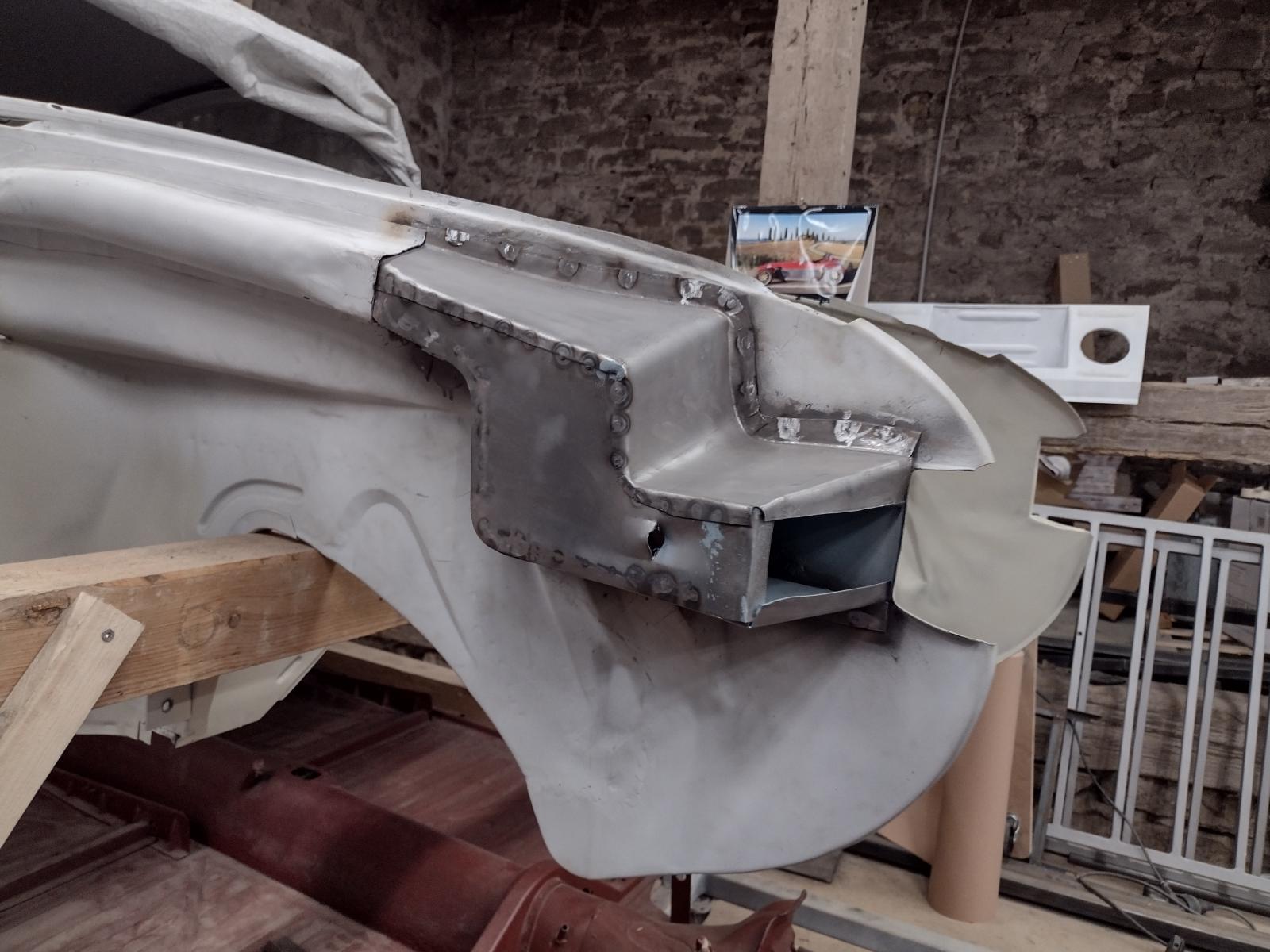

And adjusting them on the car and welding the parts together :
One new fresh air box!:
Ready to weld:
Parts painted/welding primer where it will be welded:
And here we go :
And in primer:
  #219
