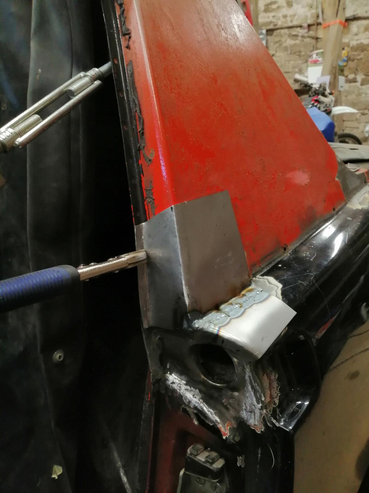

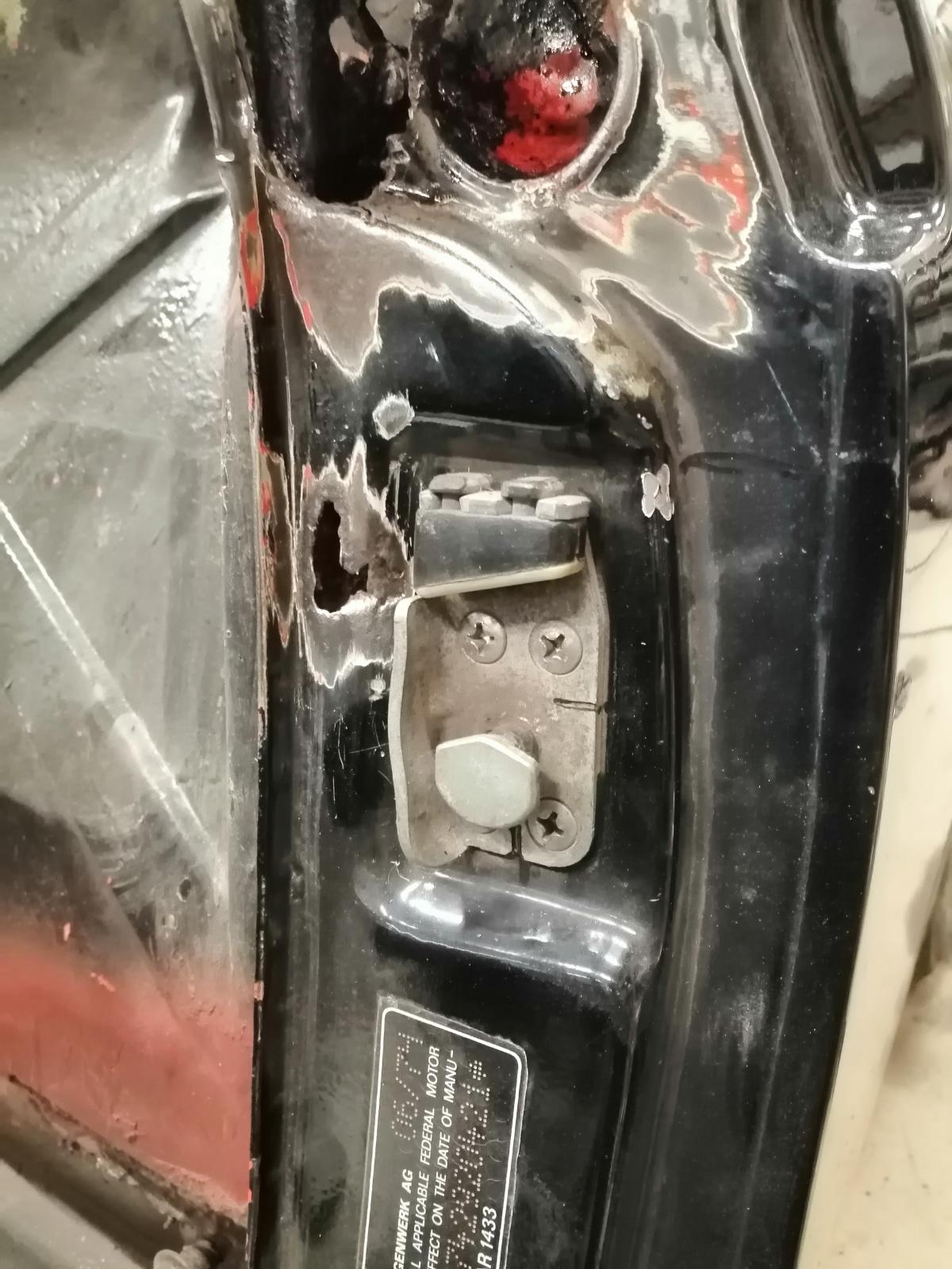

I finished the B-pillar, first with these small reparations:
Before:
During:
And finished:
And here:

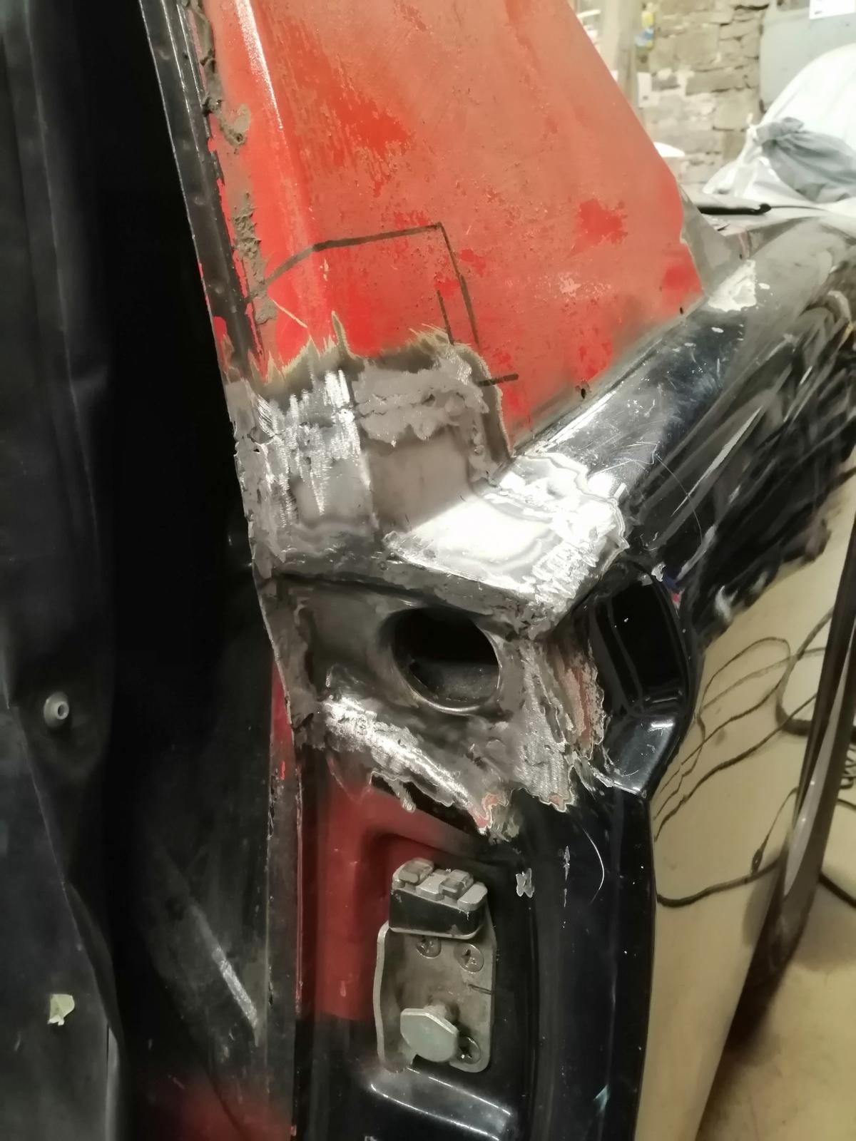

Then I welded my part on the top of the door latch but not before cleaning/fixing/painting behind it:
Then the top part, made in two parts:
And then welded:
Metal finishing will take place when I prepare for paint.

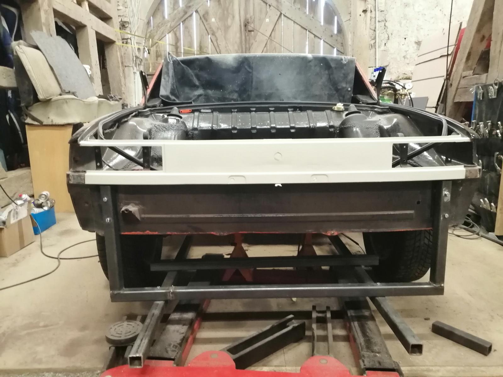

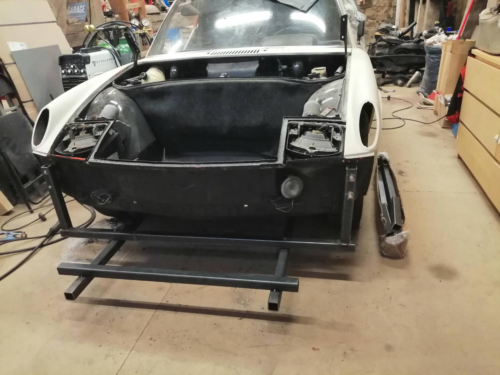

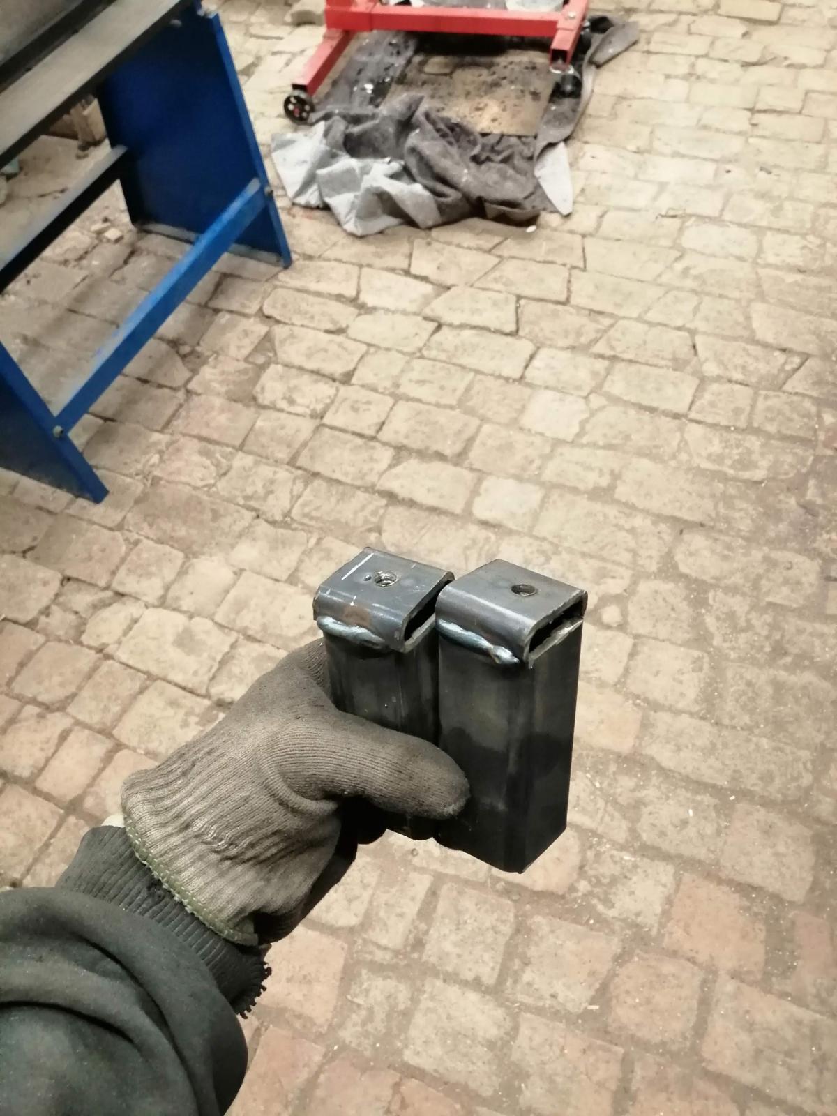

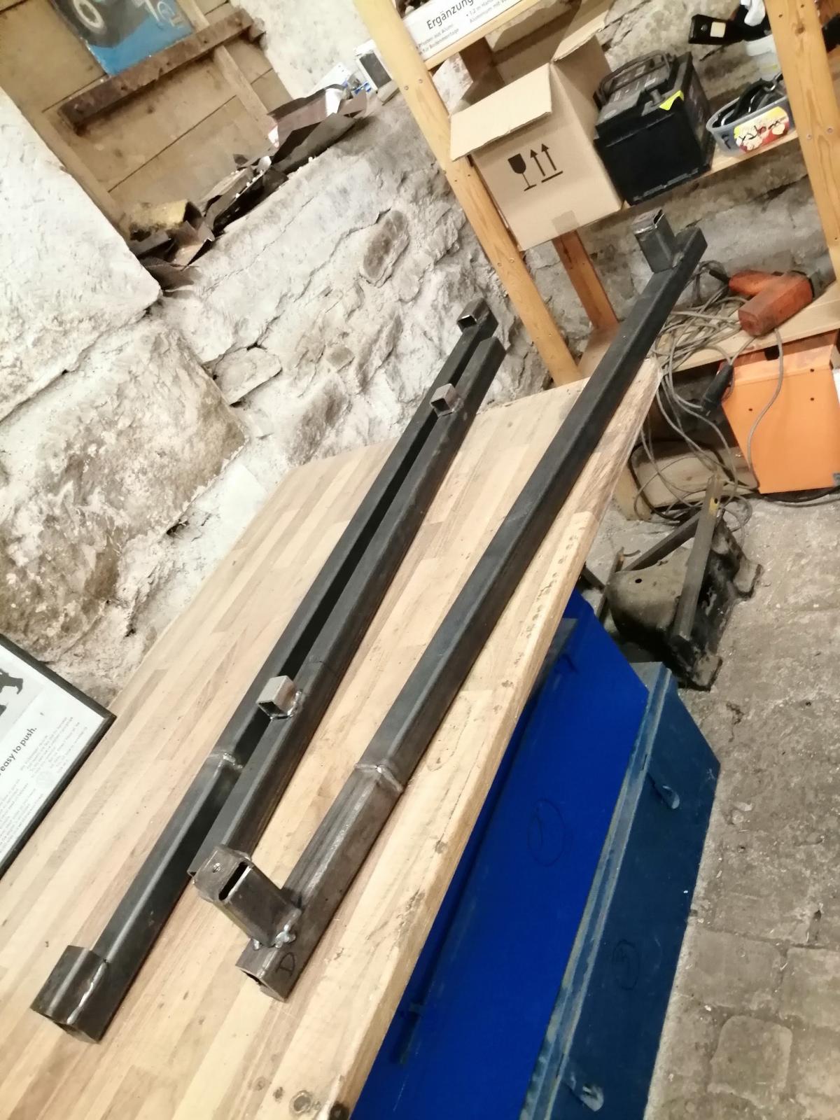

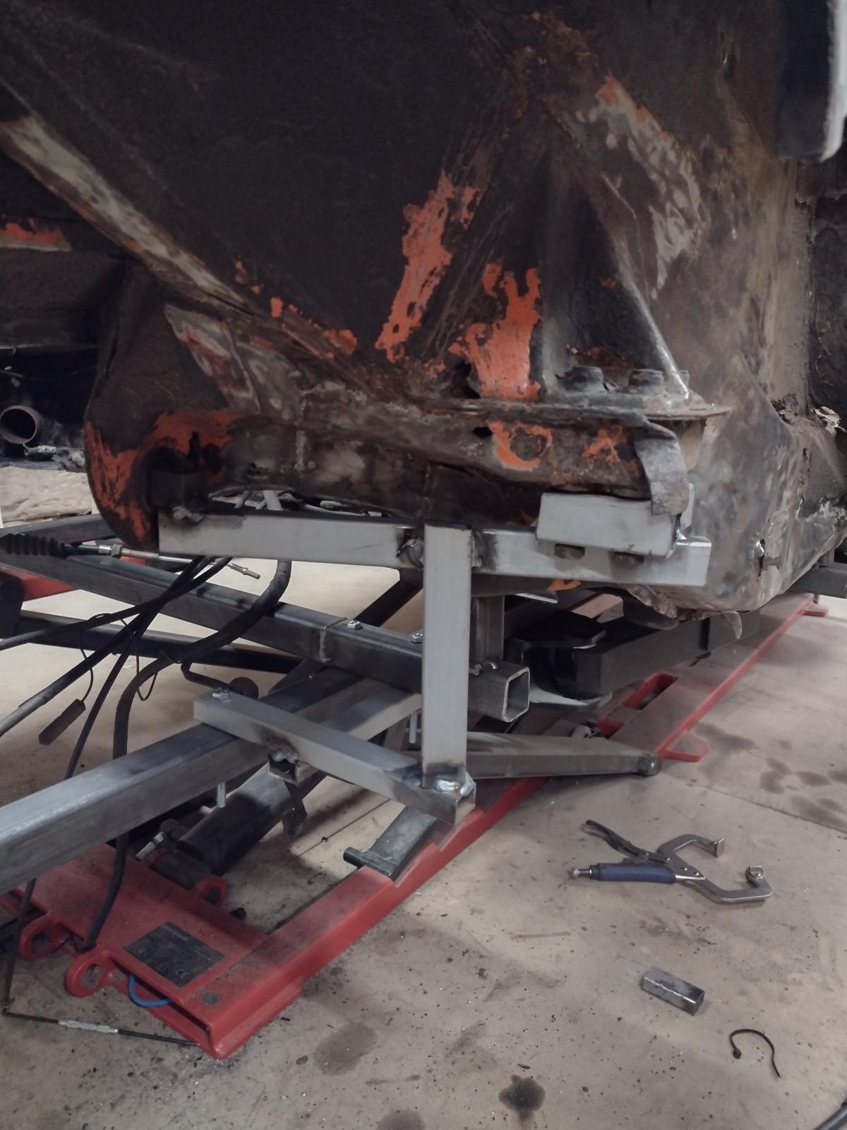

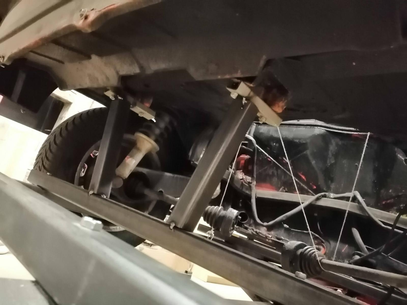

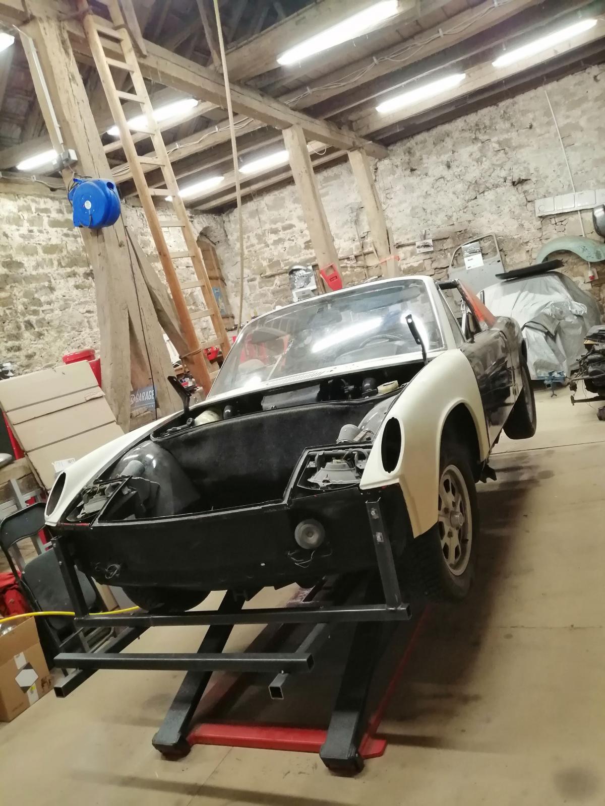

So, I made my body frame to ensure nothing moves during welding:
Every fixation is screwed to be able to remove/reuse all after.
Front:
Back:
Under the gearbox: (pic during tacking, fully welded after)
Engine mount:
And suspension console to have the exact position to put it back after hellhole repair:
And the car is up:
Stay tuned

Hi Antoine,
You have done a great job making the car securely tight and tightly secure. Very important for all the surgery you are doing !! Great to watch over your shoulder.
Success and joy!

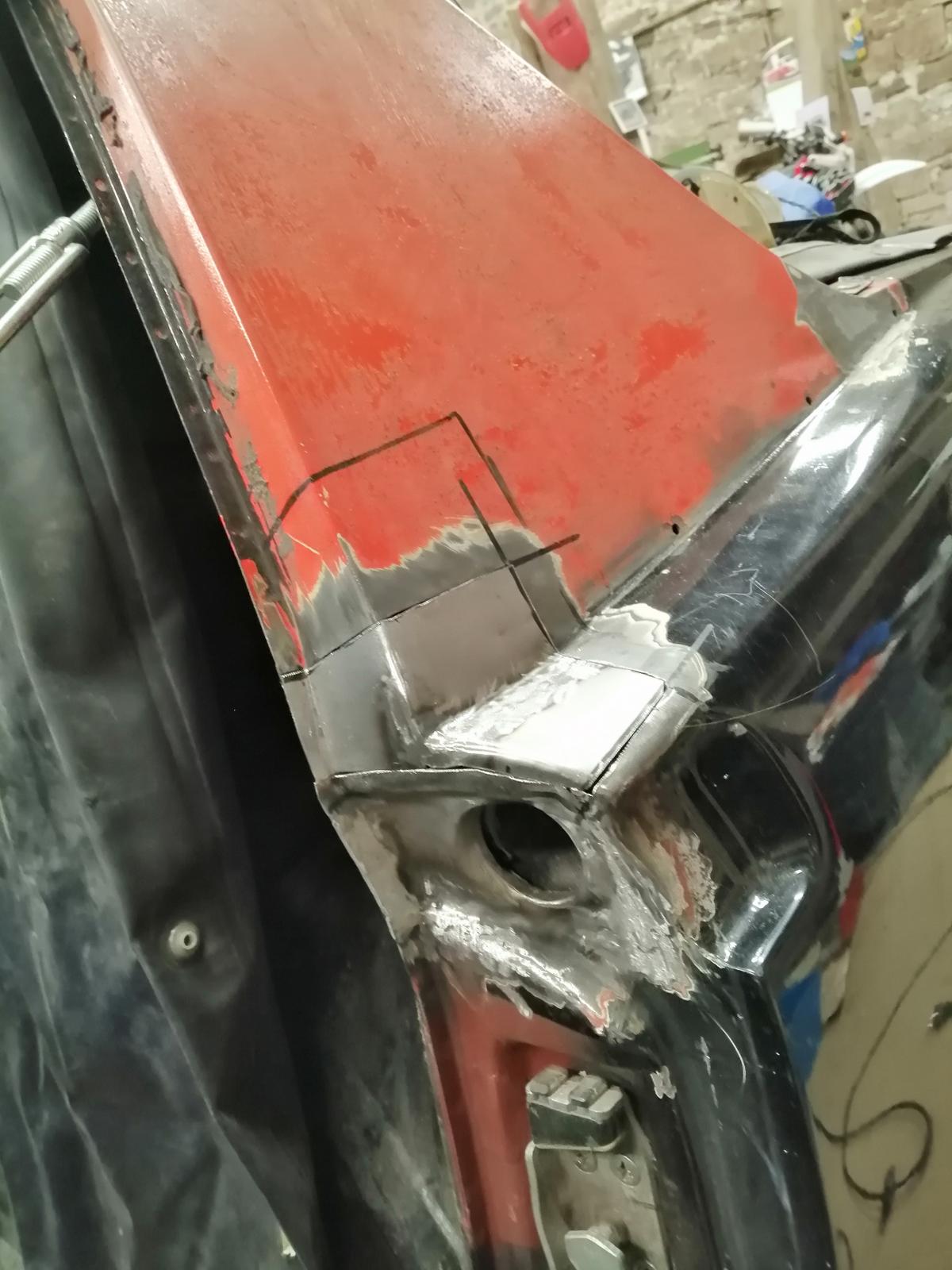

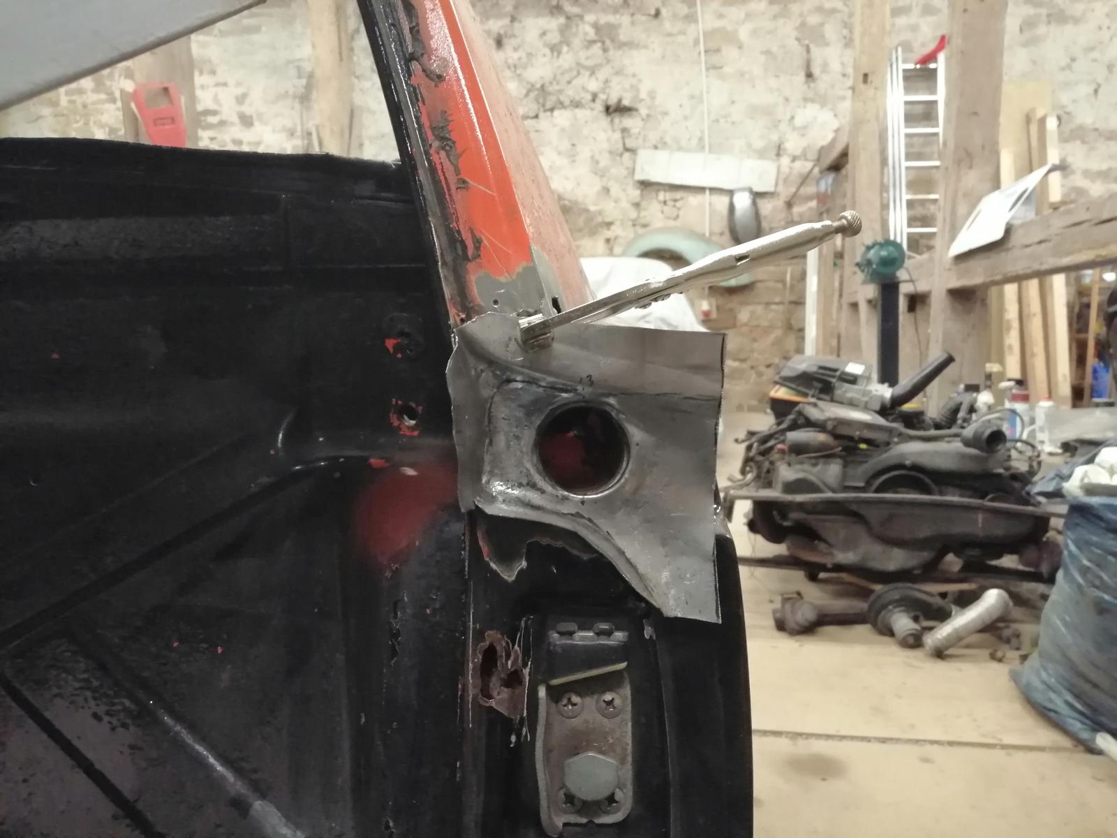

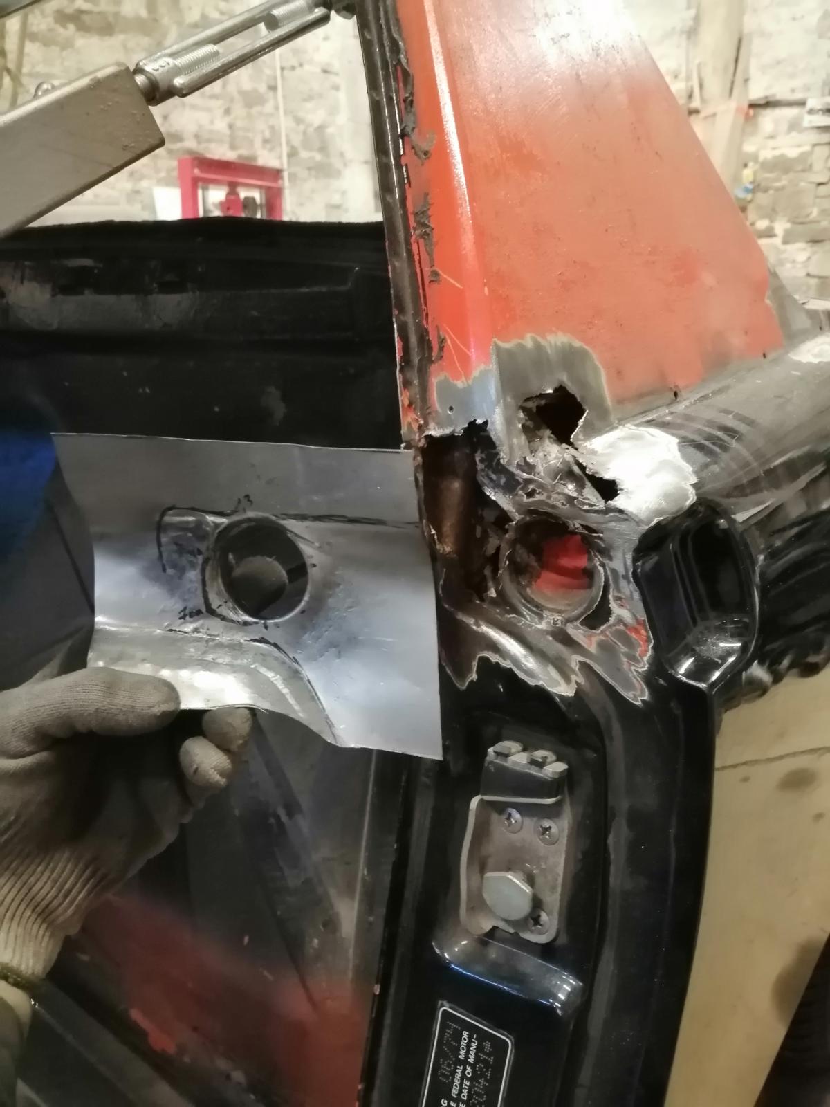

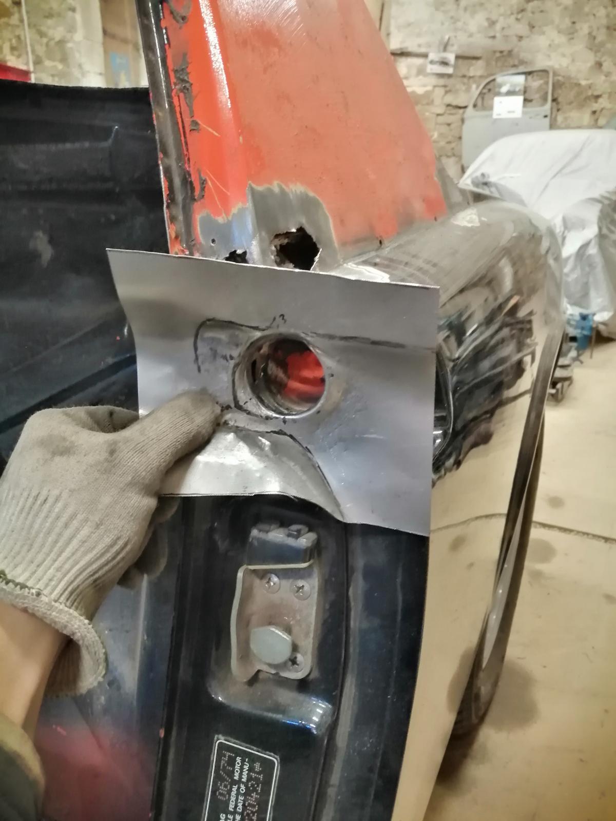

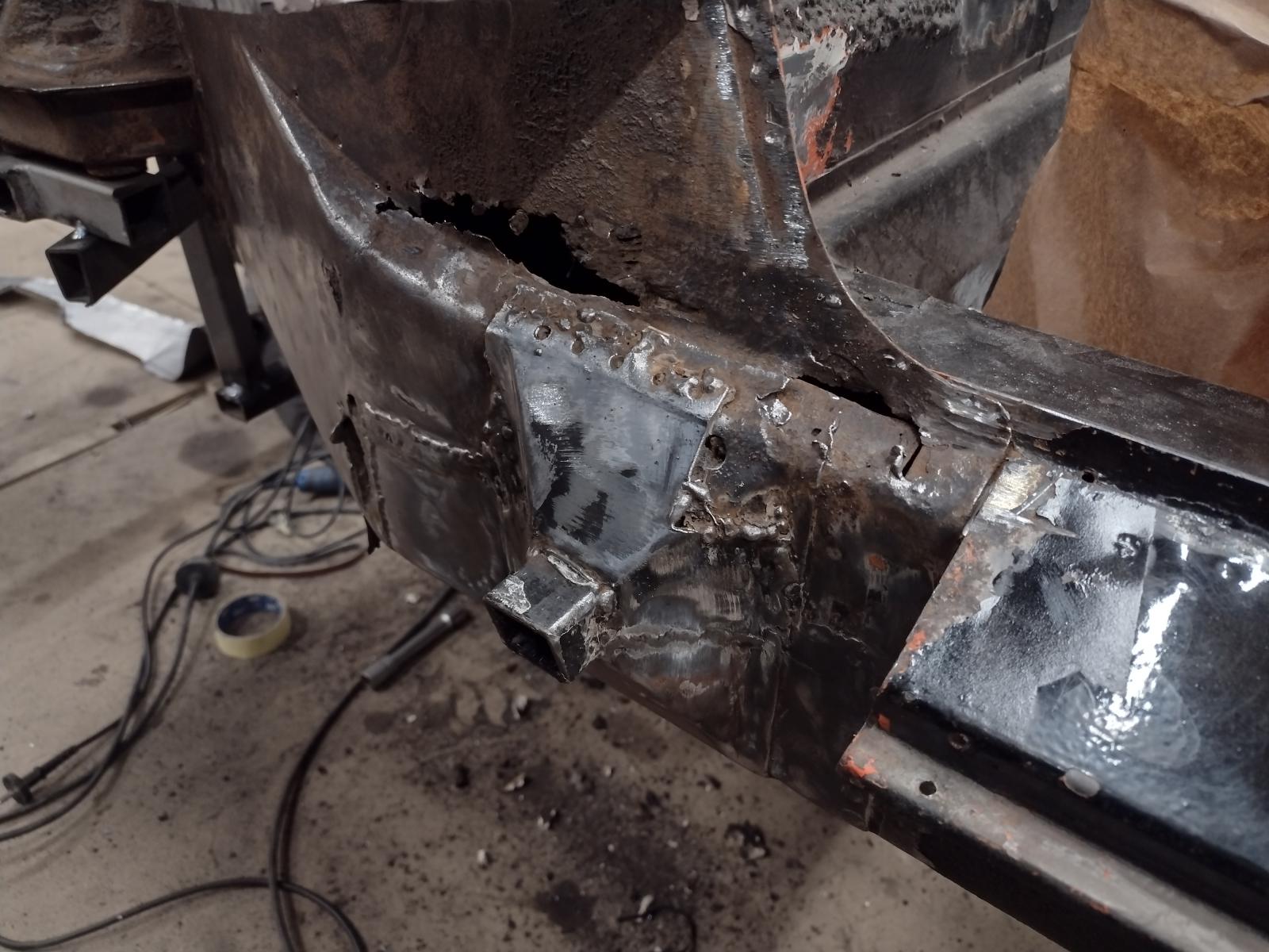

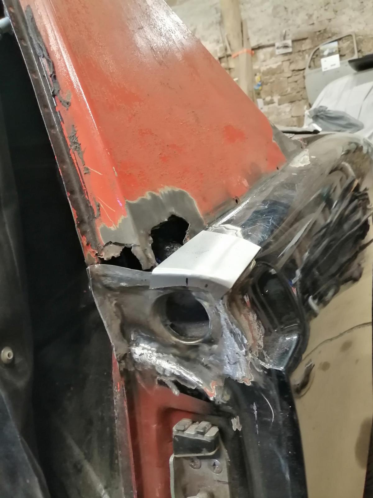

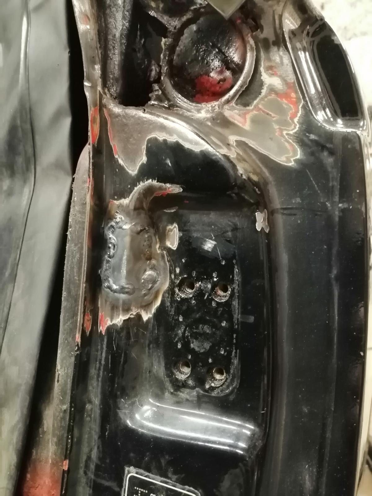

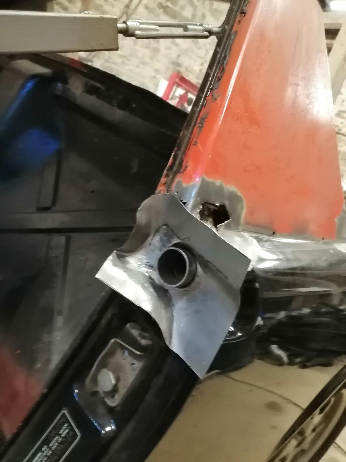

Before starting on the hellhole, I made one last repair on the driver's B-pillar.
The bottom had some holes:

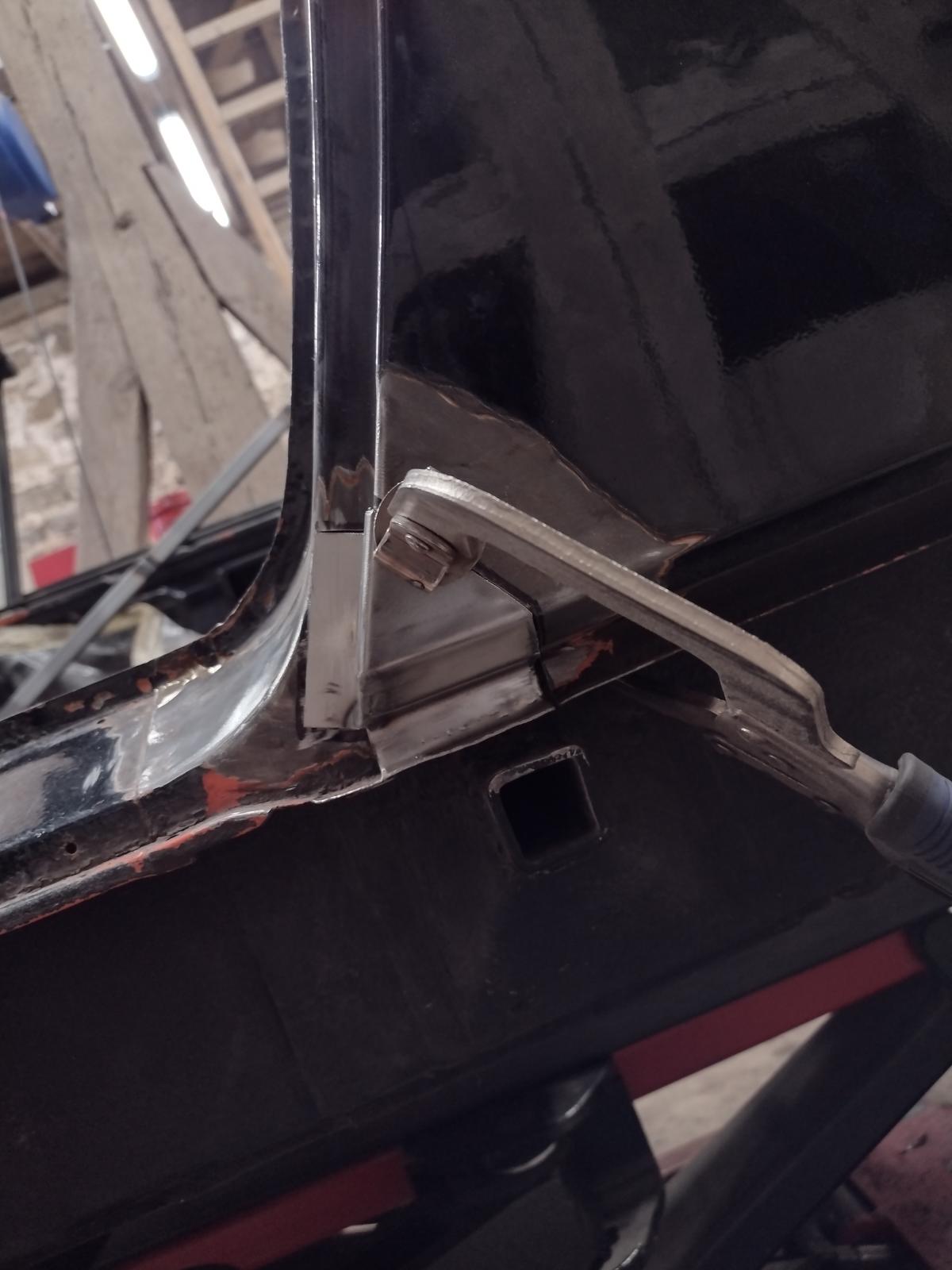

So I built the repair part in two parts as original:
Adjusted:
Tacked in position :
Stay tuned, hellhole repair comes next!

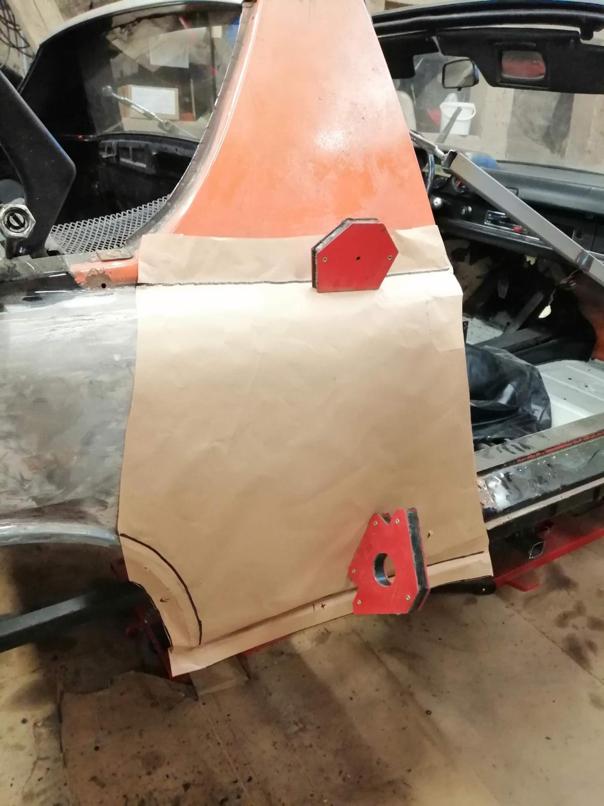

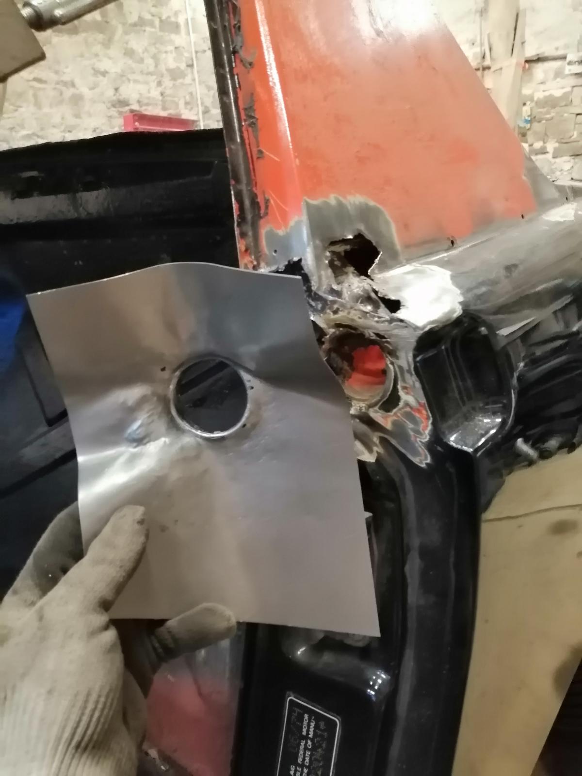

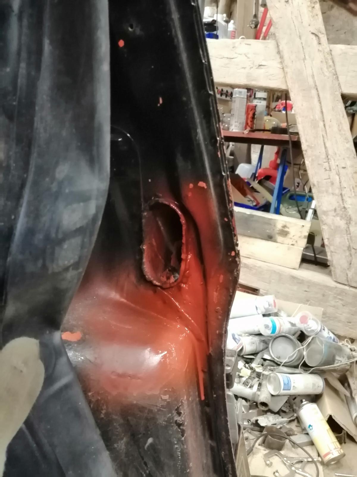

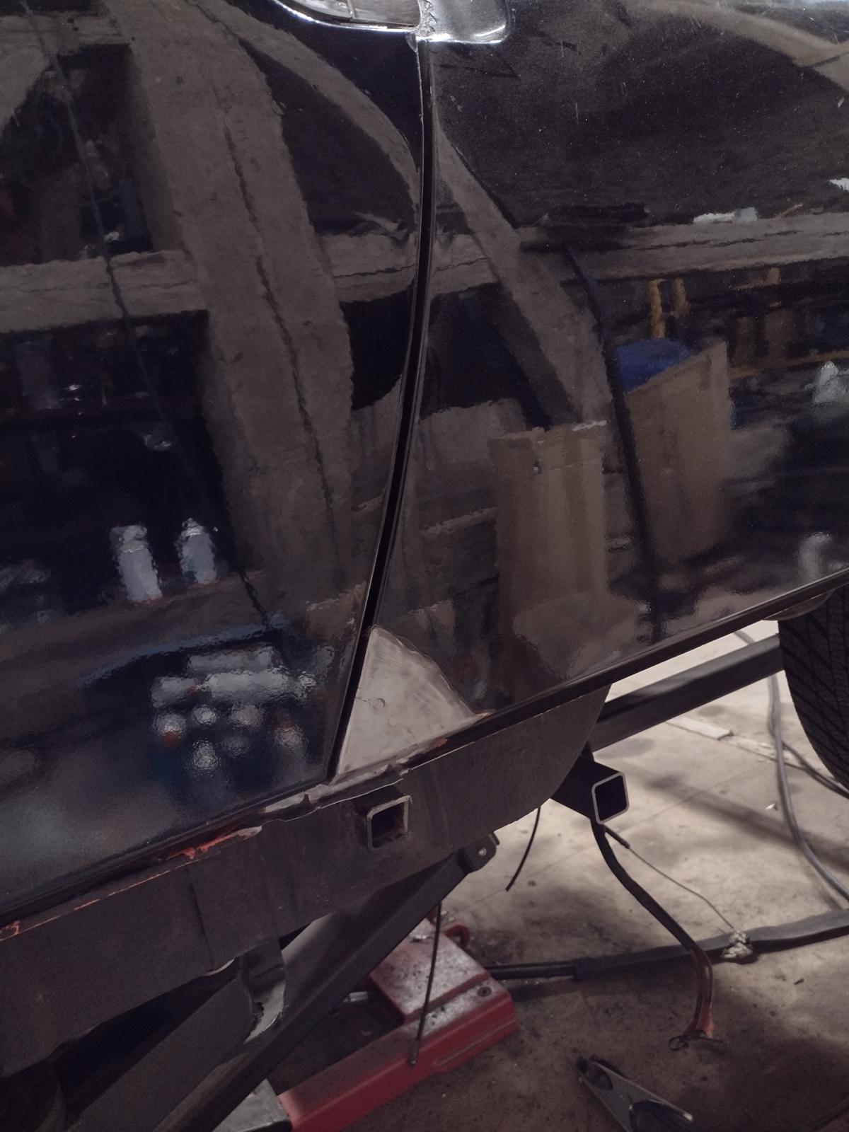

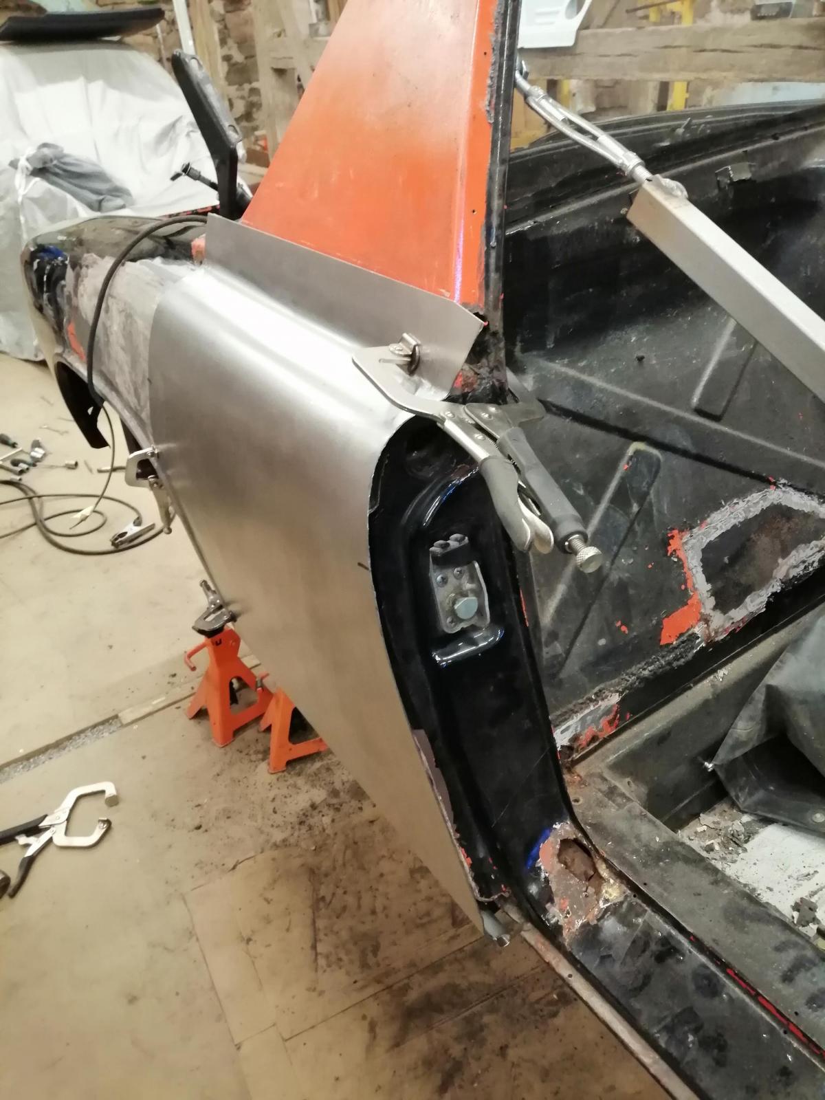

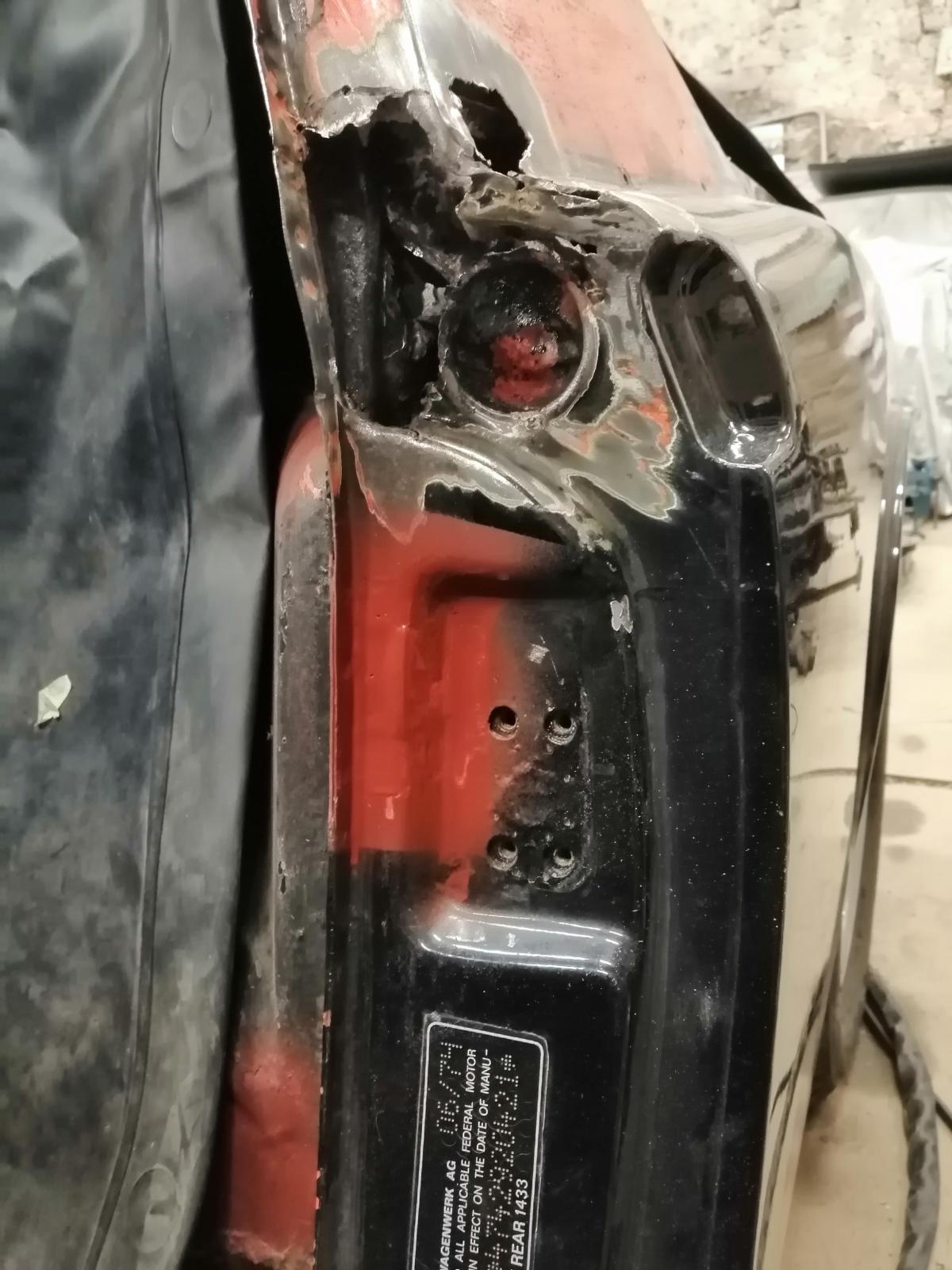

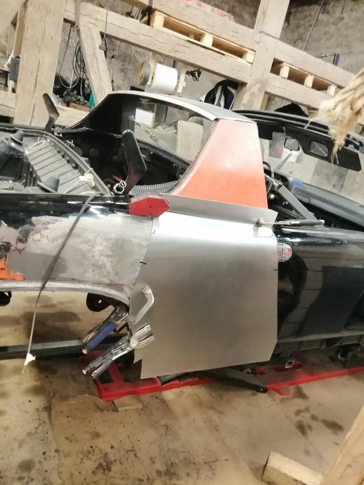

So, before removing the paint on the right rear quarter panel, I was'nt sure how to deal with it while repairing the hellhole. I knew cutting it would allow me a better access but cutting good metal is always a hard decision..
Well, from that point of view I got "lucky" because there is no good metal
Here without paint:

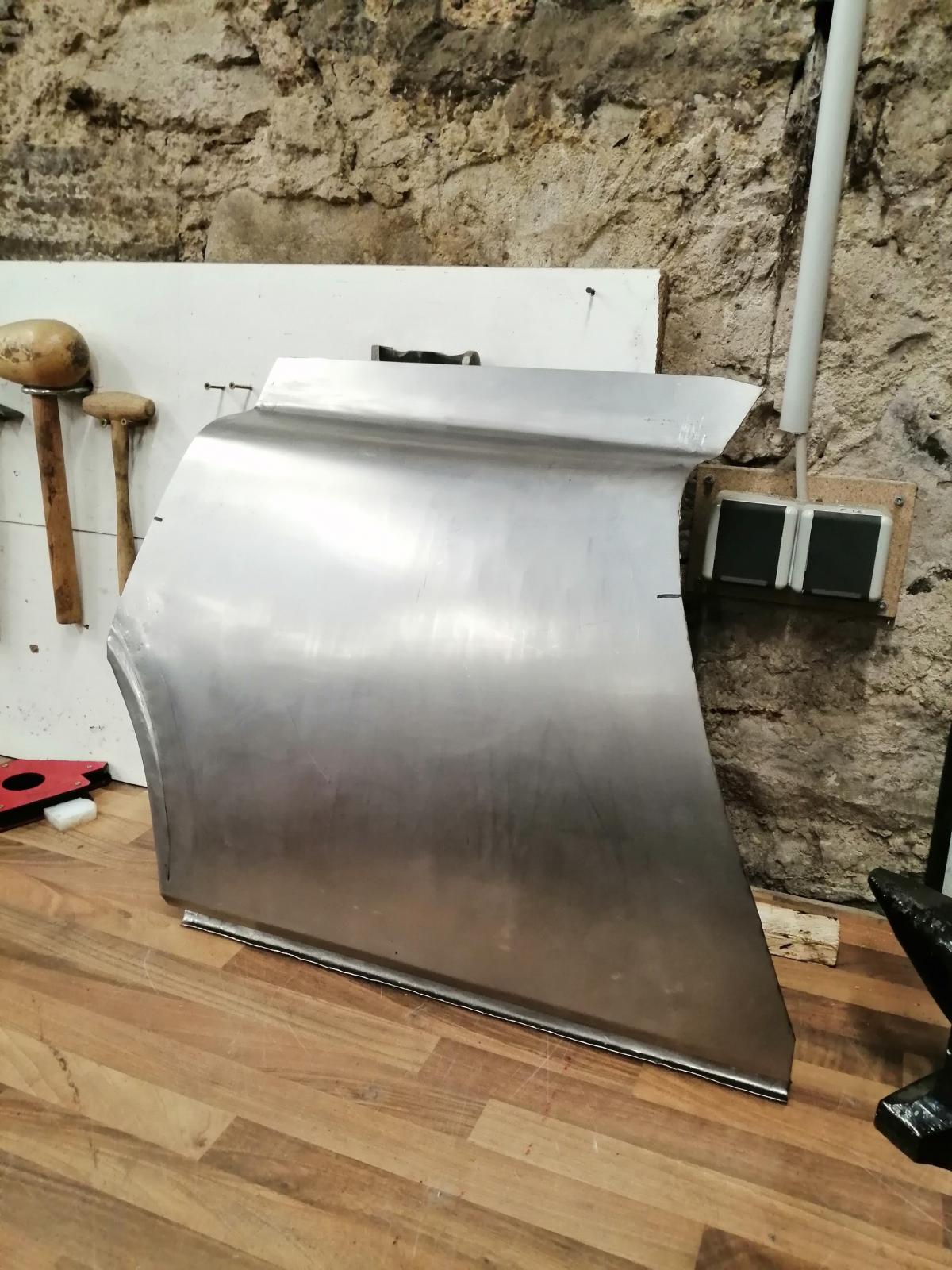

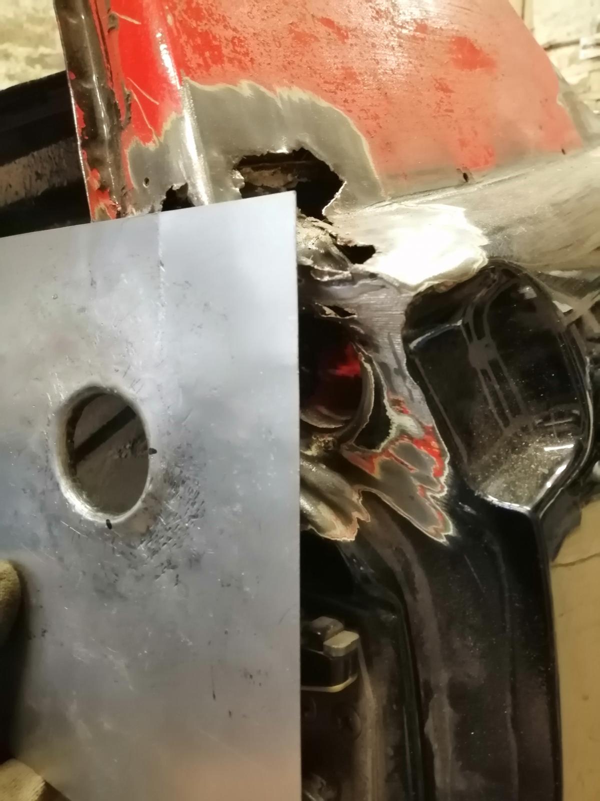

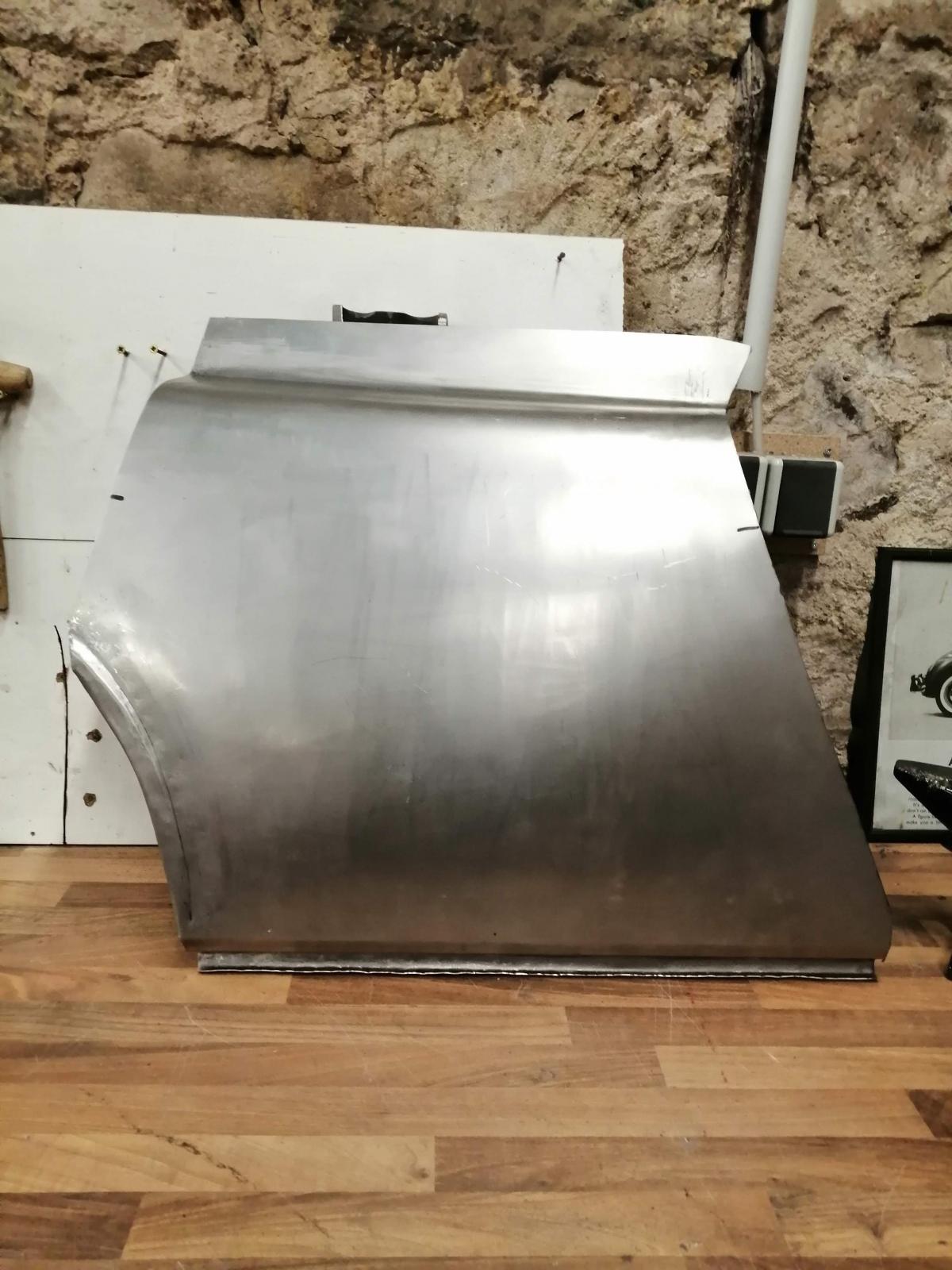

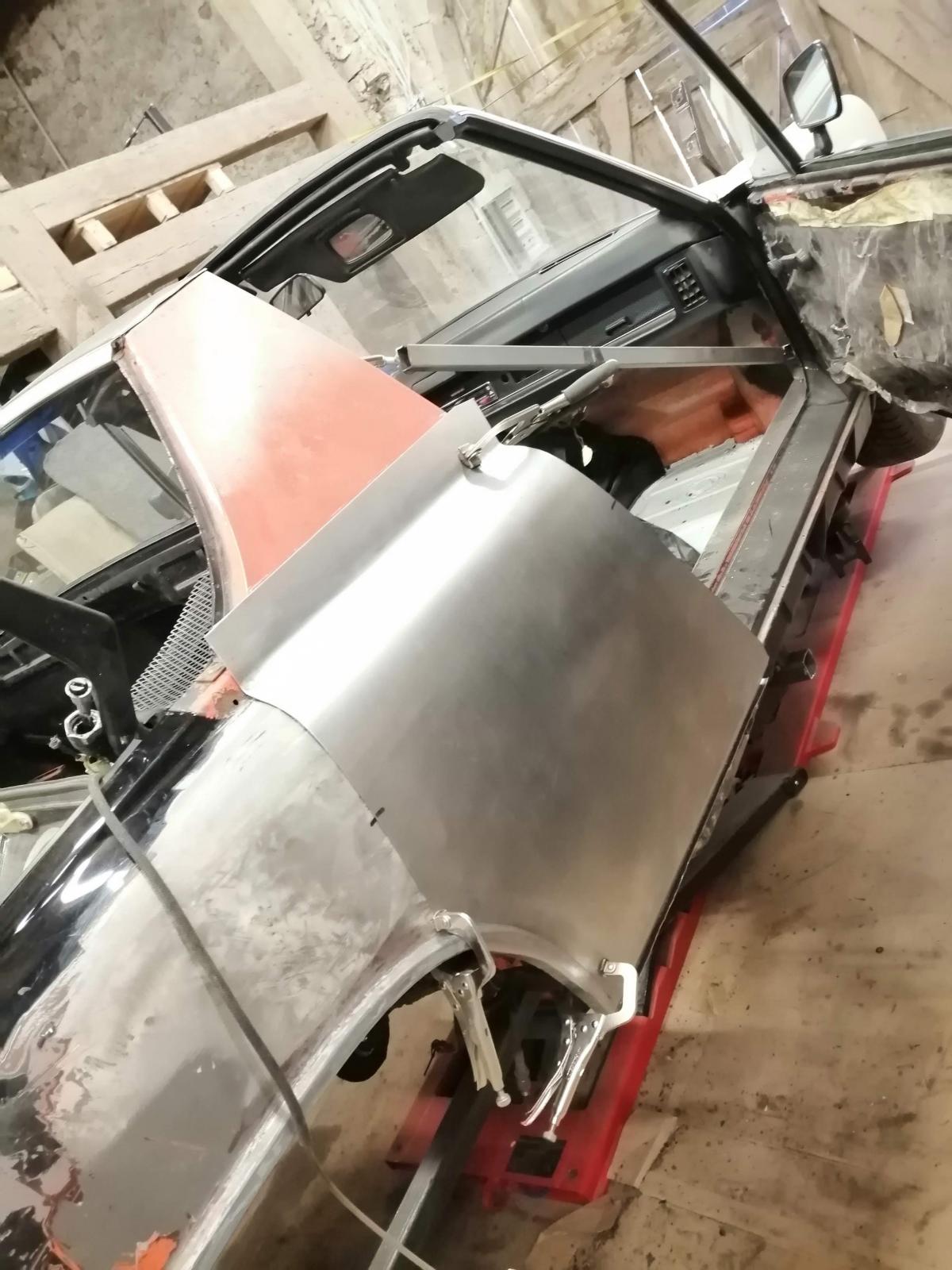

And I have a habit that I built(or make sure I have it) the part before cutting, to ensure I won't miss any measurement/positioning. So here we go !
Making my template :
And starting :
And after a couple hours:
I left the front part undone to be able to make a good door gap when it comes to that time.
So, now that this is done..cutting!
Stay tuned, the work on the hellhole is going to start!

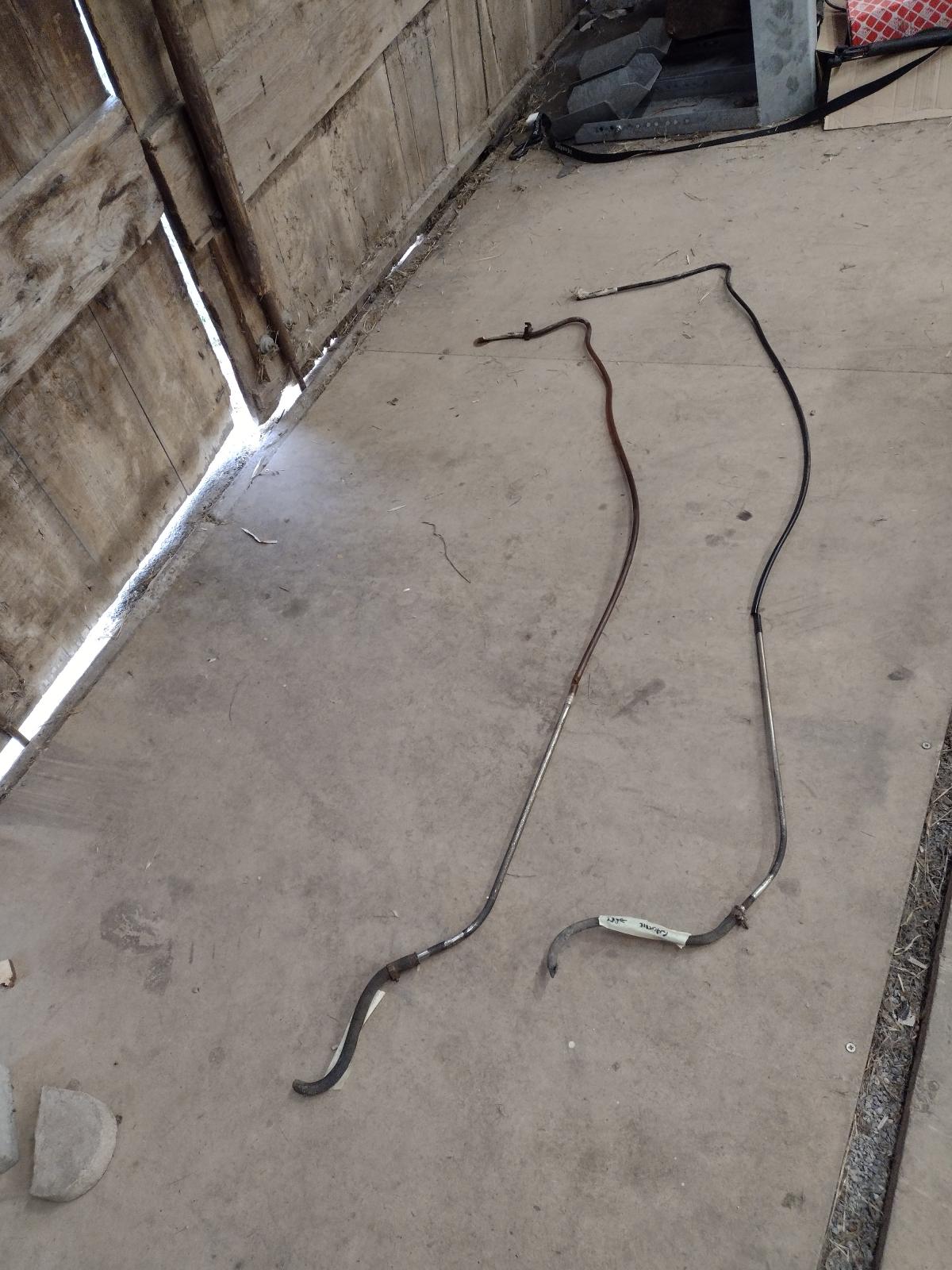

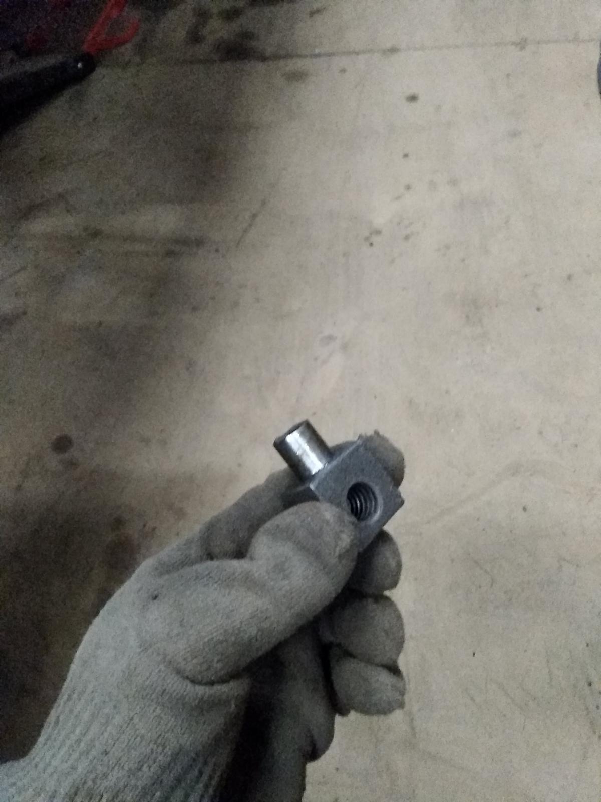

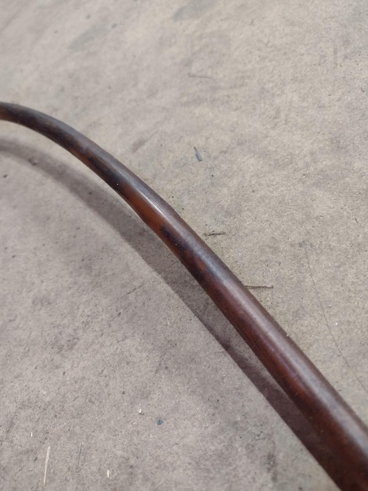

I removed the 47 years old fuel lines:
Stainless steel replacement is on its way!

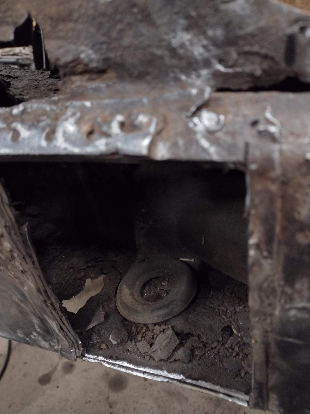

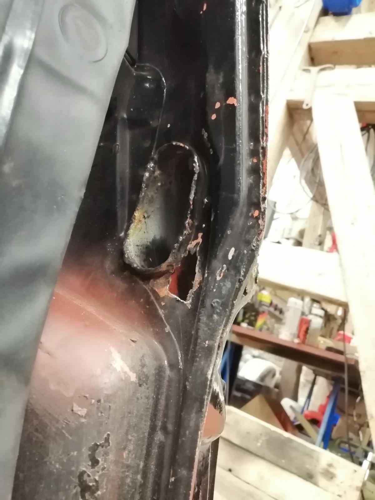

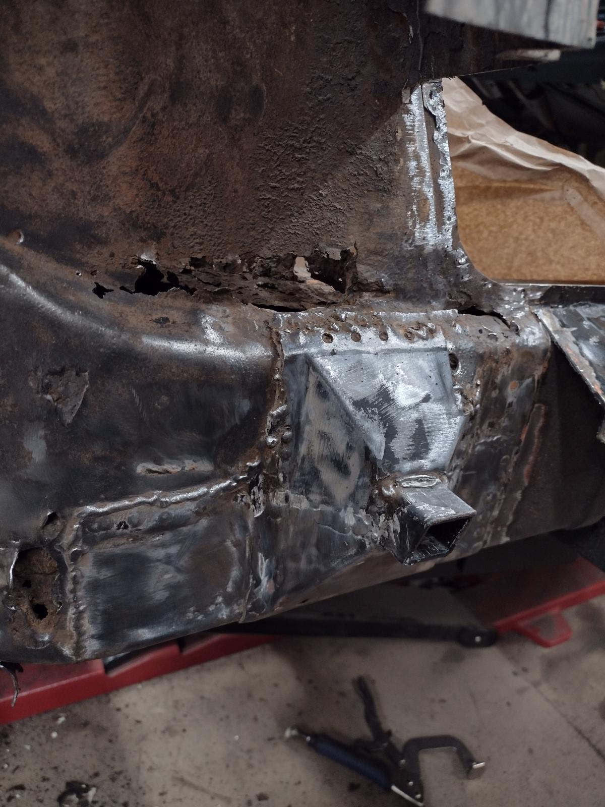

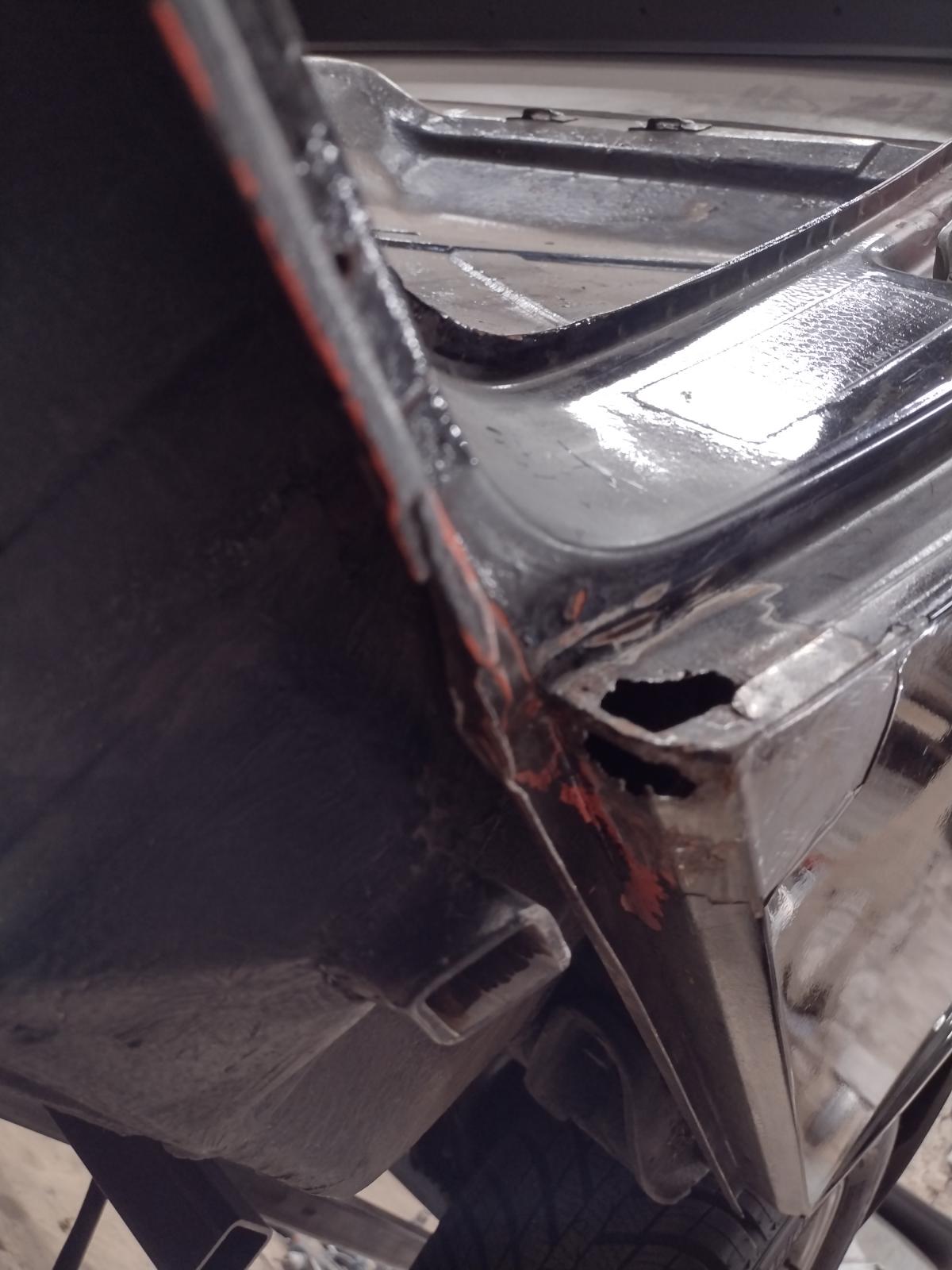

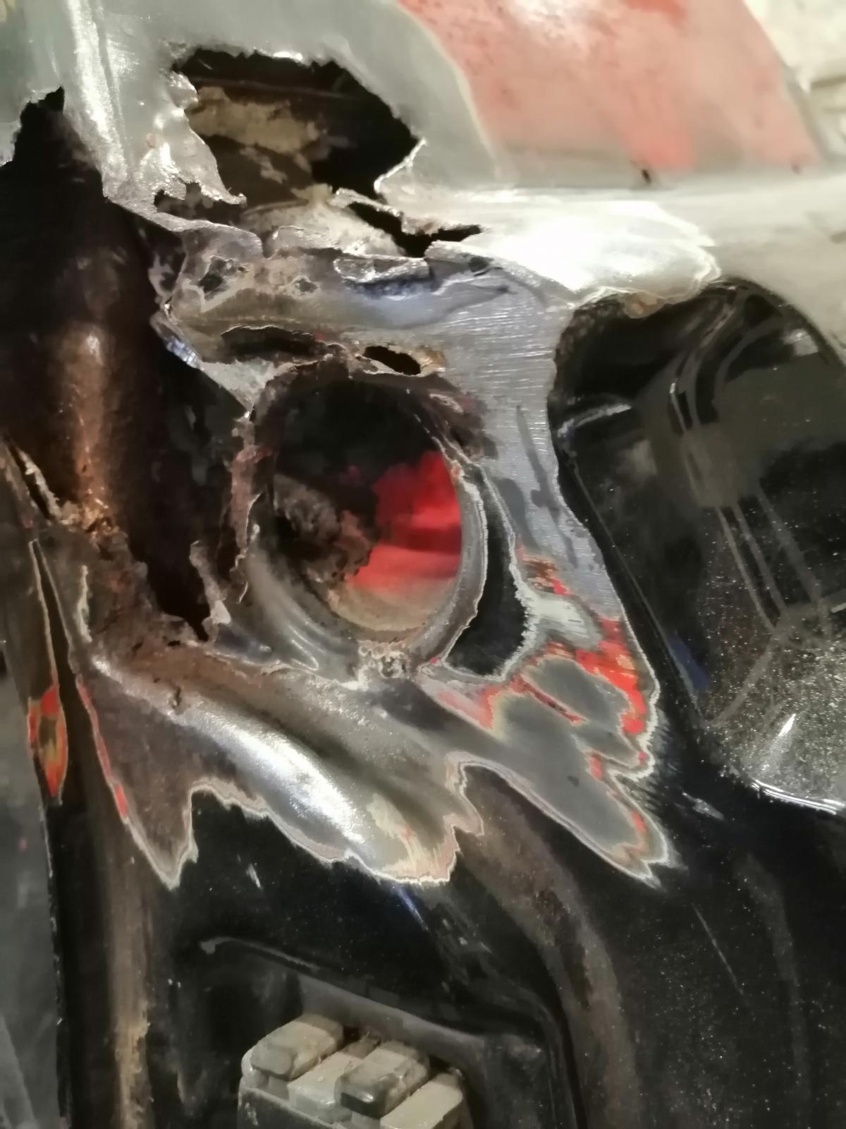

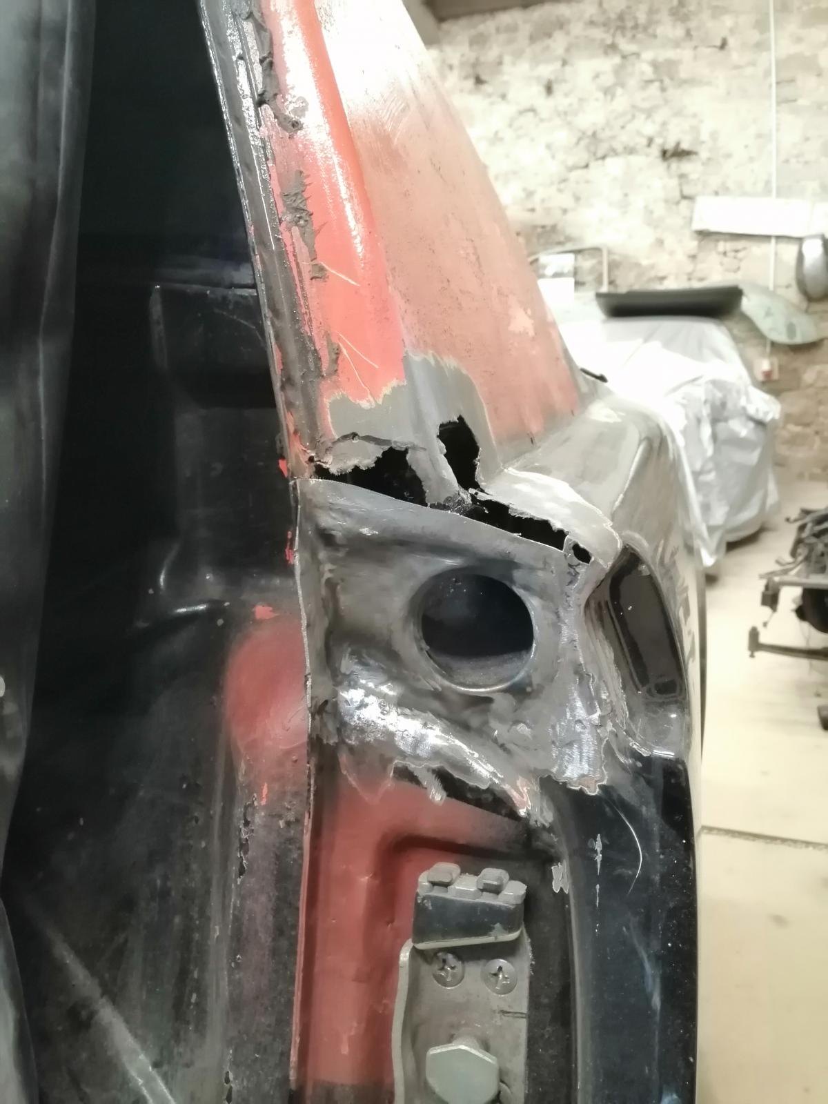

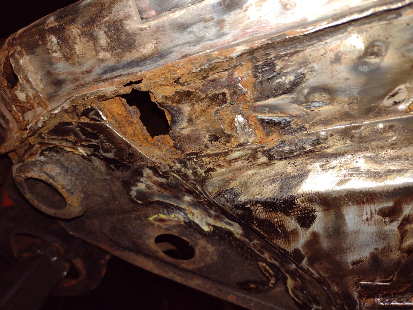

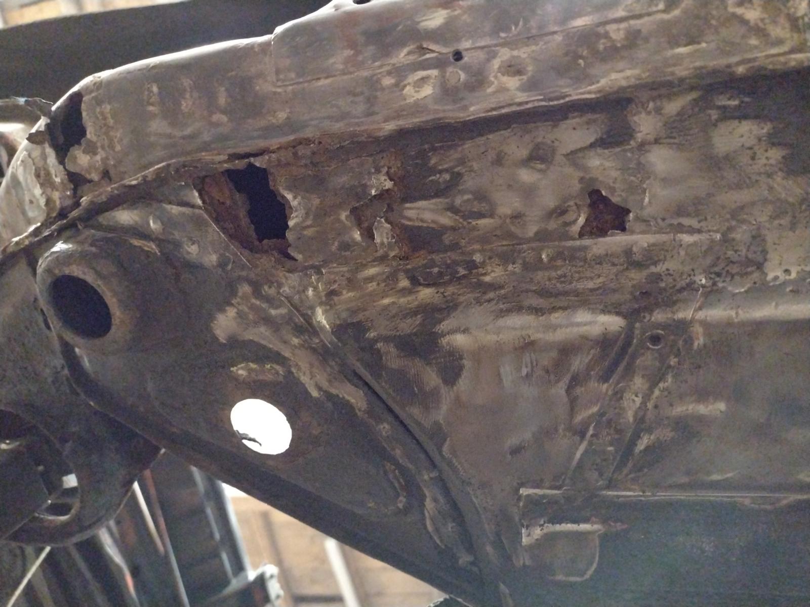

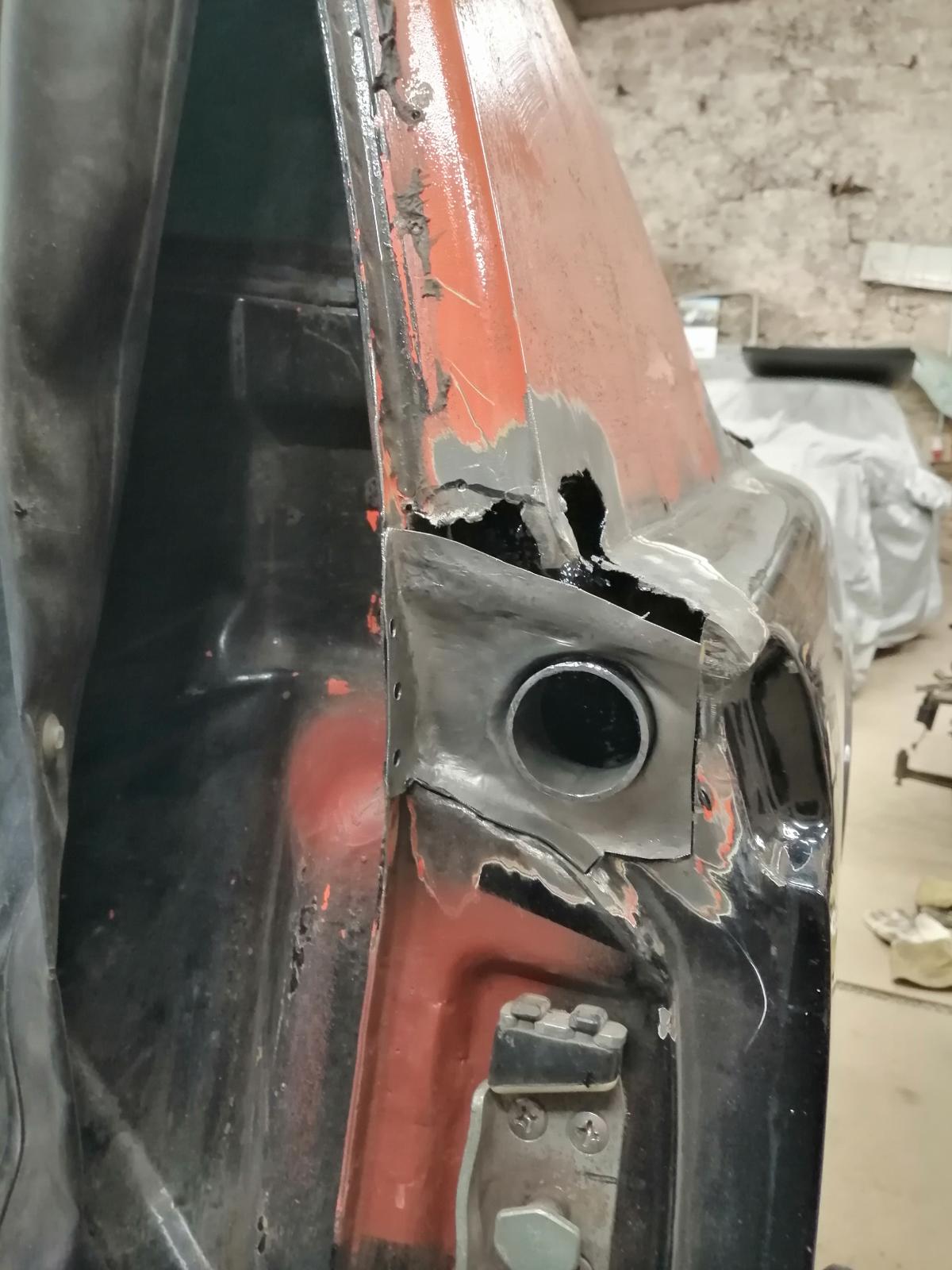

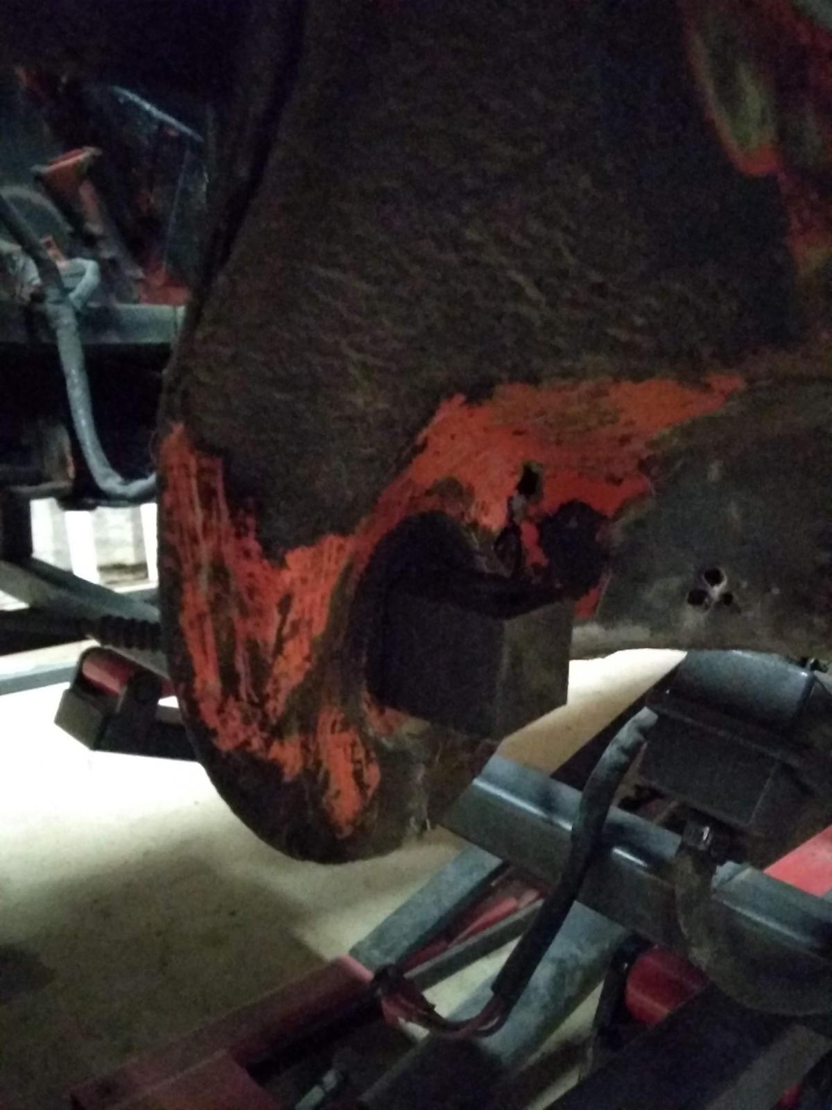

Then I looked further on the outside part of the hellhole..which doesn't look promising:

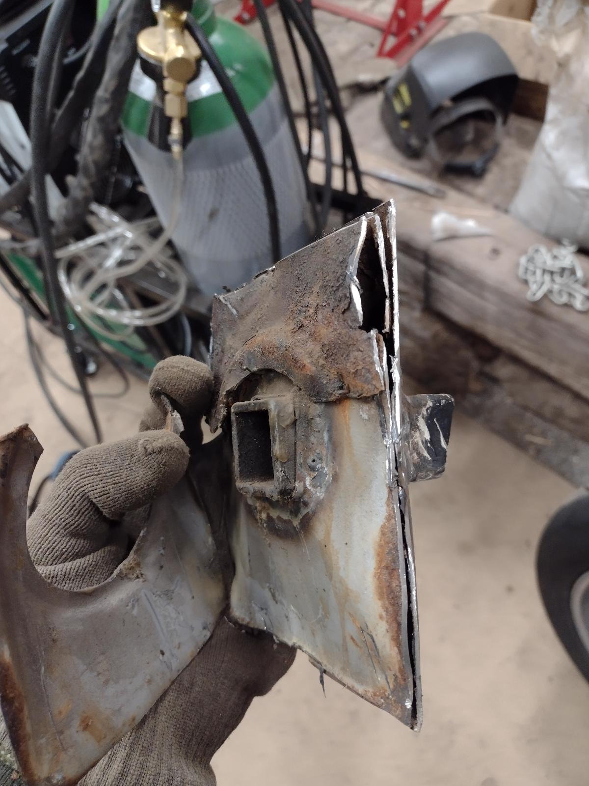

And after checking a bit inside (quite a lot of layers in this badly repaired jack point..):
There were some findings:
And a lot of rust falling through:

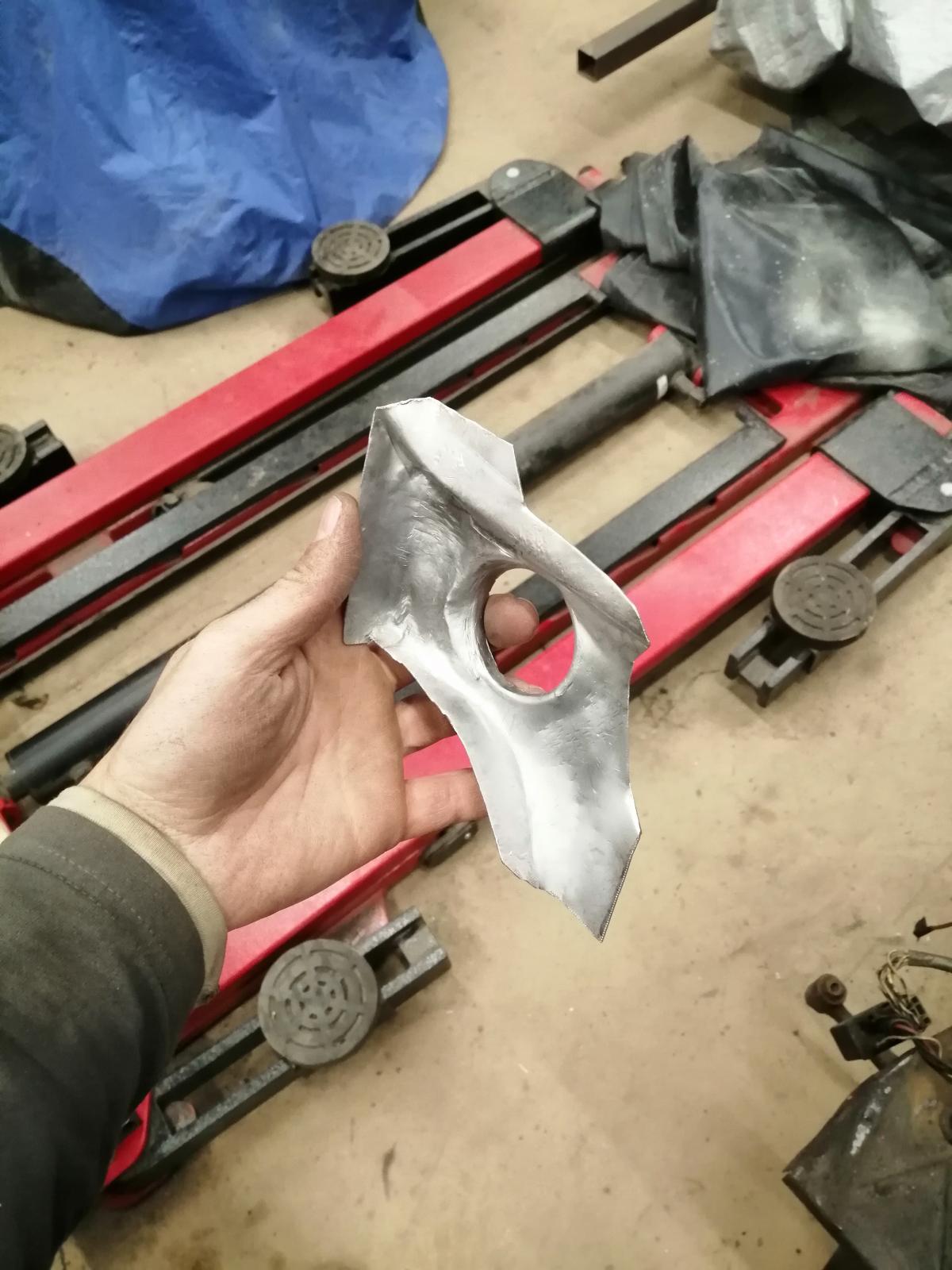

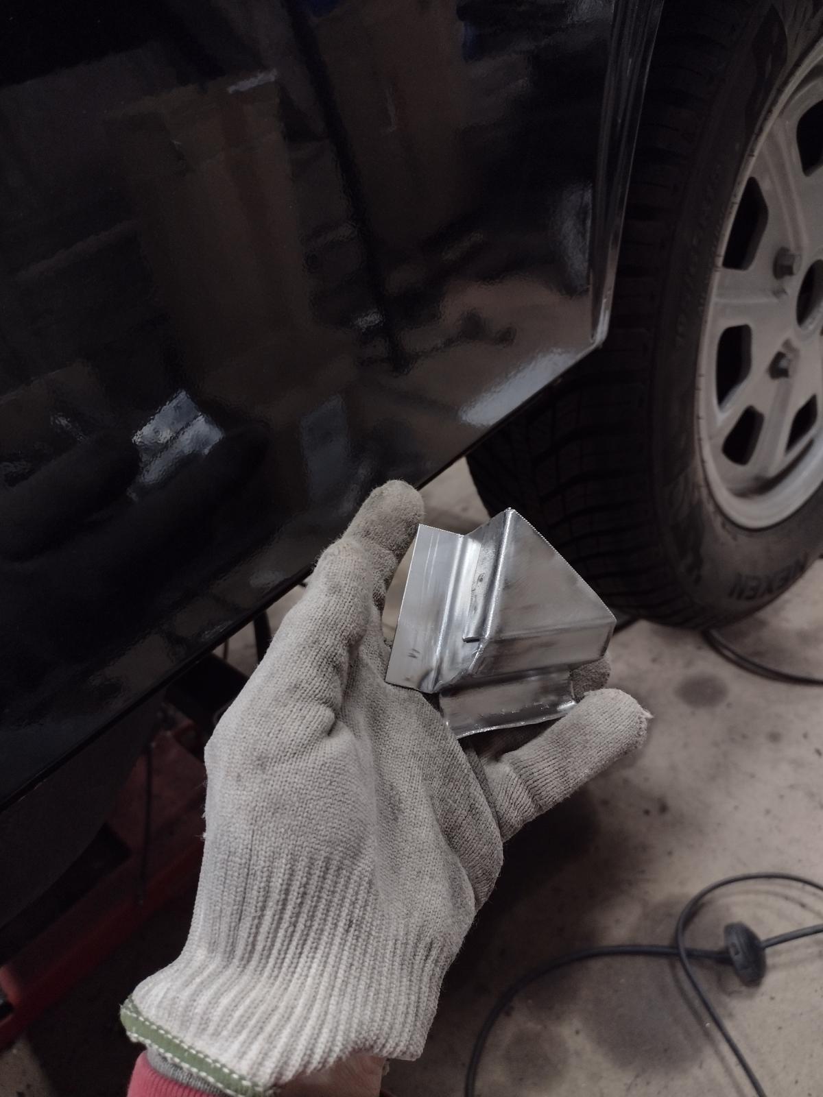

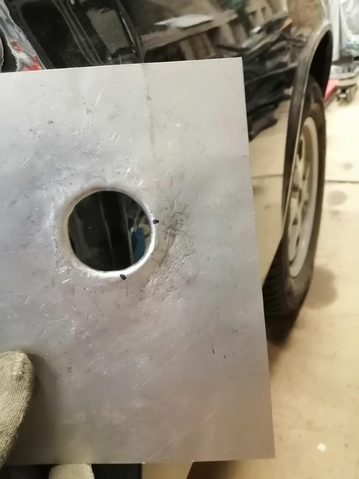

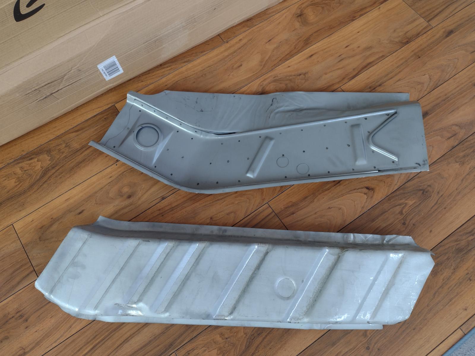

I did not want to fight forming too much thick metals so I made a small order to save me some time:

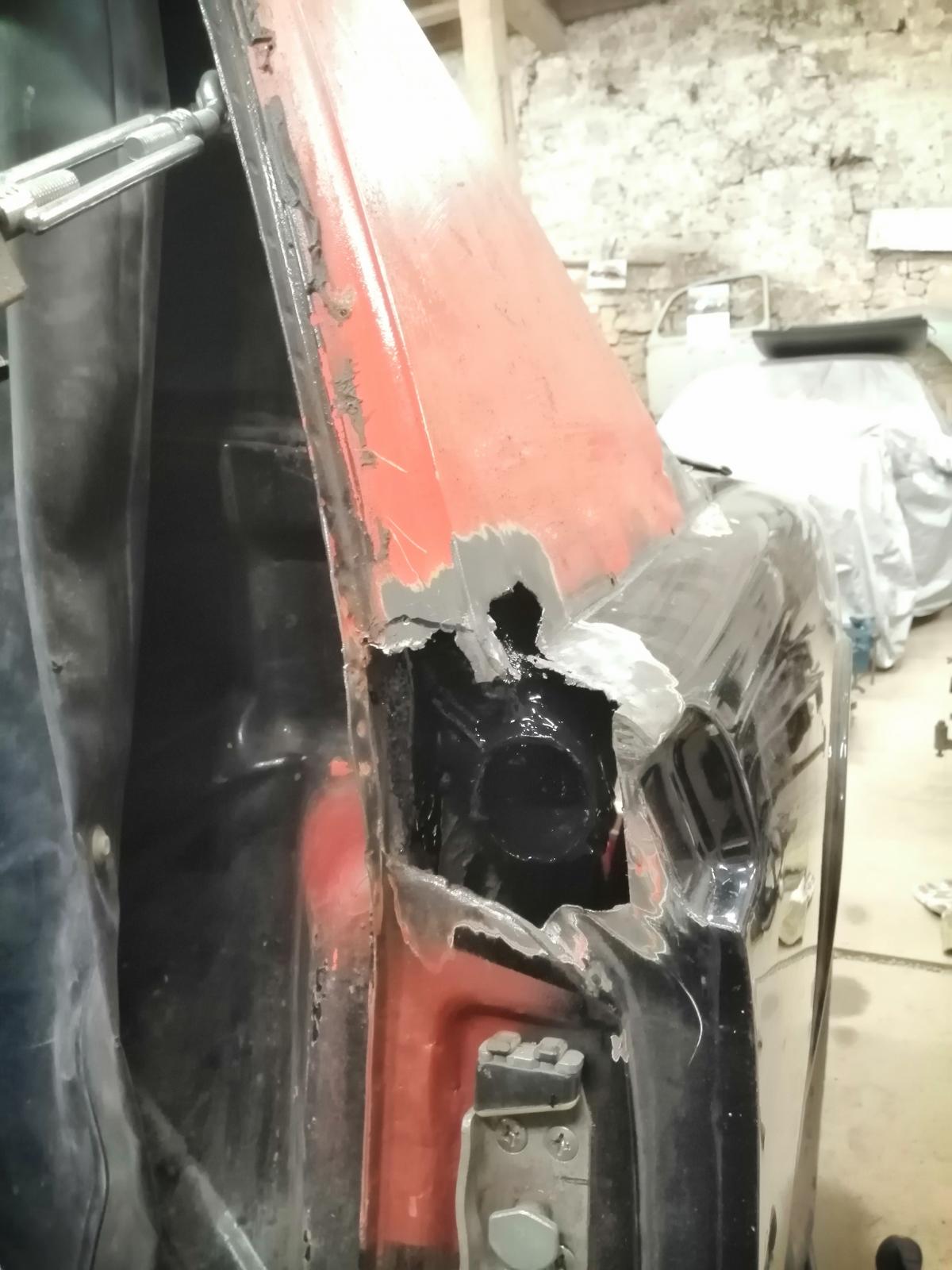

So..time to cut really into this repair..
