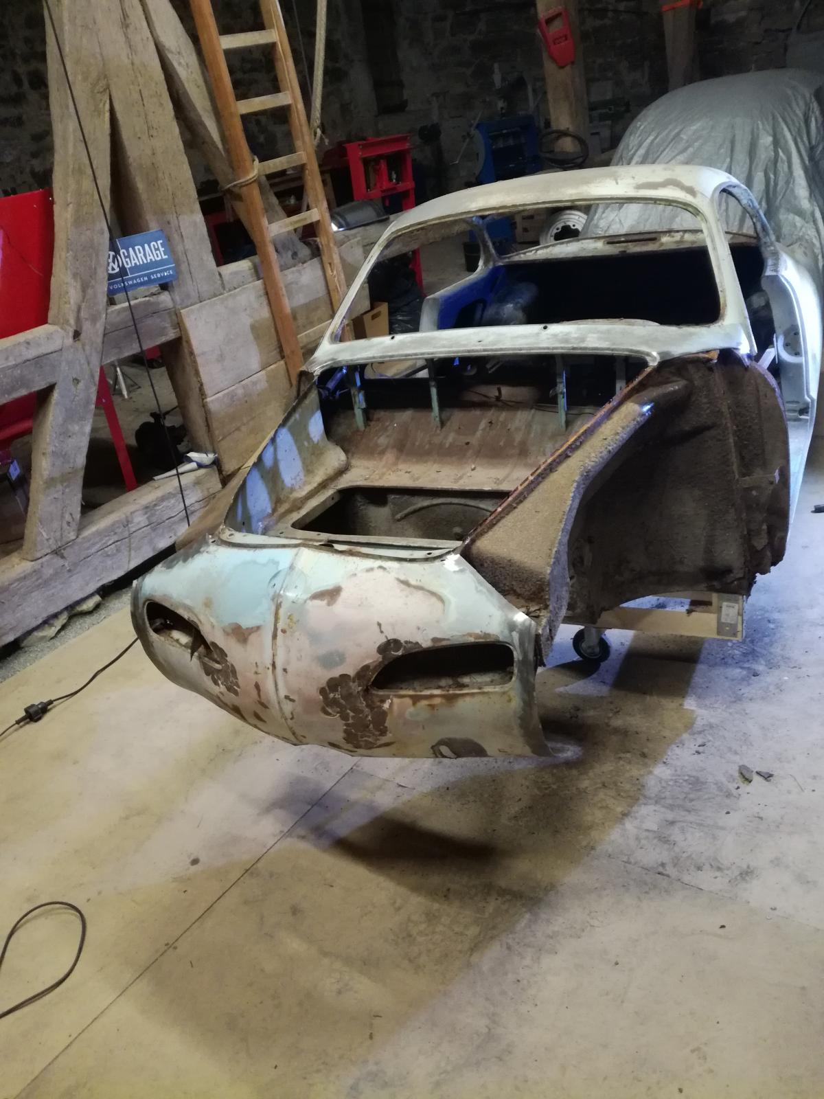

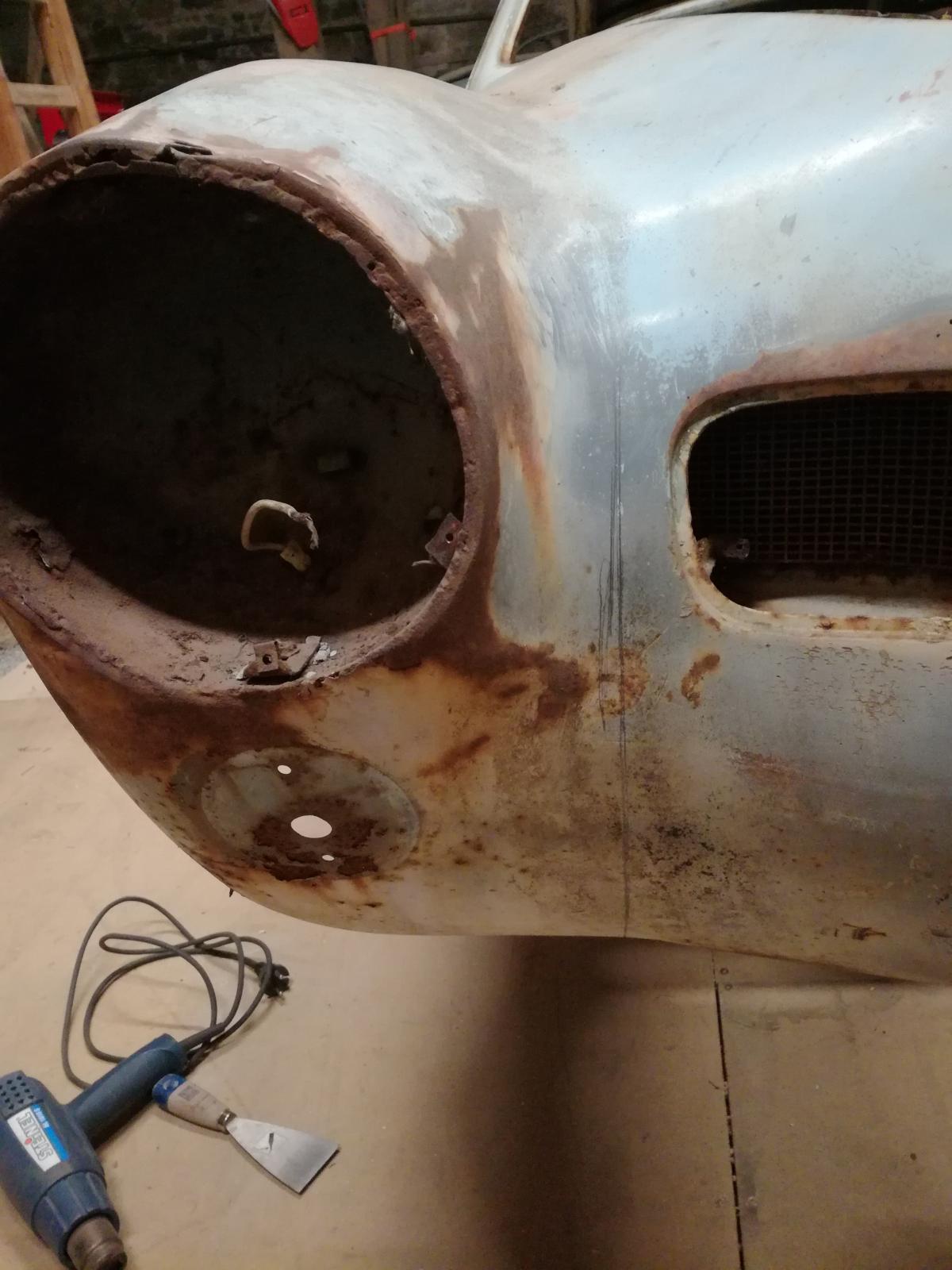

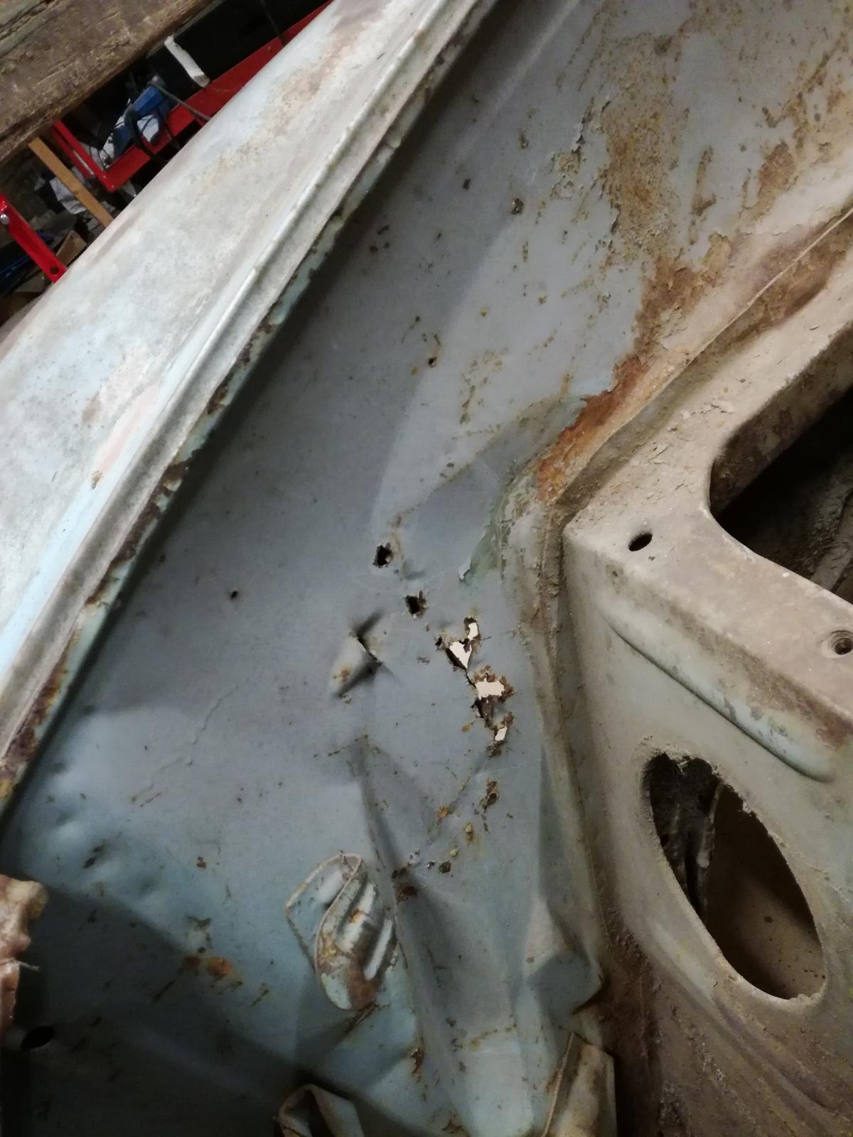

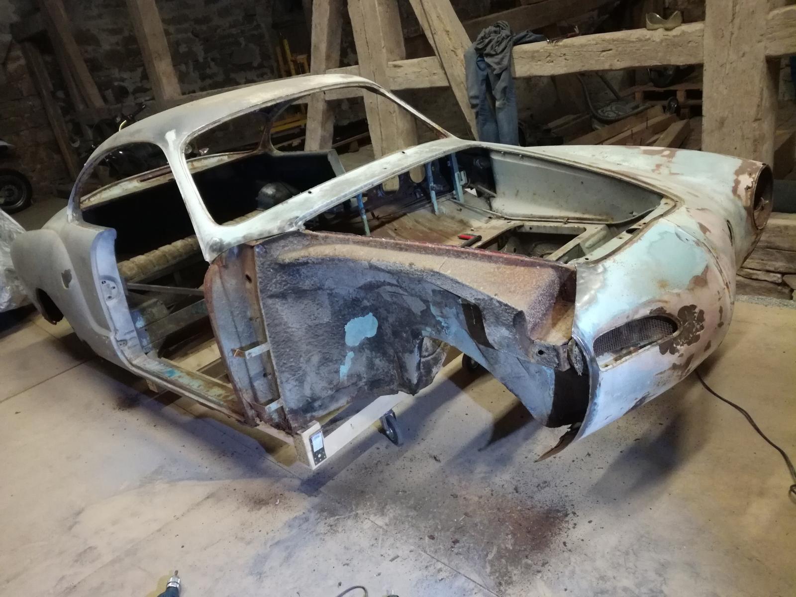

Well, I am waiting on the last seat rail to come (sadly will only be end of march apparently..well, everything is prepared for it and it will then go fast and be warm enough to paint the pan so not that bad..always seeing positively!!) so I started on the body. It was clear to me since the beginning that I will have to remove the front fenders as it is quite rusted under it: And it had apparently a small accident in the front so the nose will need work or to be replaced (still unsure until now, more on it in a future update). So I traced every needed lines: And we went from there: To there: To there: To there: Now we can see better where the journey goes :twisted: Not only the front will require some work but also the air boxes: Have a nice day Antoine

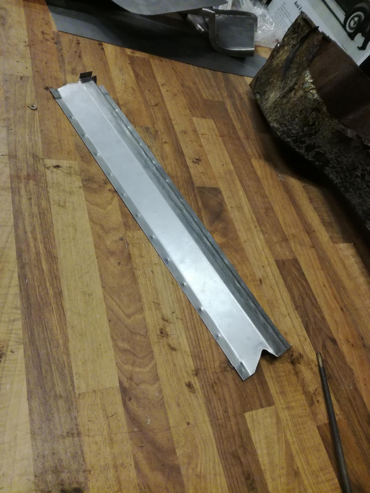

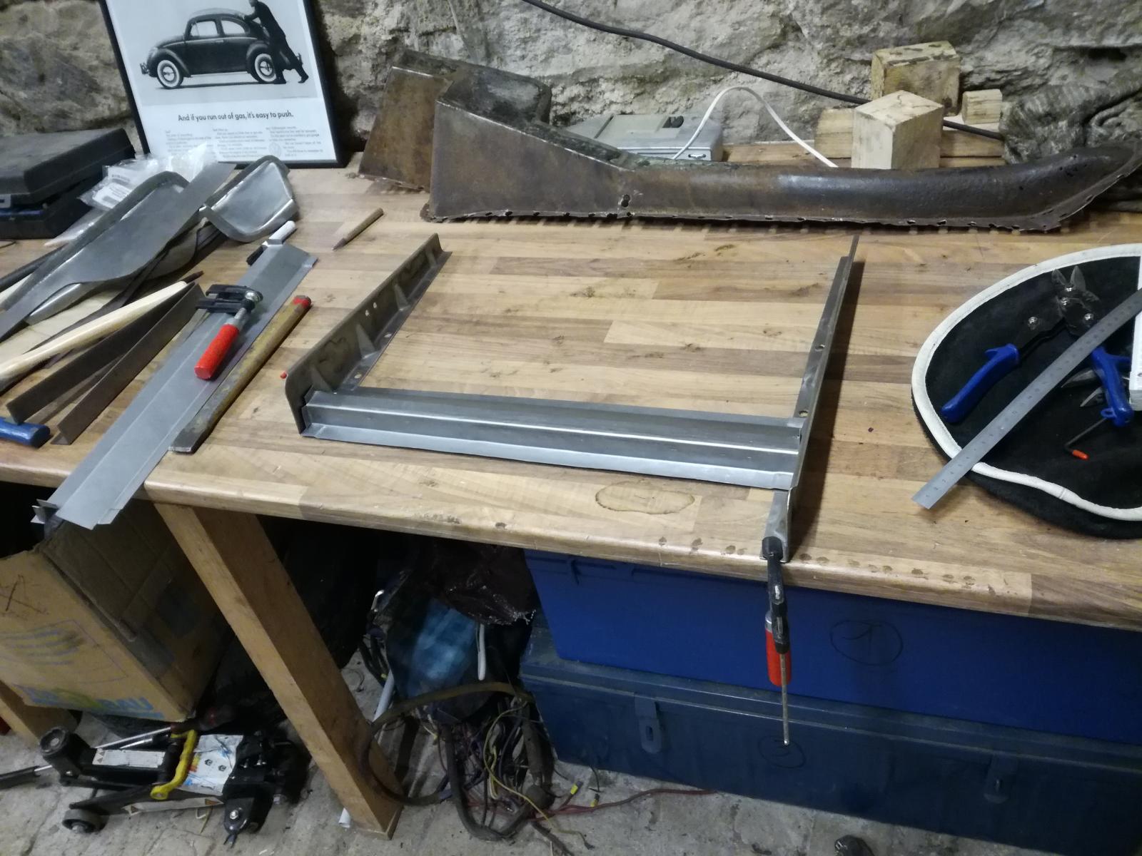

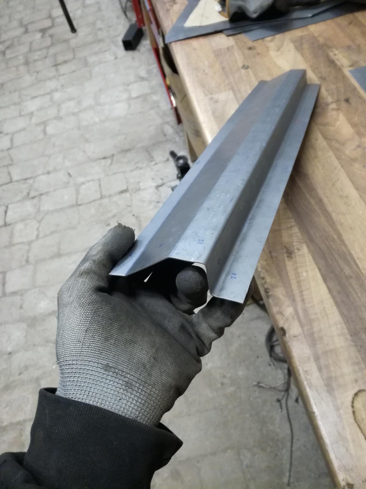

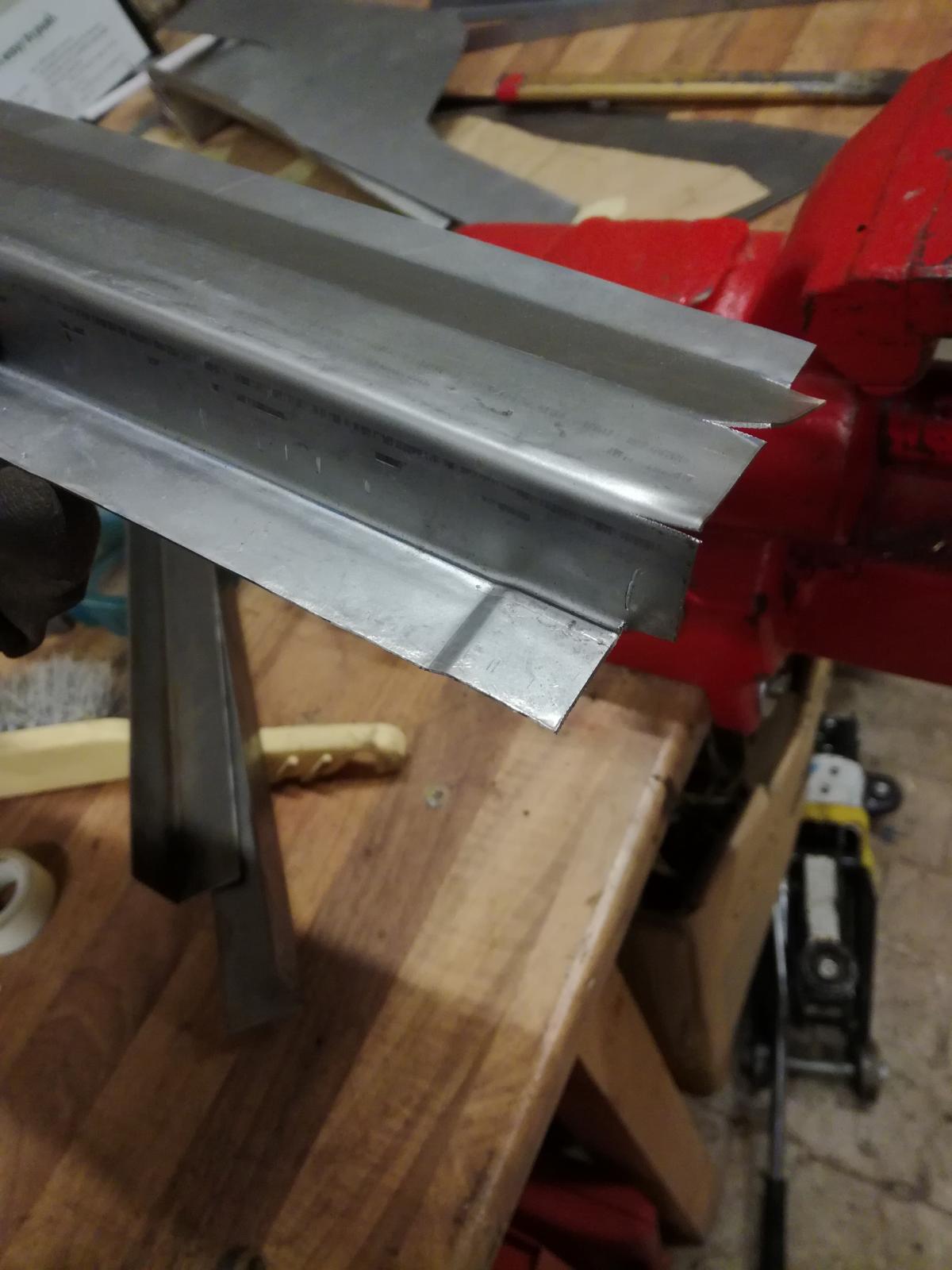

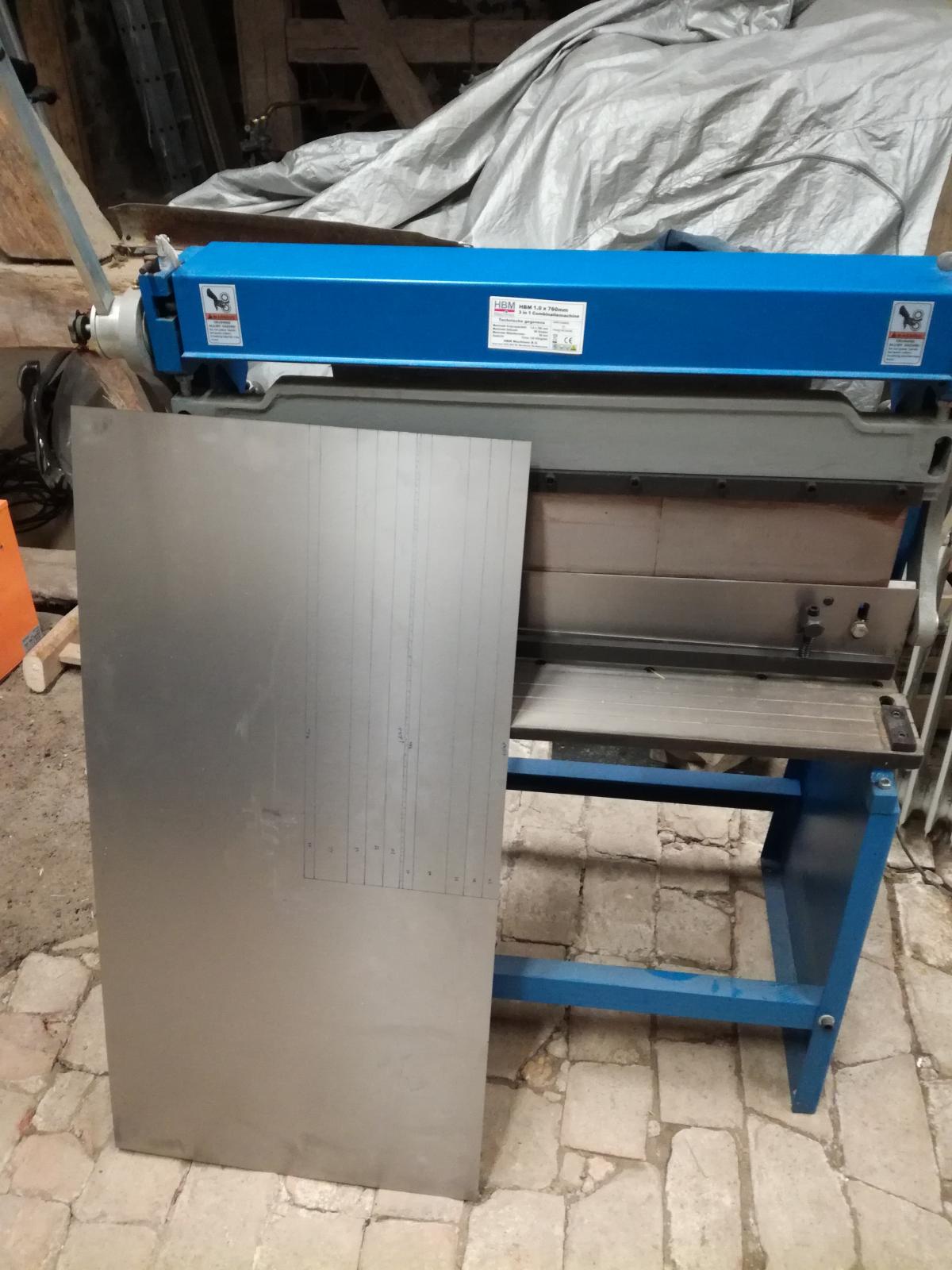

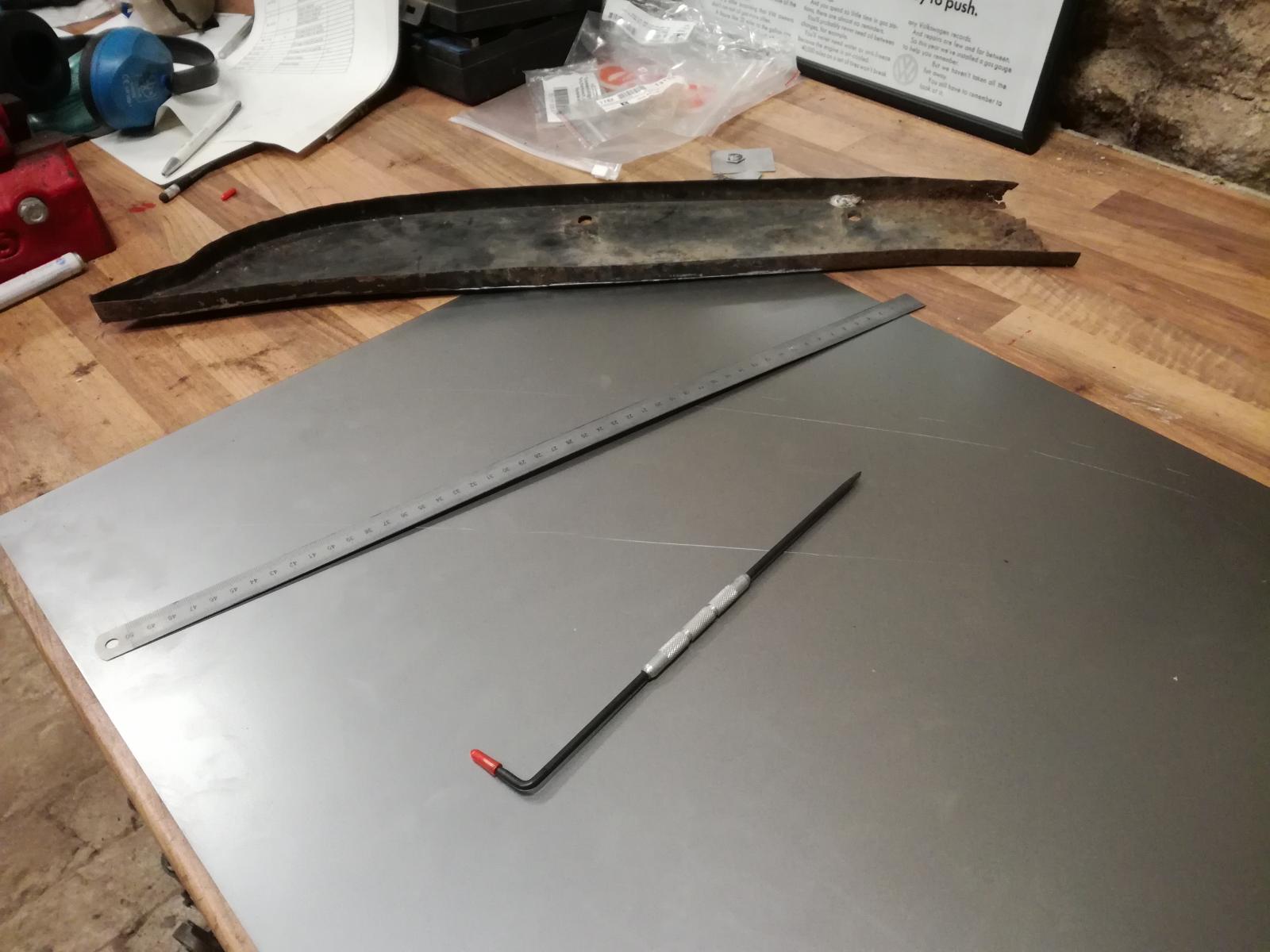

@Jaroslav: well, floor pans are repro parts that needed to, be adjusted/reworked. There were riveted fiberglass pans when I bought it @cliffrod: thanks! Yes, love my barn, it's a protected building due to its historical meaning for the city. It was first build in 1560 and partially reconstructed in 1719 after a small "earthquake" that means I cannot do everything I want to it but on the other side, what a nice place to work on my toys!! I will try to make some pictures to show it better to you! @Onorius: thanks a lot. Yes, not a sports car but I love its design and all the details of it So, finally found some time to upload more picture..means it’s time for an update! Let’s make one update now So, except one, I have all seat rails but not the central part between the rails.. So I had to build it Let’s first trace it: And it’s time for the build: Bent: Let’s not forget the end that needs to go on the rails: Checking: Ready to be welded: Stay tuned, several updates will come in a short time to bring you to the actual status! Antoine

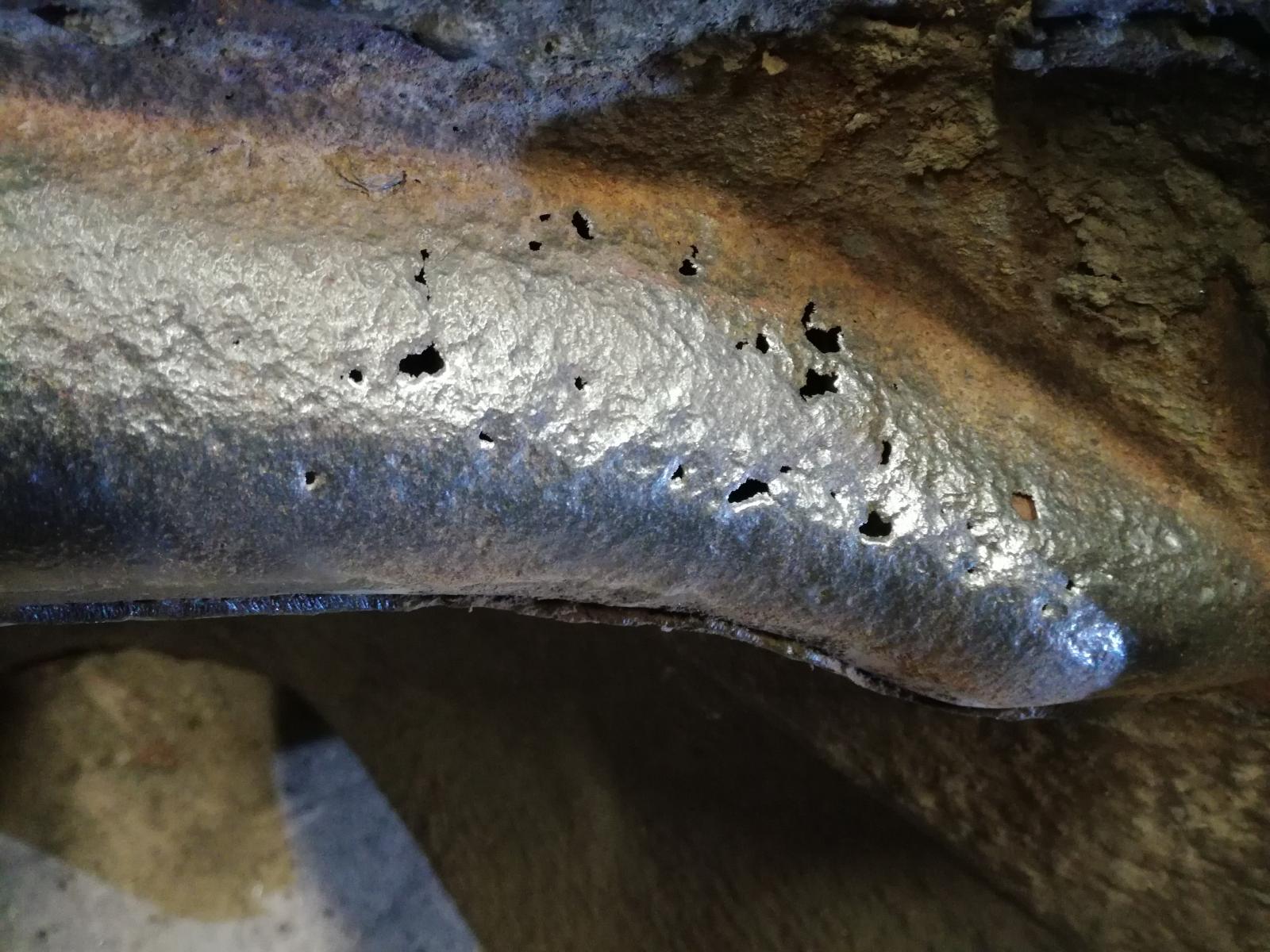

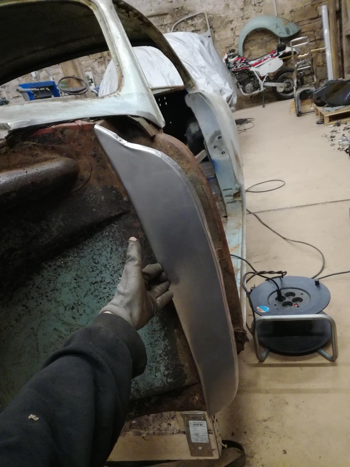

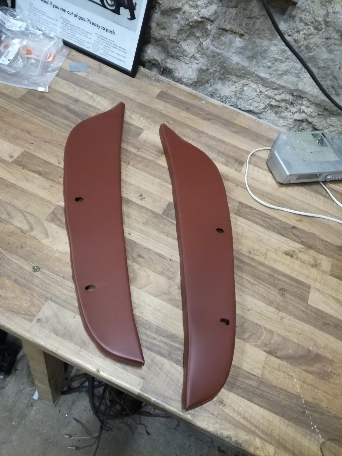

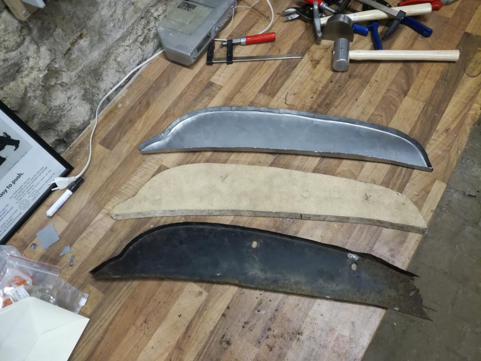

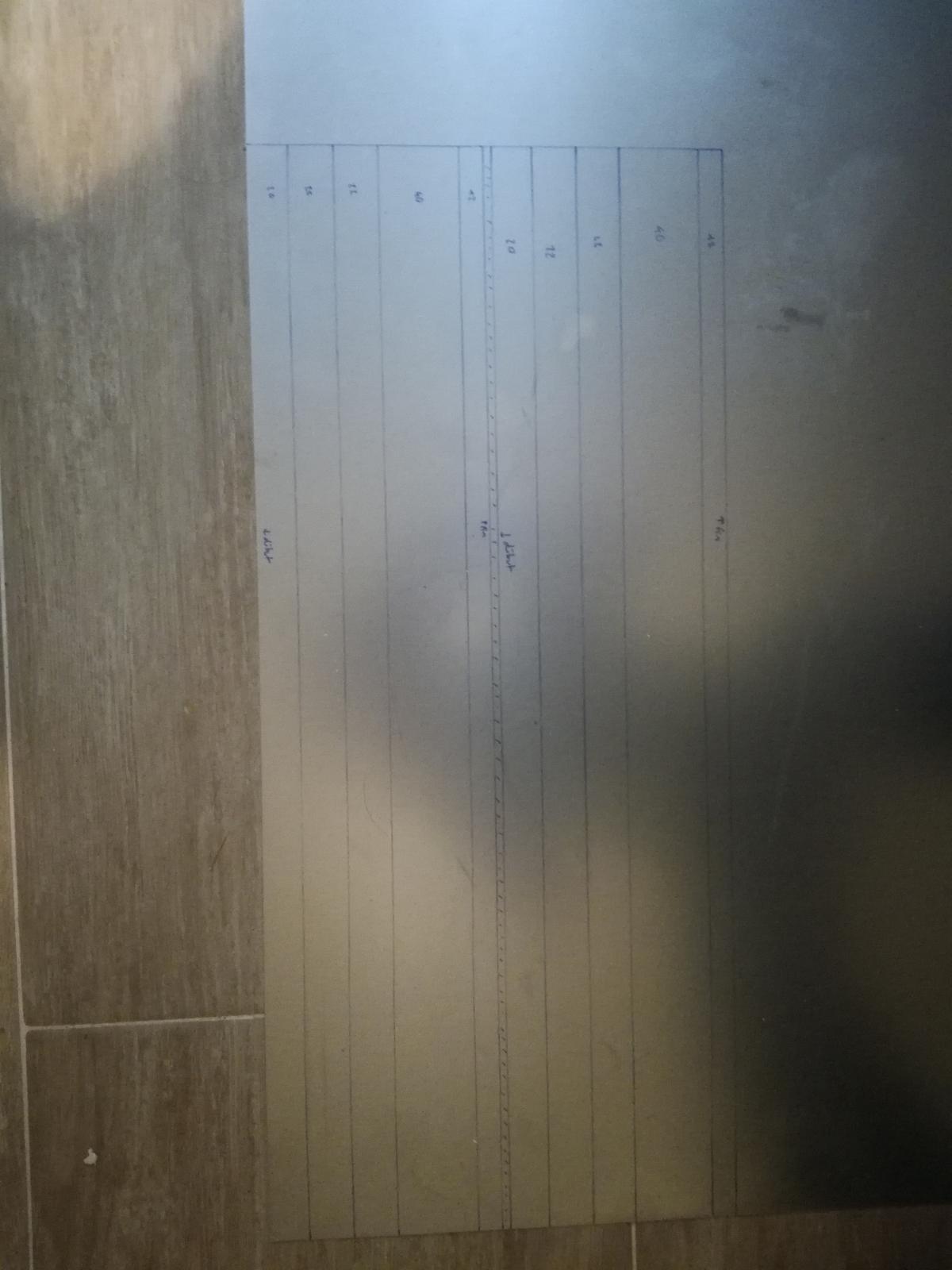

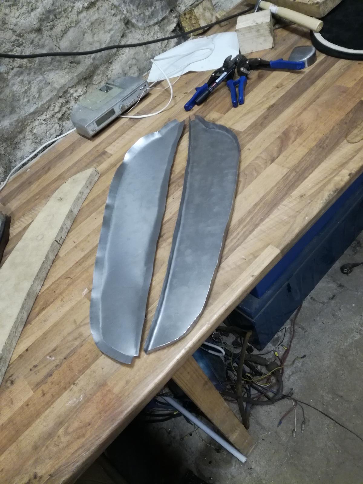

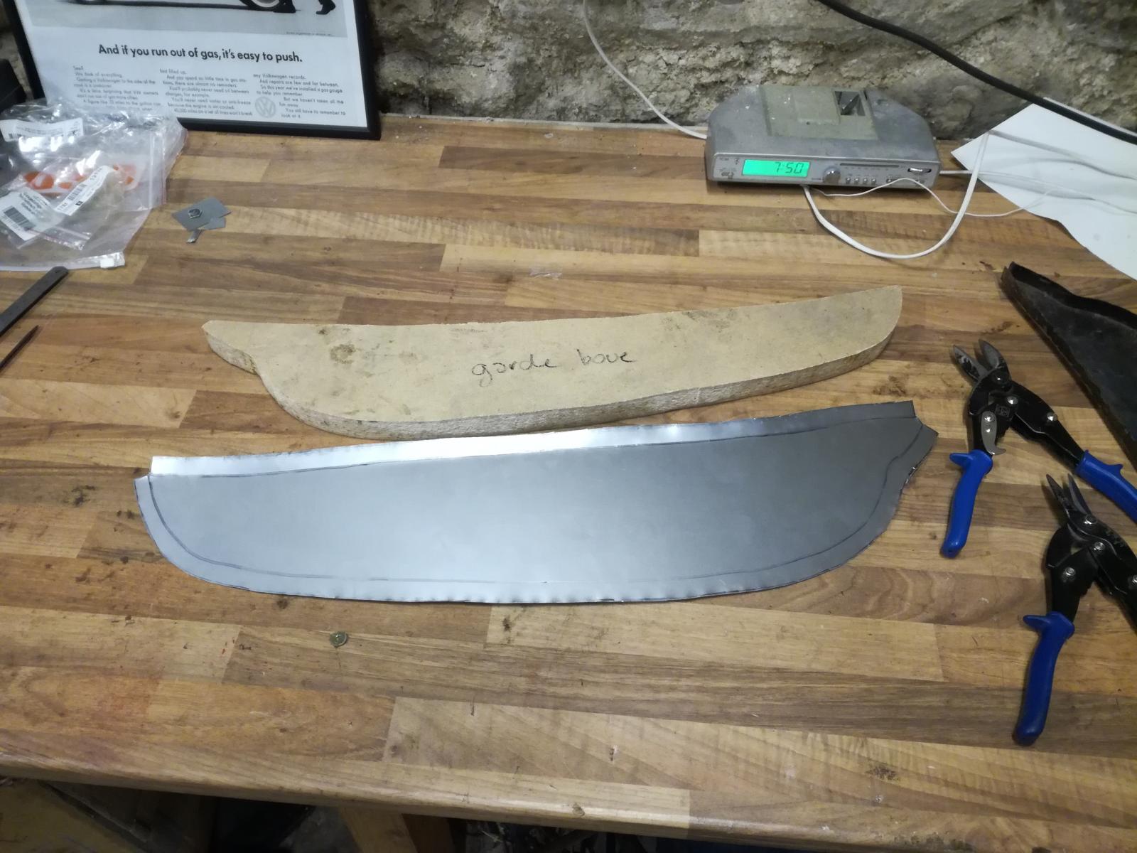

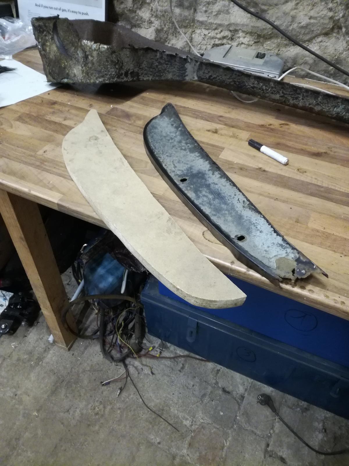

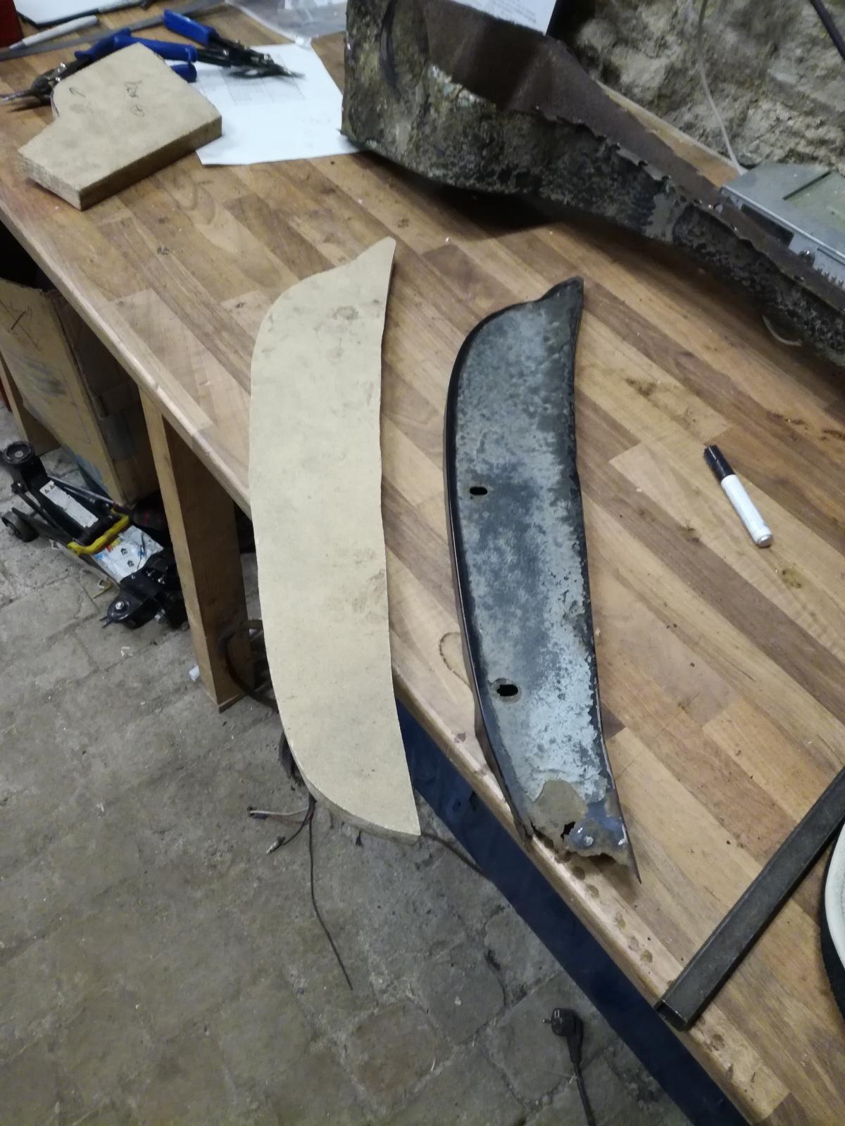

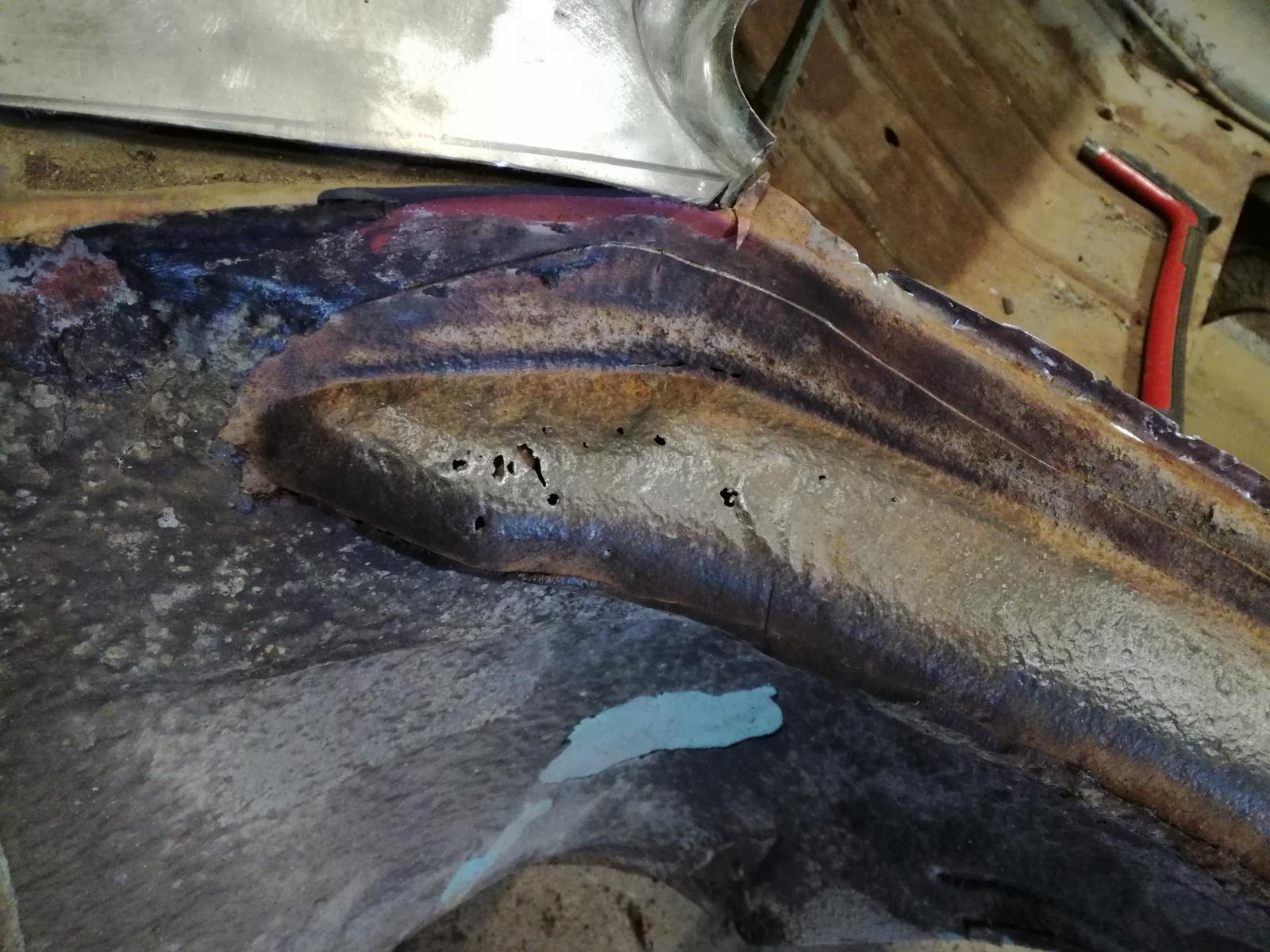

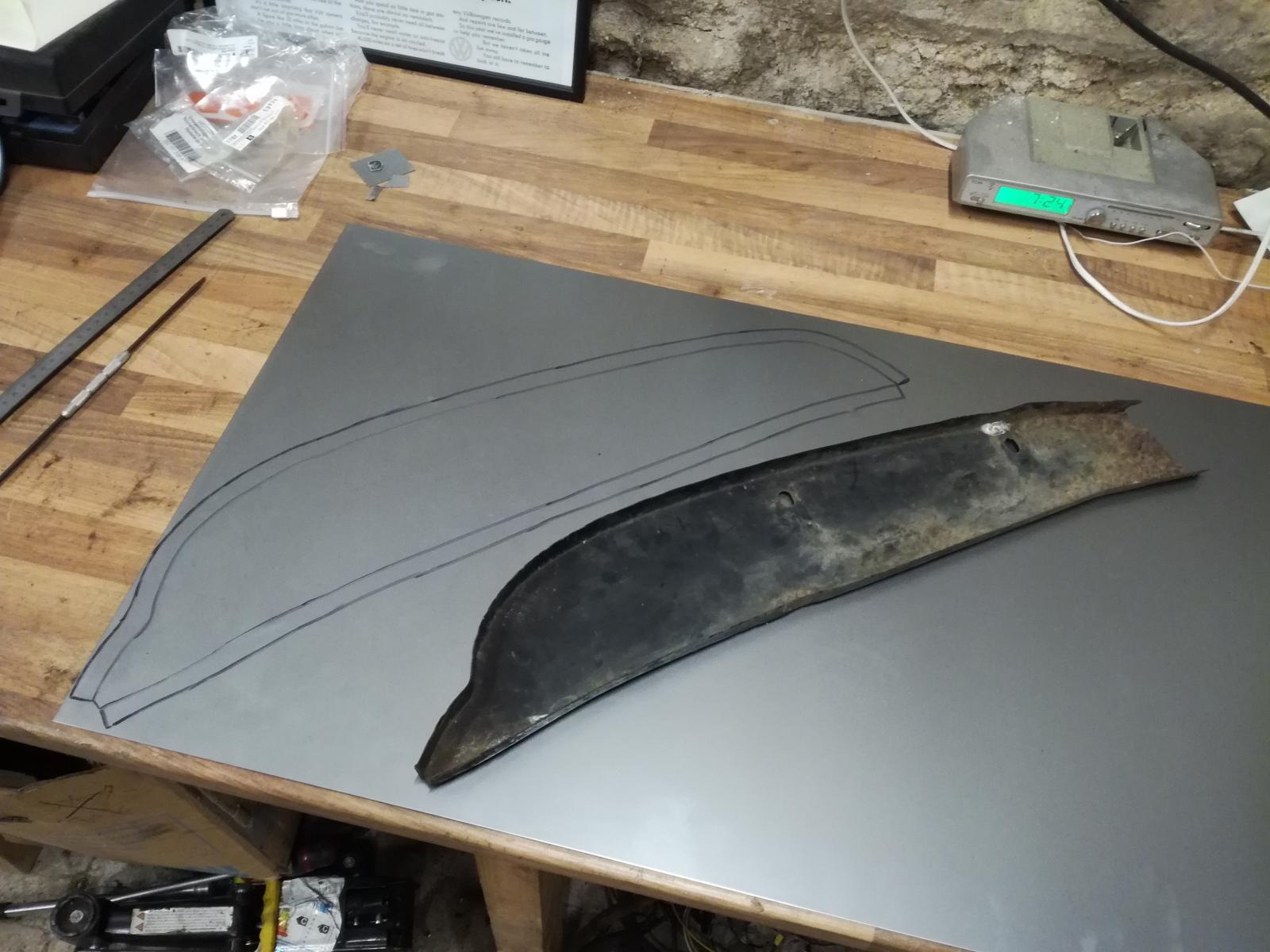

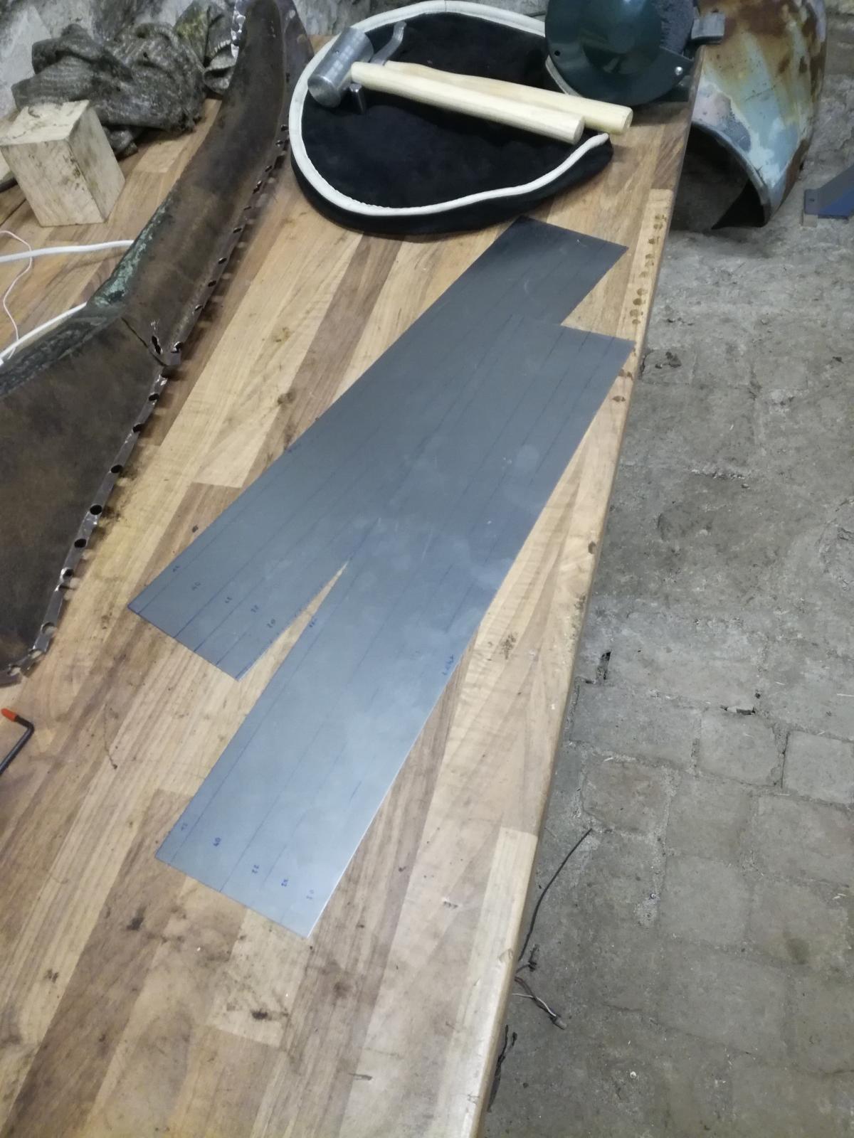

Well, here comes the next update I know you can buy the splash guards but: I want to learn more and I try to keep this project on a reasonable budget so I built mine.. As usual, first is the drawing: Then I build myself a hammerform out of wood: Ready to cut: cut and I started to bend the sides using my bead roller: and then it's time for the hammerform: and after some hammering, some shrinker/stretcher action,... I have it: Fitment check: and it's time for the second side: check: and after making the holes, all in primer: 8) Just to give you an idea of the condition of my ghia..this felt down just by moving the body: Stay tuned Antoine
