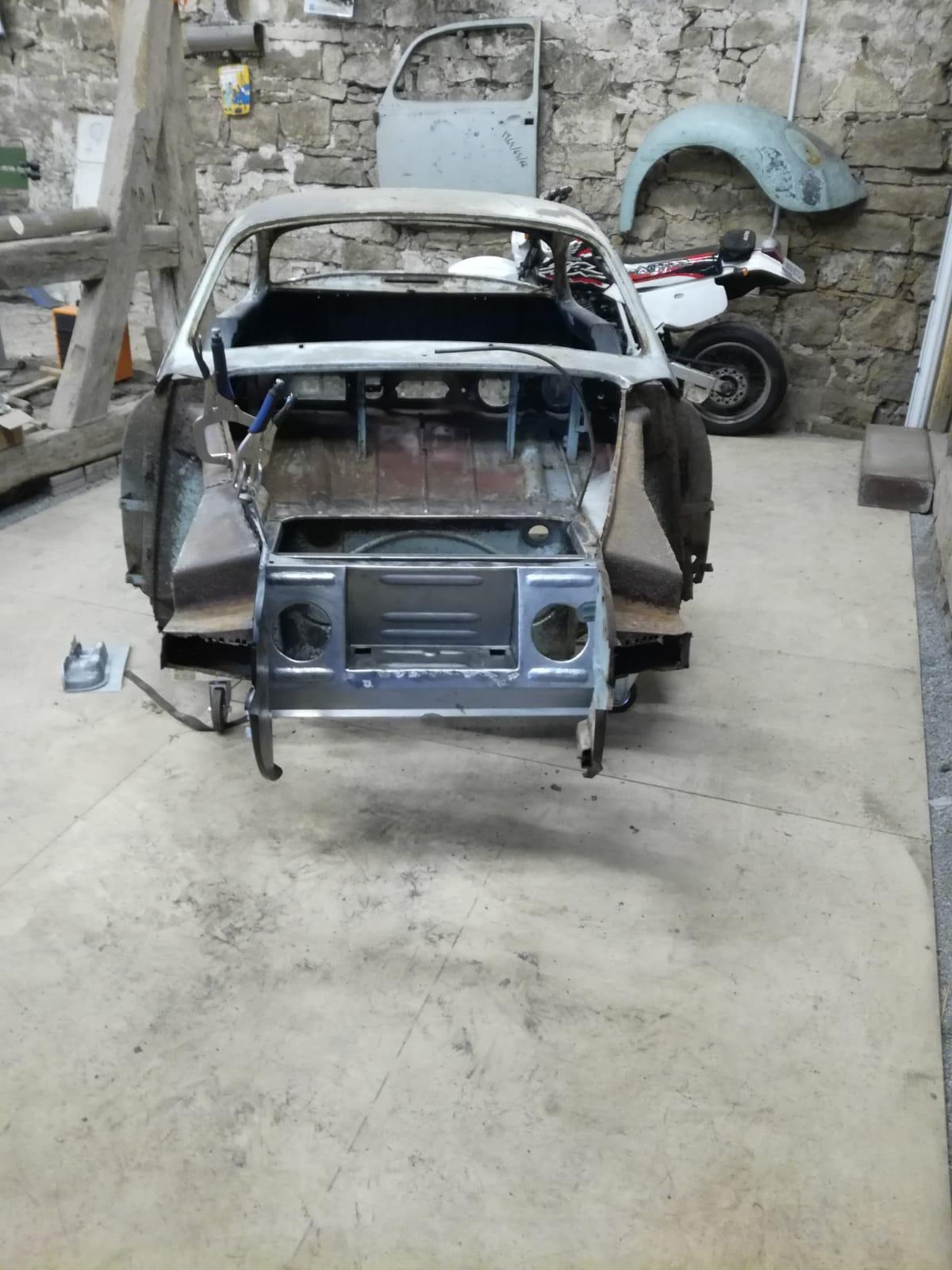

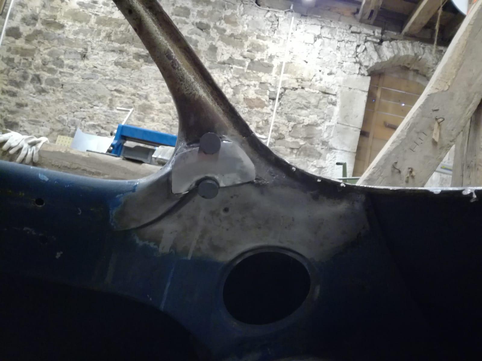

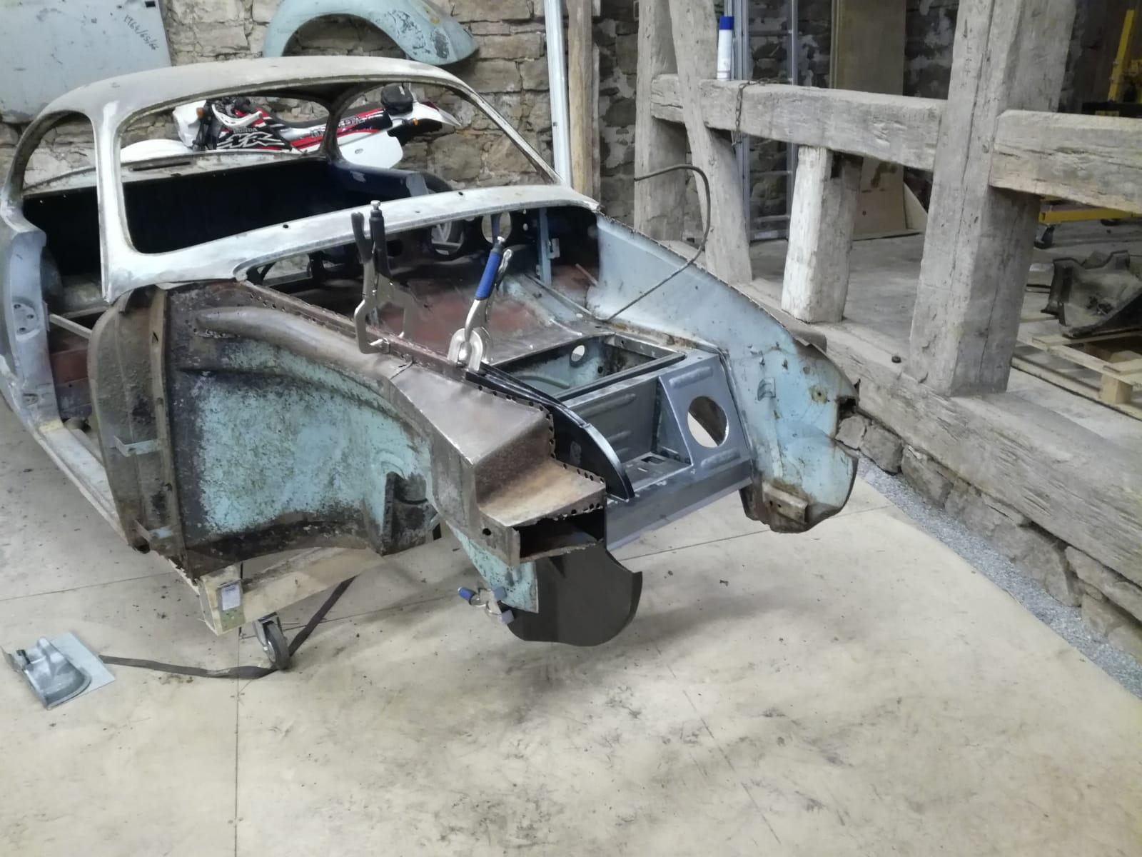

So, little update

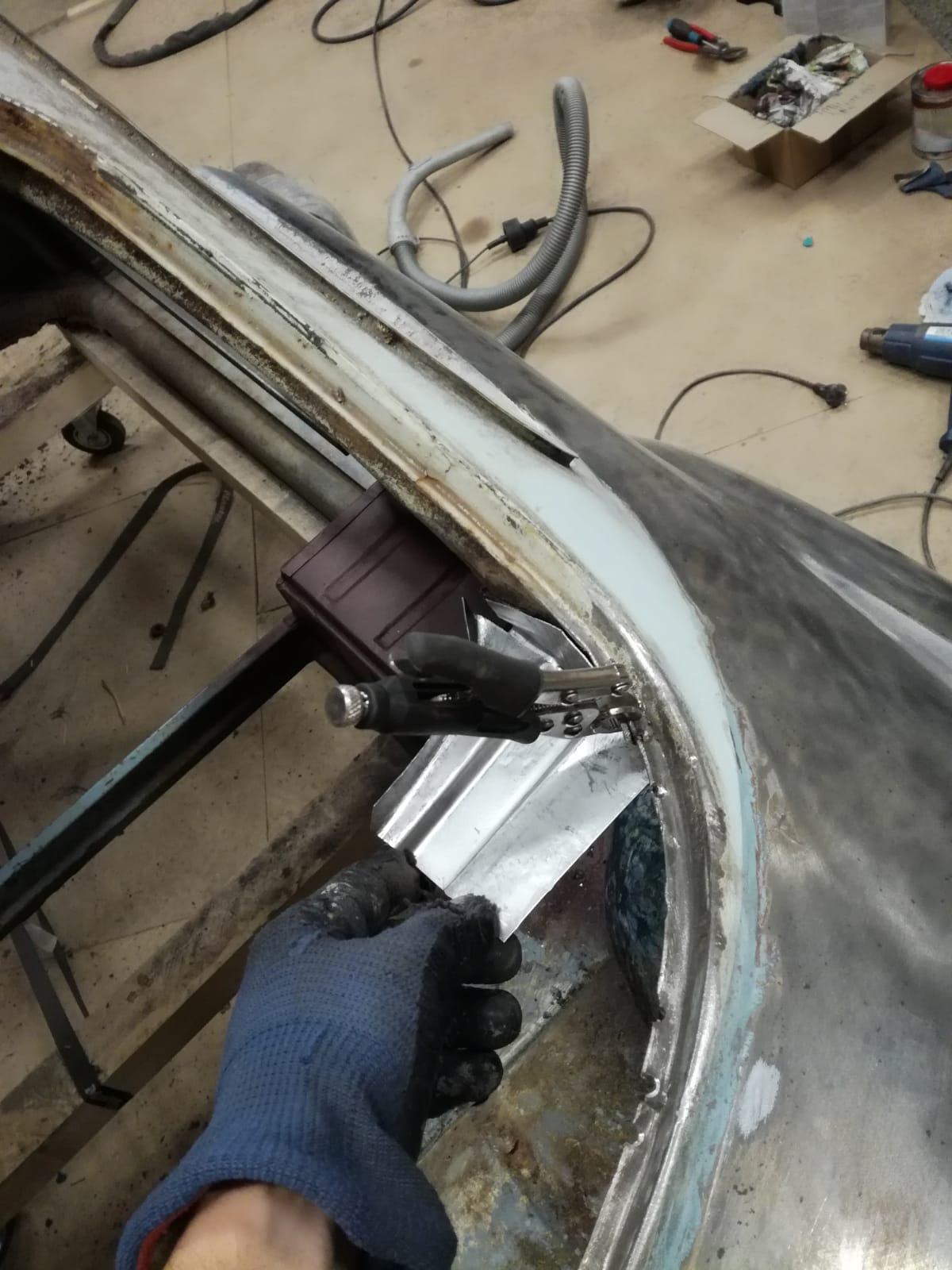

I made some trial adjusting and it looks good:
And with the old air channel that will help to position everything right. Of course in the end I will weld my homemade ones!
But before all the welding I will bring it all to bare metal and in primer :wink:

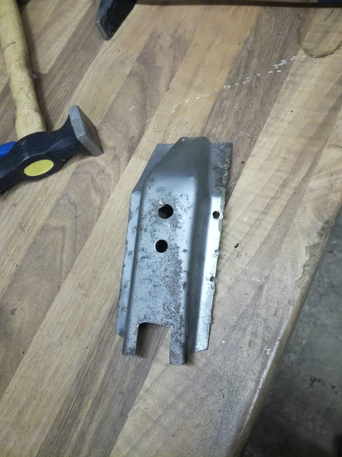

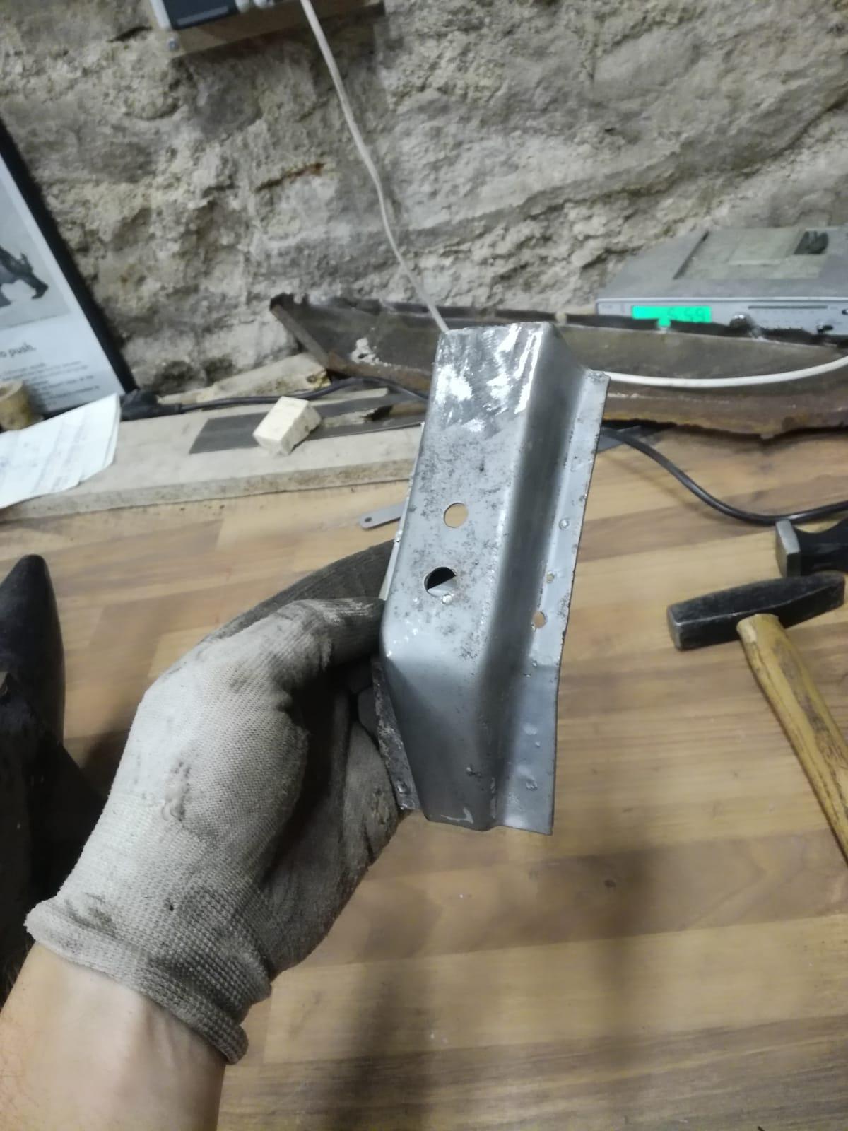

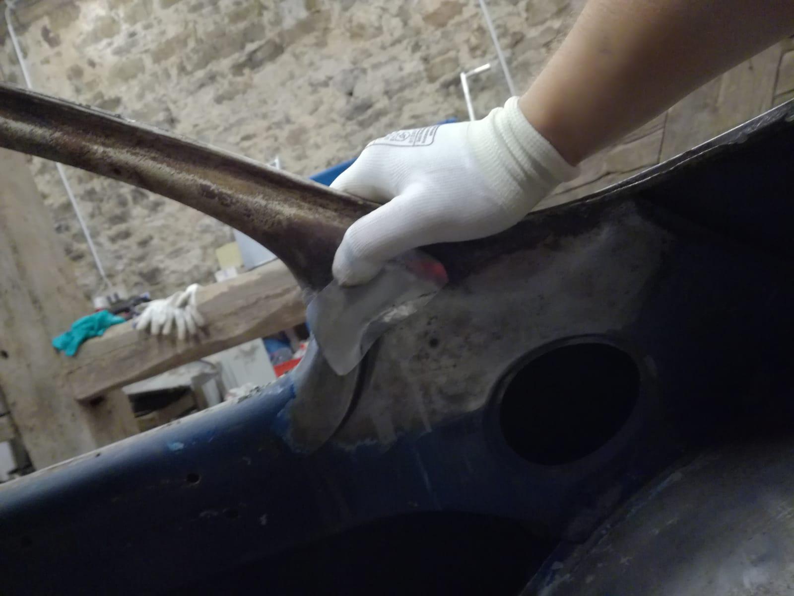

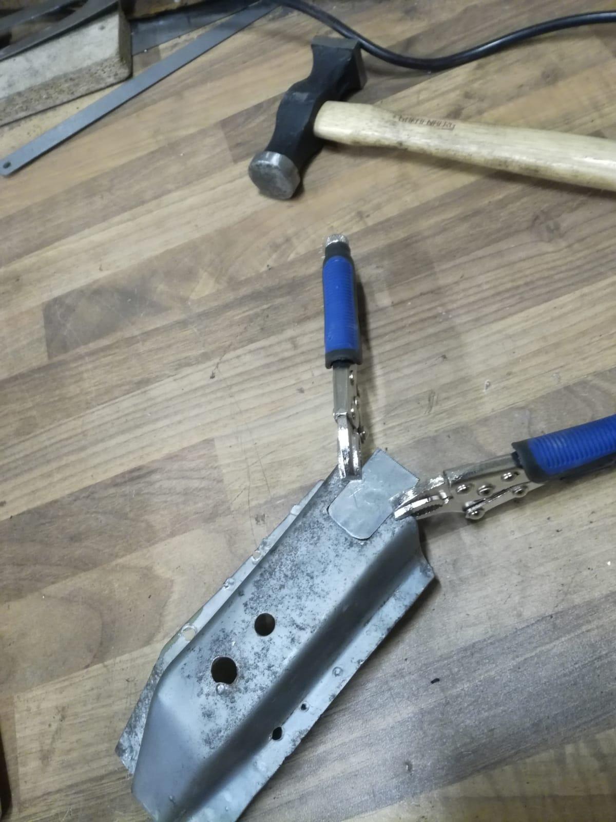

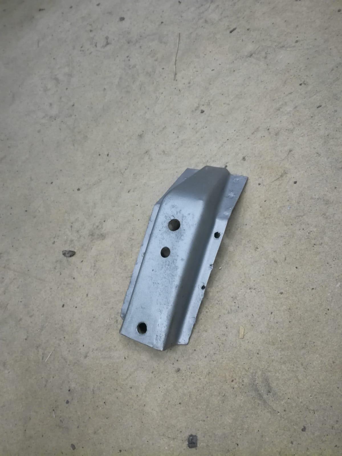

While playing with the front part,I also decided to save the original bumper bracket:
Stay tuned for more

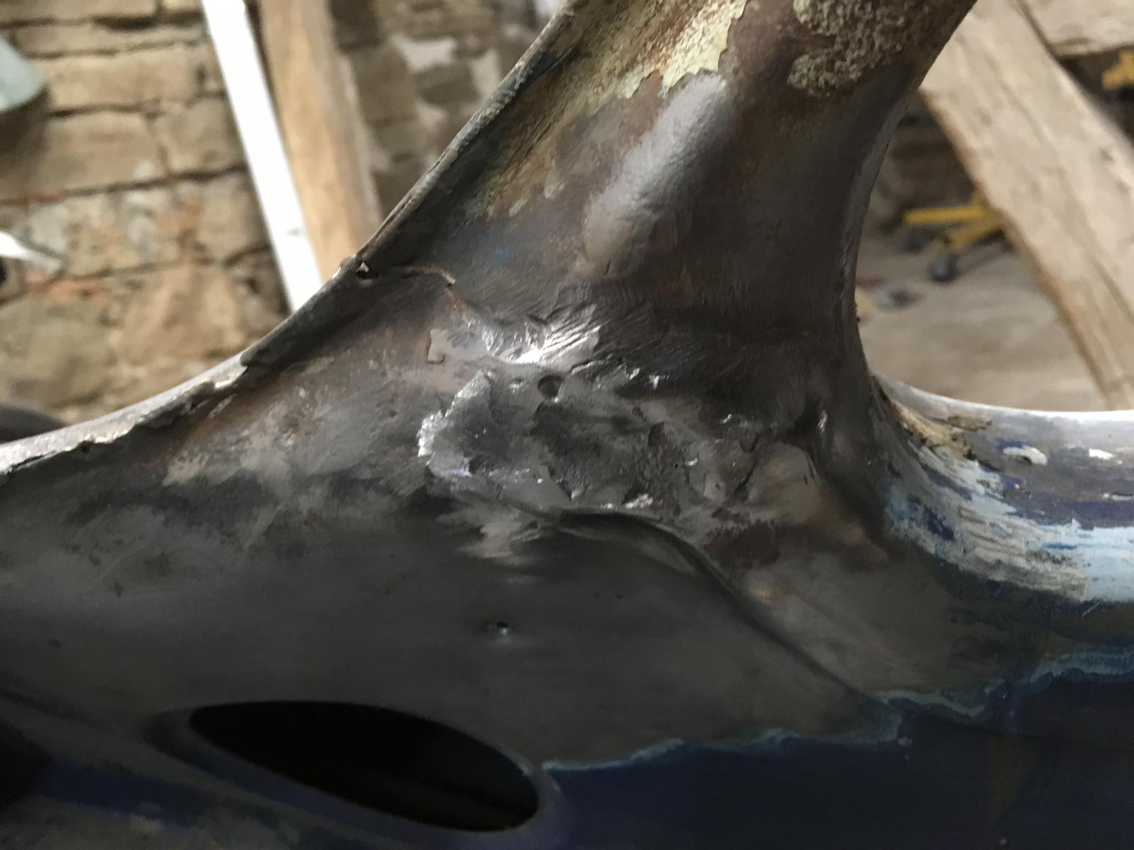

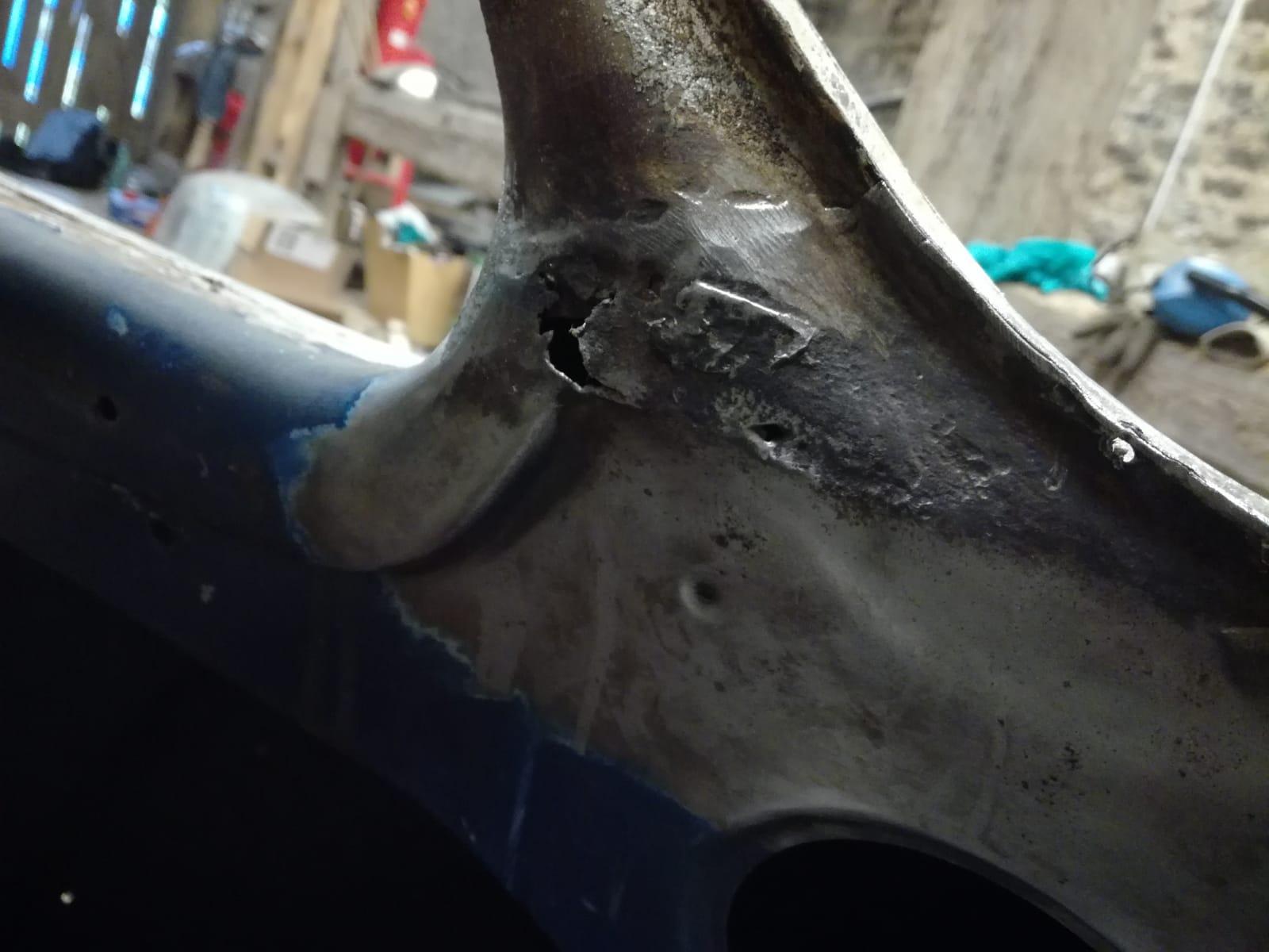

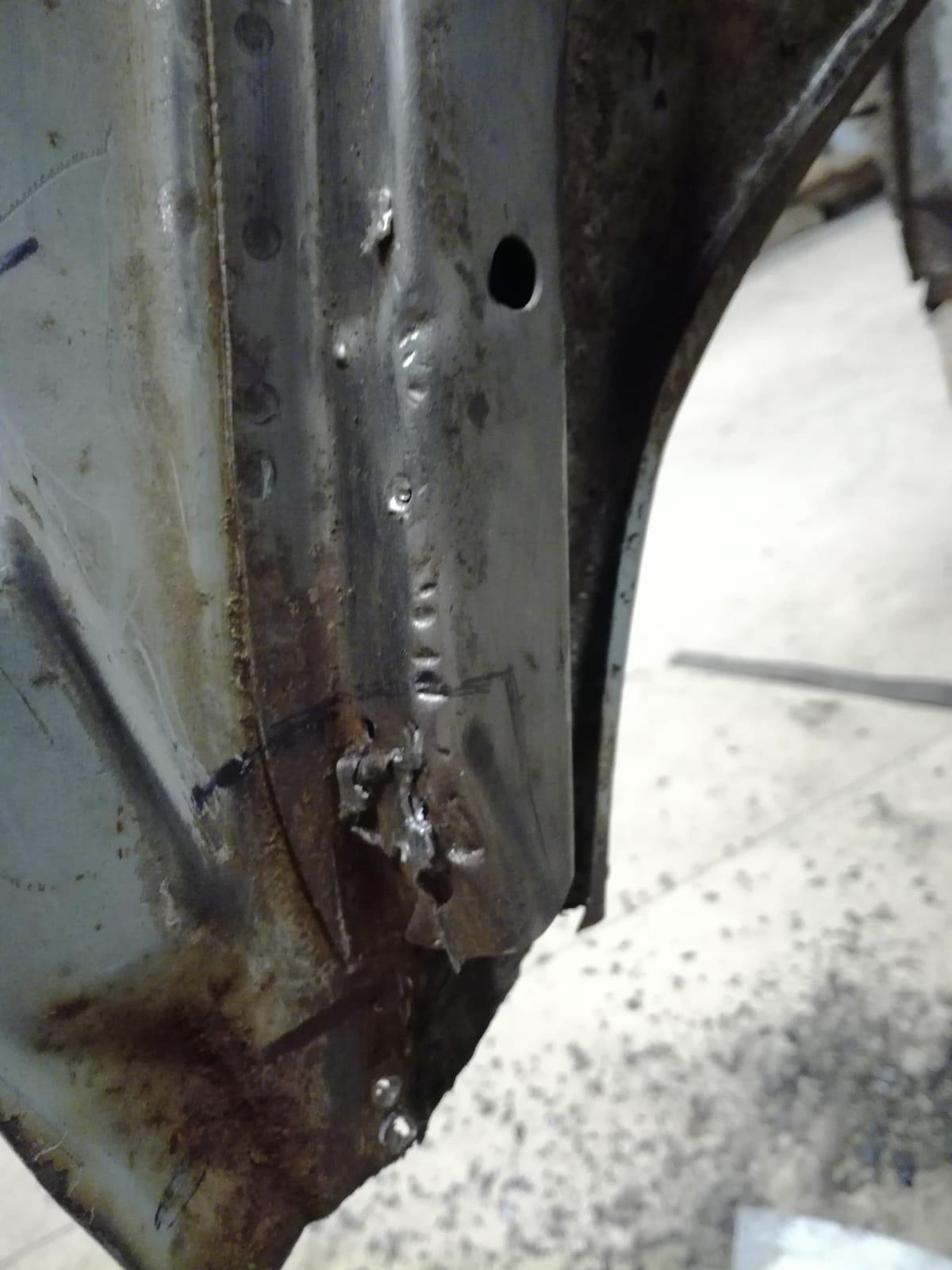

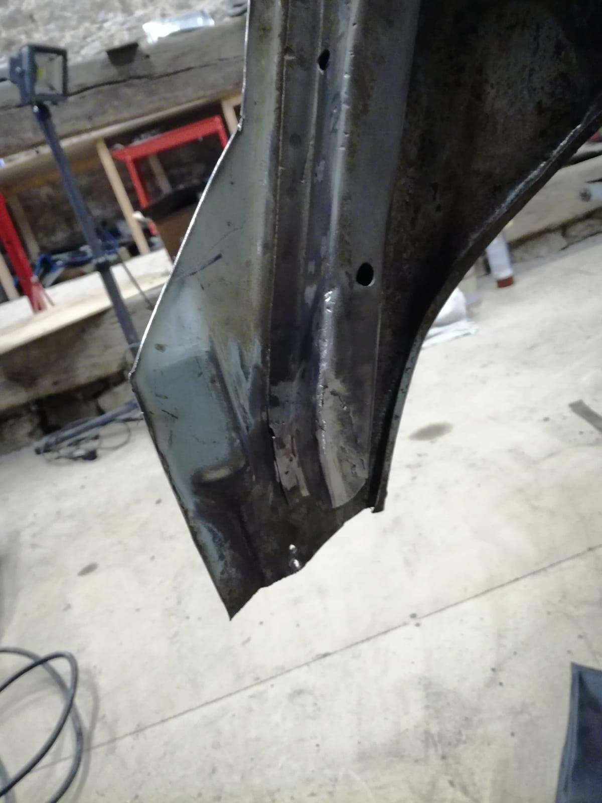

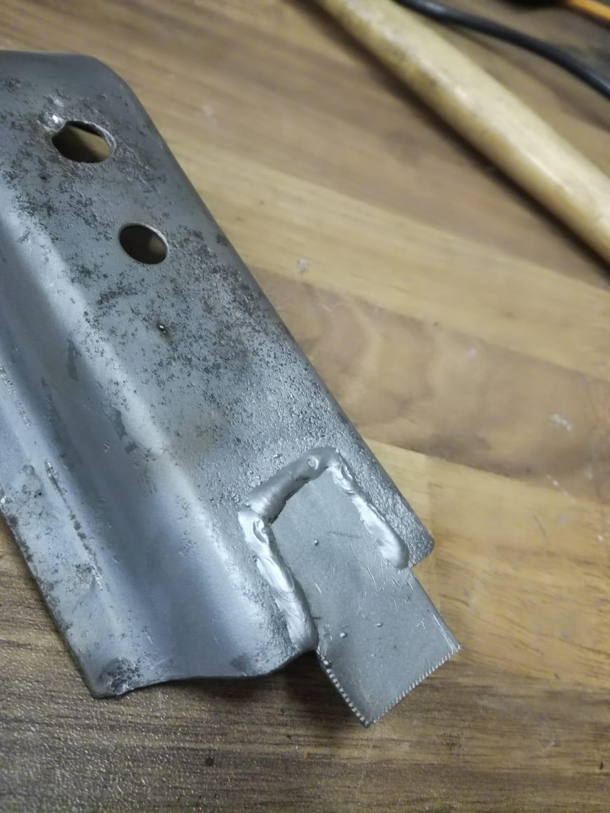

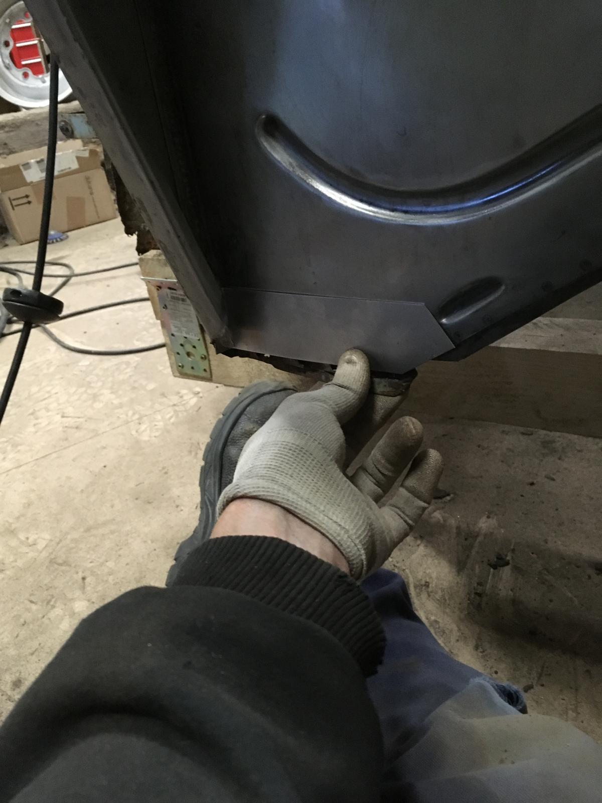

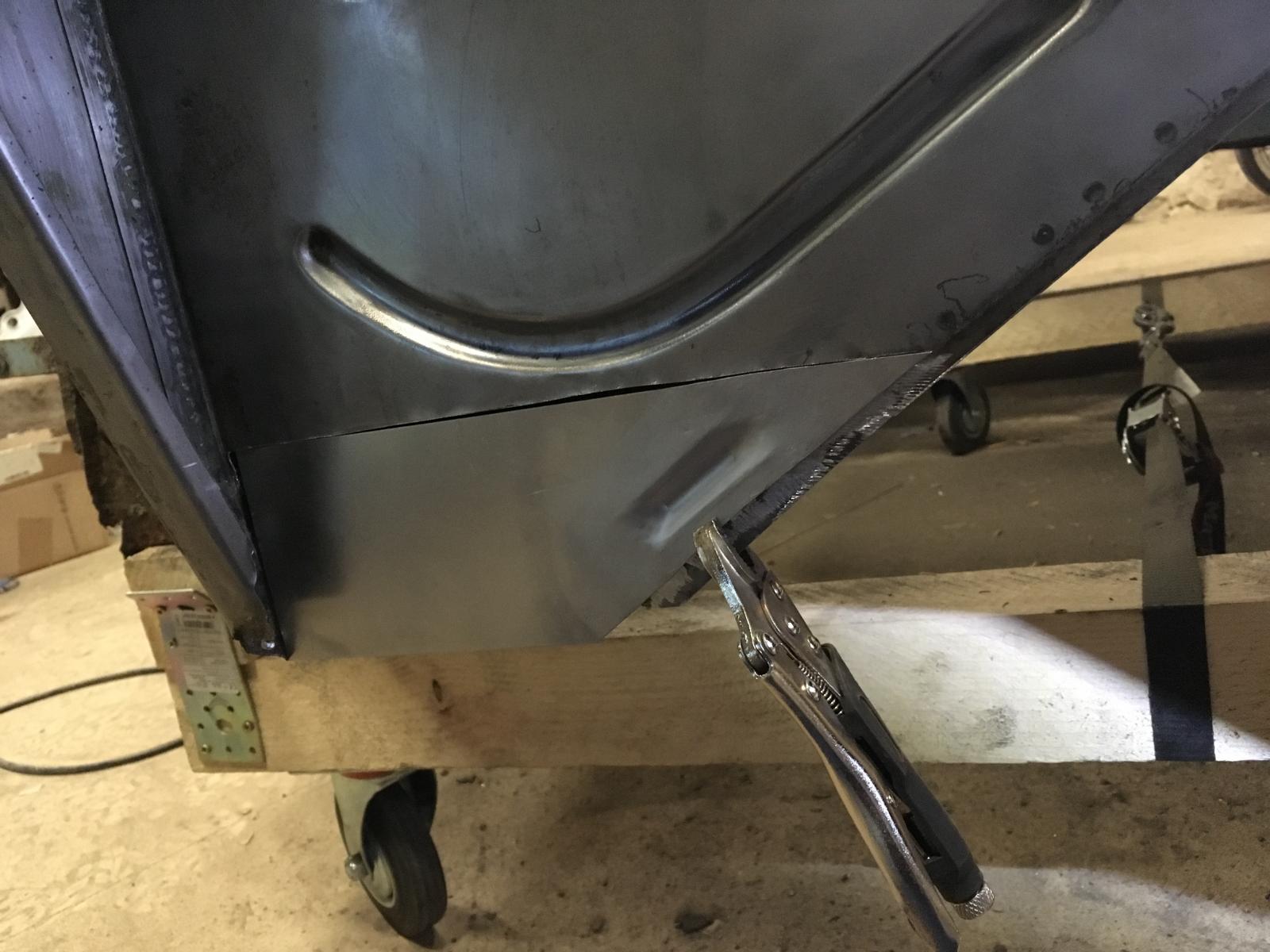

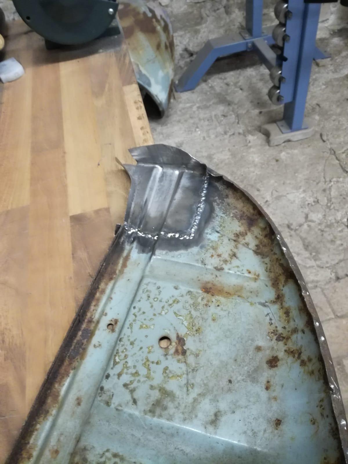

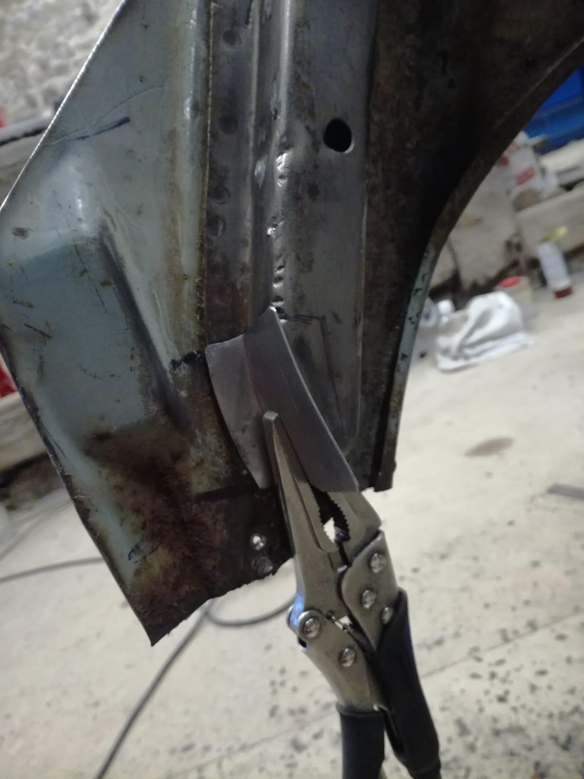

So,in the process of cleaning and preparing to weld my front part, I had to fix a few parts on the way.
Like here on the driver‘s side:
Made a patch:
And welded, grinded, along with few other holes above it:

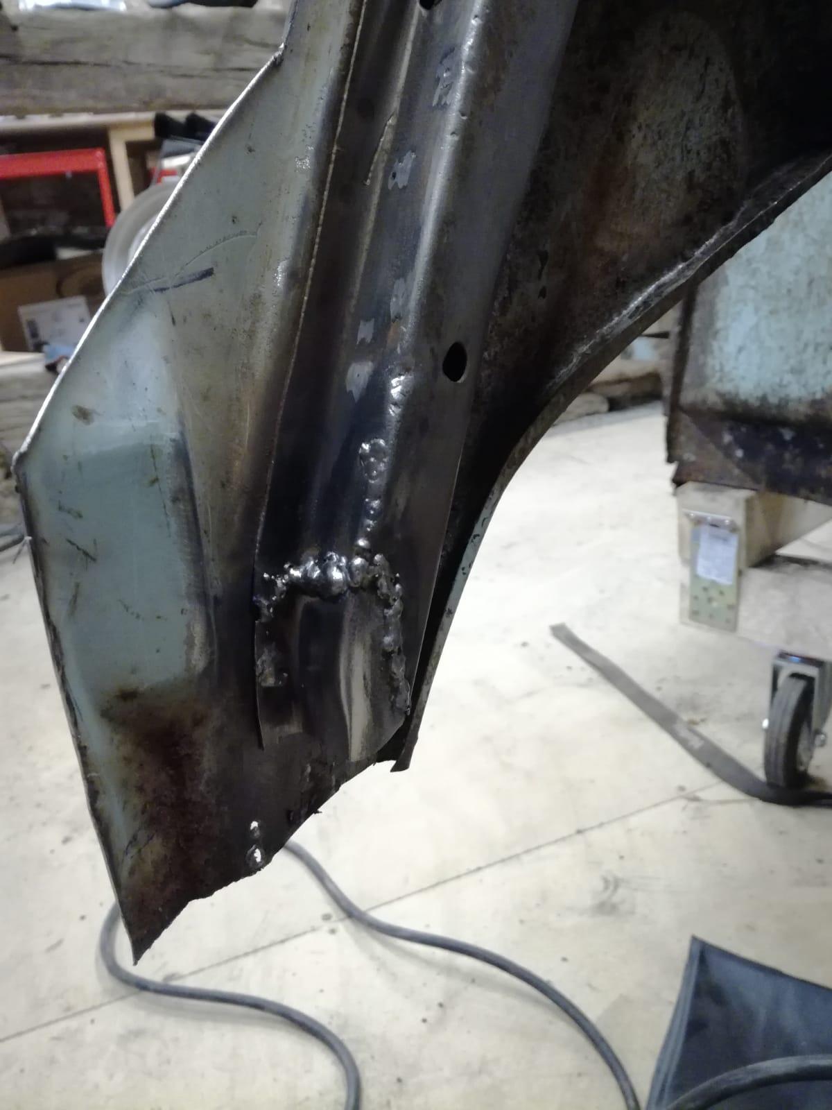

And the same on the other side:
Before:
During:
And After:

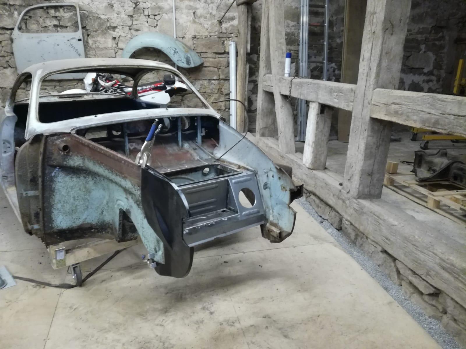

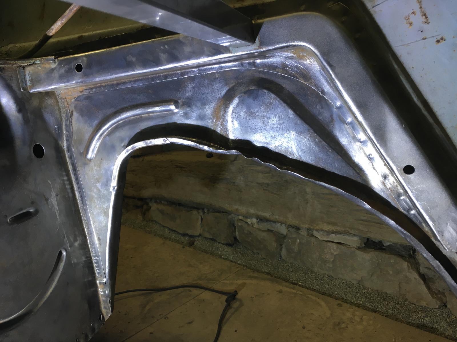

So, as I was progressing on the front, I continued with cleaning it to bare metal:
[img]https://www.thesamba.com/vw/gallery/pix/1929652.jpg[/
The driver‘s side was a bit damaged:
So I put it back to shape:

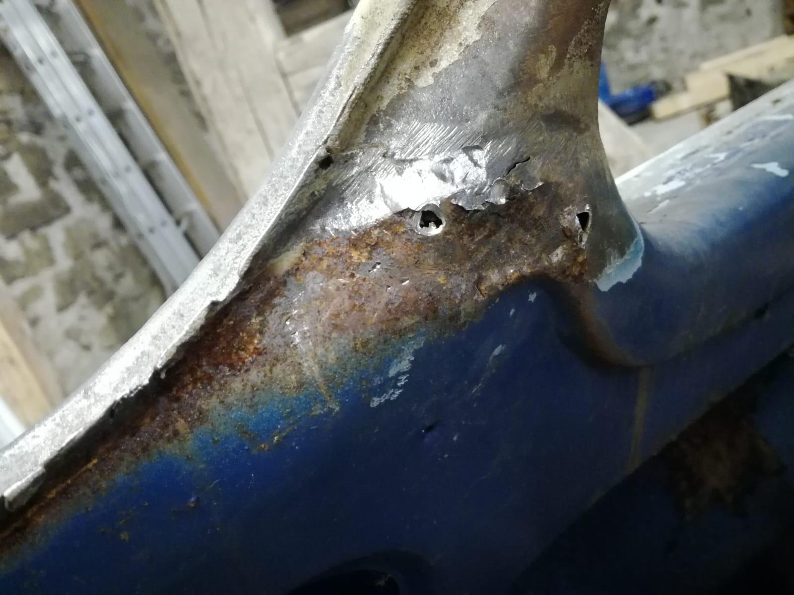

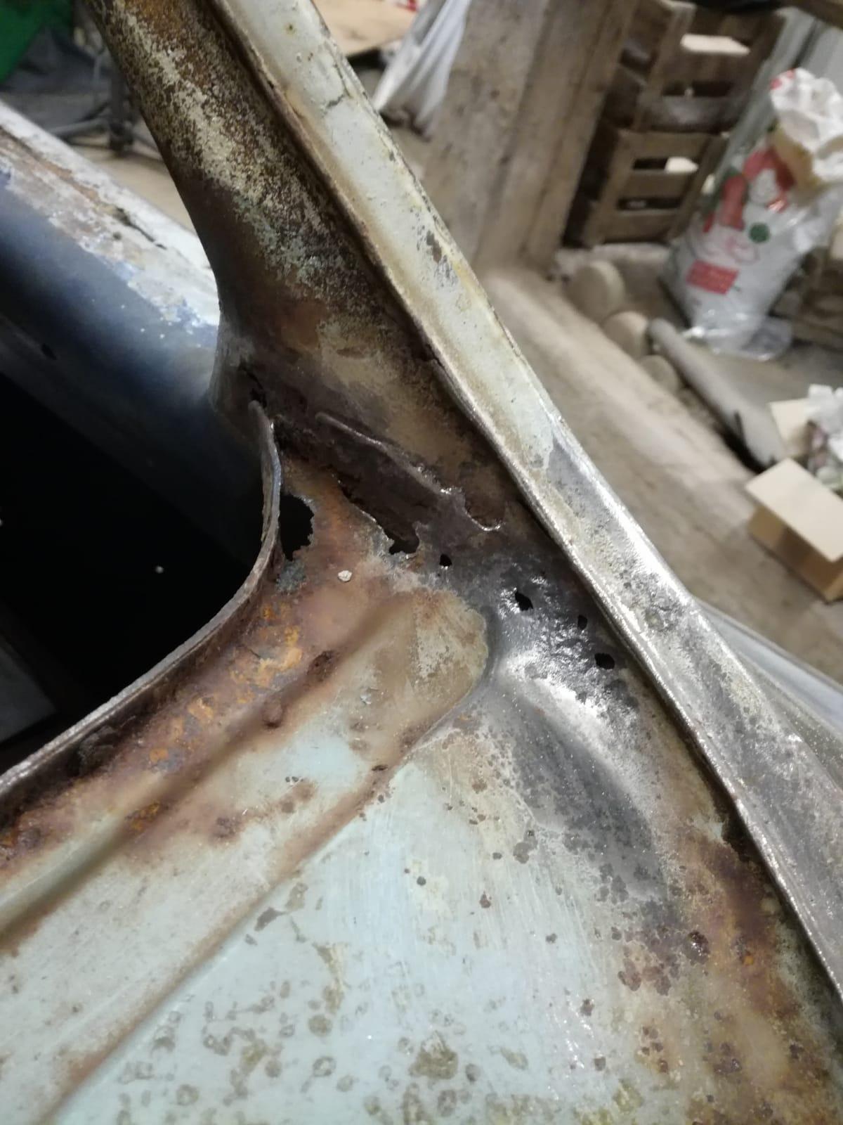

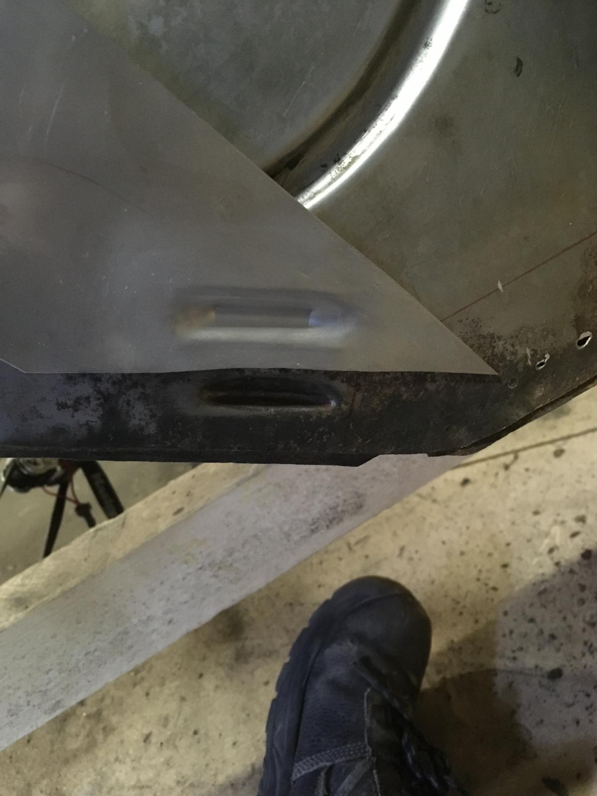

Also found as usual some rust issues:

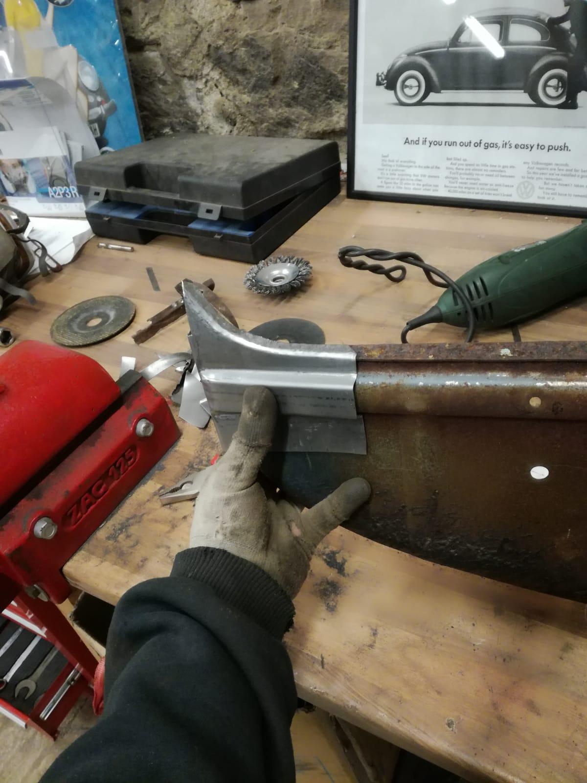

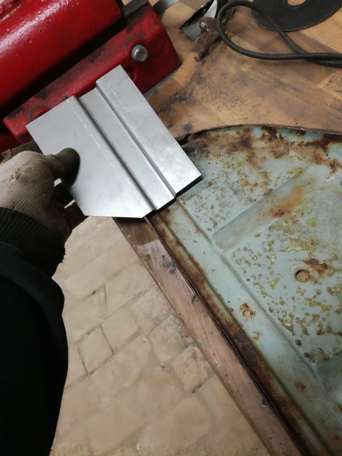

Thought I can go with a small patch:
But as usual, it wasn‘t nice after opening:
So I had to open more until there are only surface rust to see:

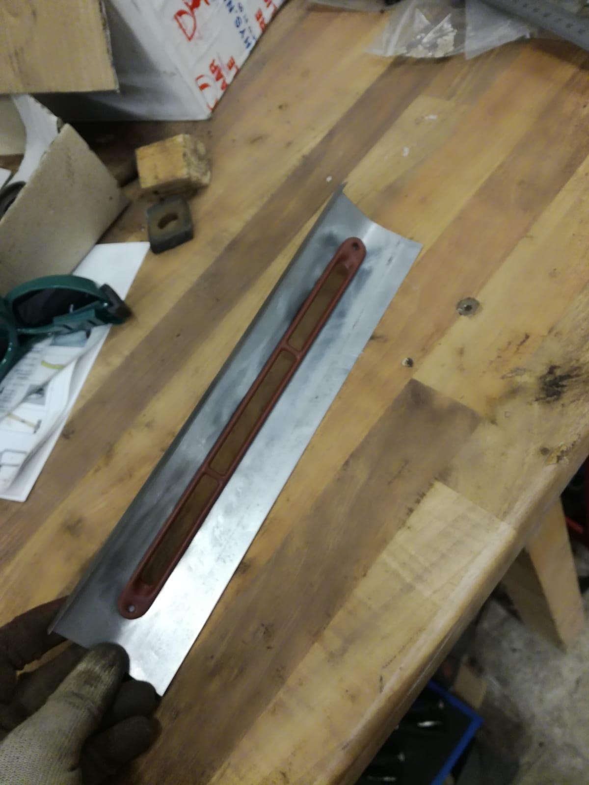

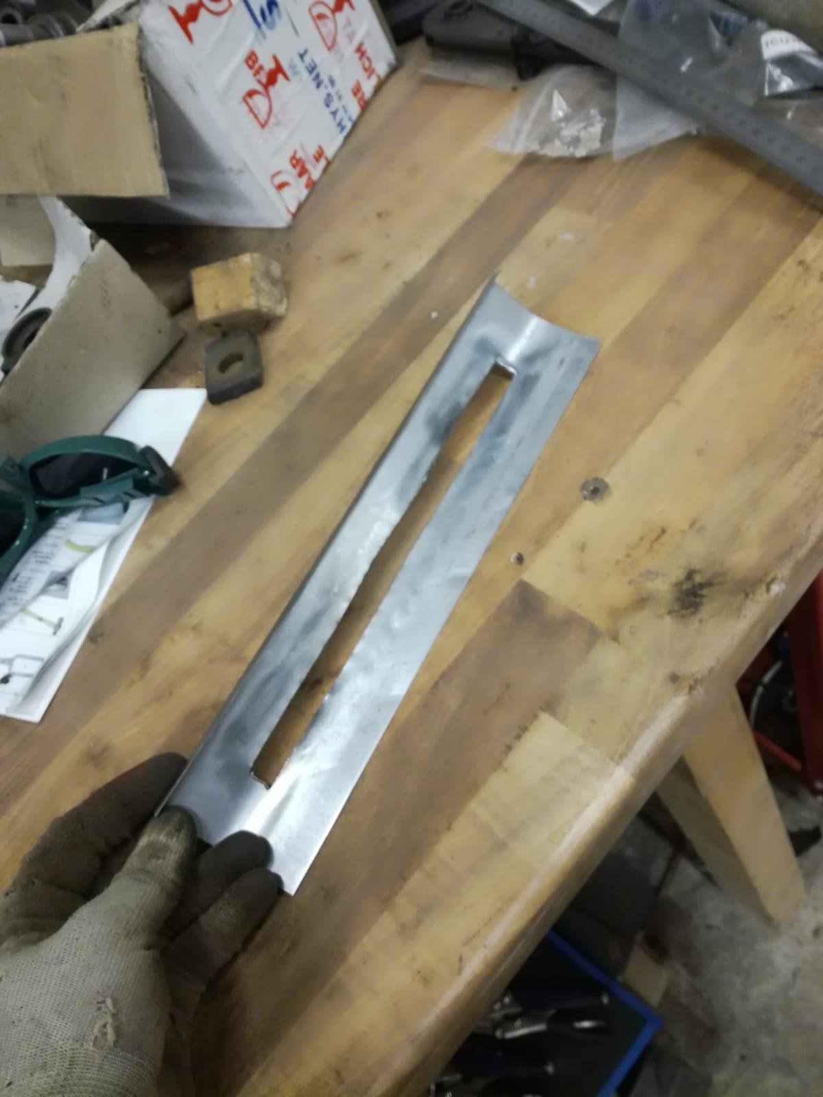

A new patch including the indent had to be created:
Checking the indent:
Adjusted:
I will be welding it after replacing the rest behind, when I will be replacing the heater channel. In the mean time I progressed on the back of the ghia, stay tuned for more

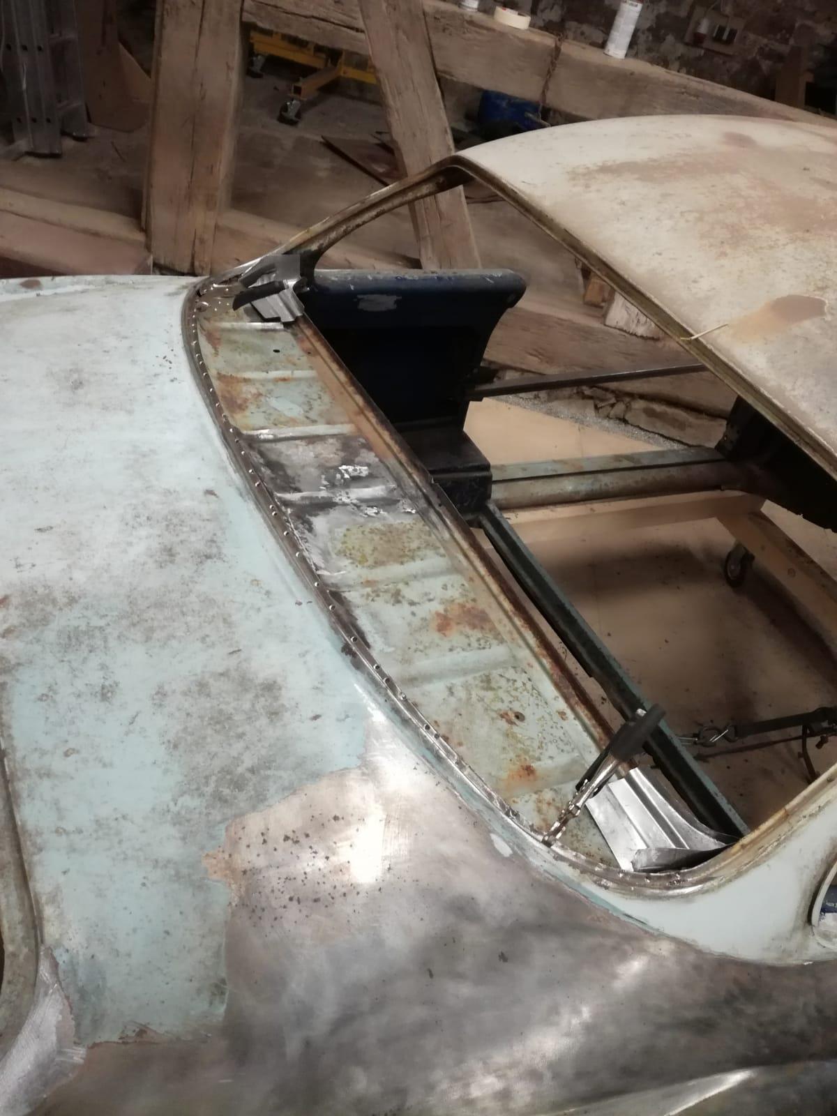

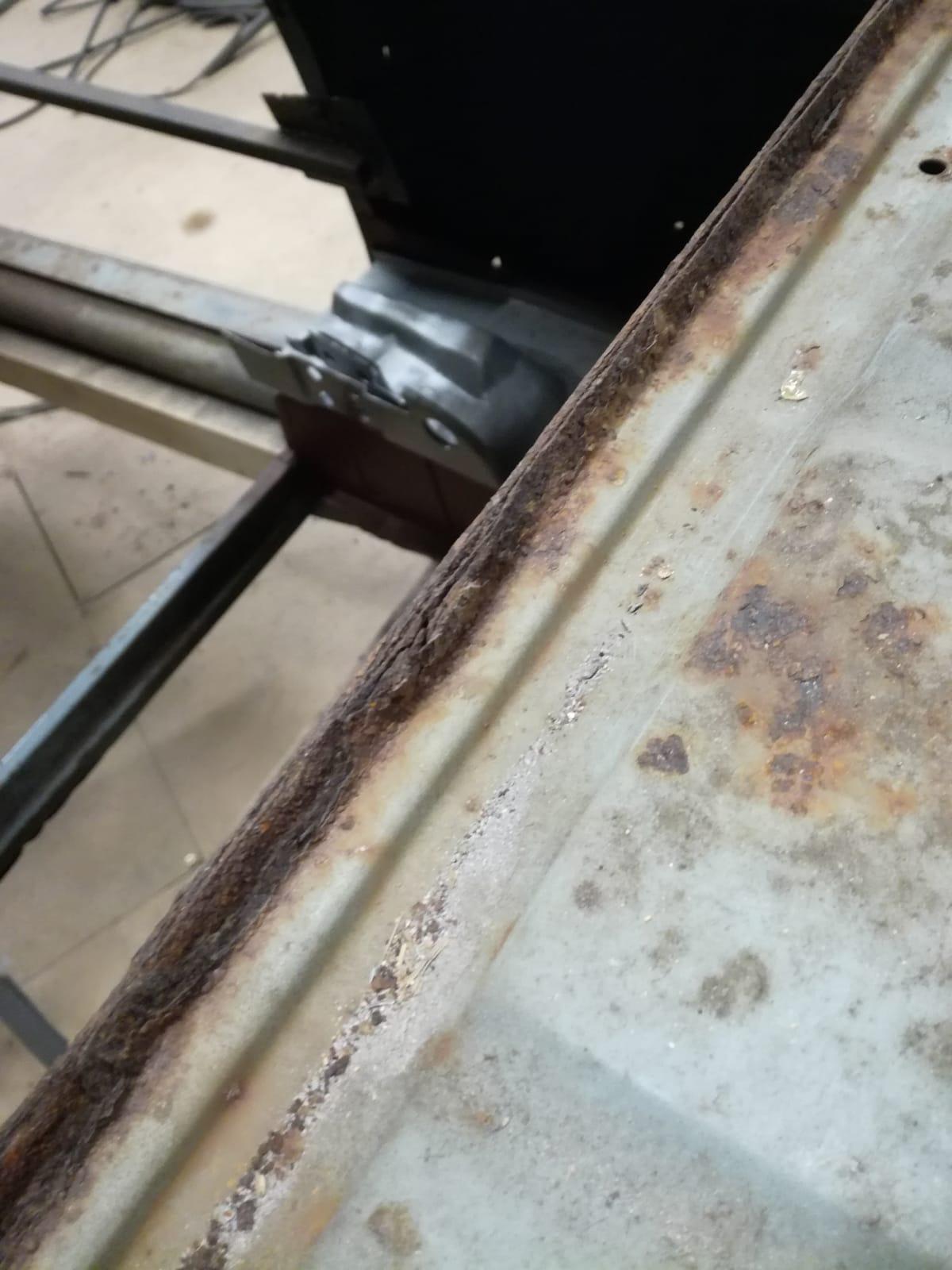

So, I think the next update is really overdue!
As mentioned before, I turned my attention a bit to the back of the car..

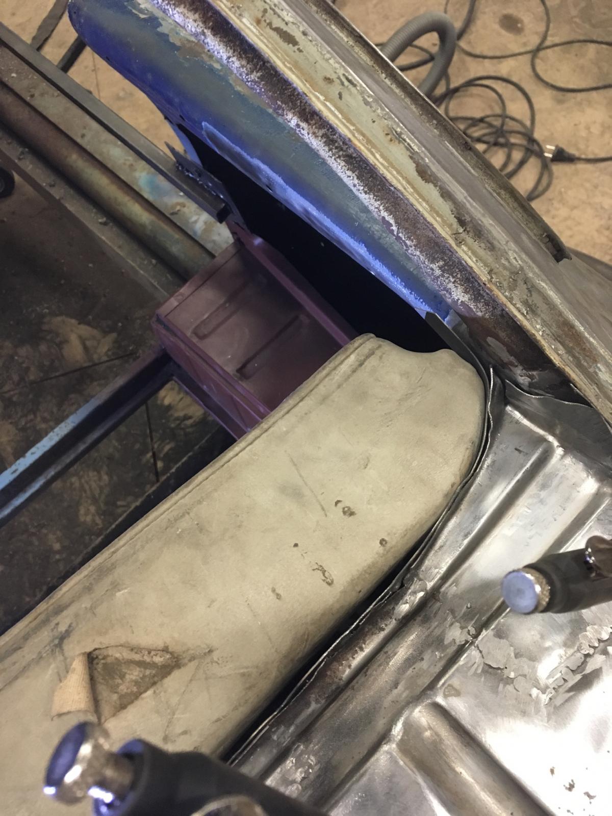

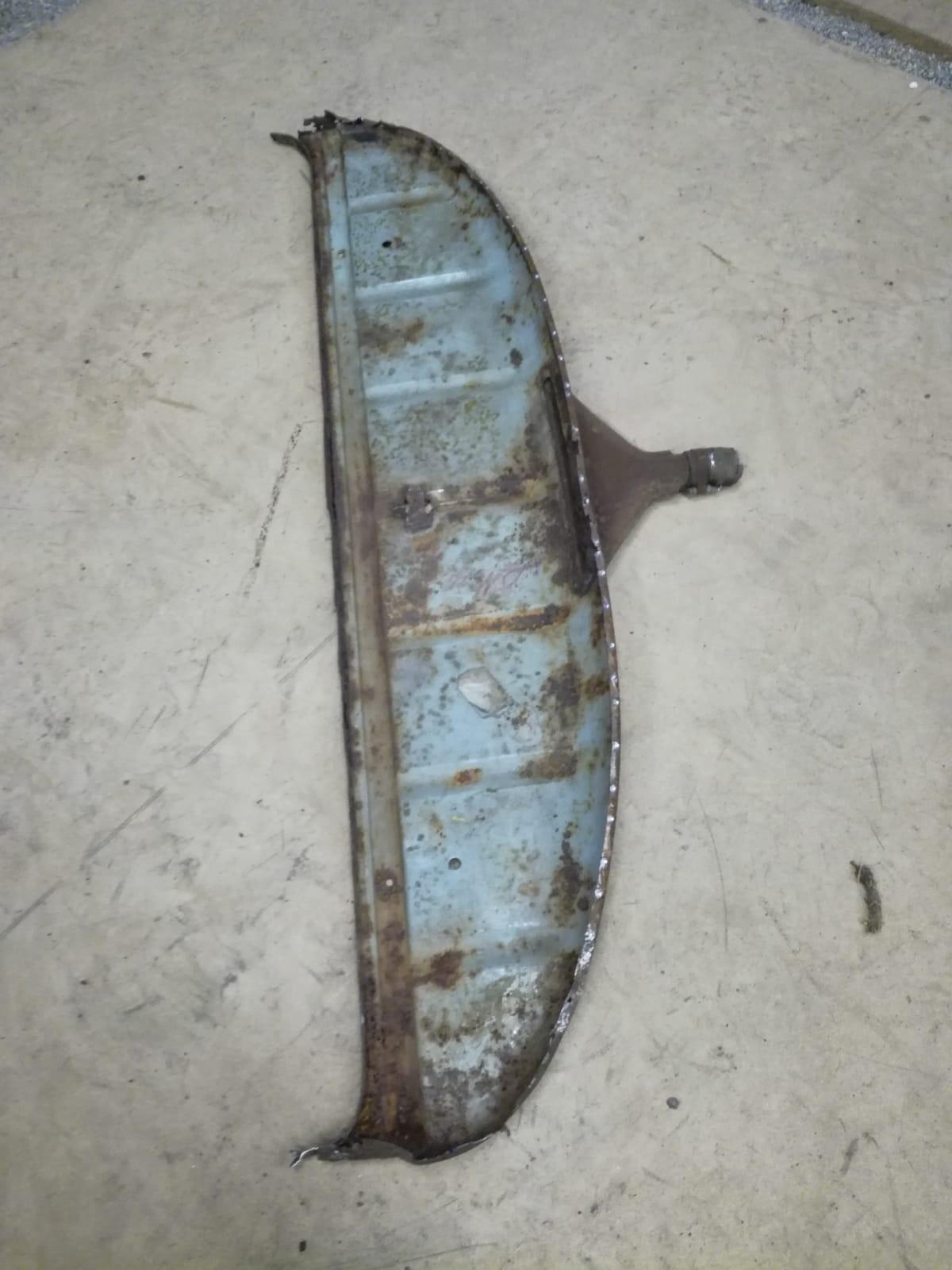

My parcel shelf was really rusted:
So I removed it:

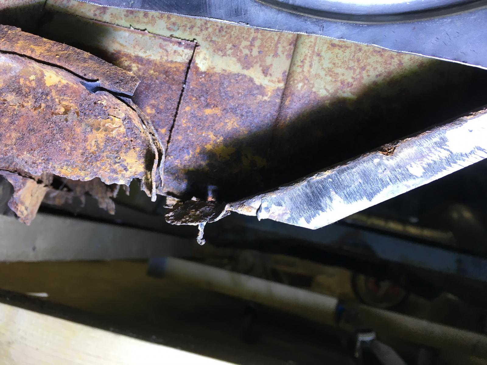

Which was the best decision judging the rust that was also hidden under it:
I fixed these issues (all pictures before final grinding):

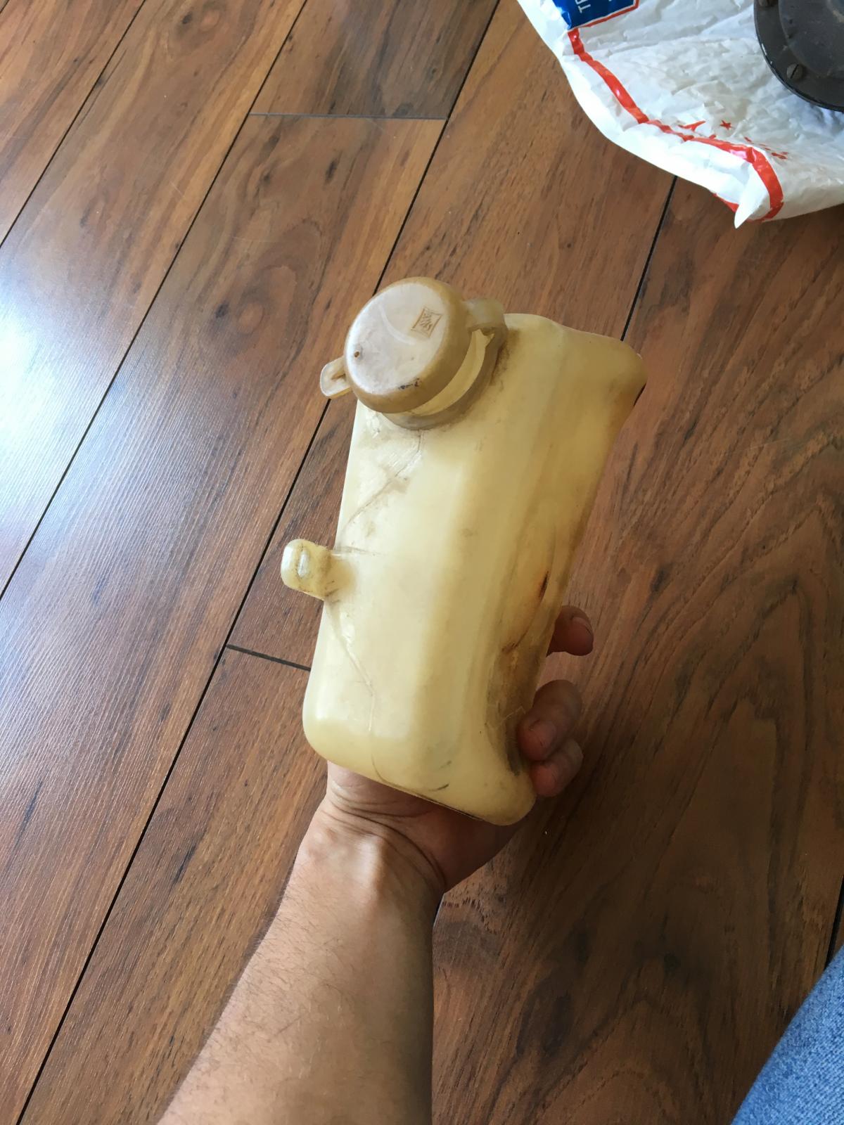

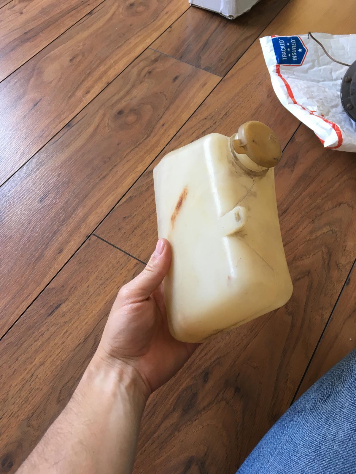

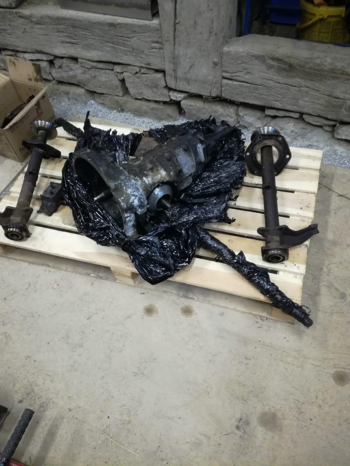

Yes the 60 only gearbox (thanks Mick!) that will be rebuilt:

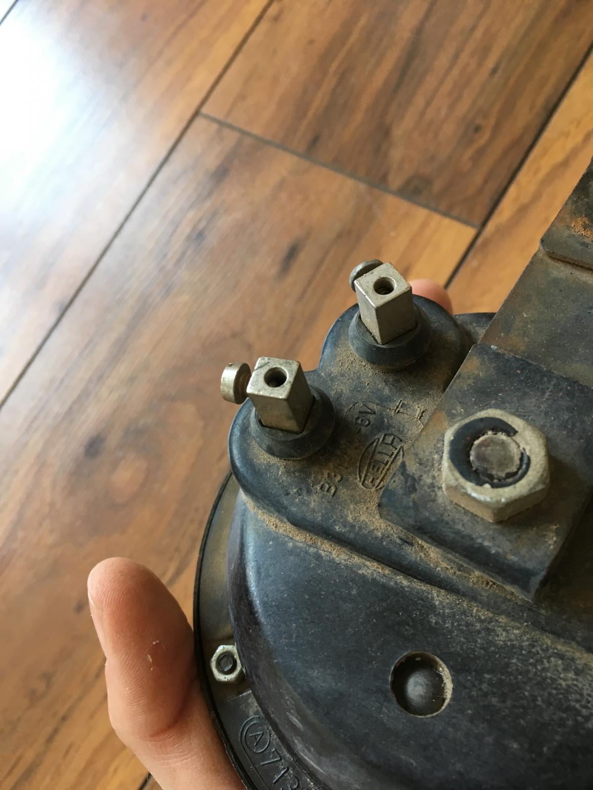

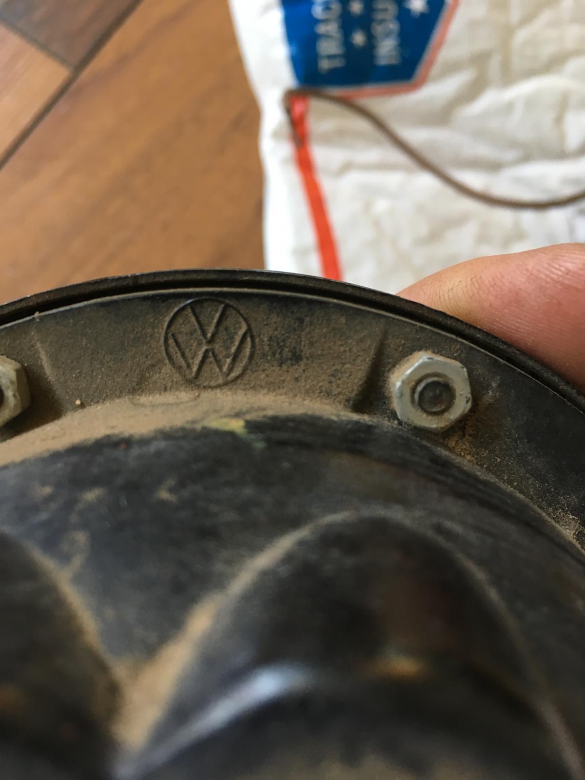

Speaking of 60 only parts, also received (thanks Lee!) the water bottle and the horns with screw connectors:

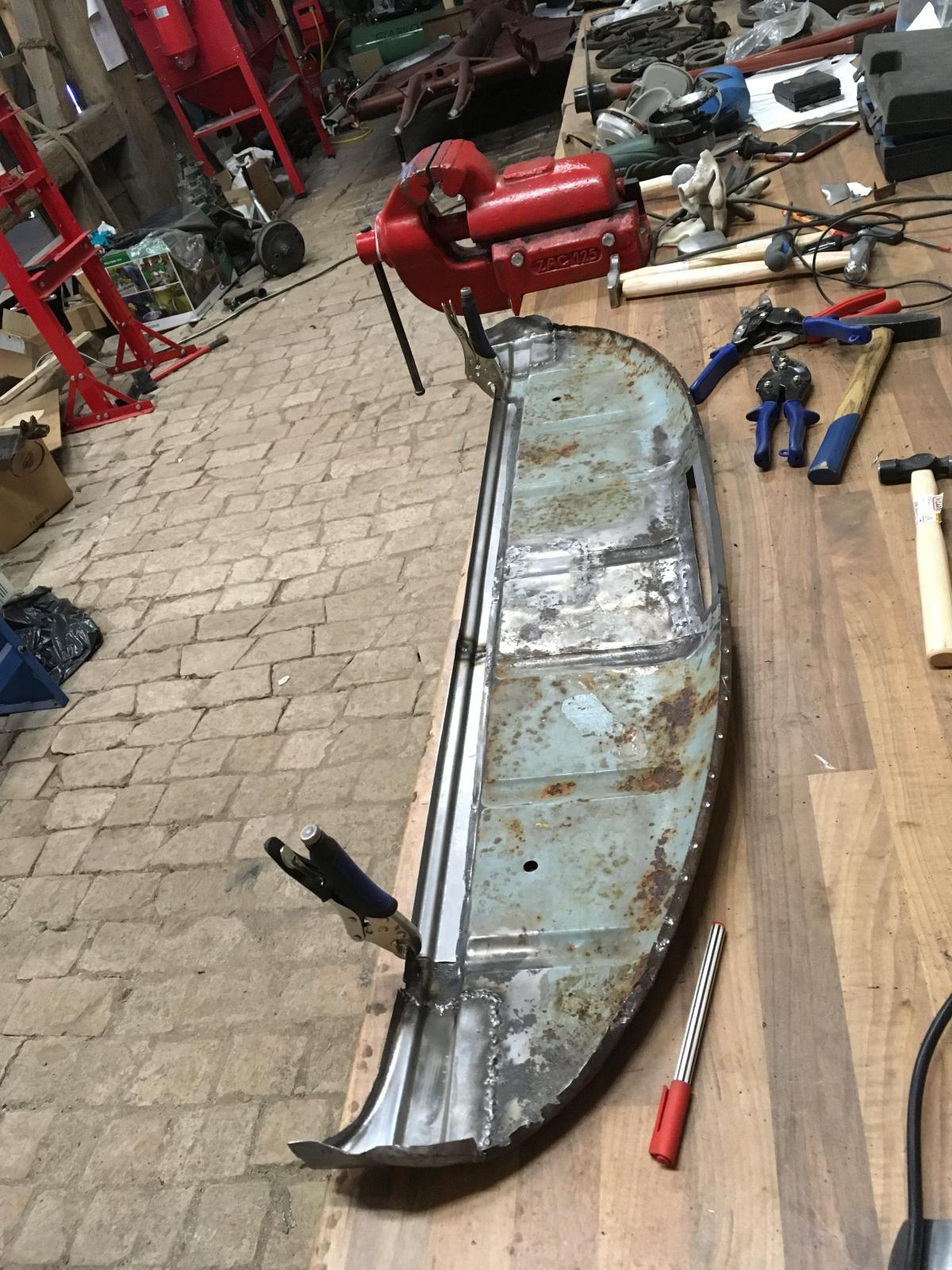

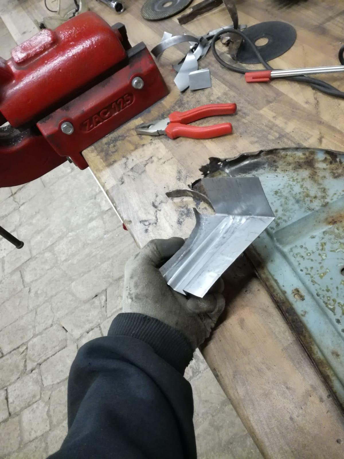

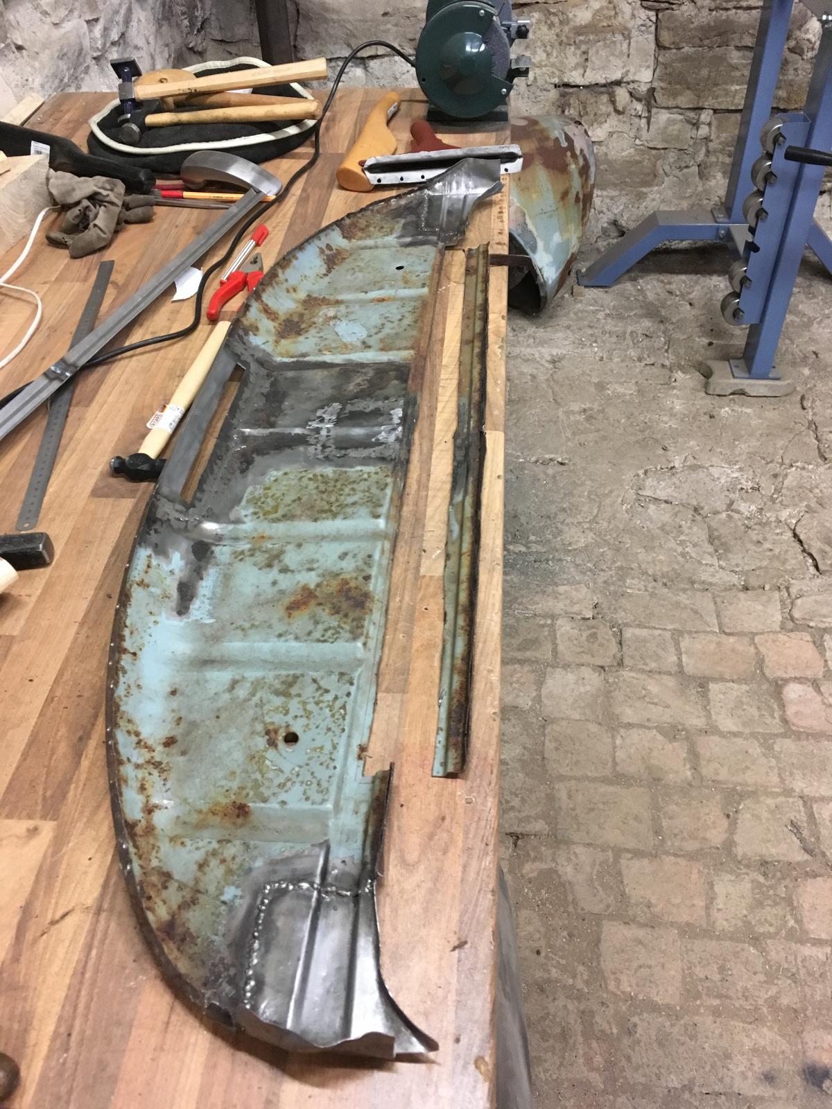

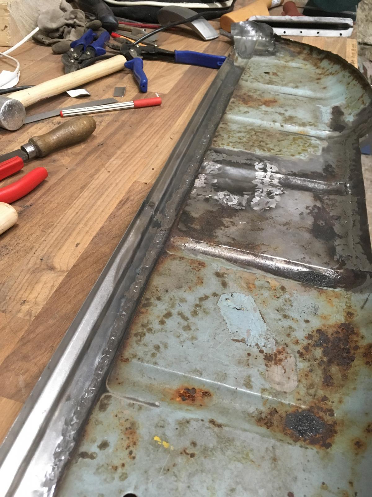

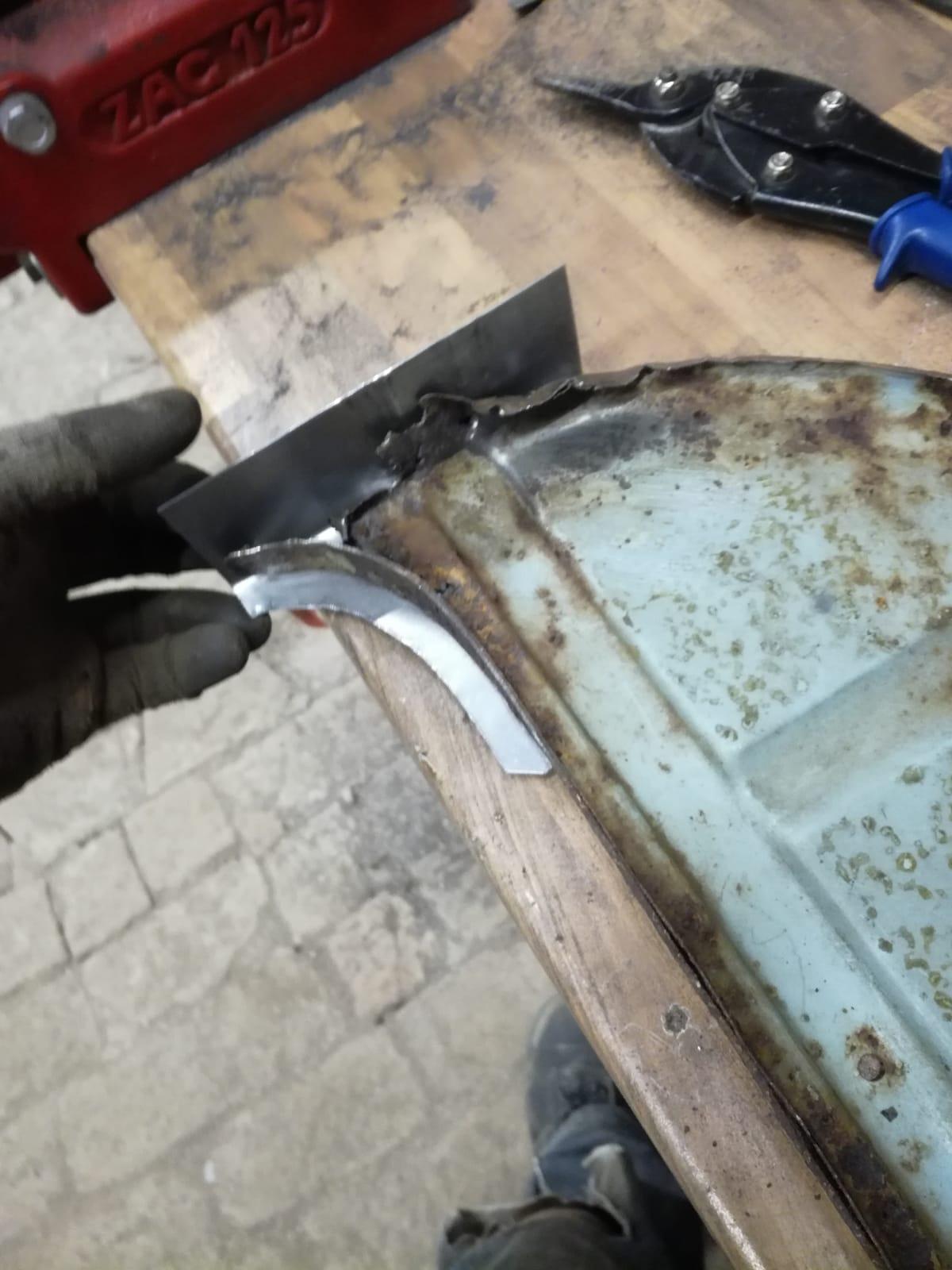

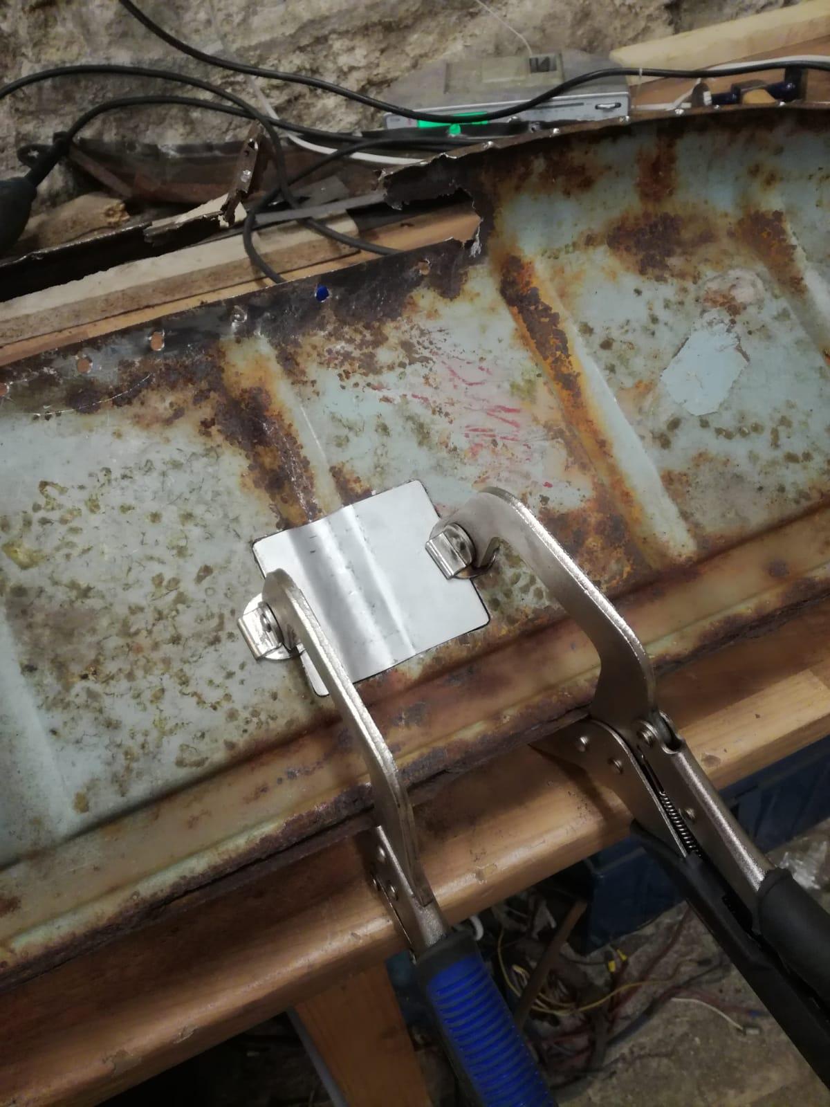

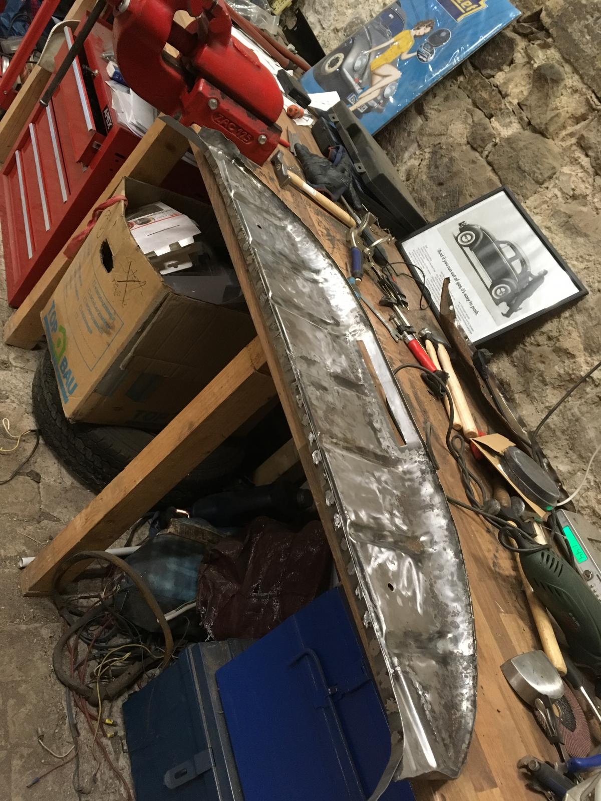

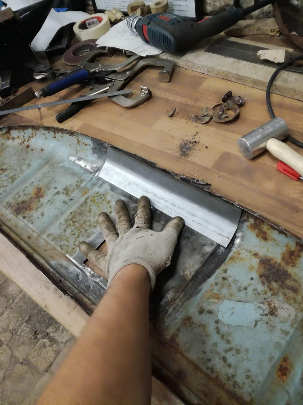

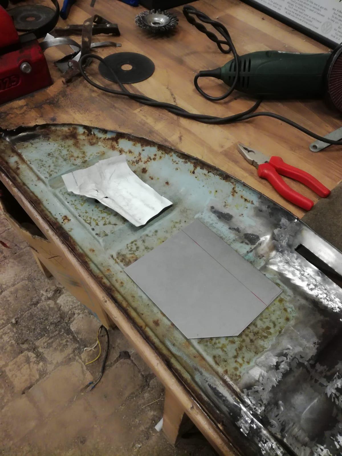

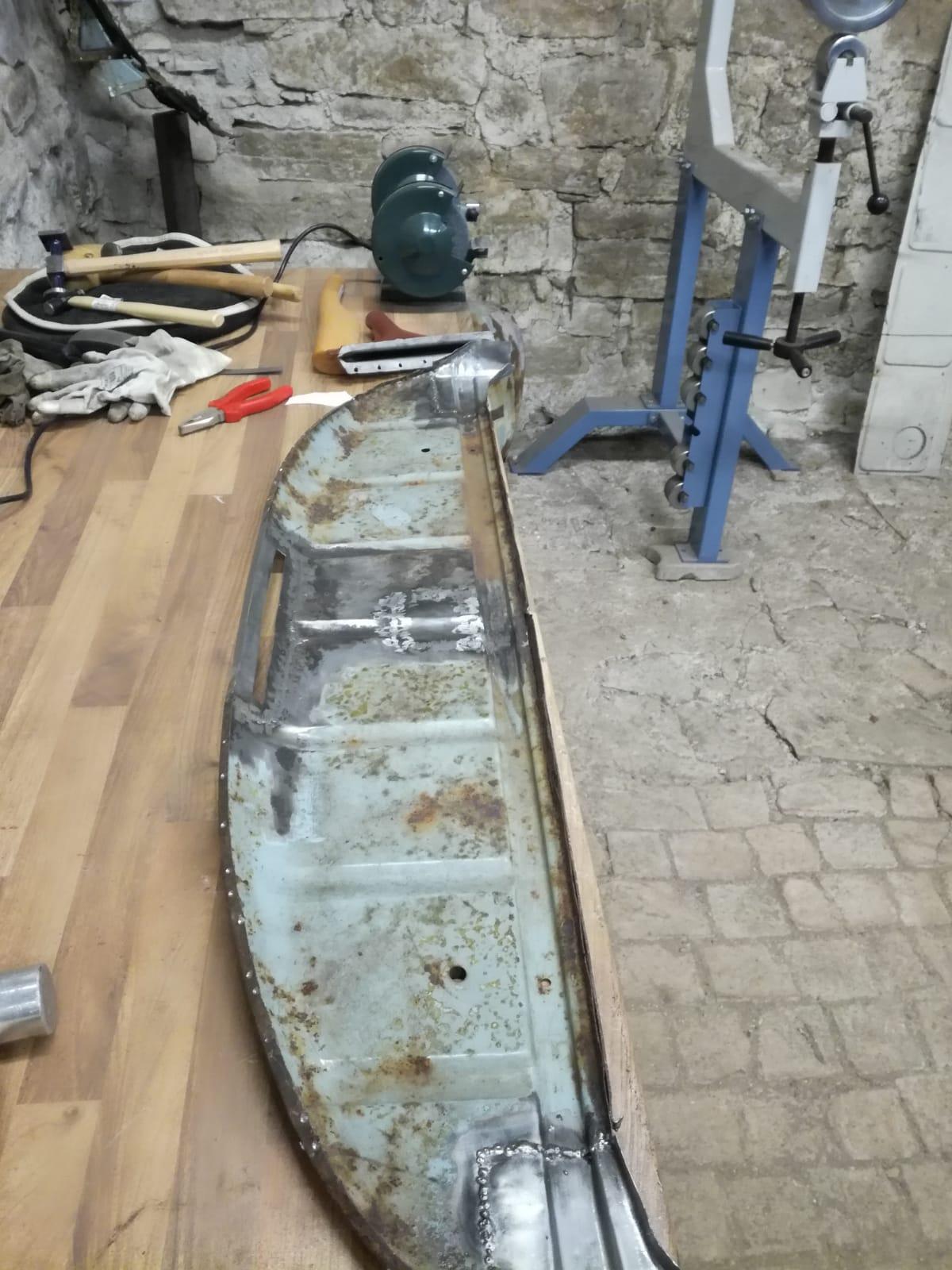

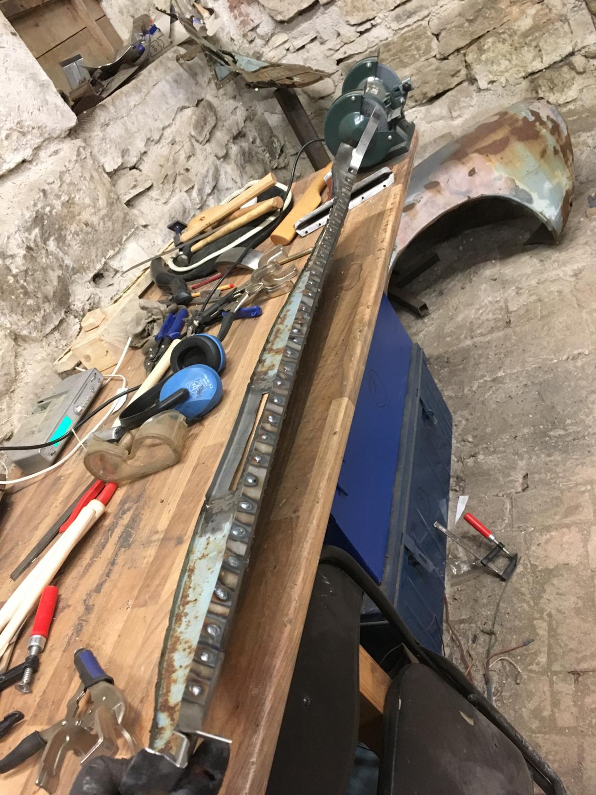

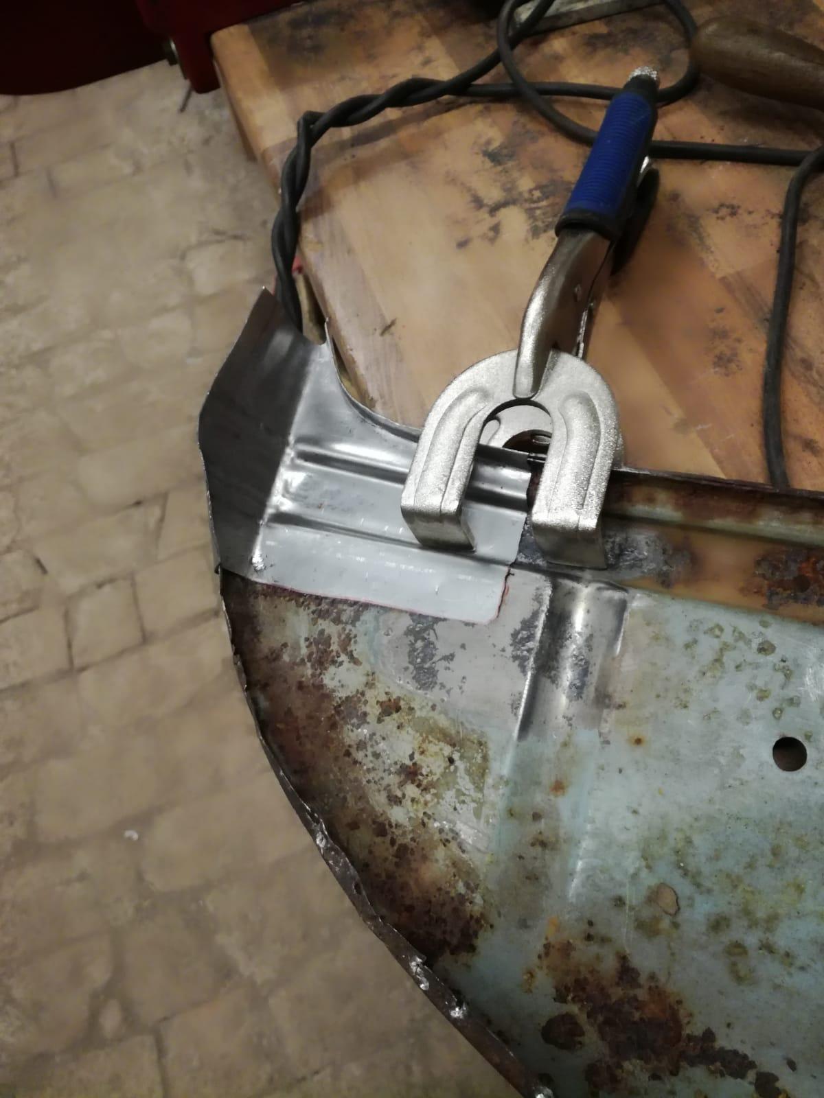

So, next update was about fixing the parcel shelf. I replaced every rusted through or heavily pitted sections. I did not rebuilt it all as it is finally hidden under a carpet so no show car rebuilt here, just being sure this section is solid.
I first started in the middle:
Then a bit further:

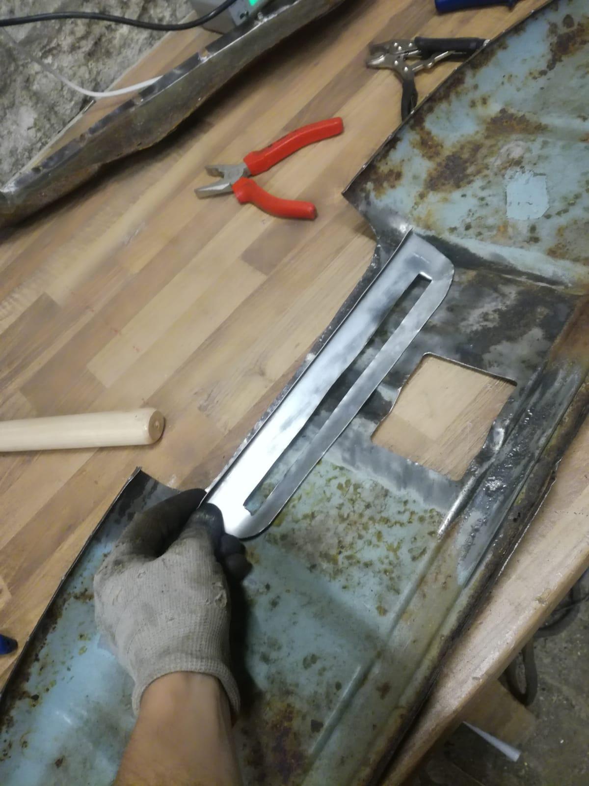

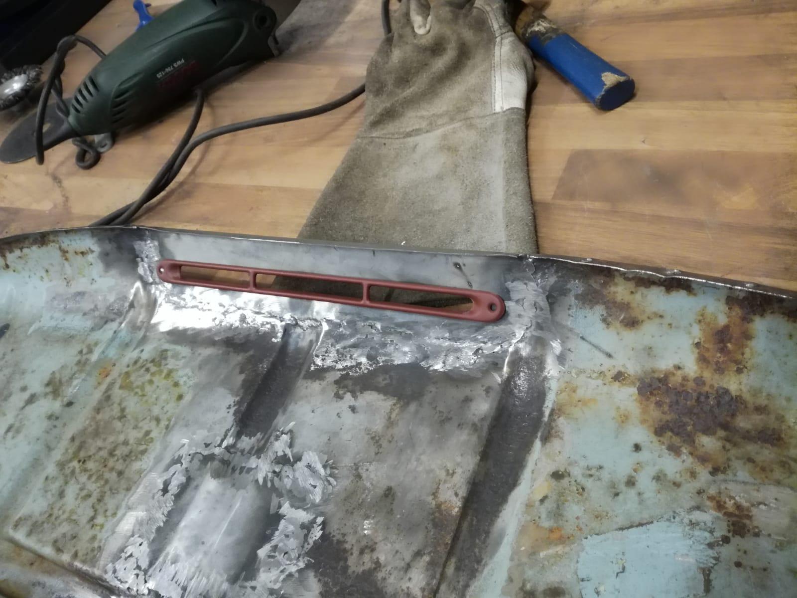

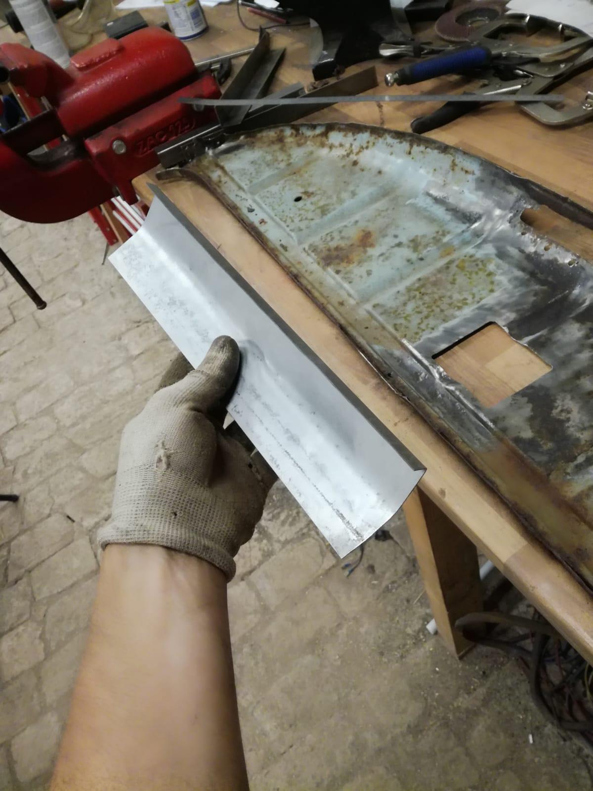

Next steps were the corners. Really tricky with the beads, the different curves,.. took me several attempts to get them right, including a lot of test fit on the car, with the rear seat,.. Here in pictures:
Then the front part:

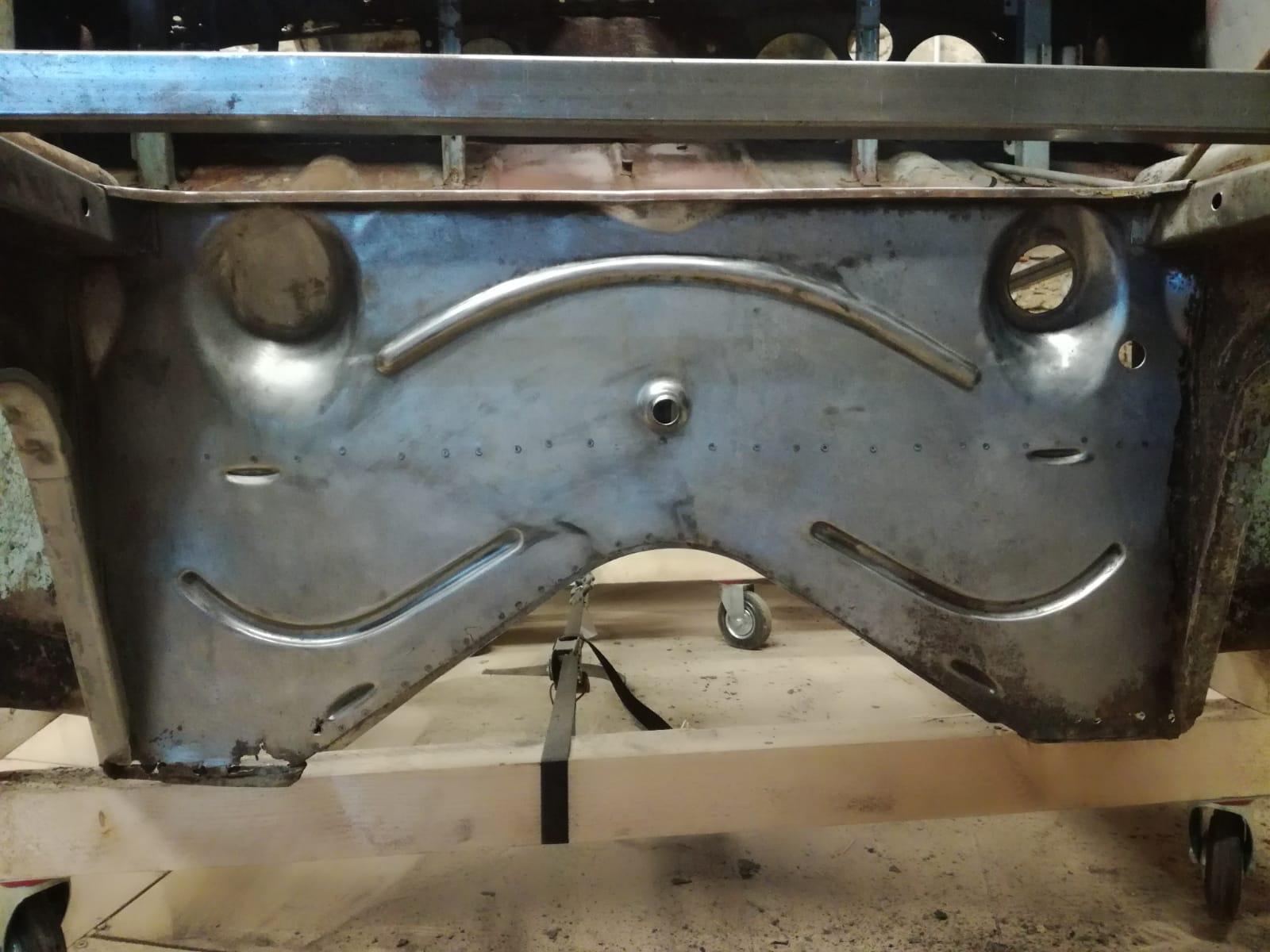

it was time:
adjusting:
welding:
welded:

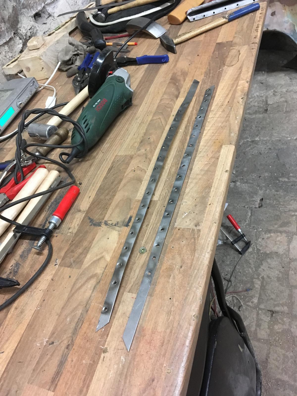

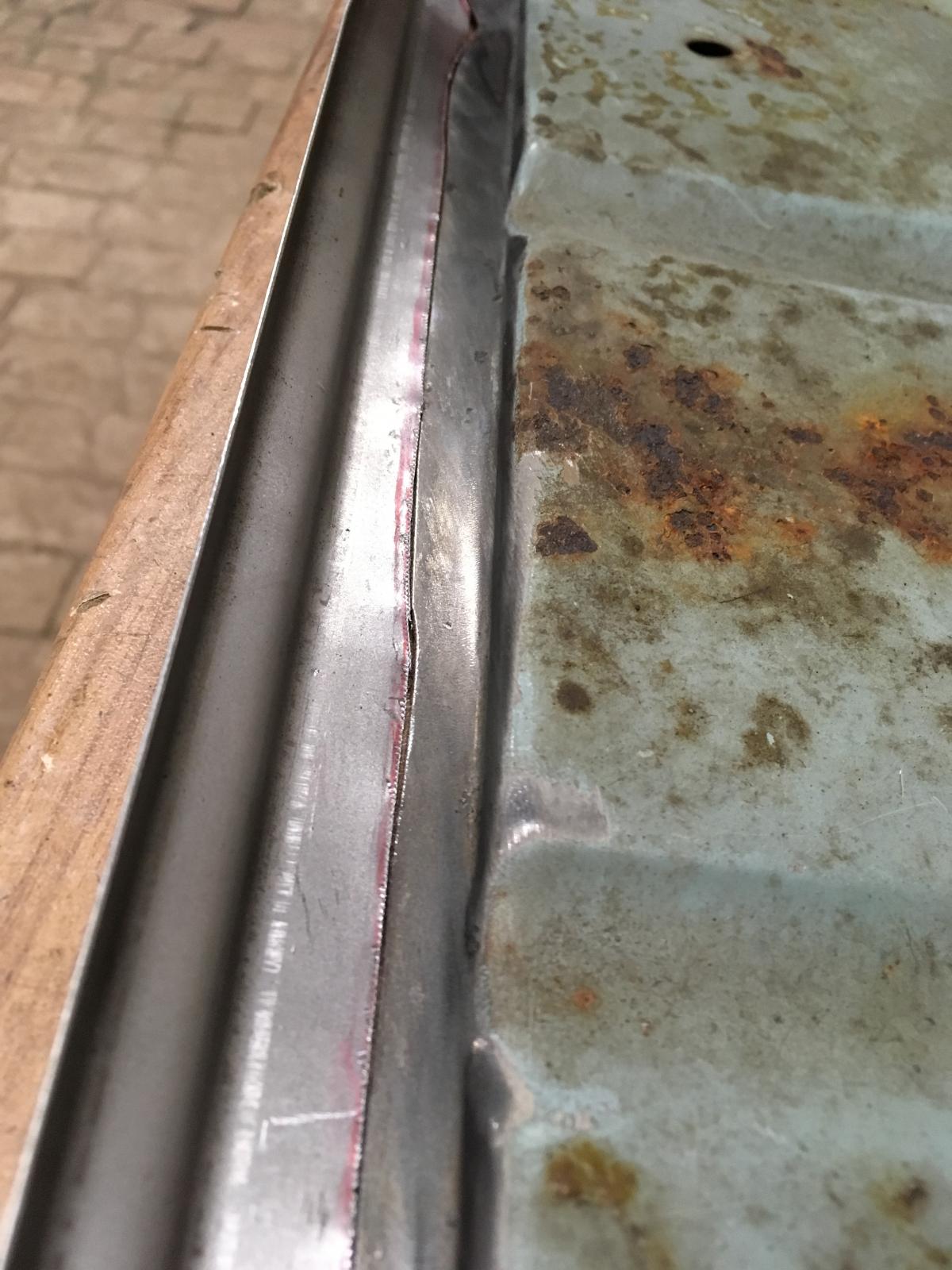

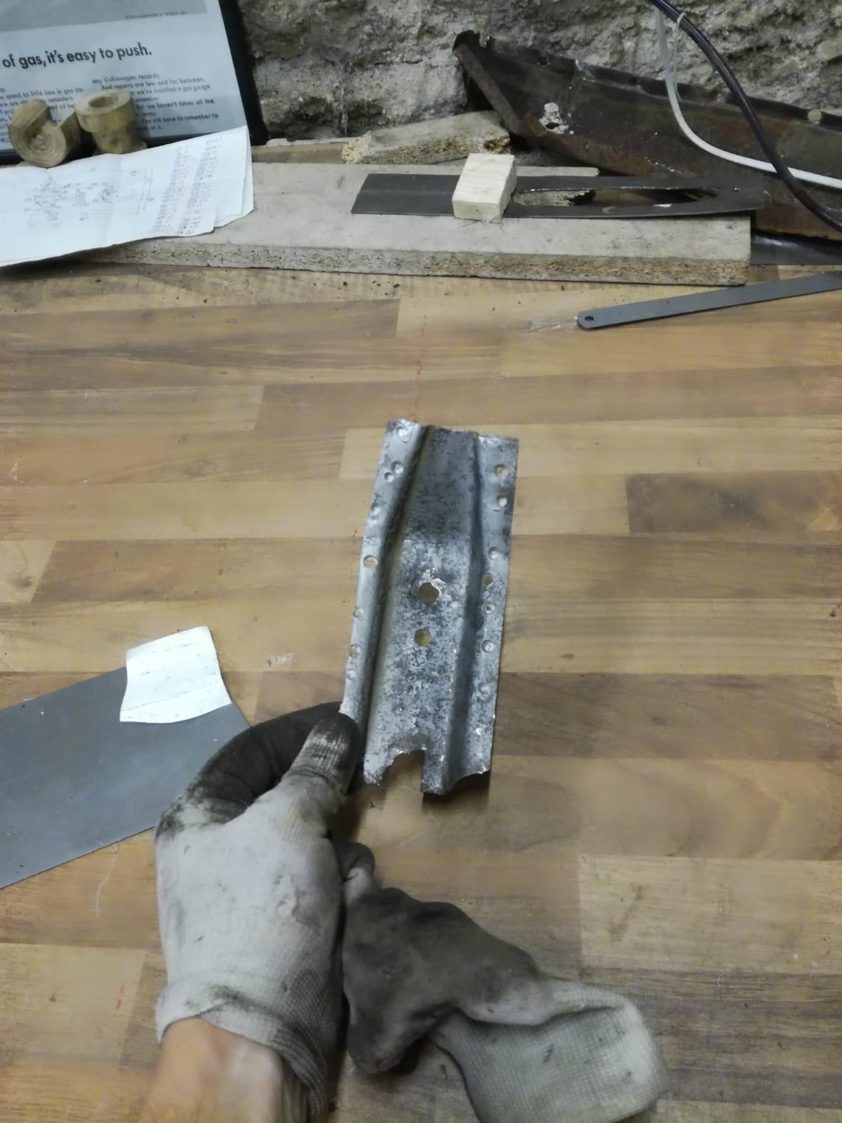

the metal string welded on it also needed to be replaced. Made it in 2 parts due to material availability, and of course some welding primer where there are welded together:
