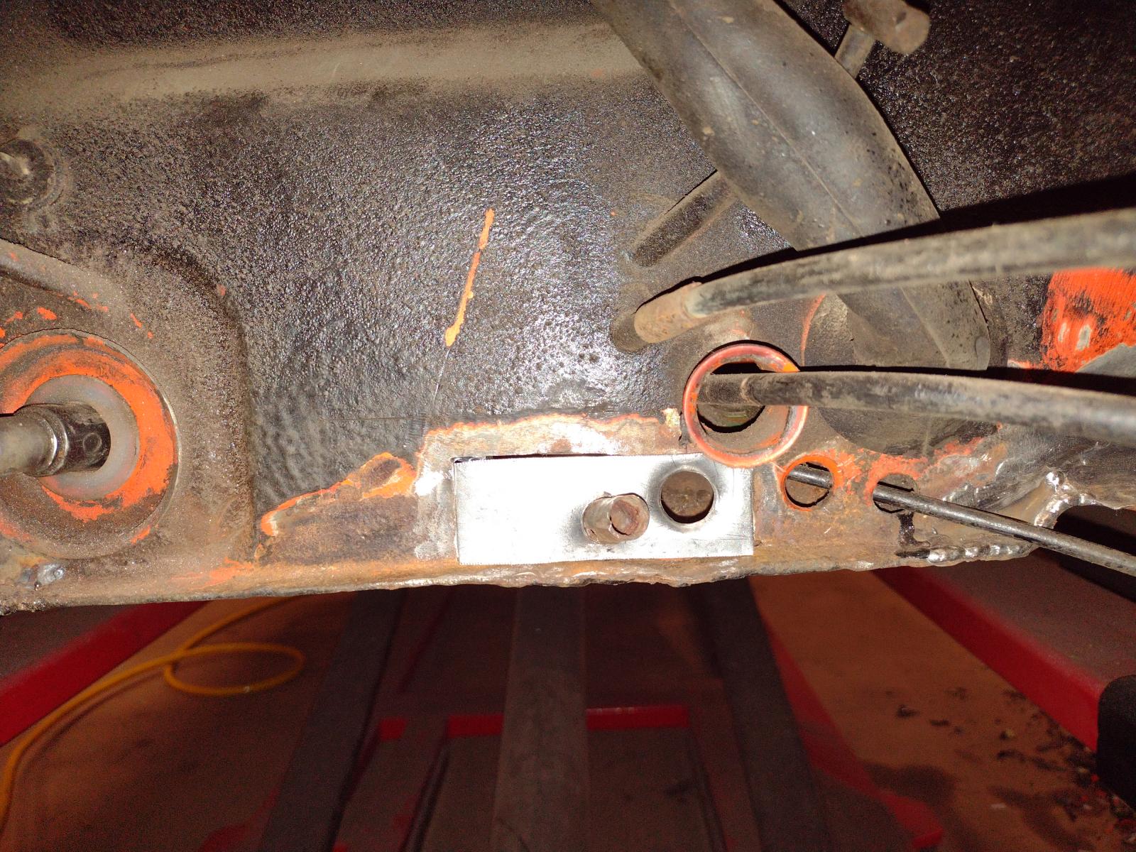

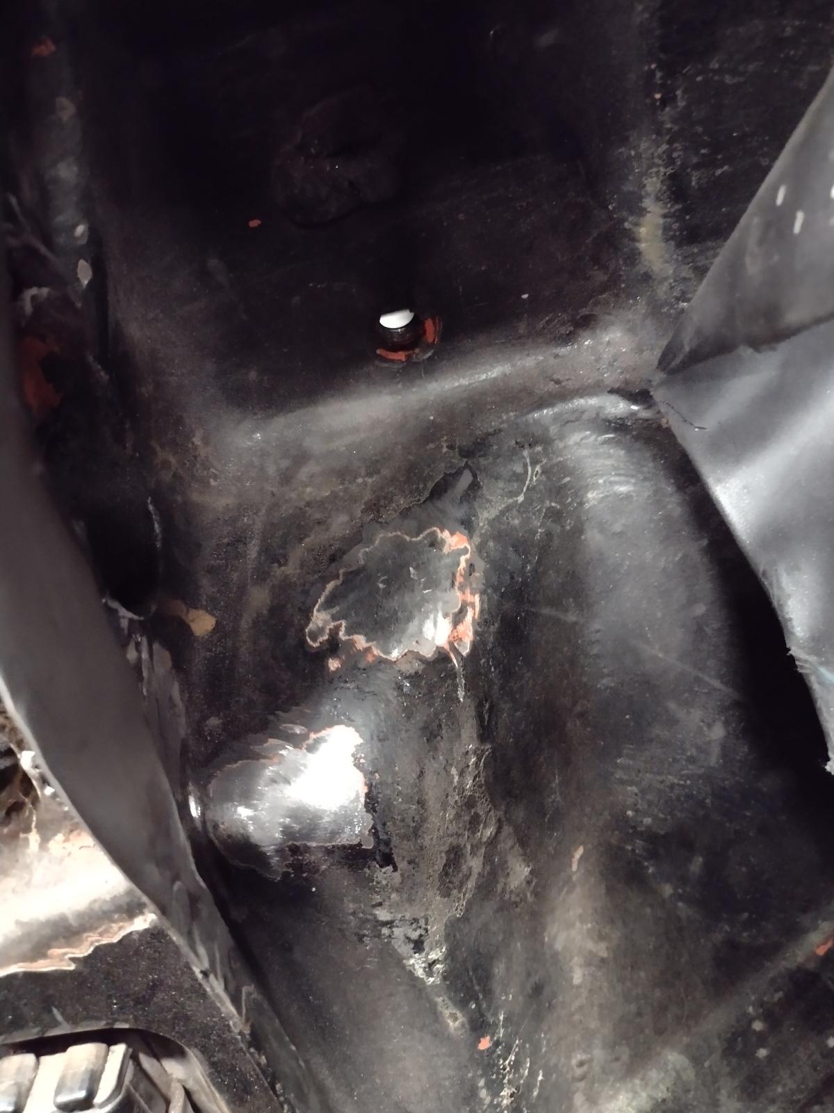

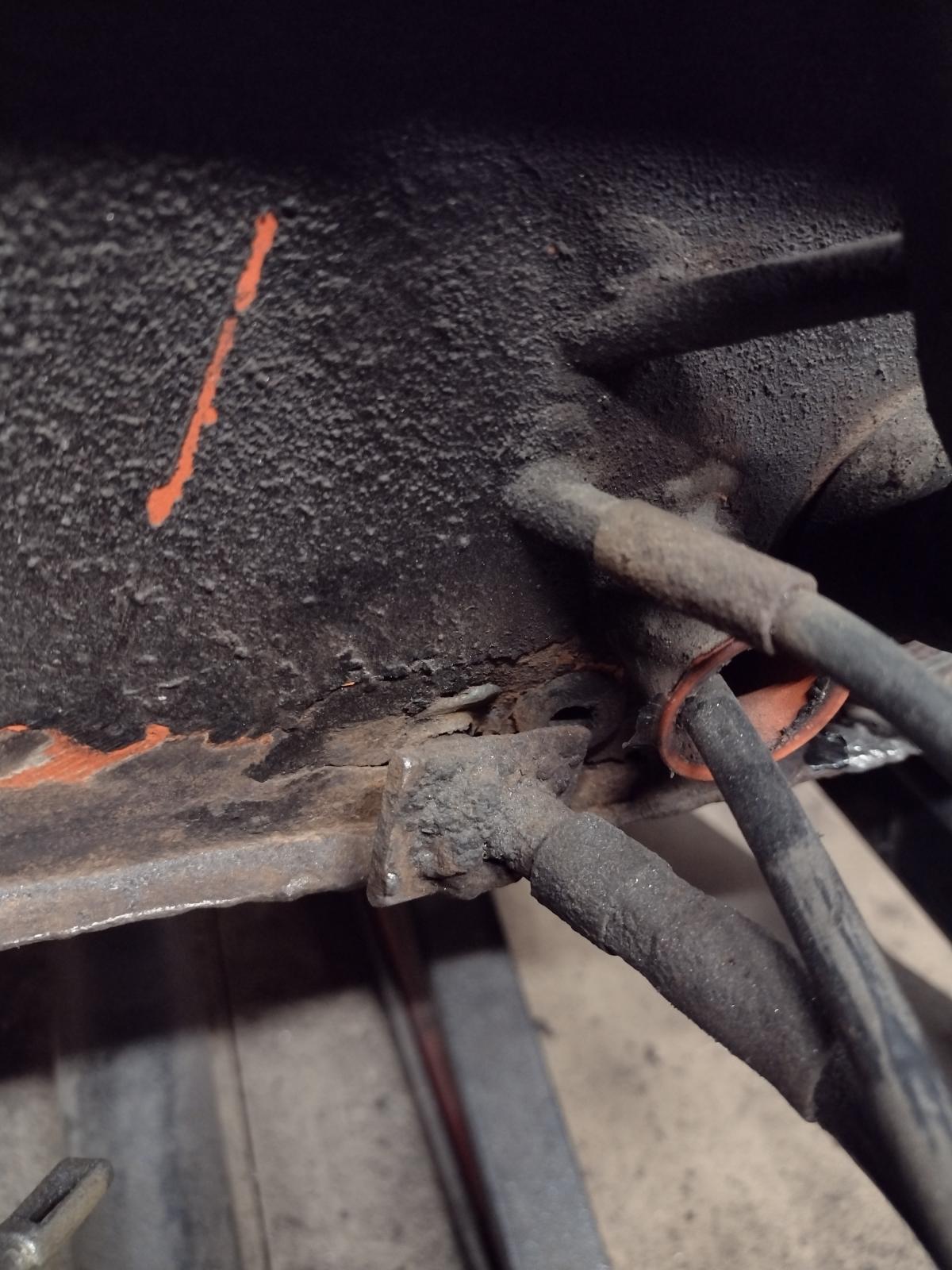

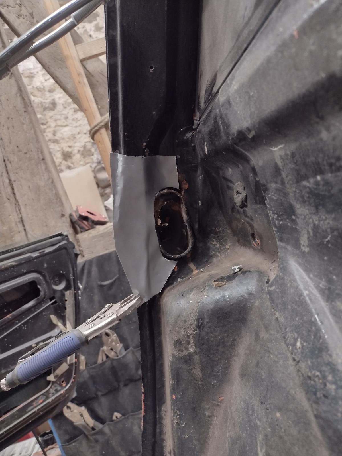

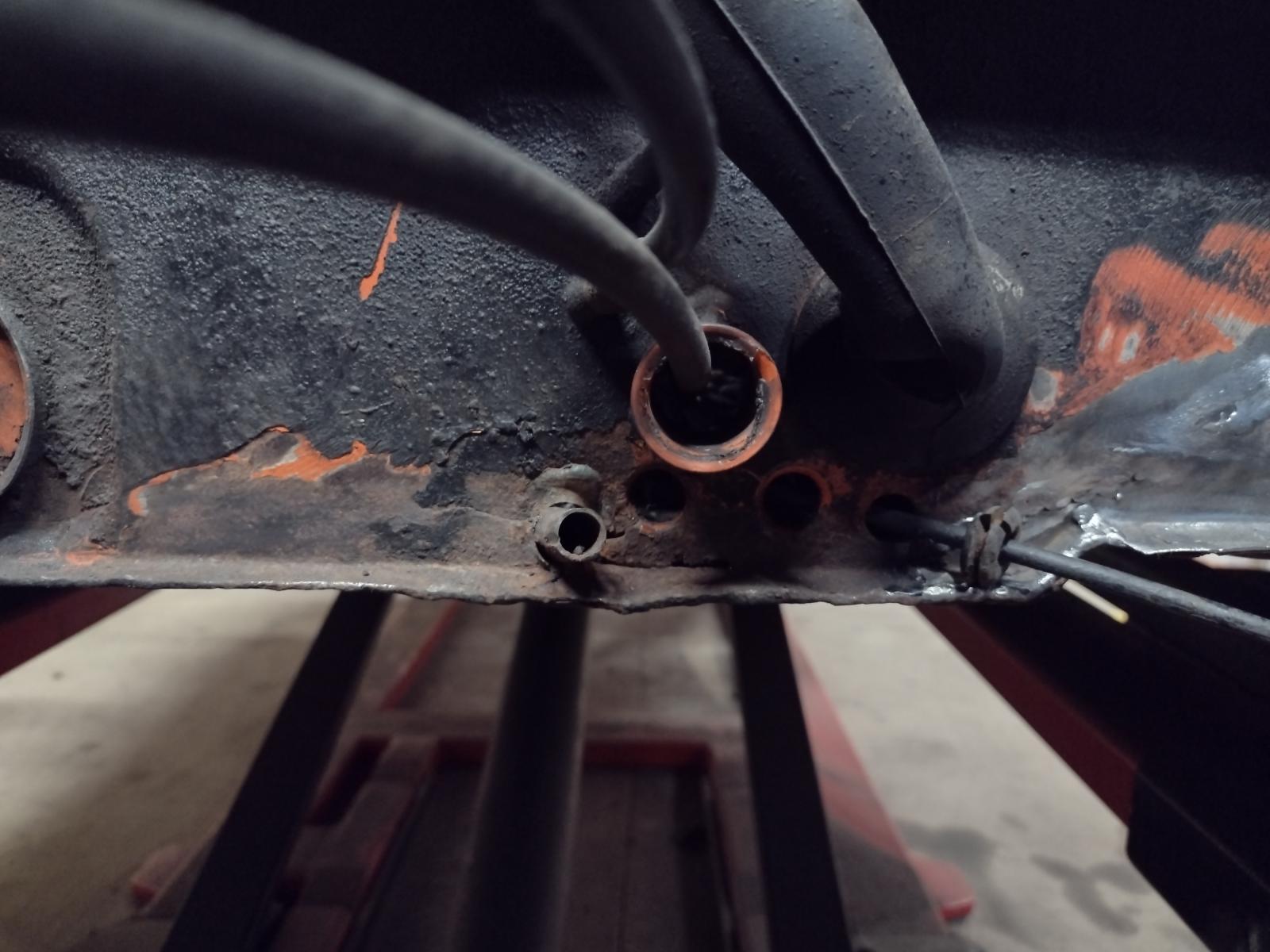

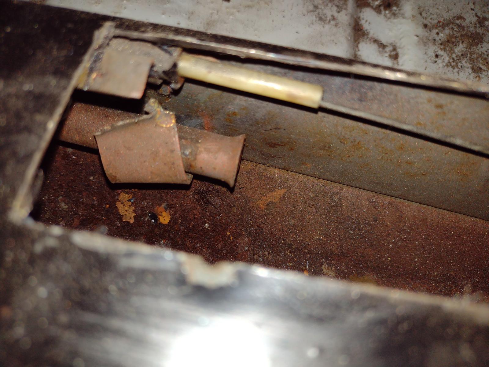

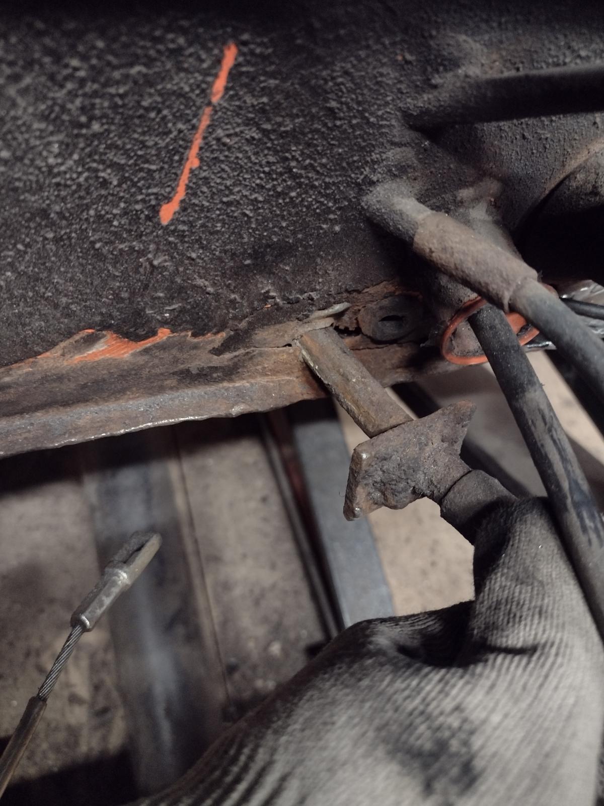

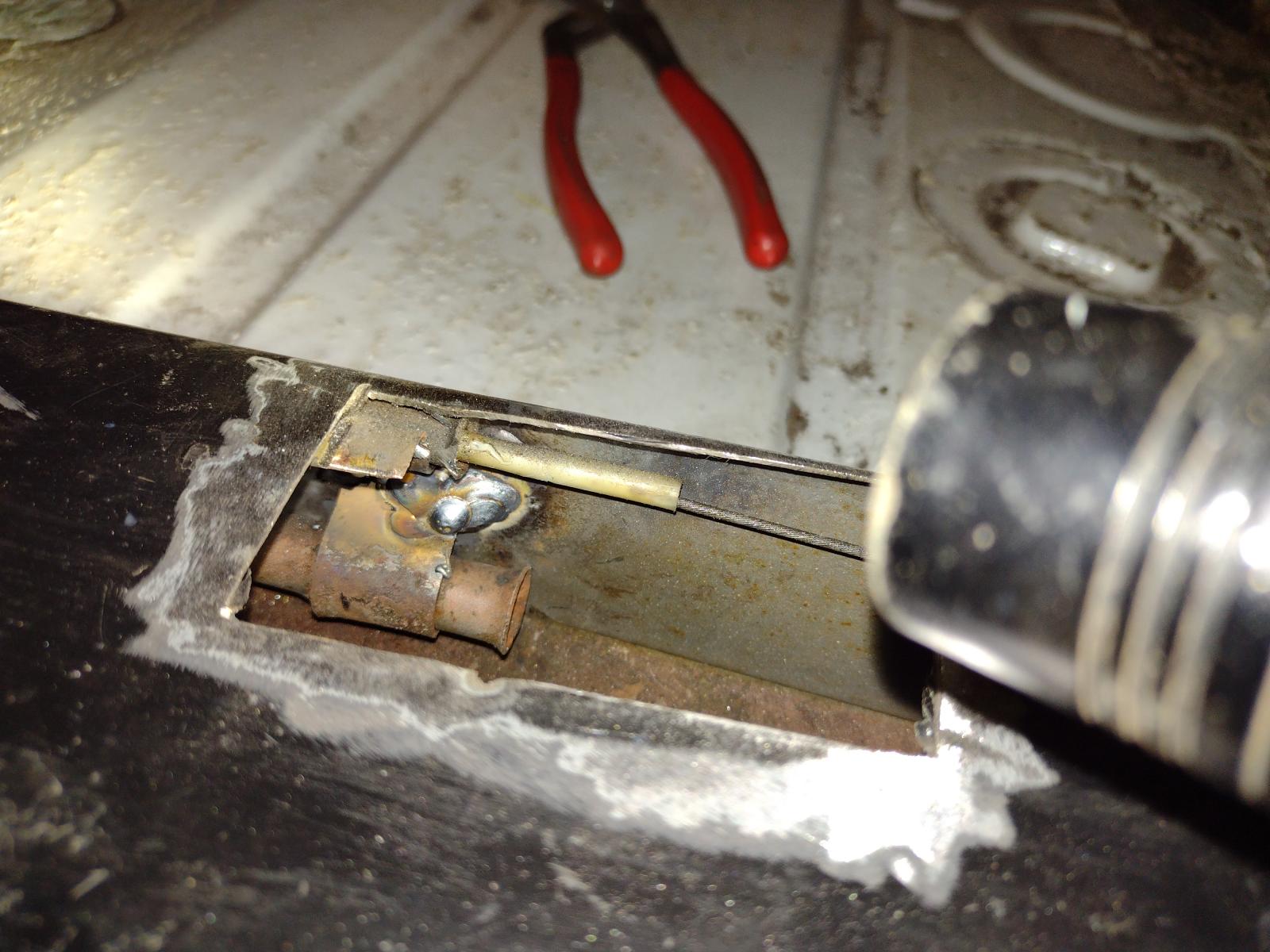

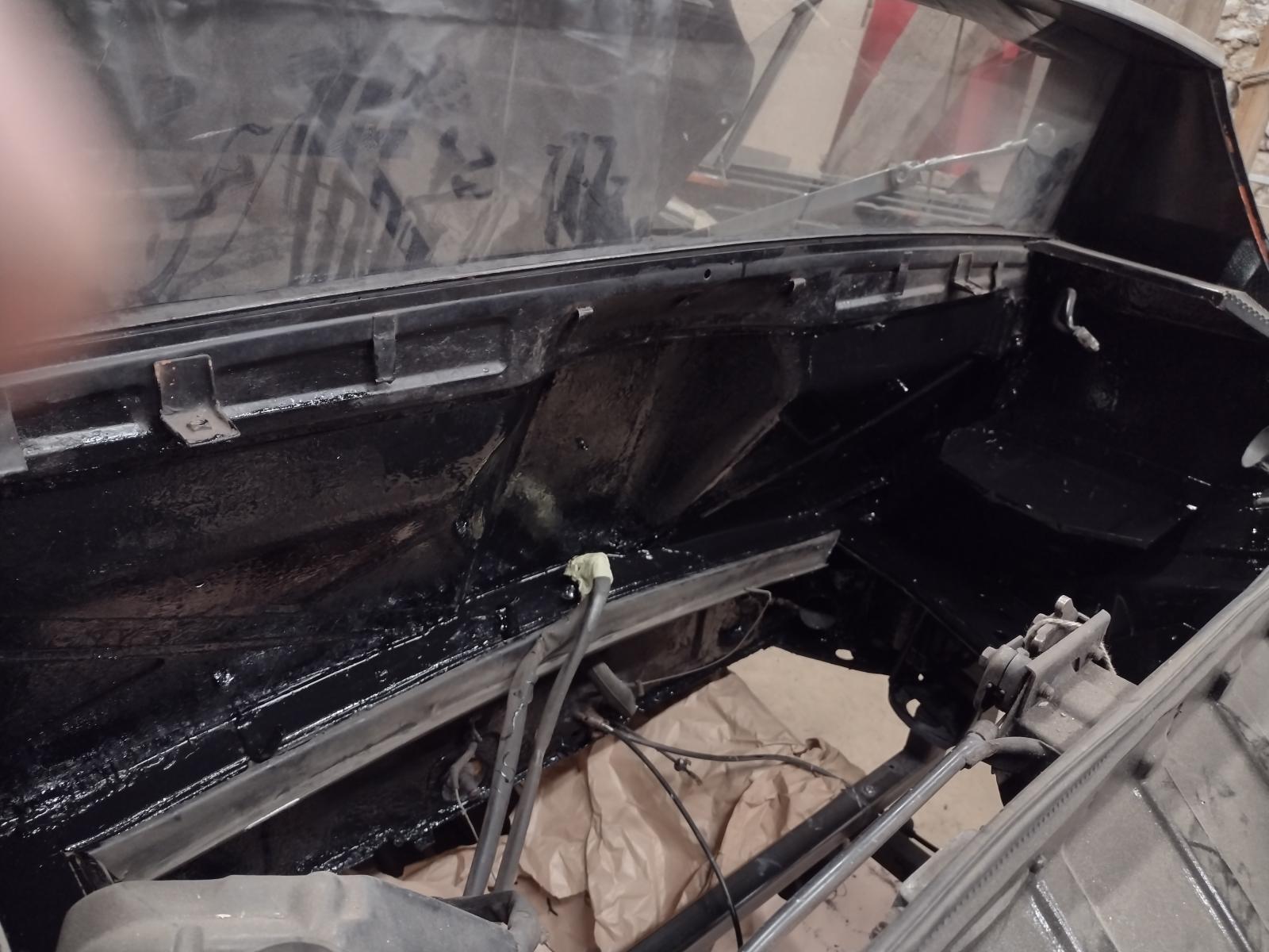

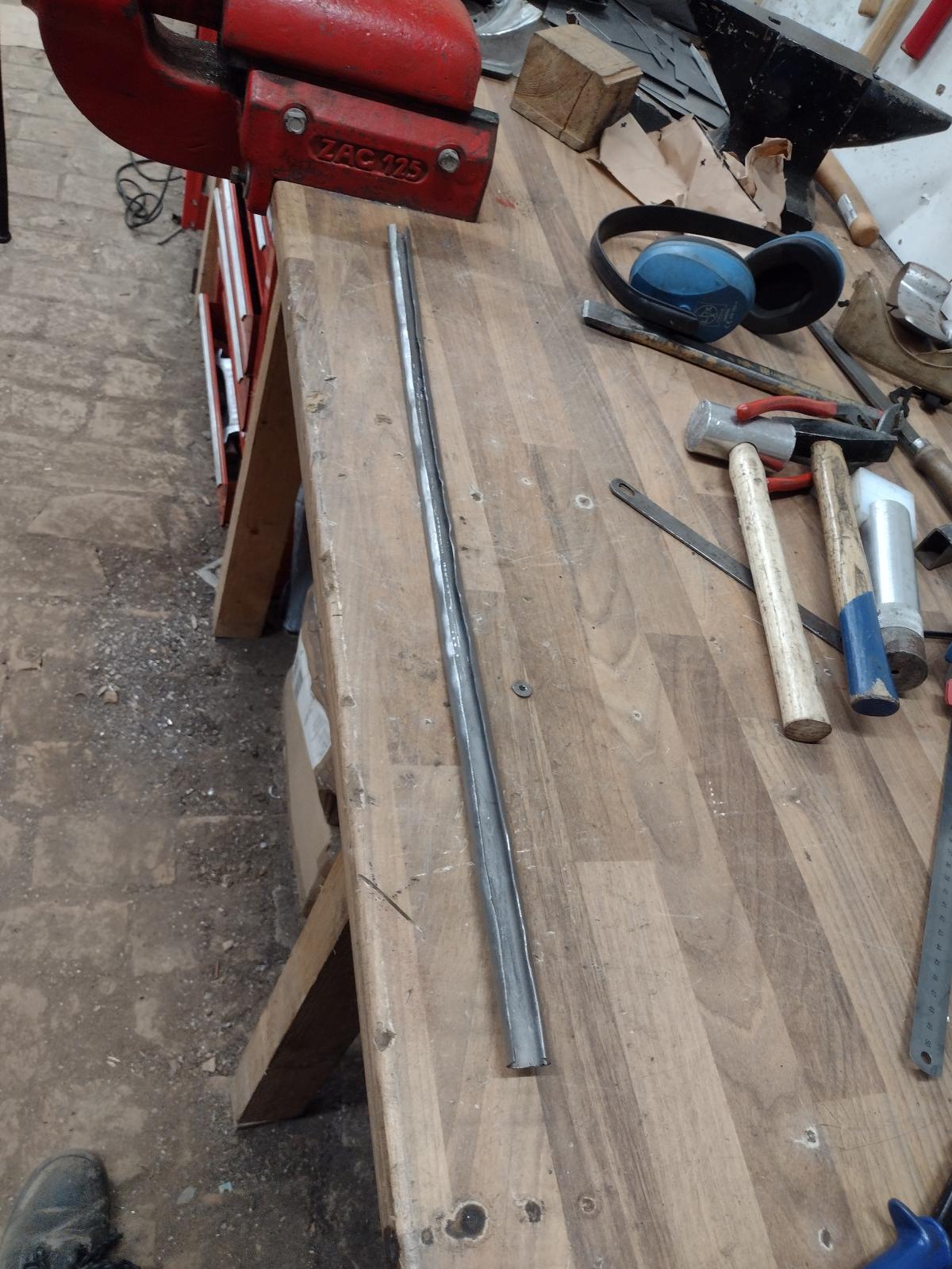

So, next I fixed the clutch tube.
First the part on the firewall, I don't know what a PO was thinking with this thick piece?!
So I removed it and found a damaged firewall:
So removing what is damaged:
Making the patch:
Welded:
And the front fixation, cut the access :
The issue:
Welded (pic was ongoing, I welded the whole length but forgot to take a picture):
And closed:
Stay tuned

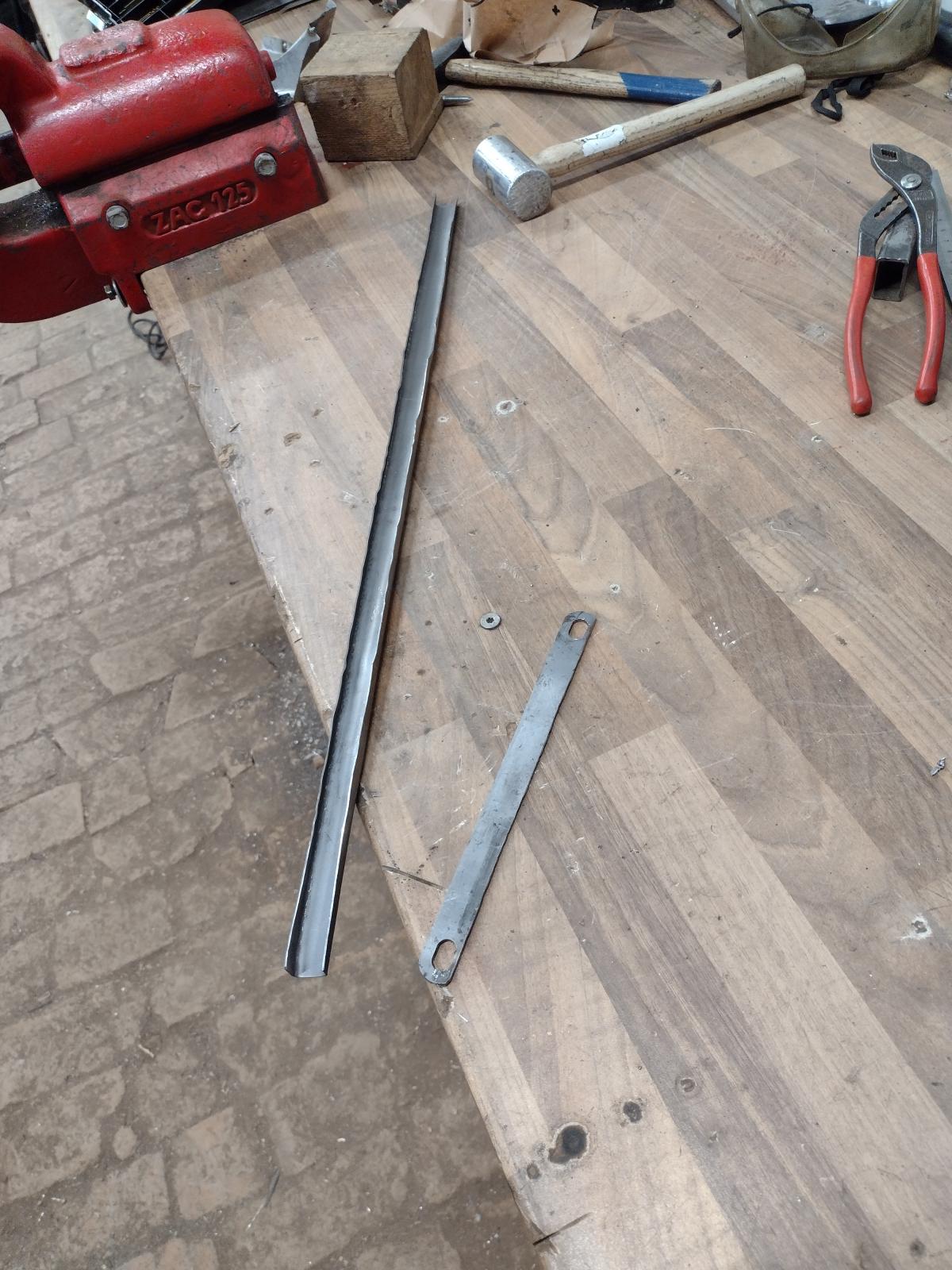

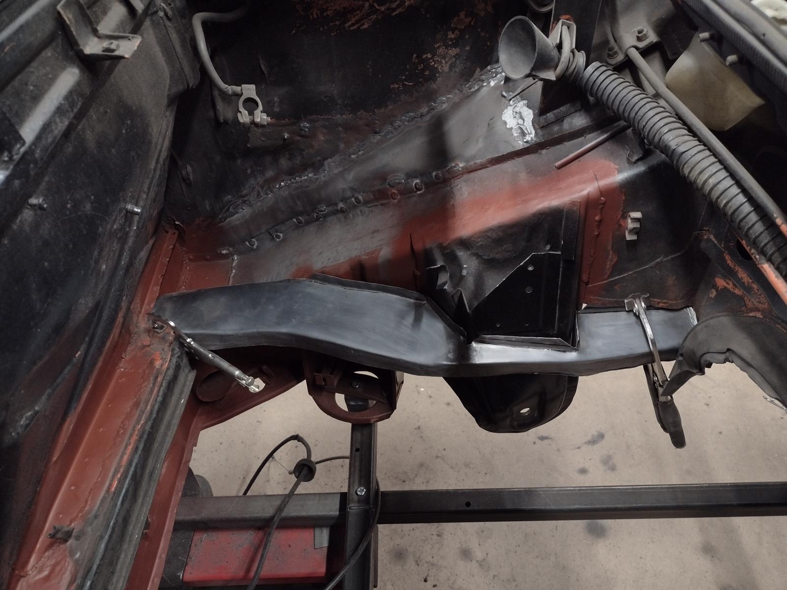

So, I then worked on my engine side panel:
Then the necessary holes:
Then the sealing guide:
A before-after:
And in place :

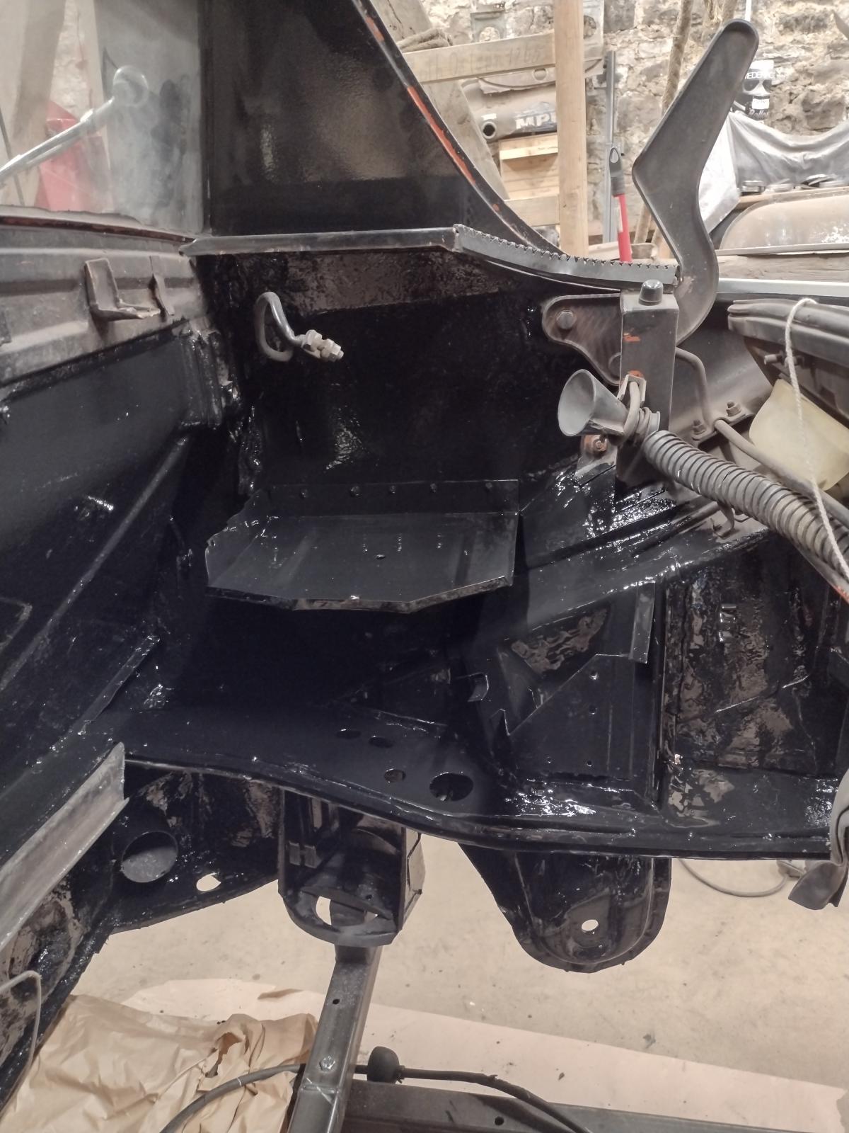

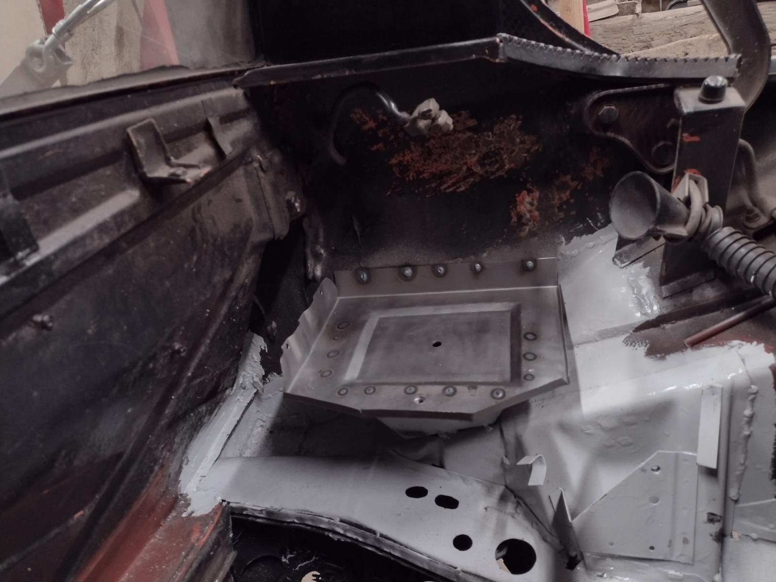

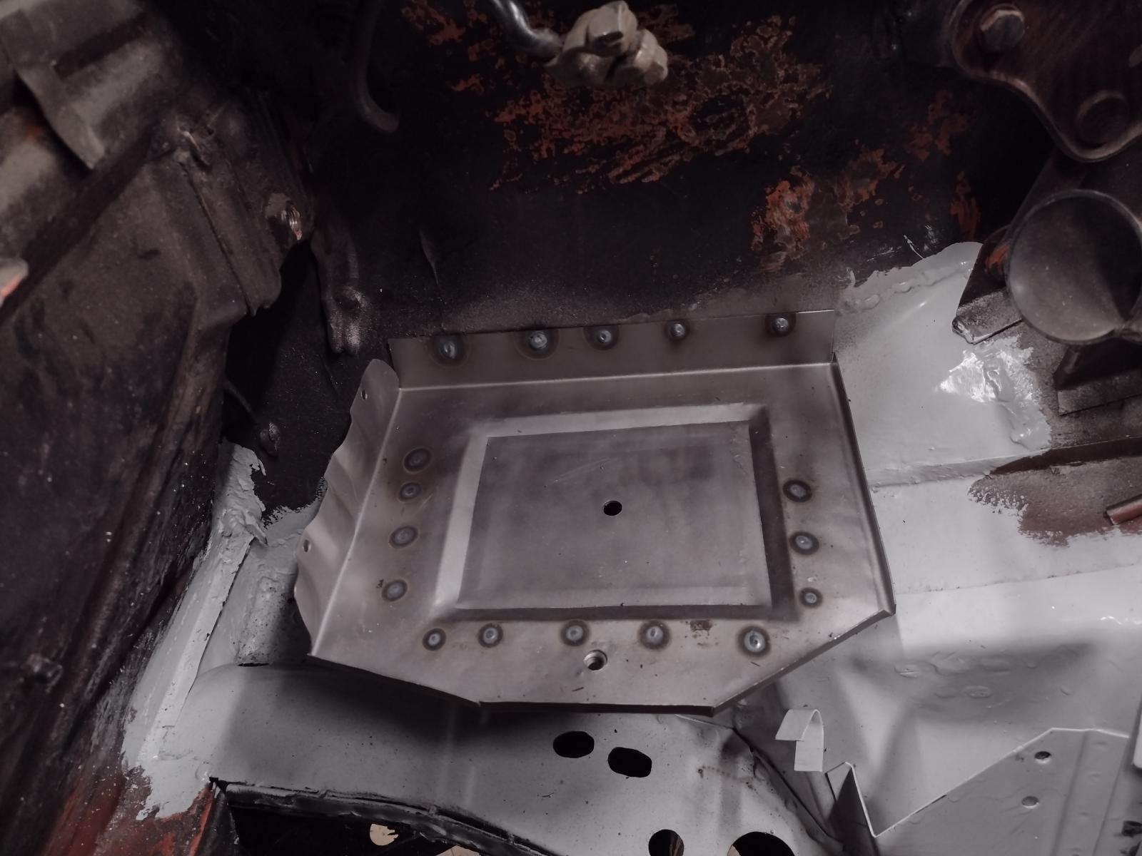

So, I think the next step was quite logical..the battery tray
I did built it by hand couple months ago:
So it was time to adjust and weld it, first the bottom part:
And then the top:
All done and all fits great:

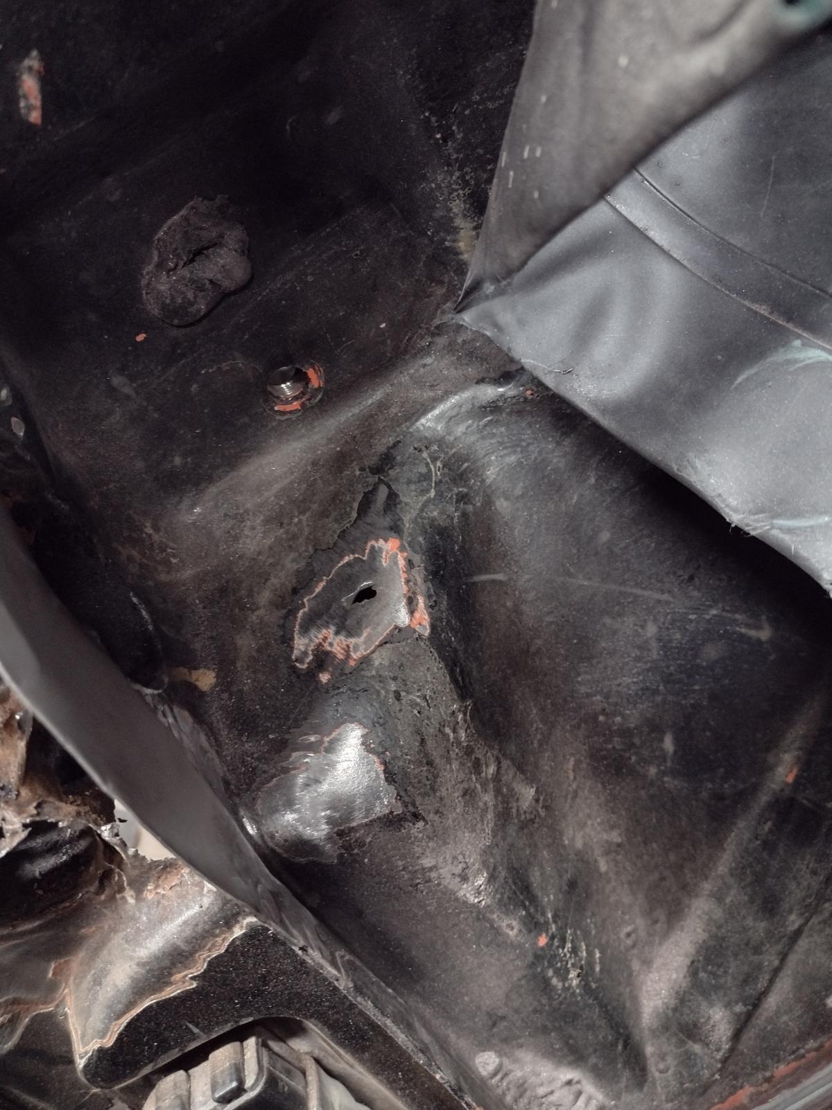

I then found one last hole on the firewall:
That I welded close:
And now we have a nice engine bay/right long:
Starting to look good!

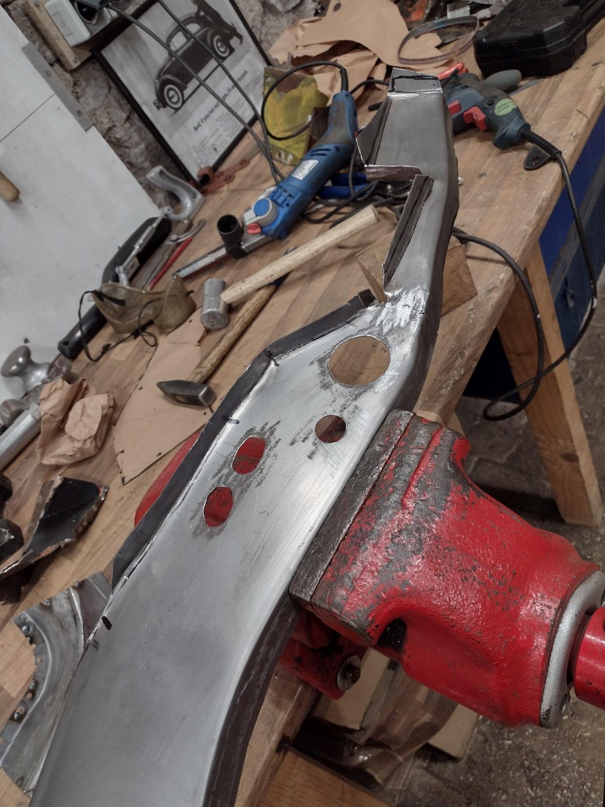

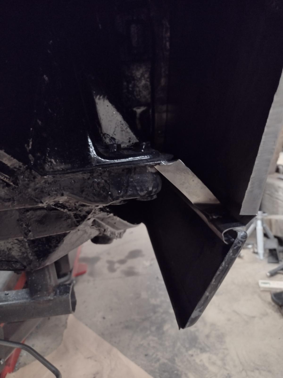

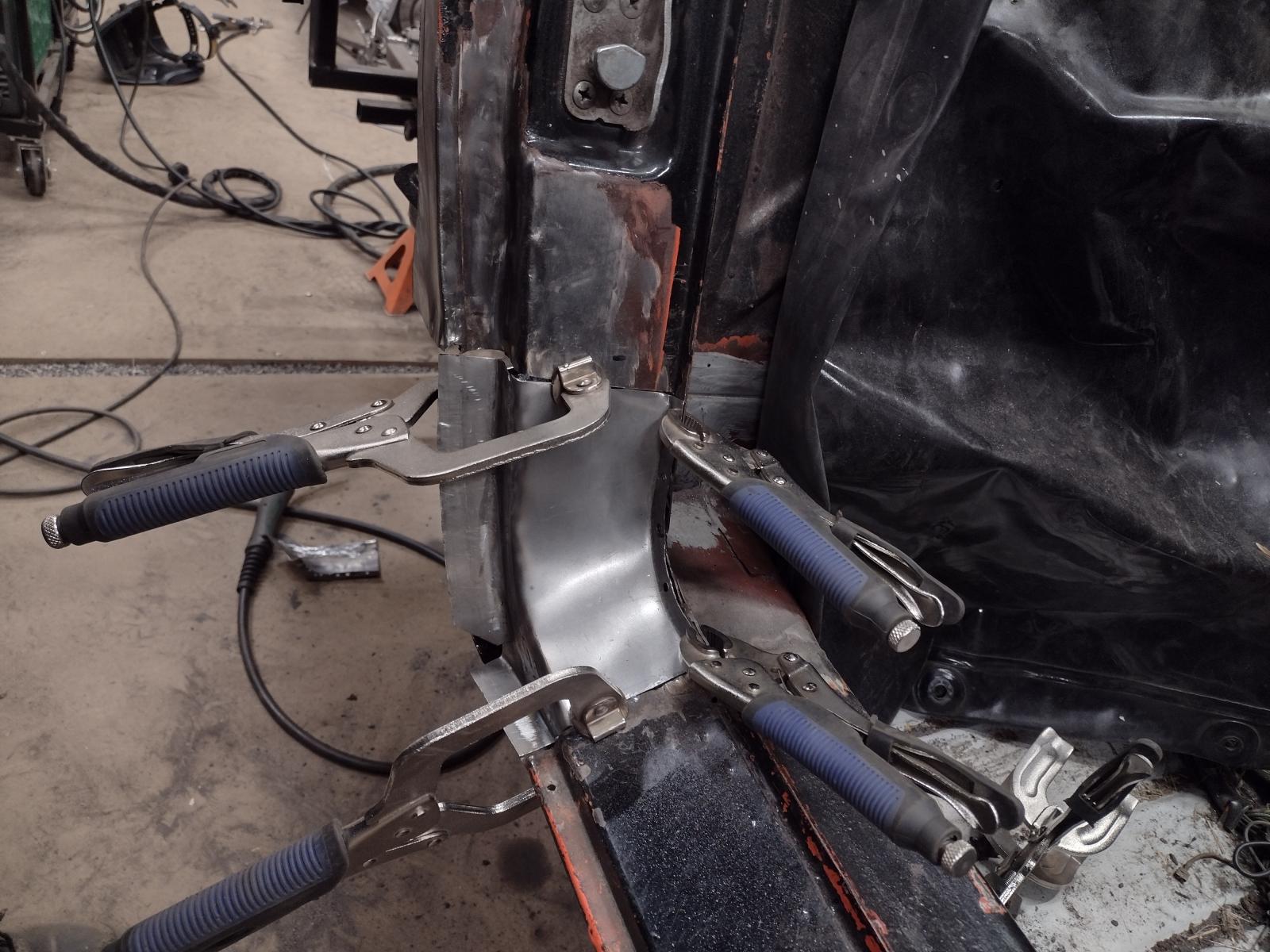

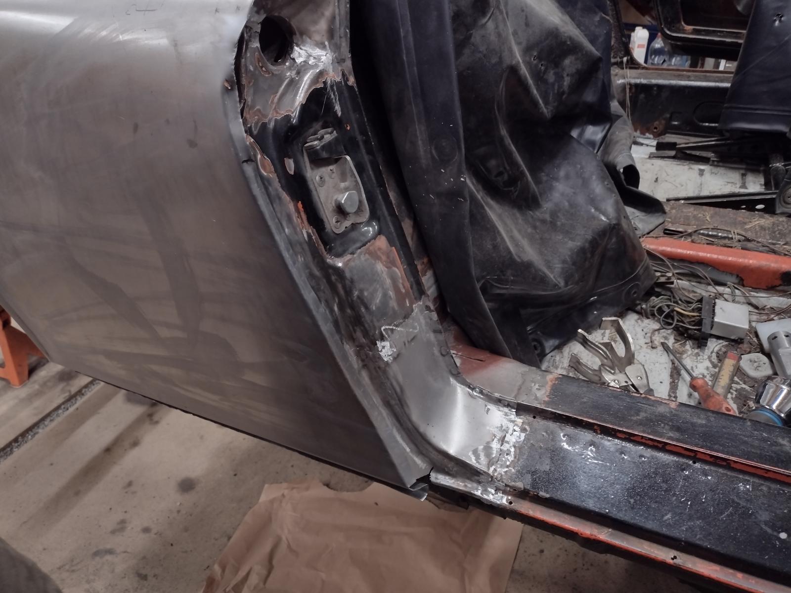

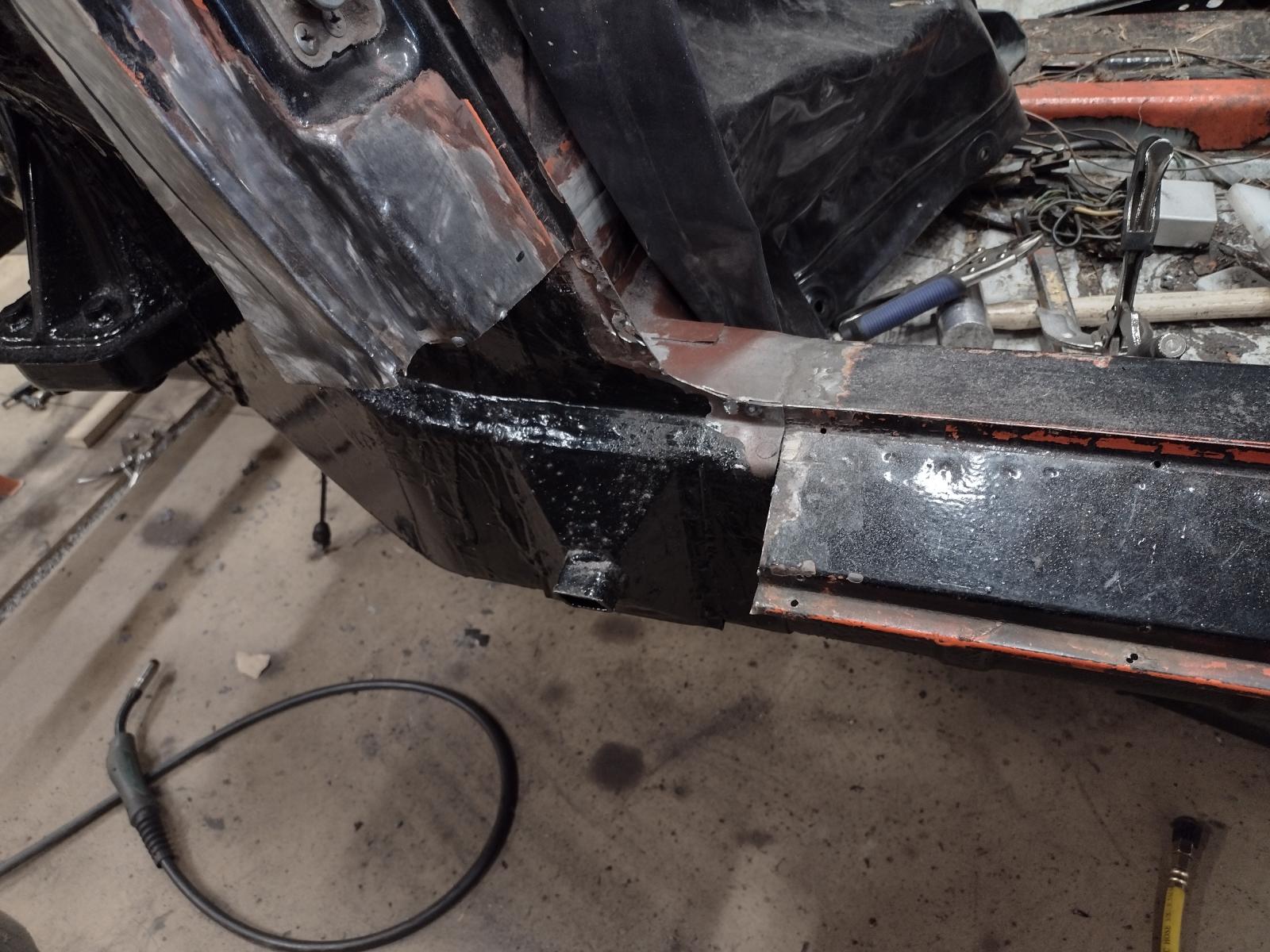

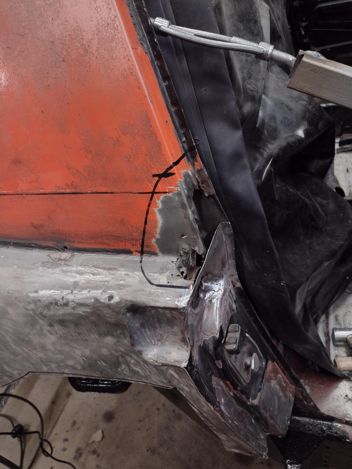

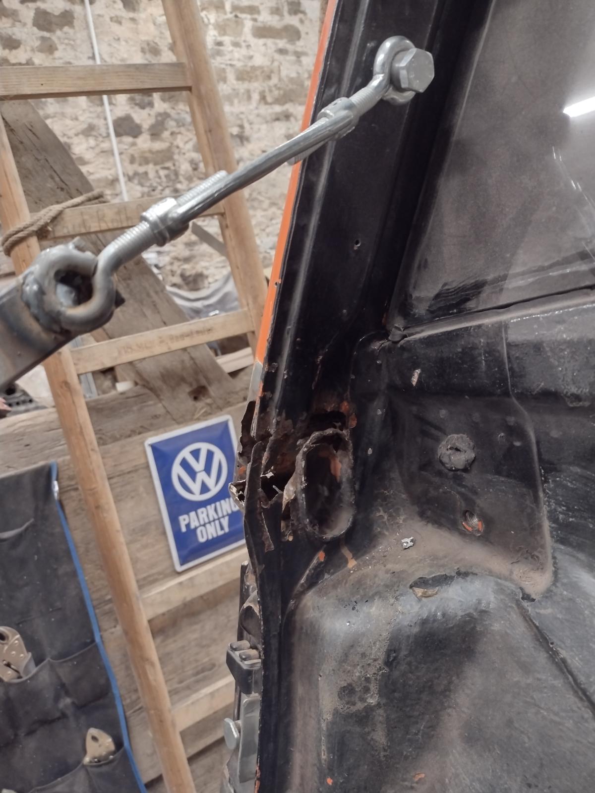

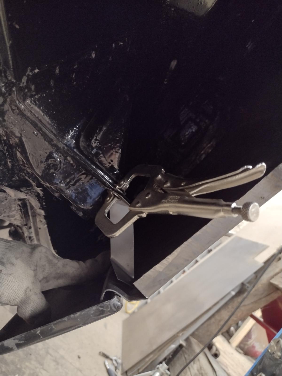

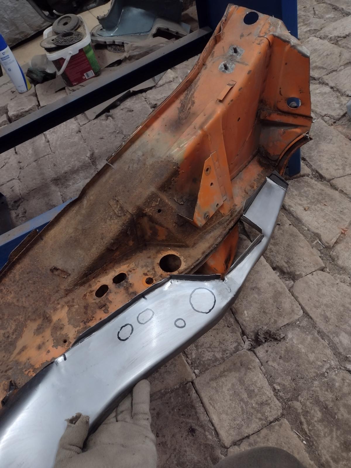

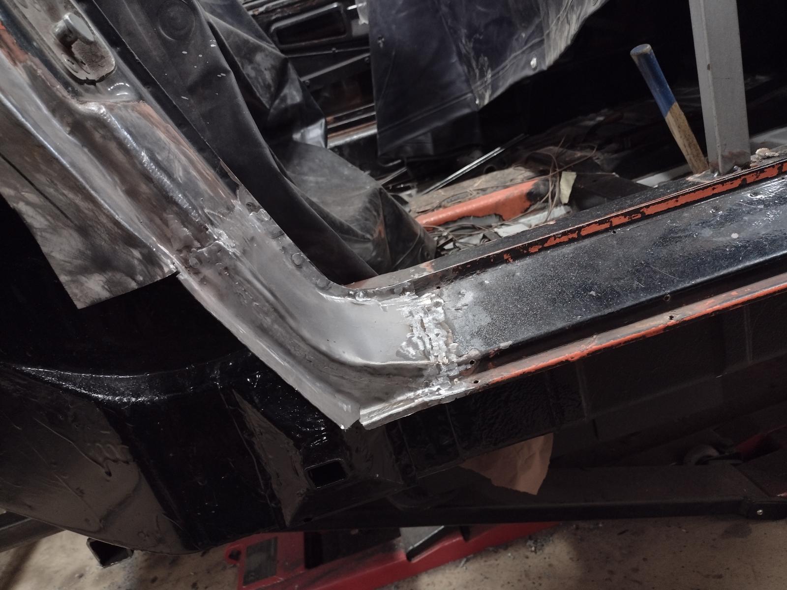

Next step was the bottom of the B-post..here you go :
Empty space:
Home made part being adjusted:
  #47

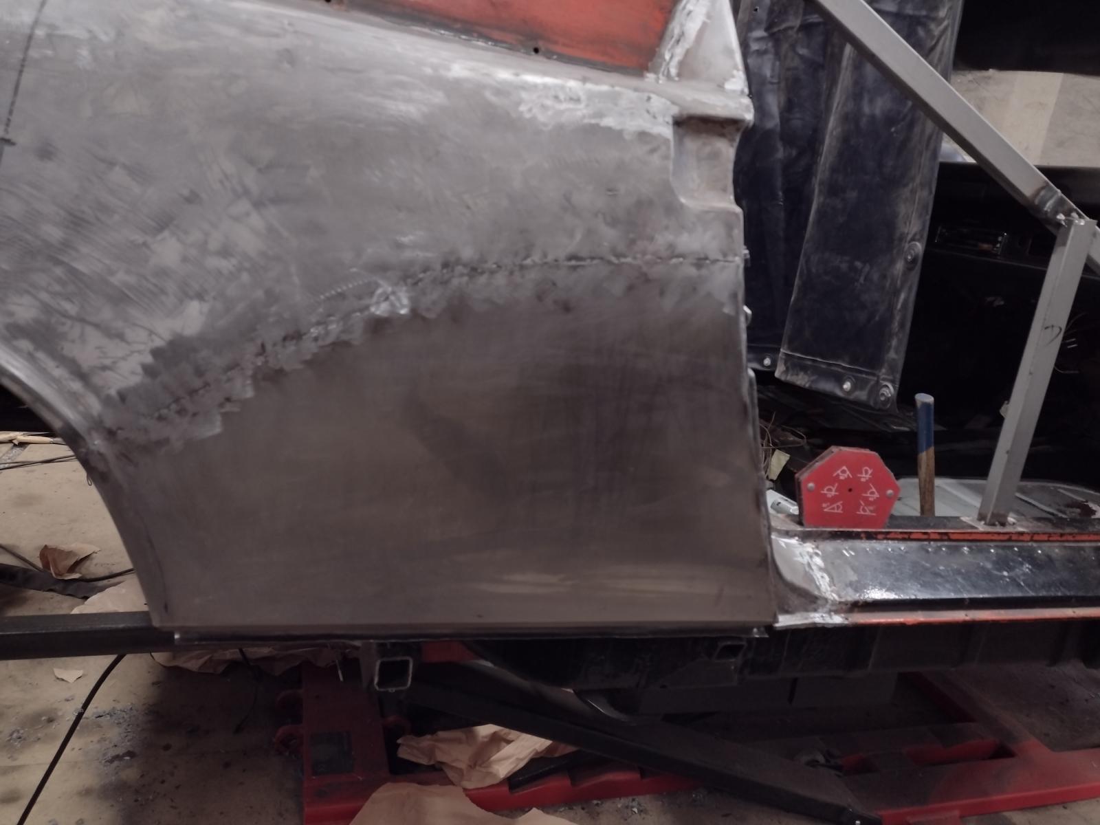

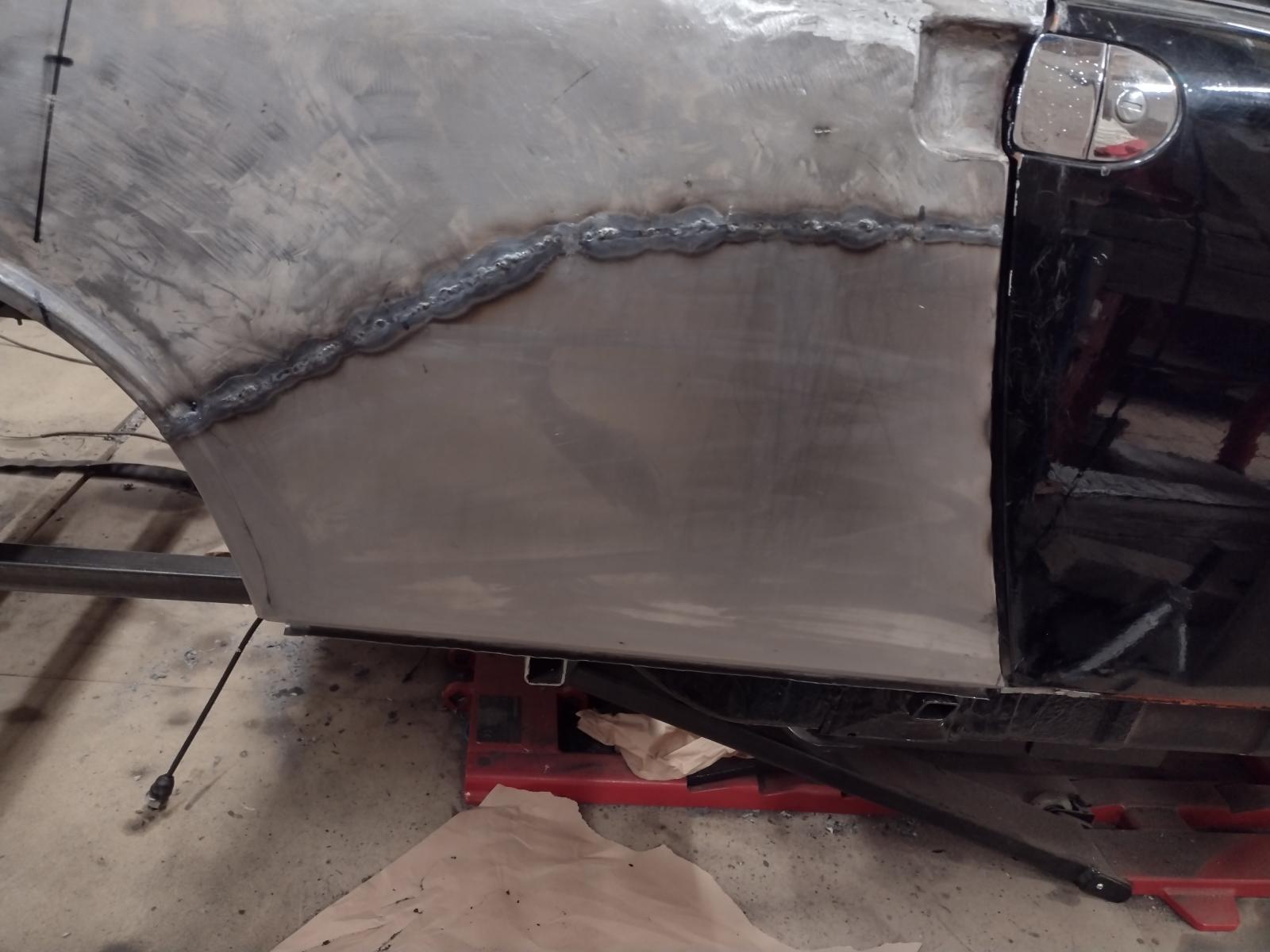

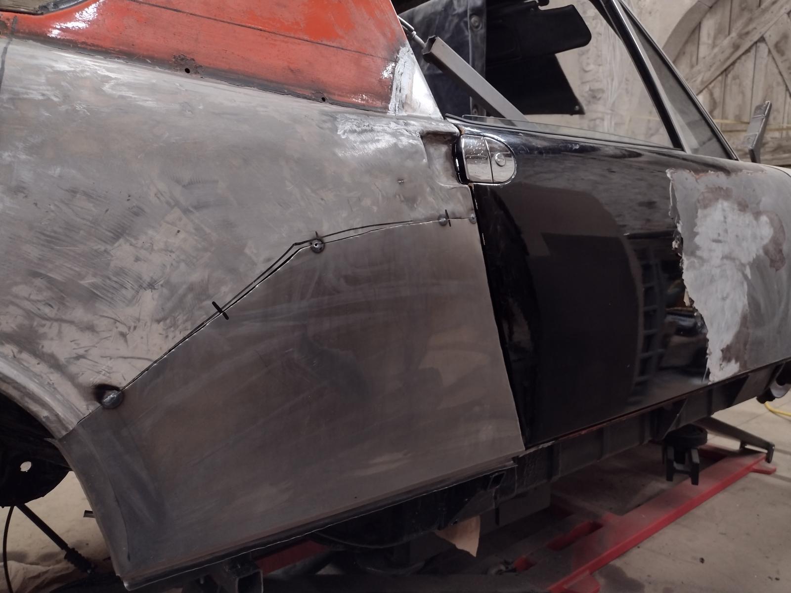

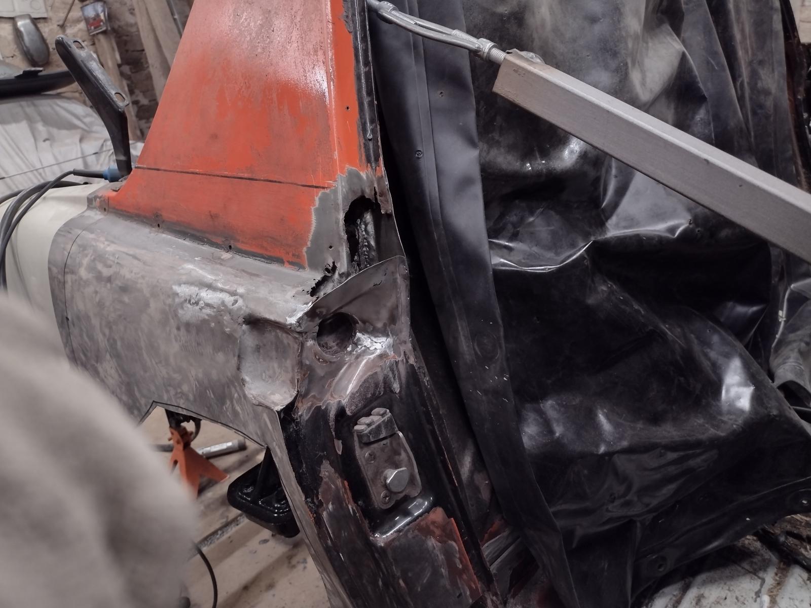

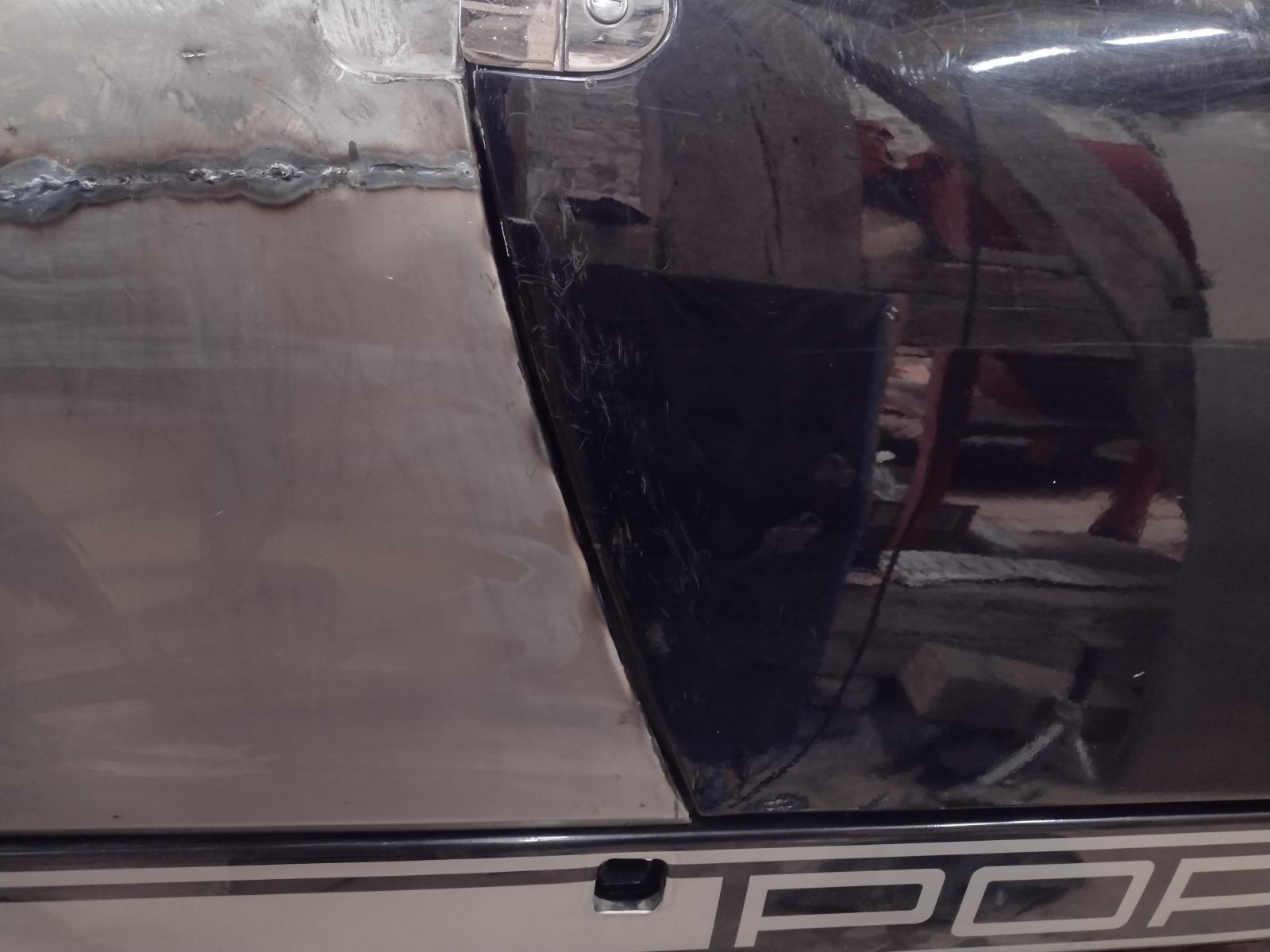

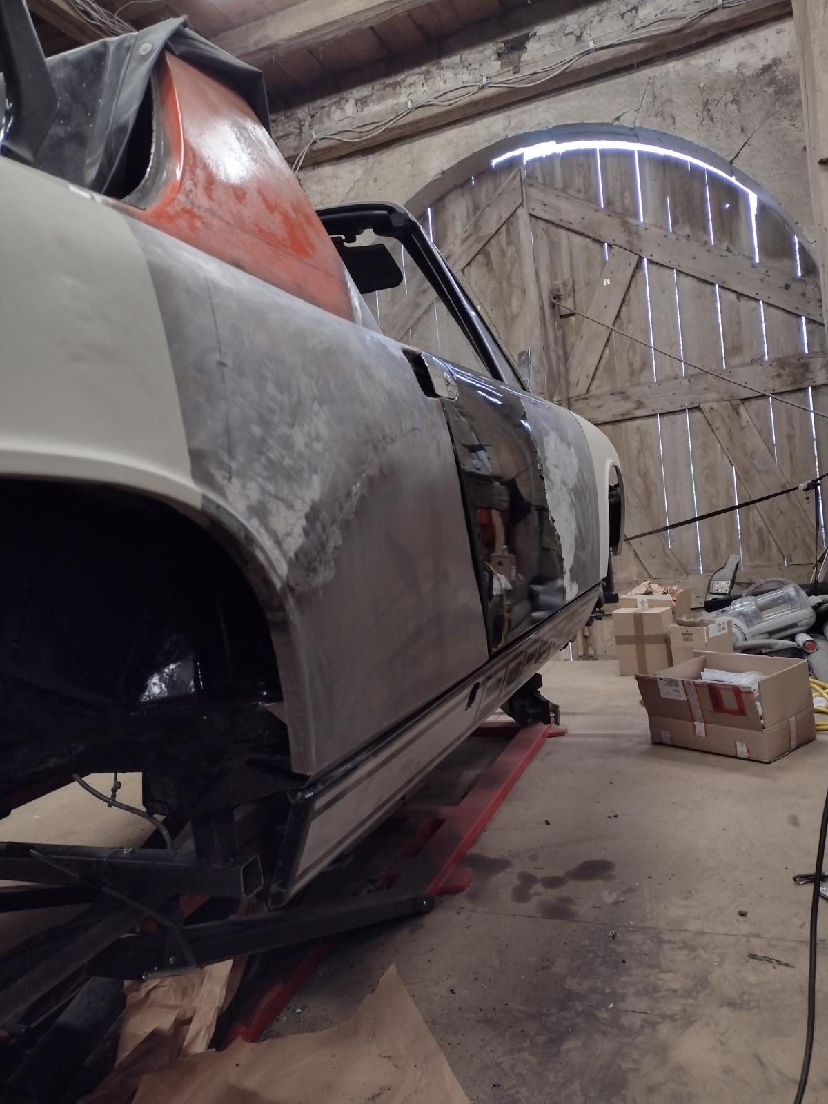

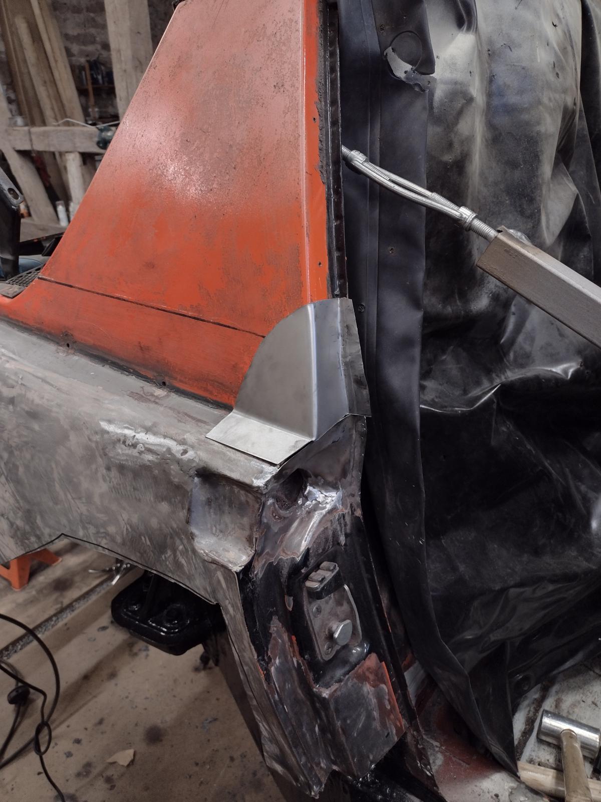

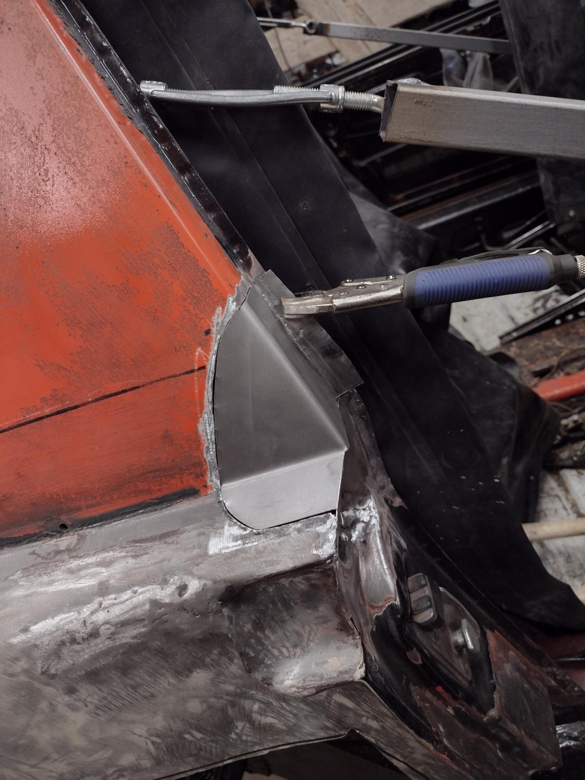

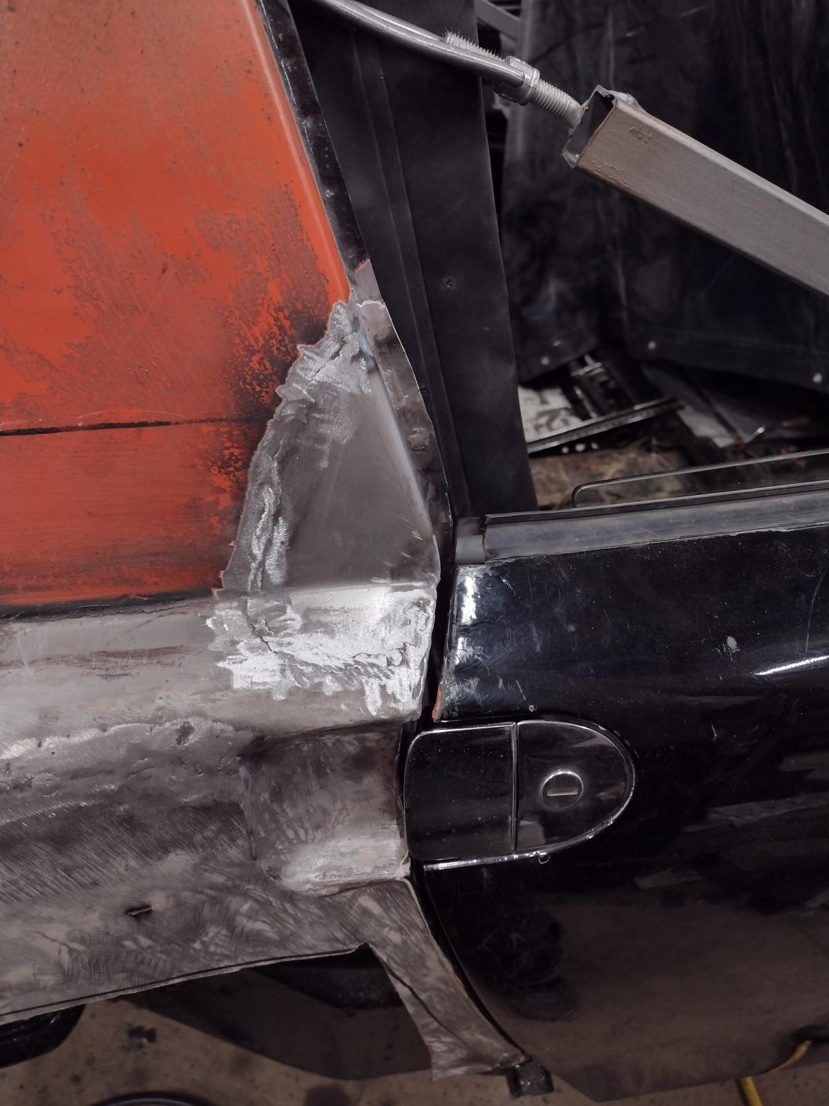

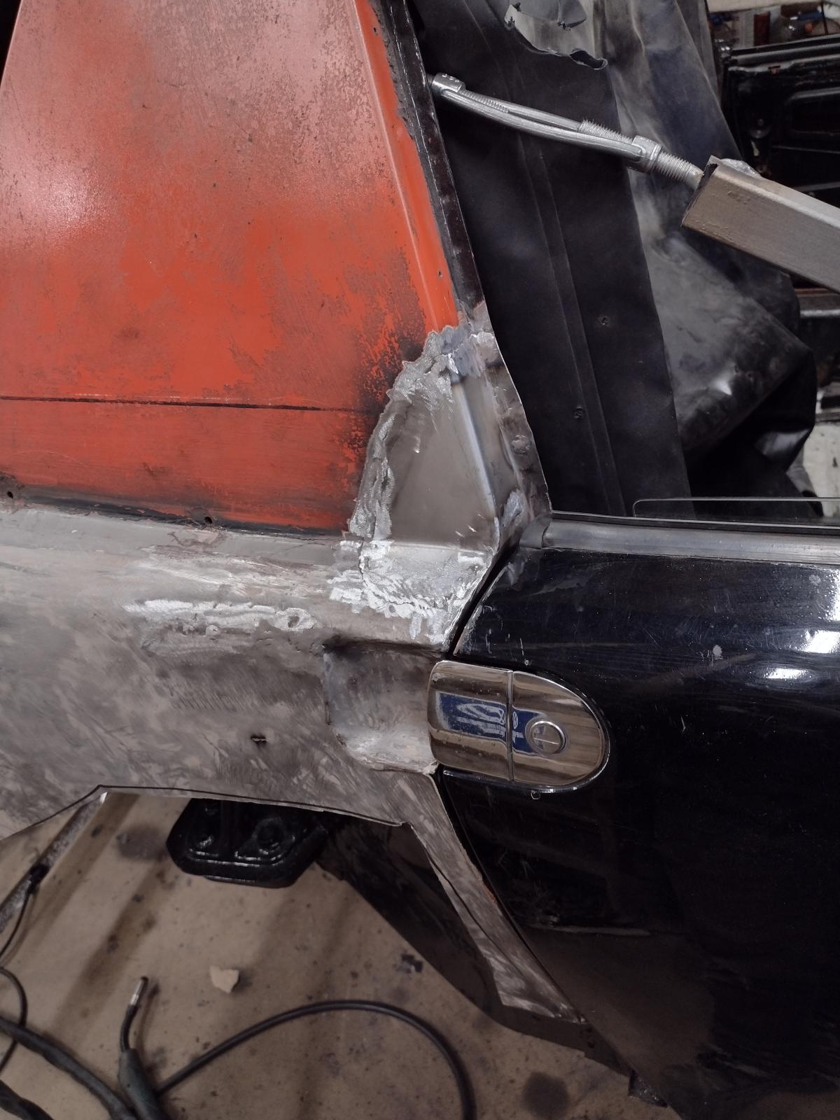

So, then comes a big step..the quarter panel!!
I made it myself of course..first, adjustment:
And then cut, tack welded:
And then welded:
My door gap is so much better than it was!
Planishing:
And done:

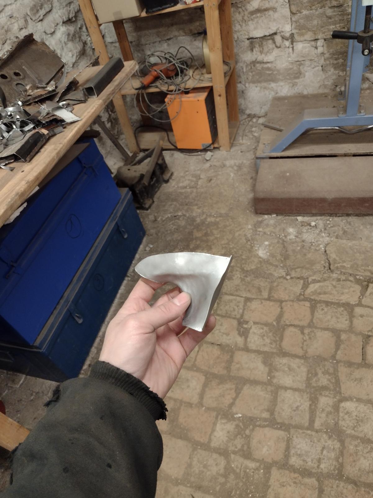

The last missing part was the small bracket at the front of the wheel:
All looking good:
Thanks for following along,
