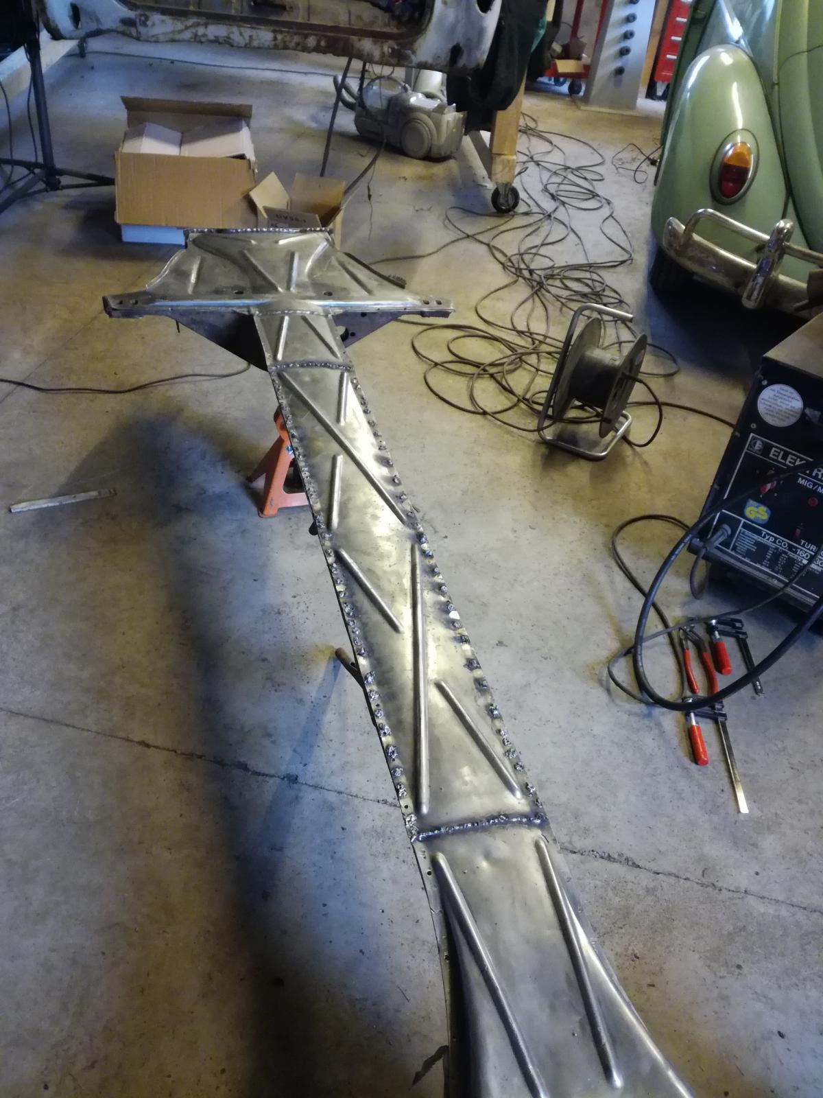

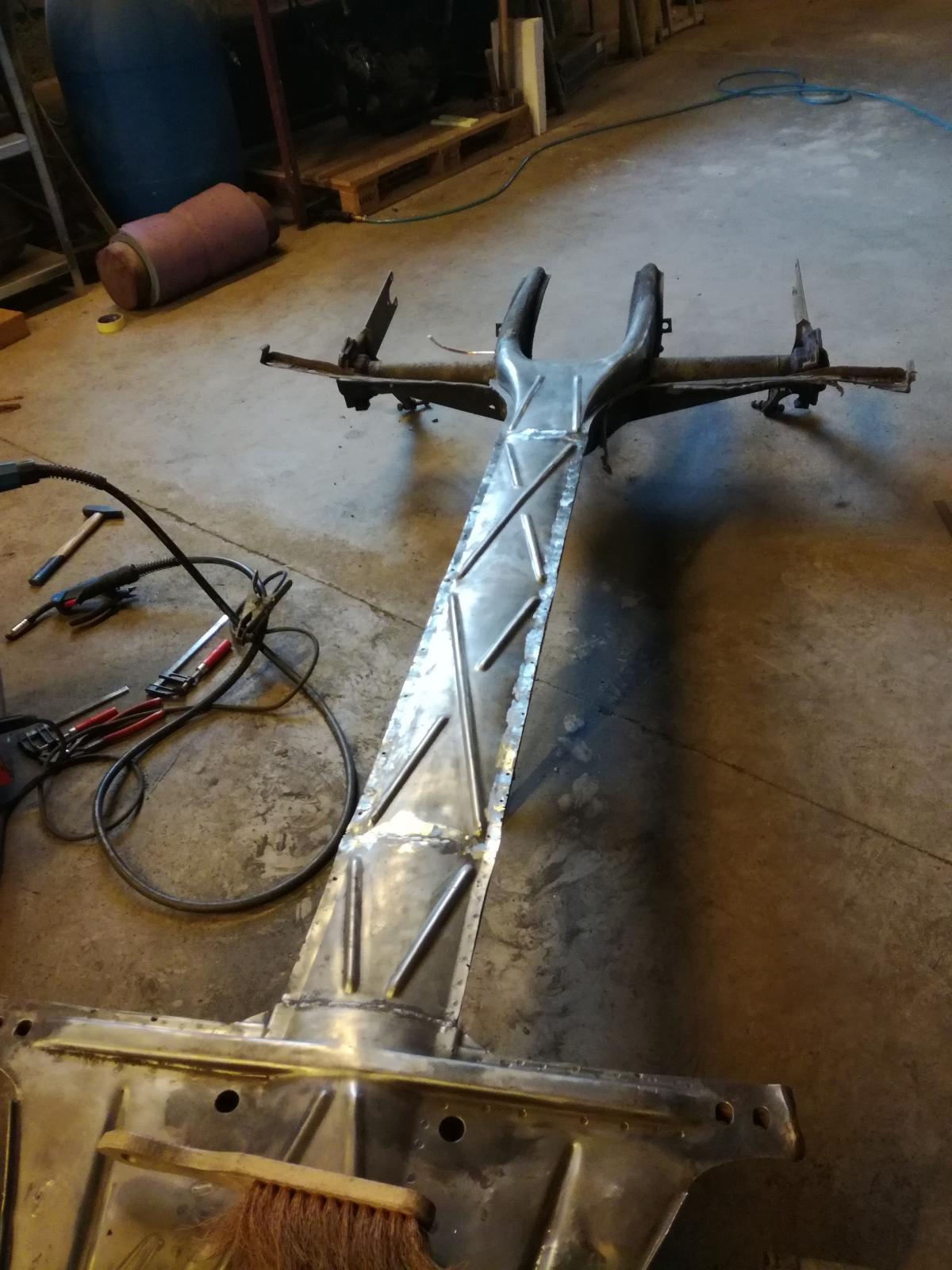

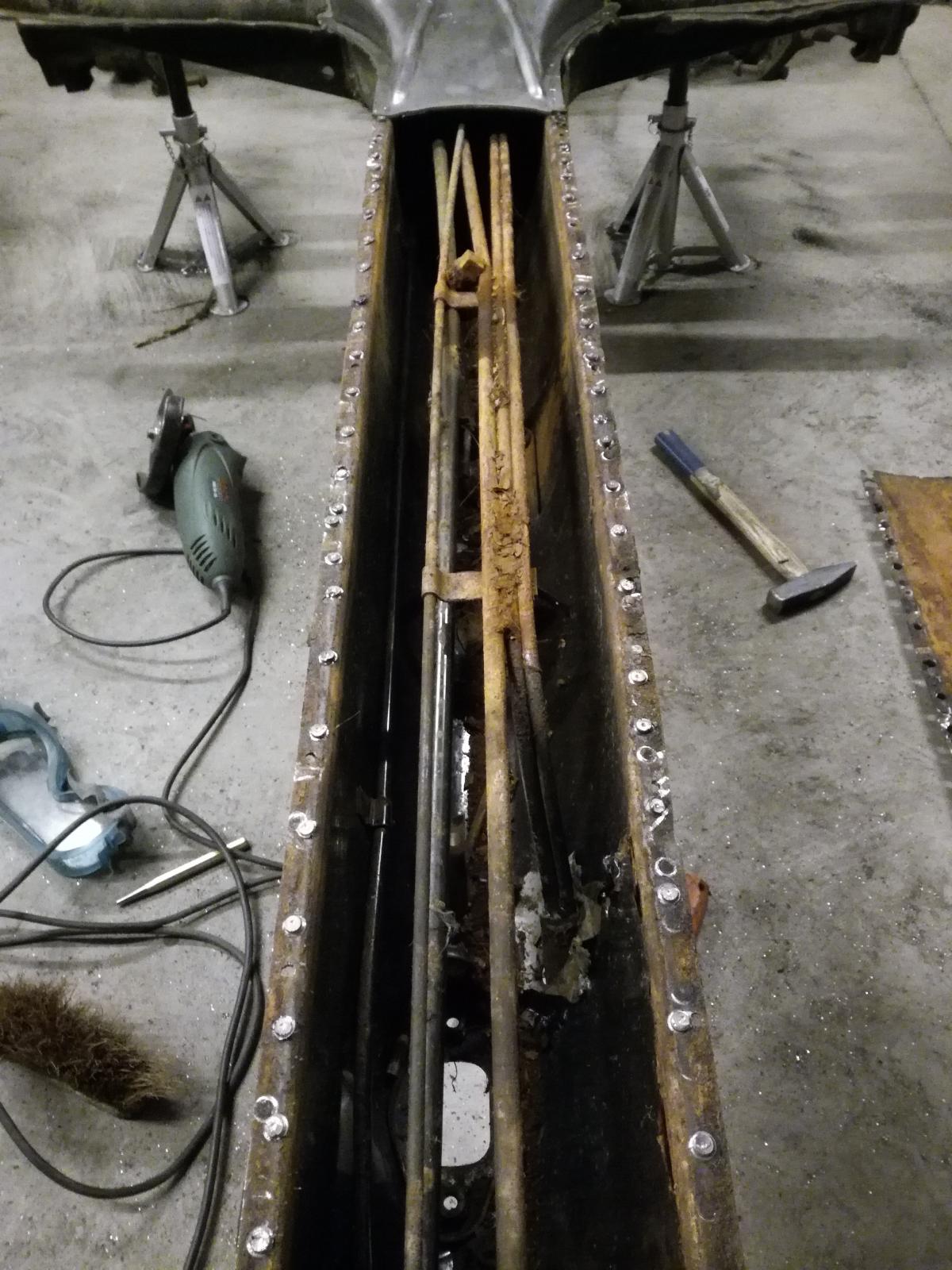

I first decided to start on the frame, removing the undercoat:
And then preparing to its opening as the fuel line was untight:
Opened!
Then it was time to change all the rusted lines and close it back..
Of course with rust protection!
Closed:
And protected:

Were able to pressure test the fuel lines before closing it all back up?
Marcus
aka. Gojeep
Victoria, Australia
http://willyshotrod.com
Invention is a combination of brains and materials.
The more brains you use, the less materials you need.
Old 03-11-2019, 04:33 AM
Antoine_P Antoine_P is online now
Posts: 285
Thanks a lot Marcus!
I am trying to do my best on it, doesn't want to do a show car but a (really) nice driver
To answer your question: I replaced the entire fuel line with a new one that I tested. All the tubes that I repaired as seen on the pic are only for cables like gas, clutch, heater,..

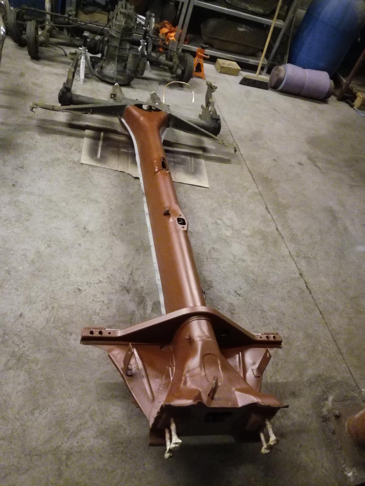

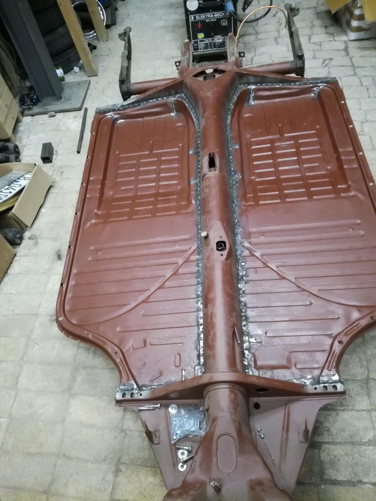

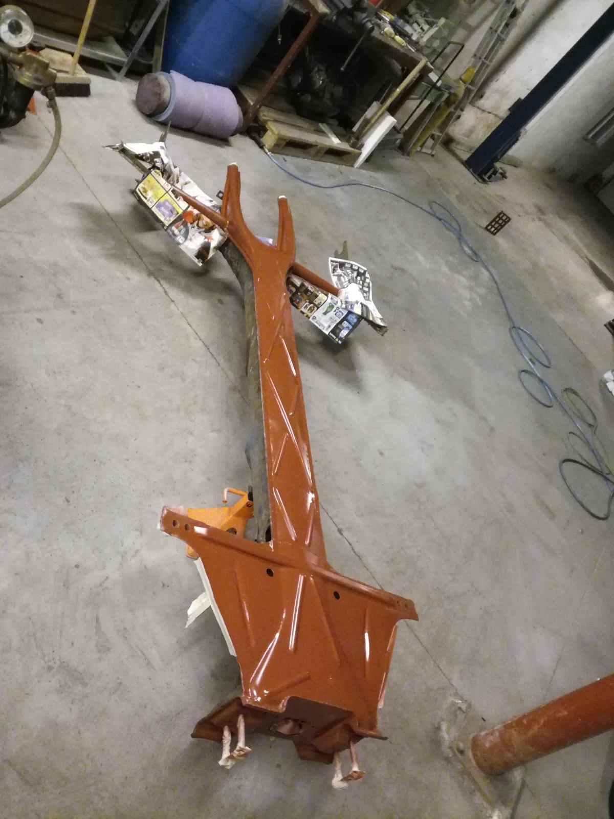

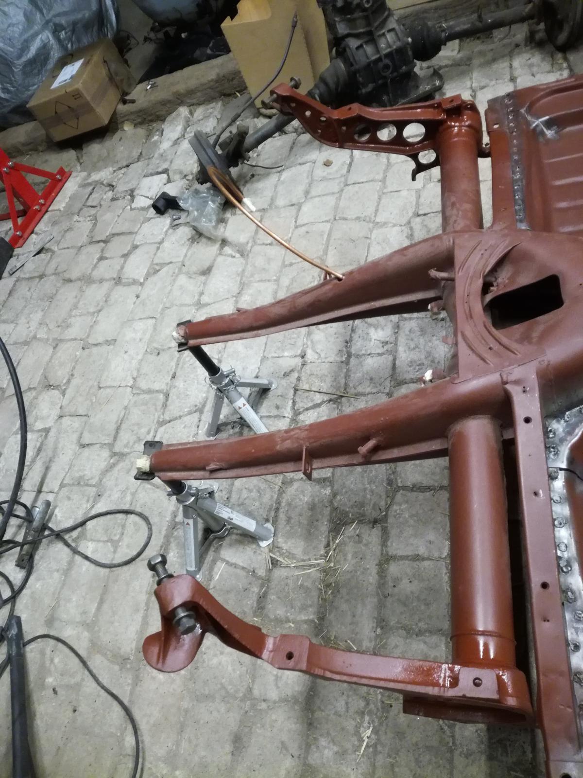

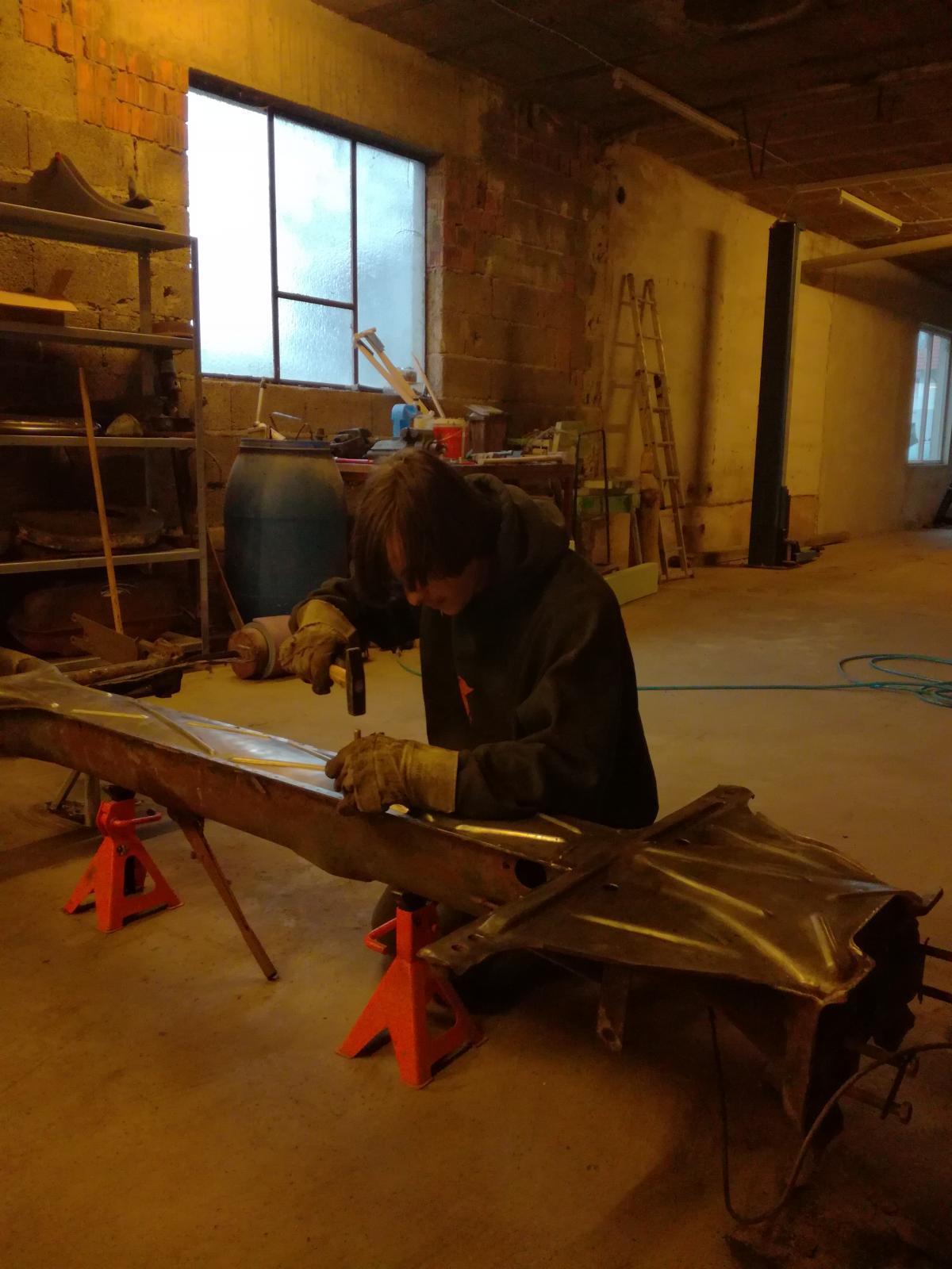

Now that the bottom was ready, time to turn the frame and do the same, clean and primed:

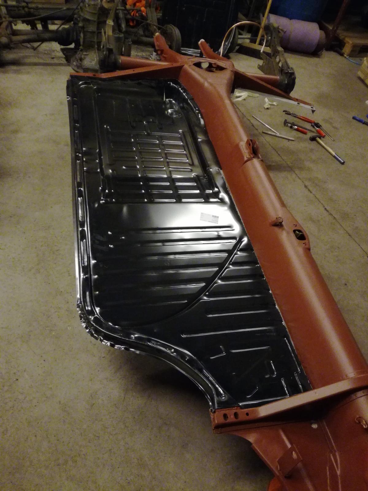

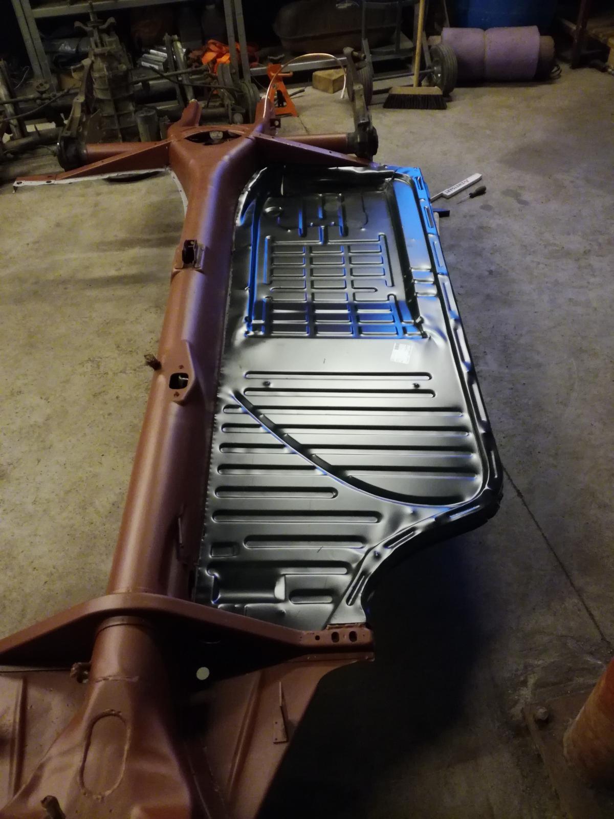

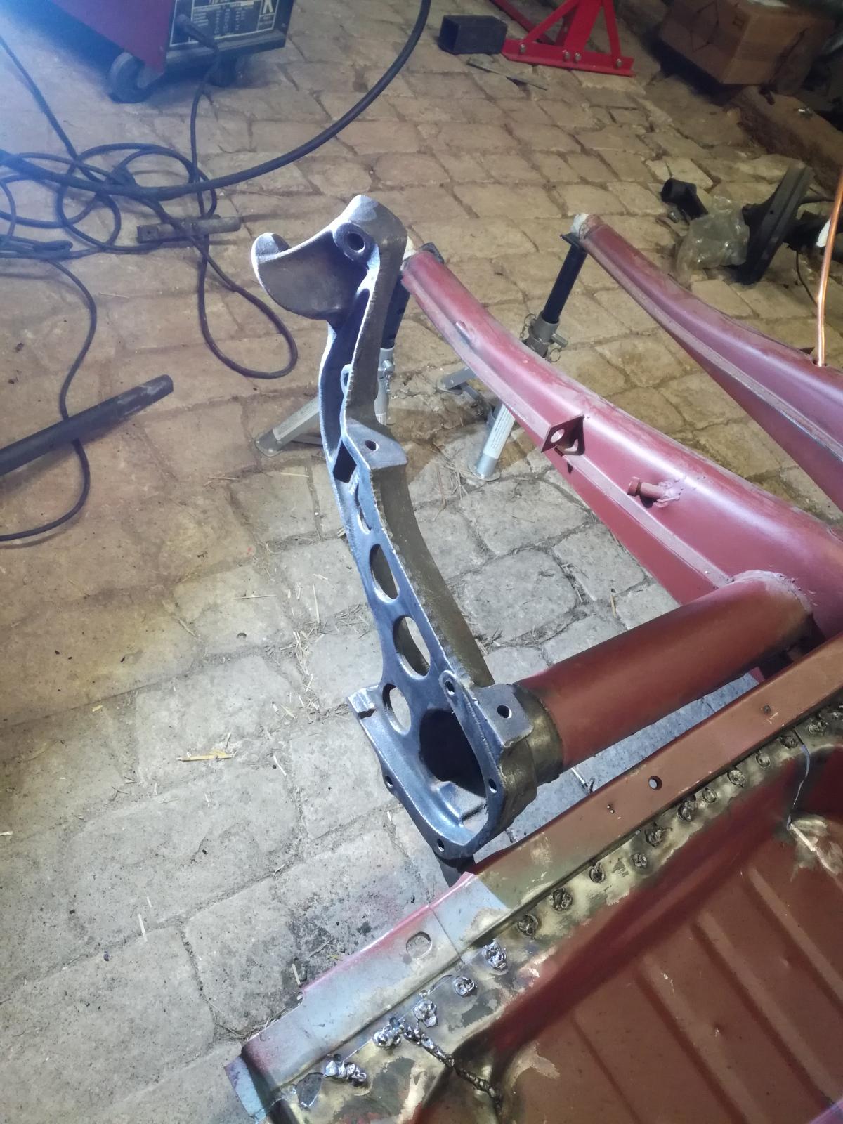

And then I started to adjust the half pan:
Used the future heater channel to adjust:

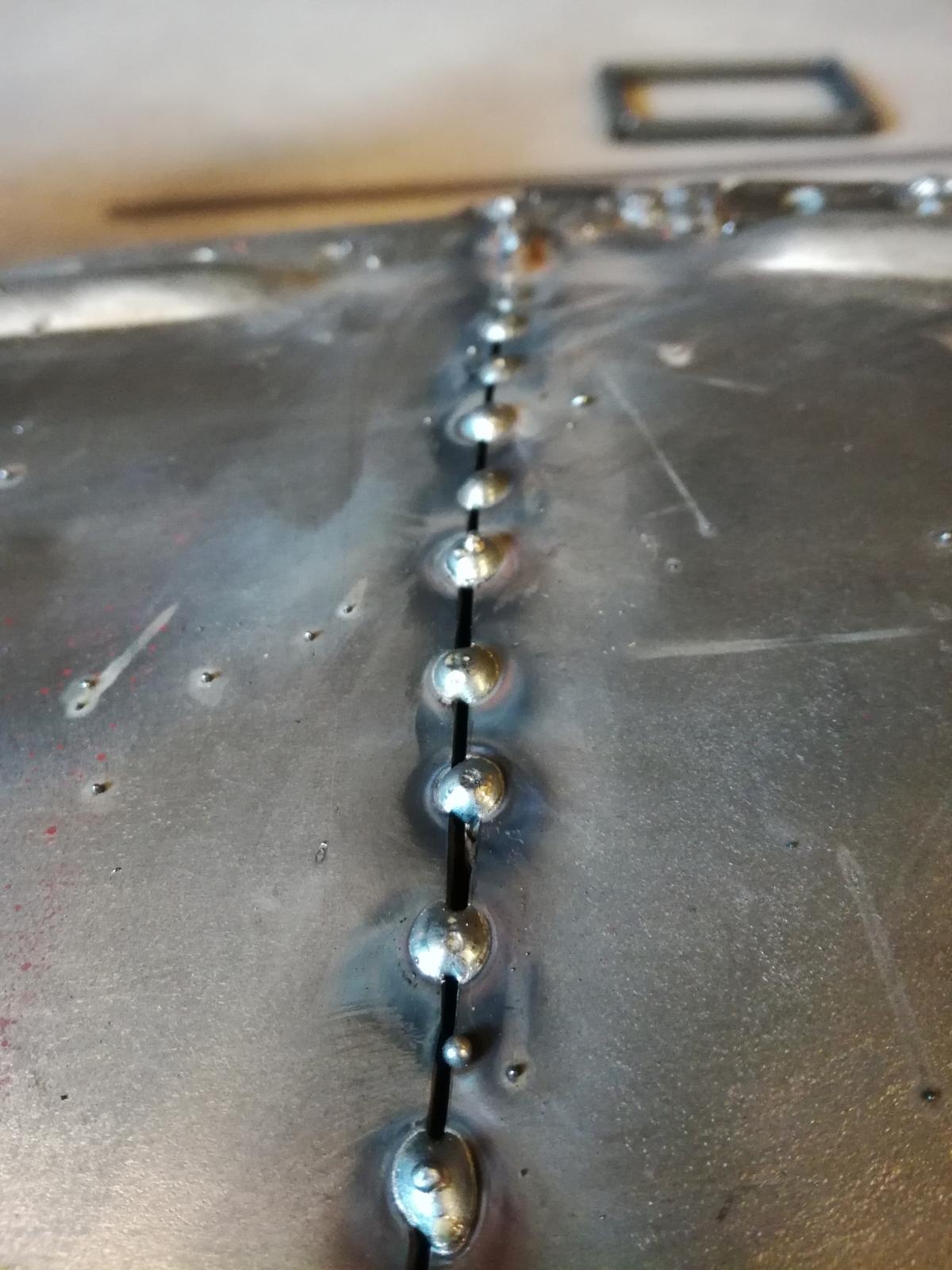

And then after cleaning/primering the half pan, it was time to weld them:
I also finished to clean/put in primer the back end:

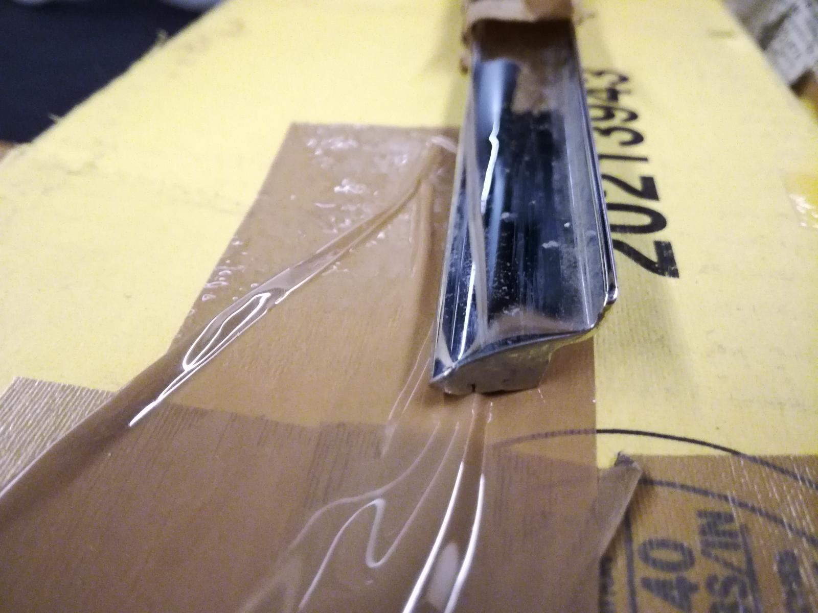

Well, as I am already here, I can also show you some of the parts I already found/bought

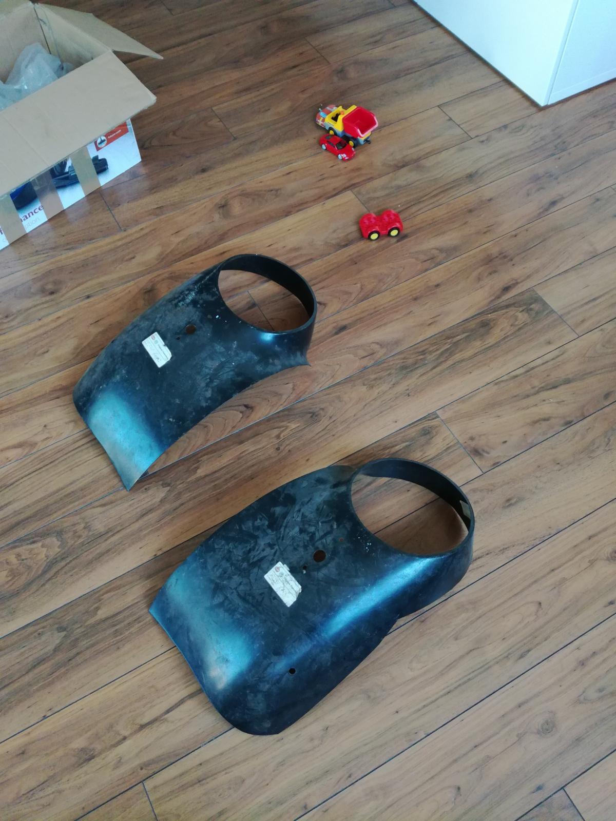

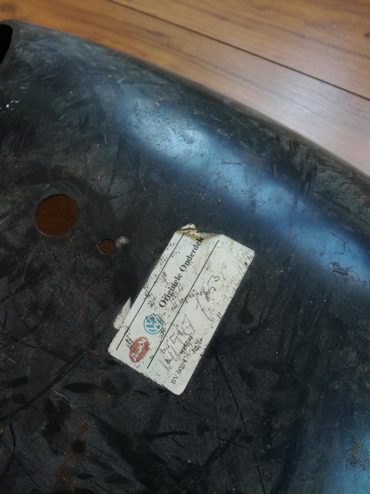

I got myself some NOS front fender panels:

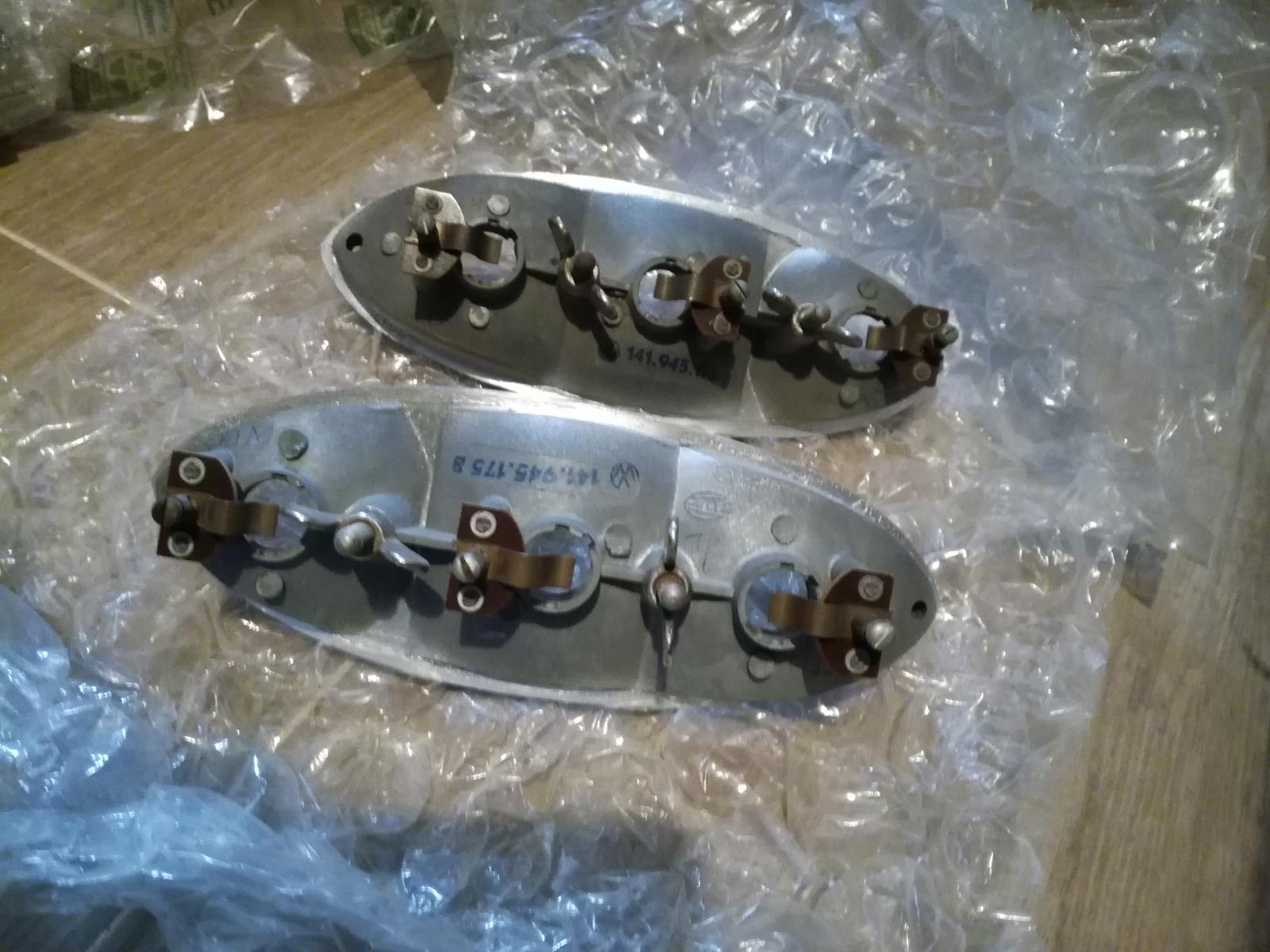

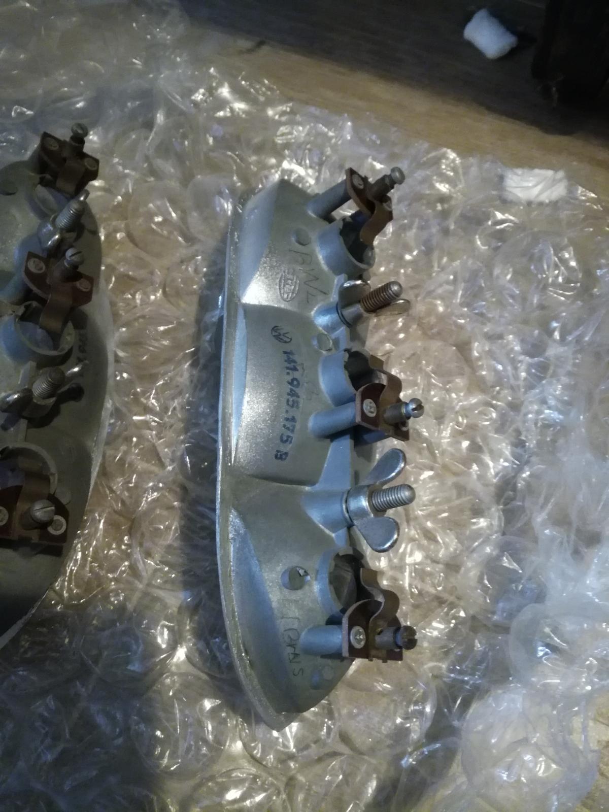

The 60 only rear light backplate:

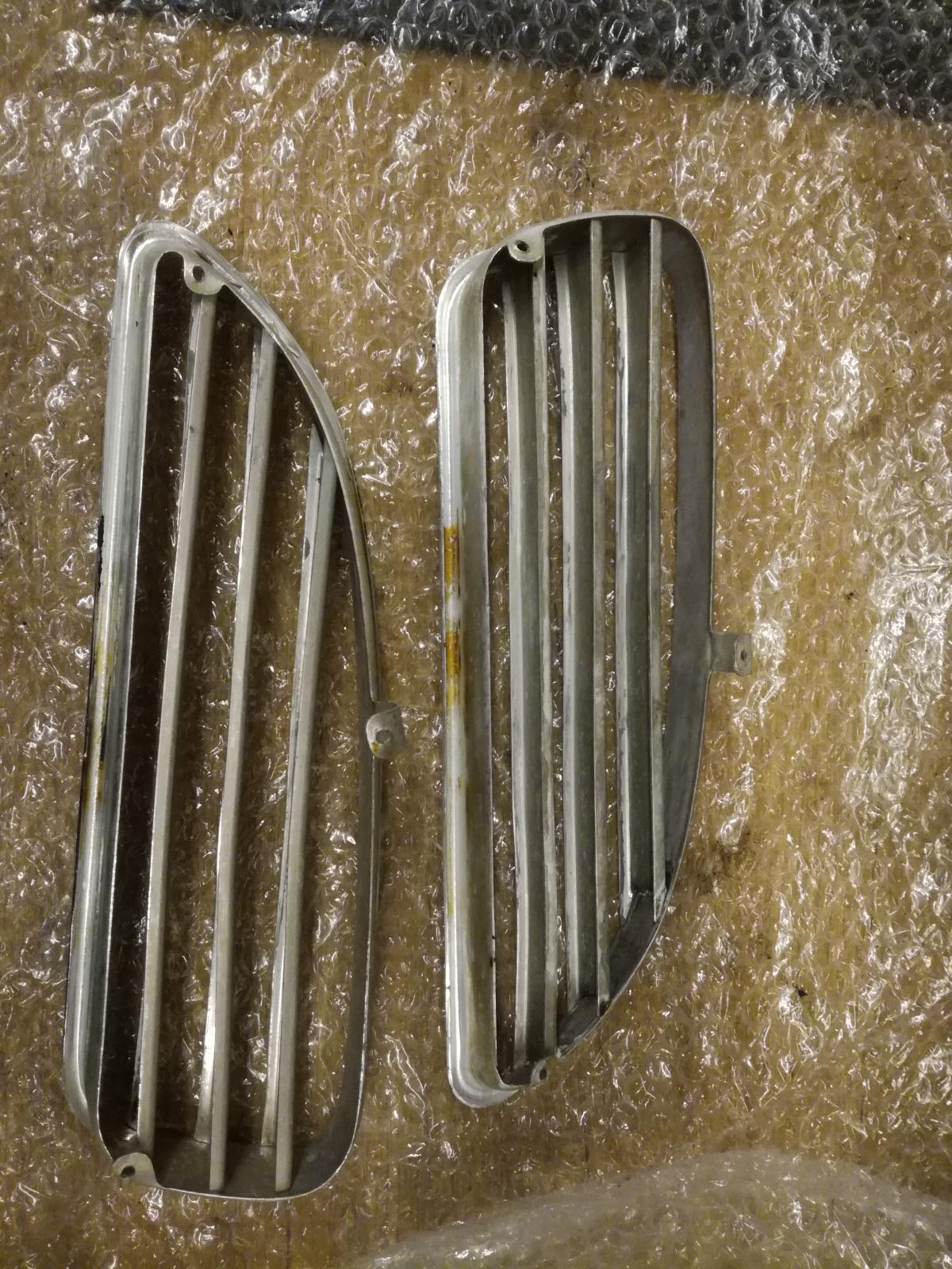

The 60 only nose grill with their 3 screws:
A NOS indicator switch:

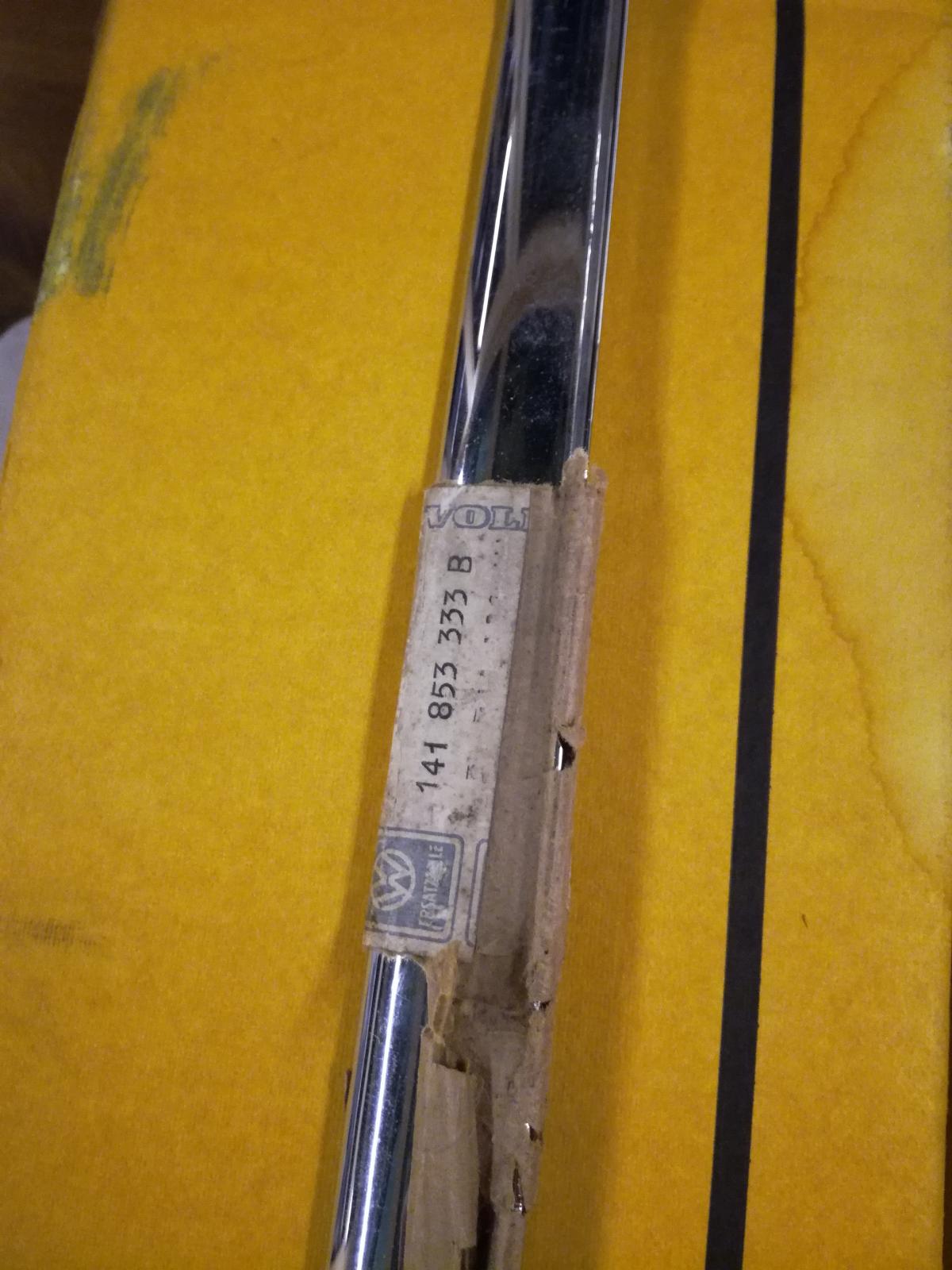

And 1 NOS and 1 good used chrom trim for the door, also a 60 only part:
