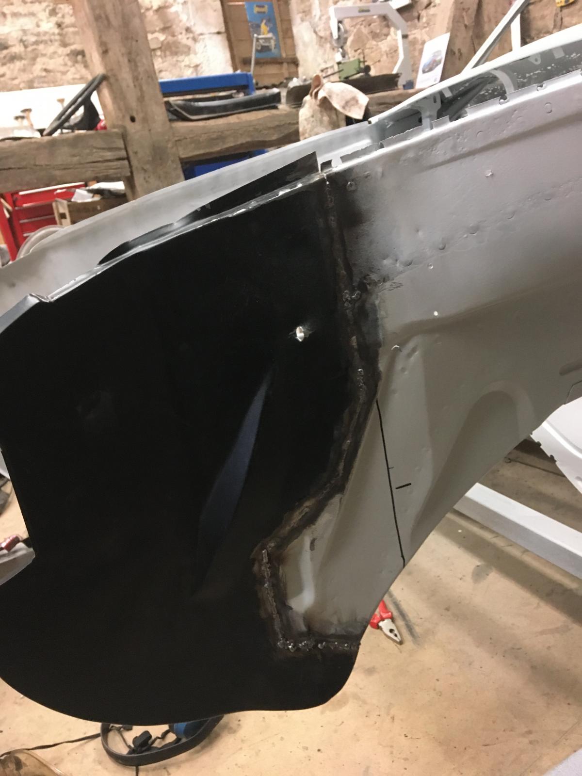

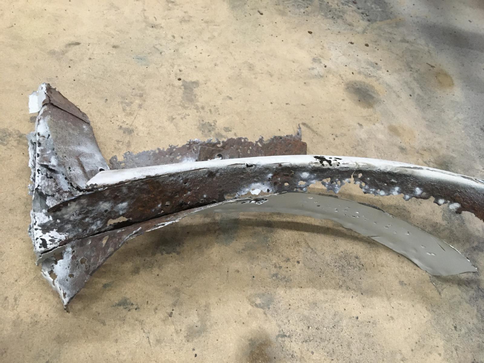

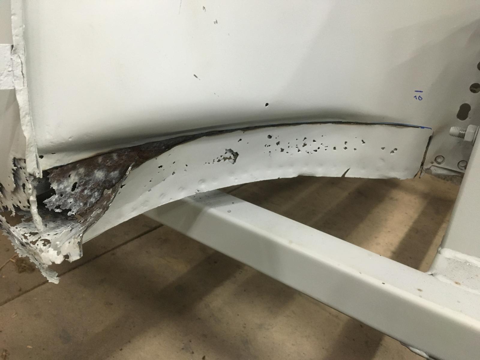

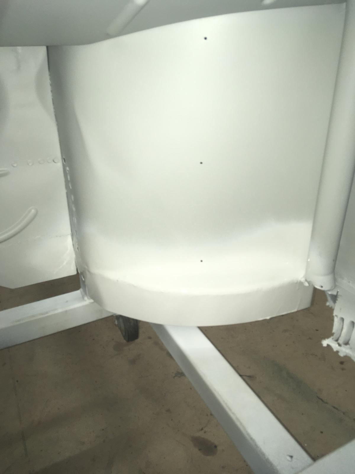

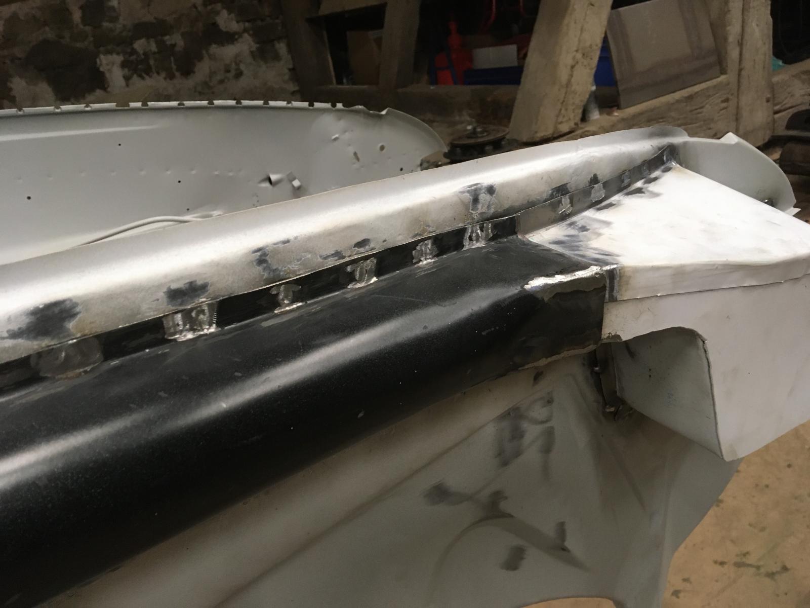

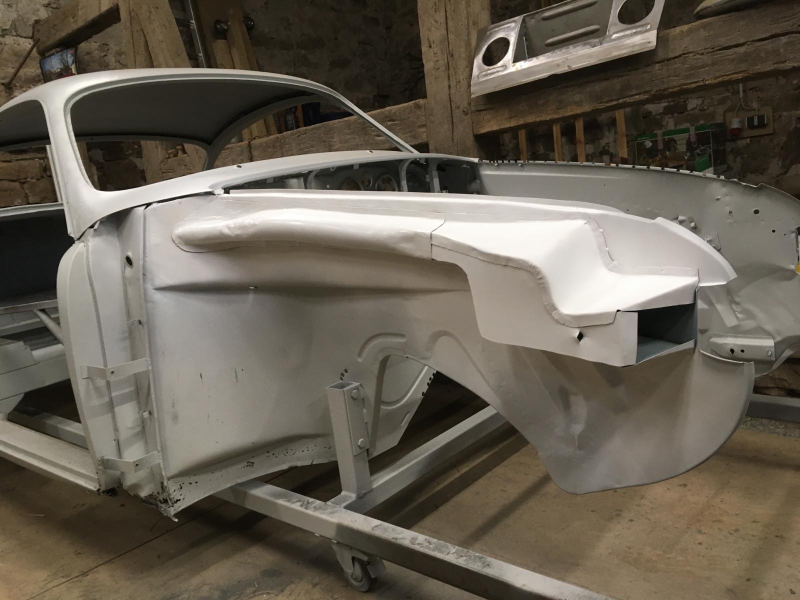

There was still one last step to finish the right wheel well:
Yes, this bottom part was pretty rusted out so time for it to go..preparing the replacement:
under it wasn't better either:
all cut:

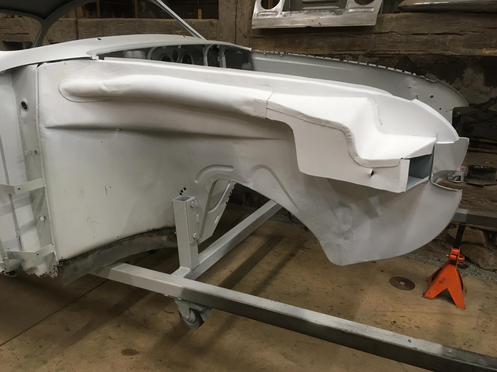

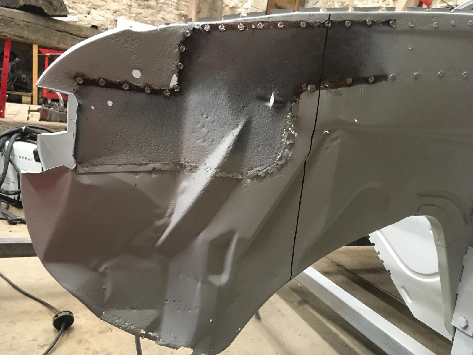

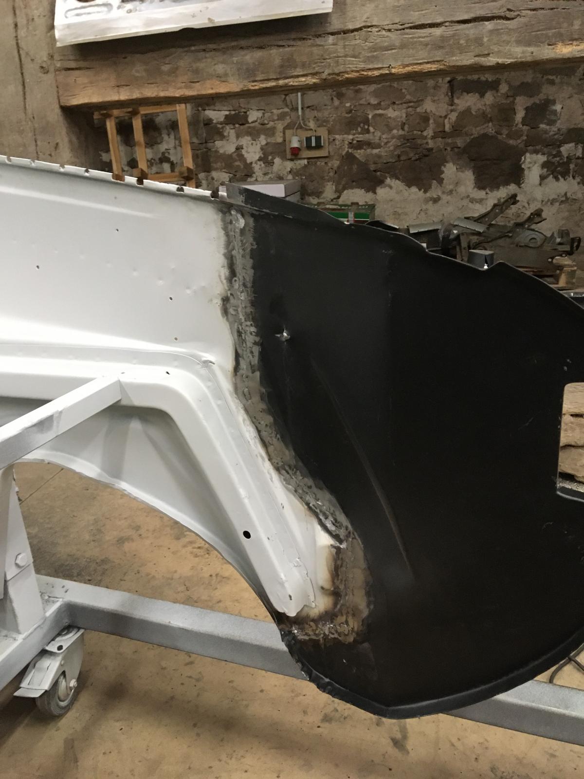

I changed the wheel well metal and the new heater channel will then be welded on it. So let's take the TIG out :
and fully replaced:
and in primer:
Feels so good seeing the progress here:

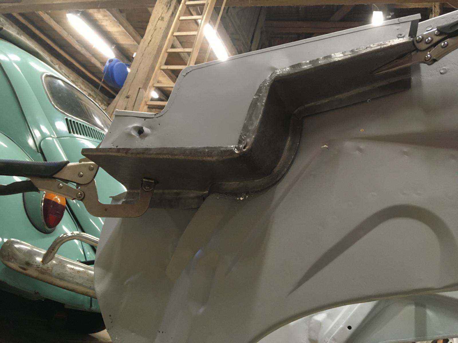

So, still doing some progress on that project

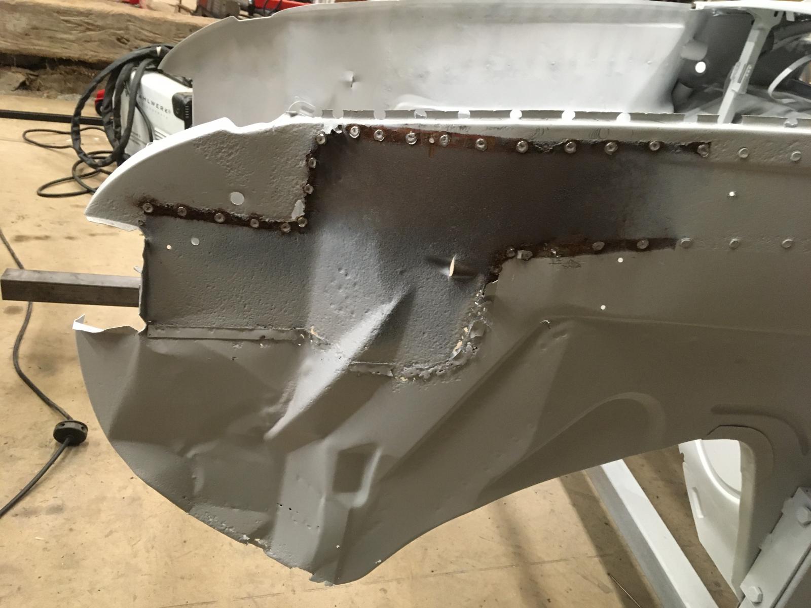

After finishing the right side, I started on the left.

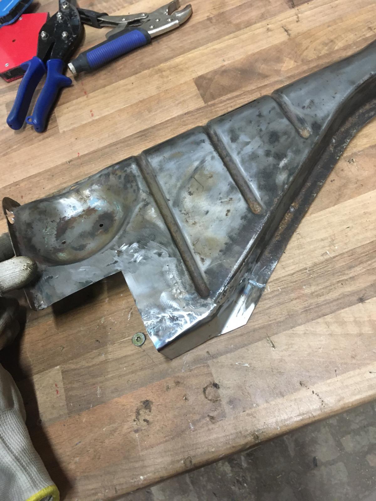

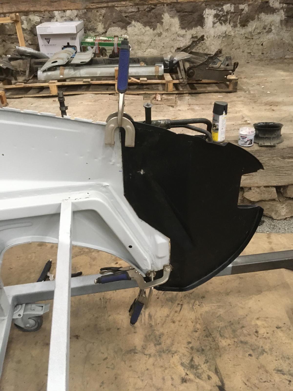

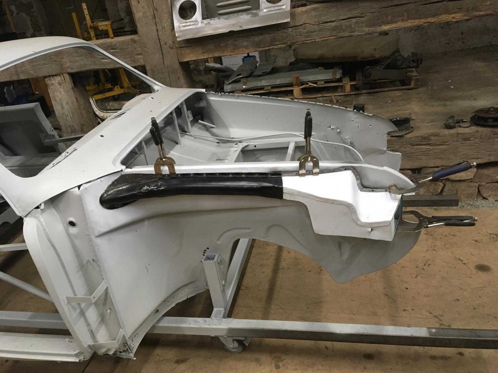

First checking/adjusting the parts I made for the left airbox:

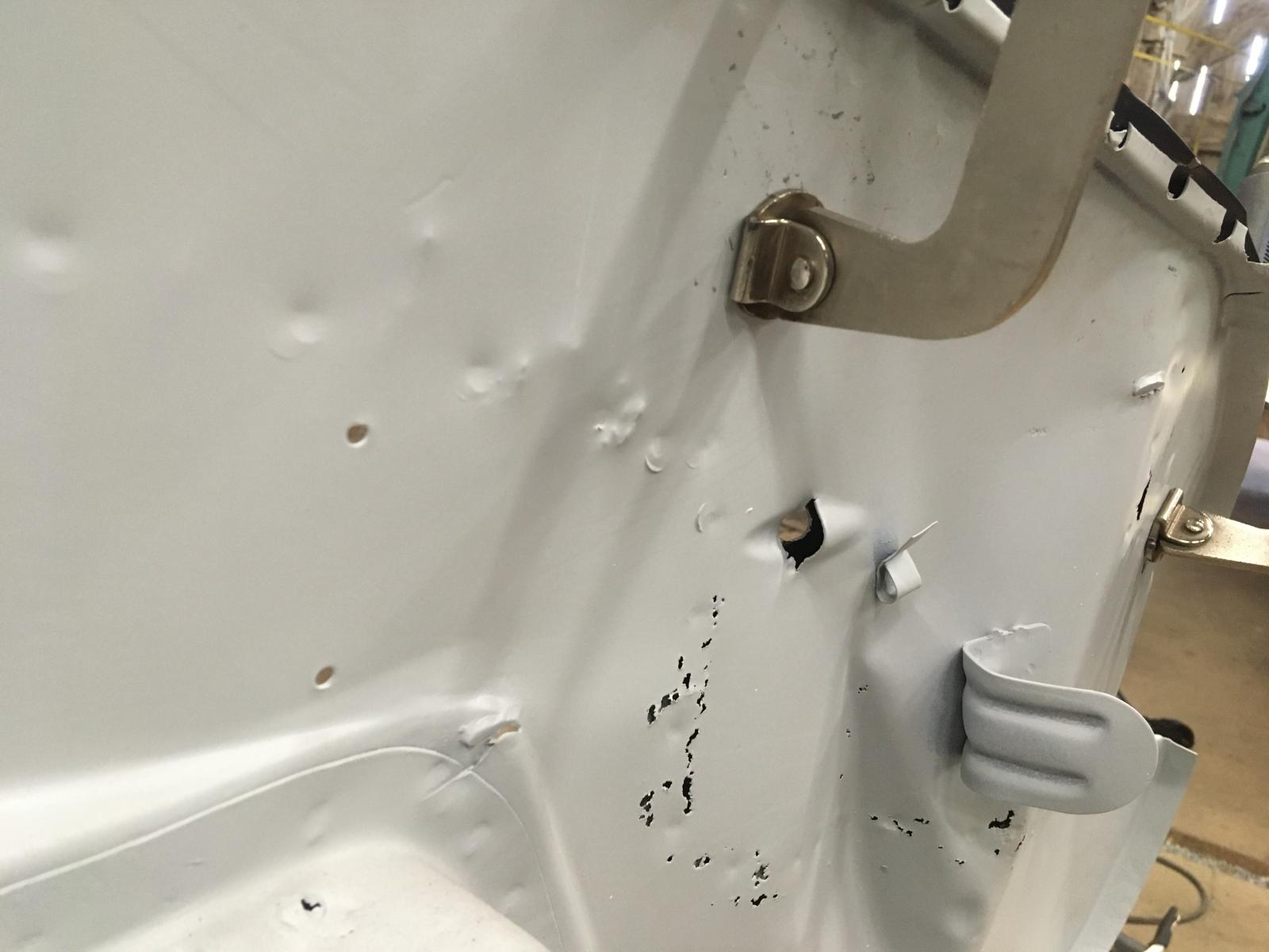

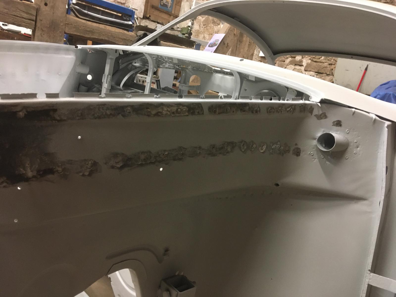

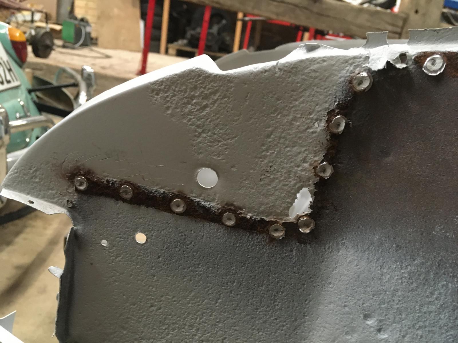

And then removed the old rusted airbox:

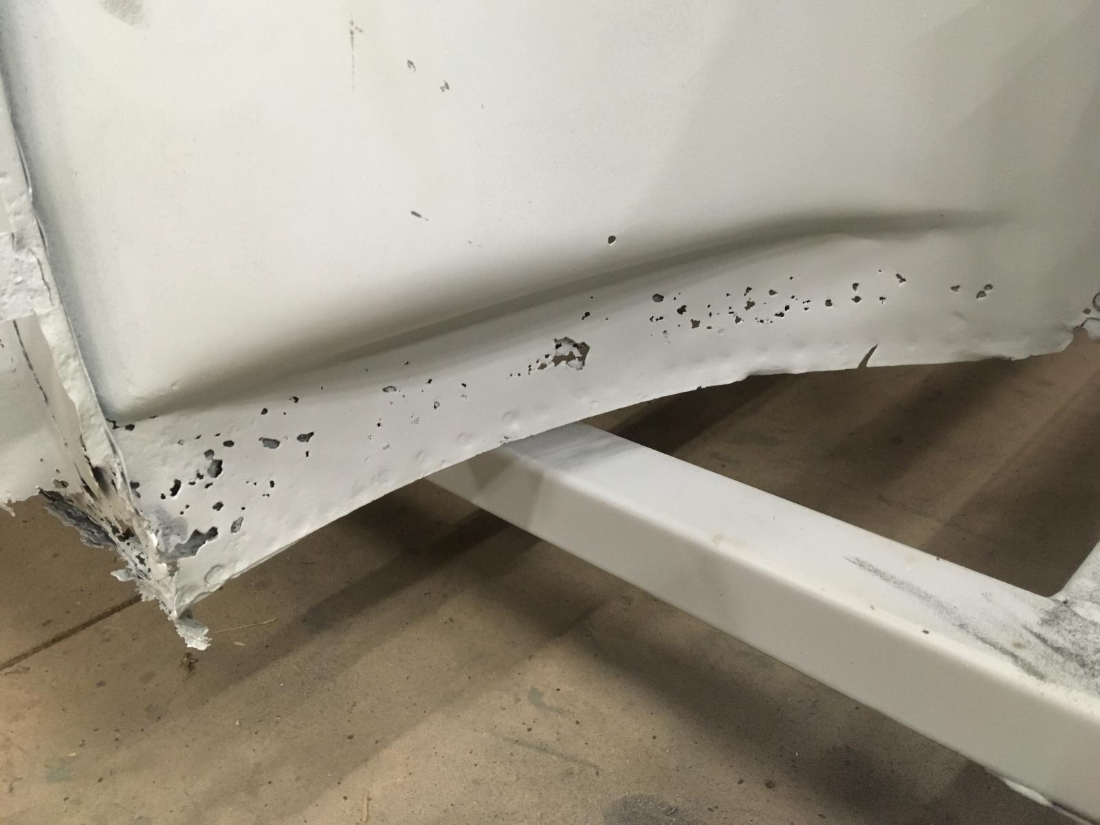

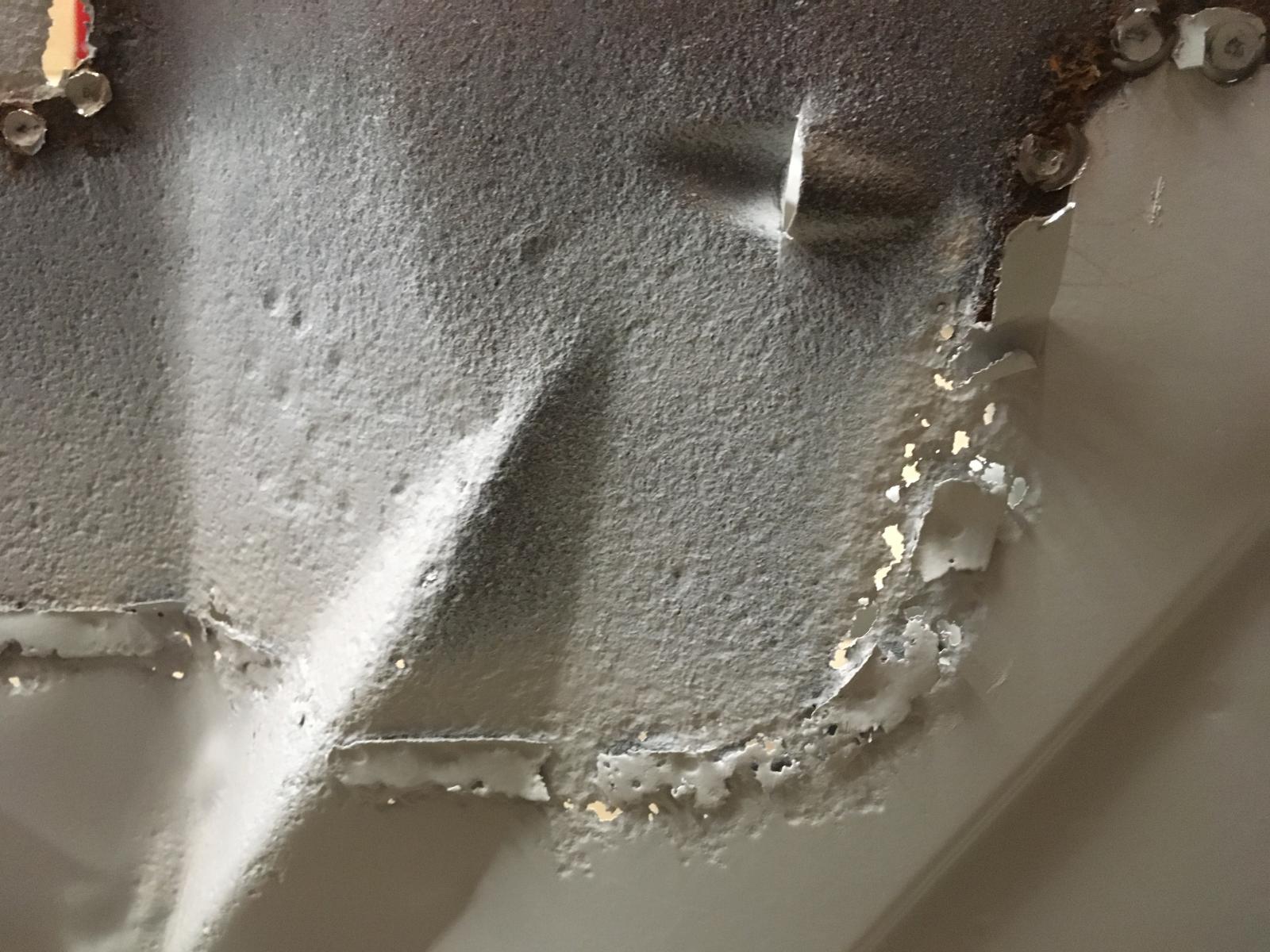

Under it.. well some holes

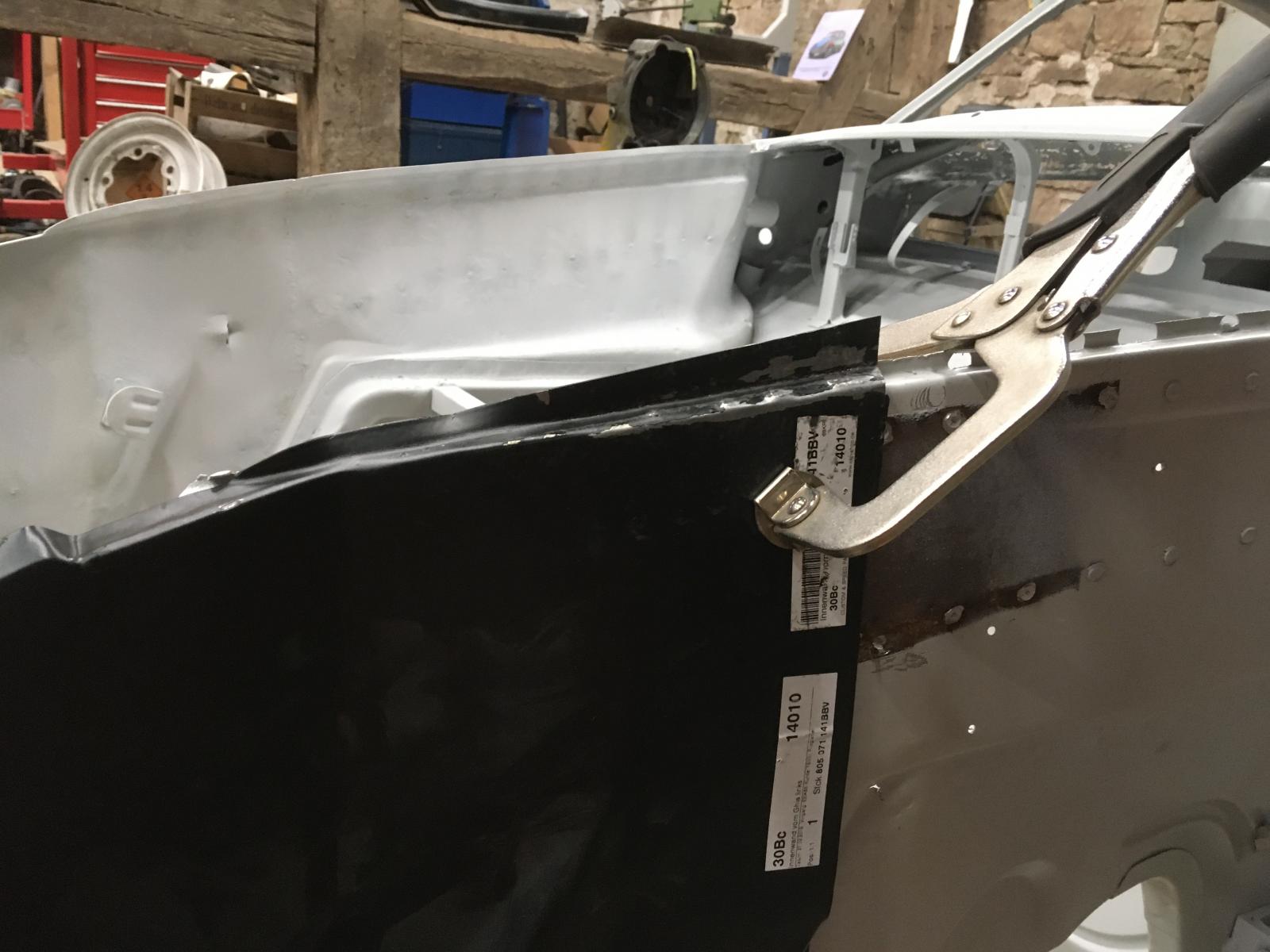

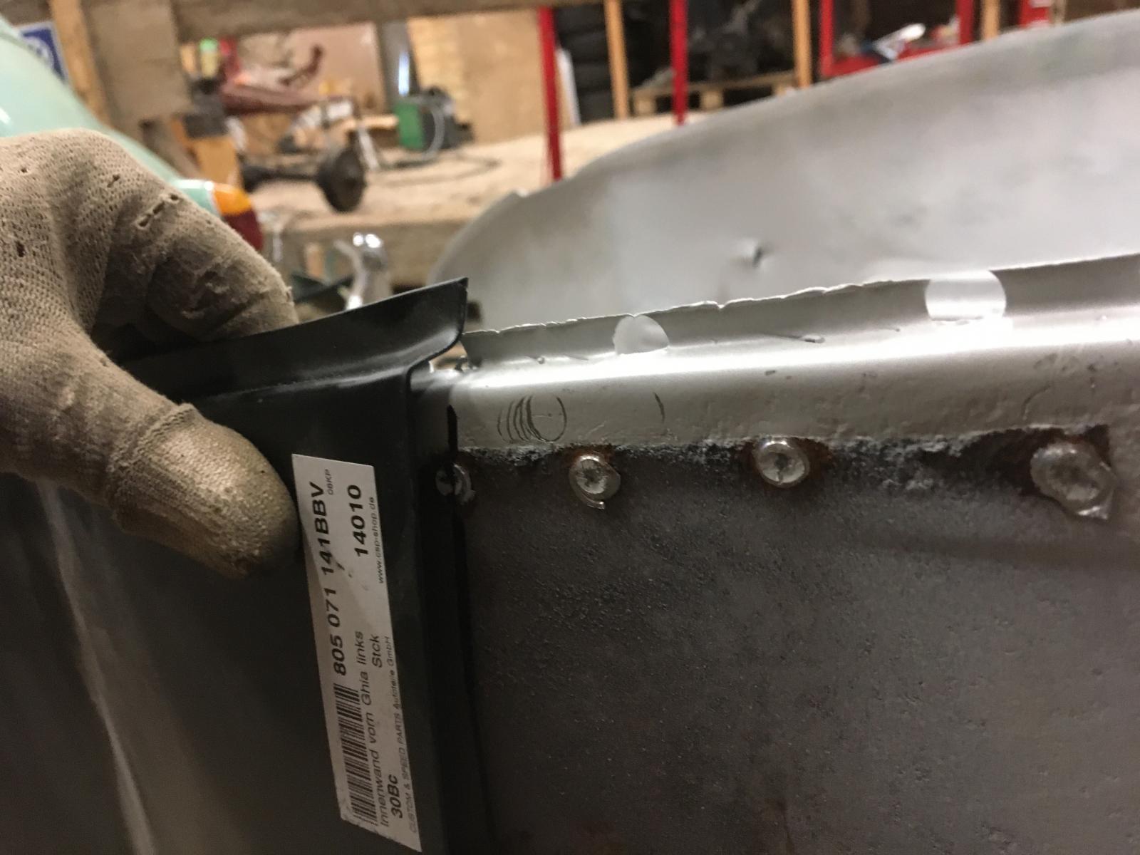

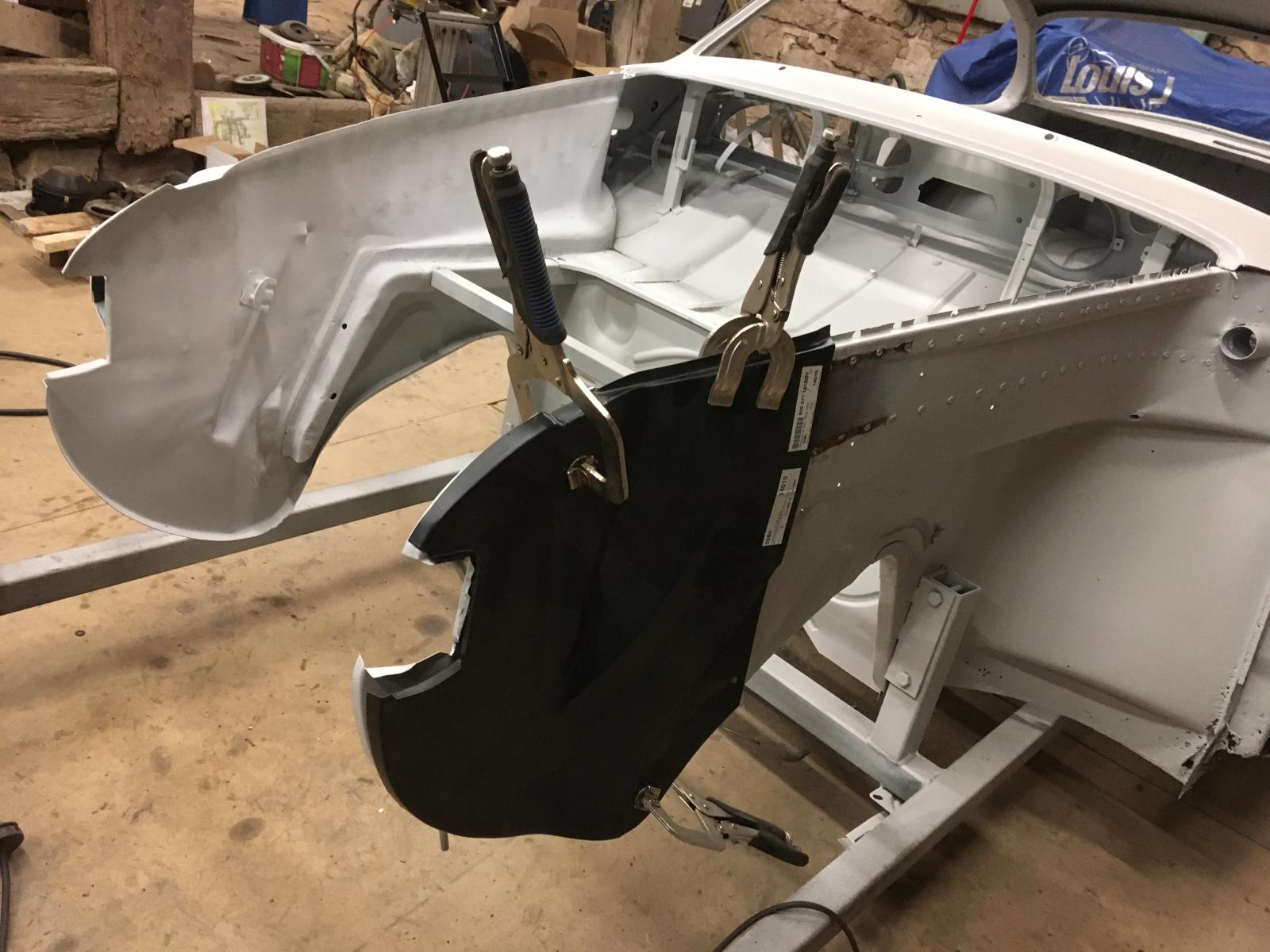

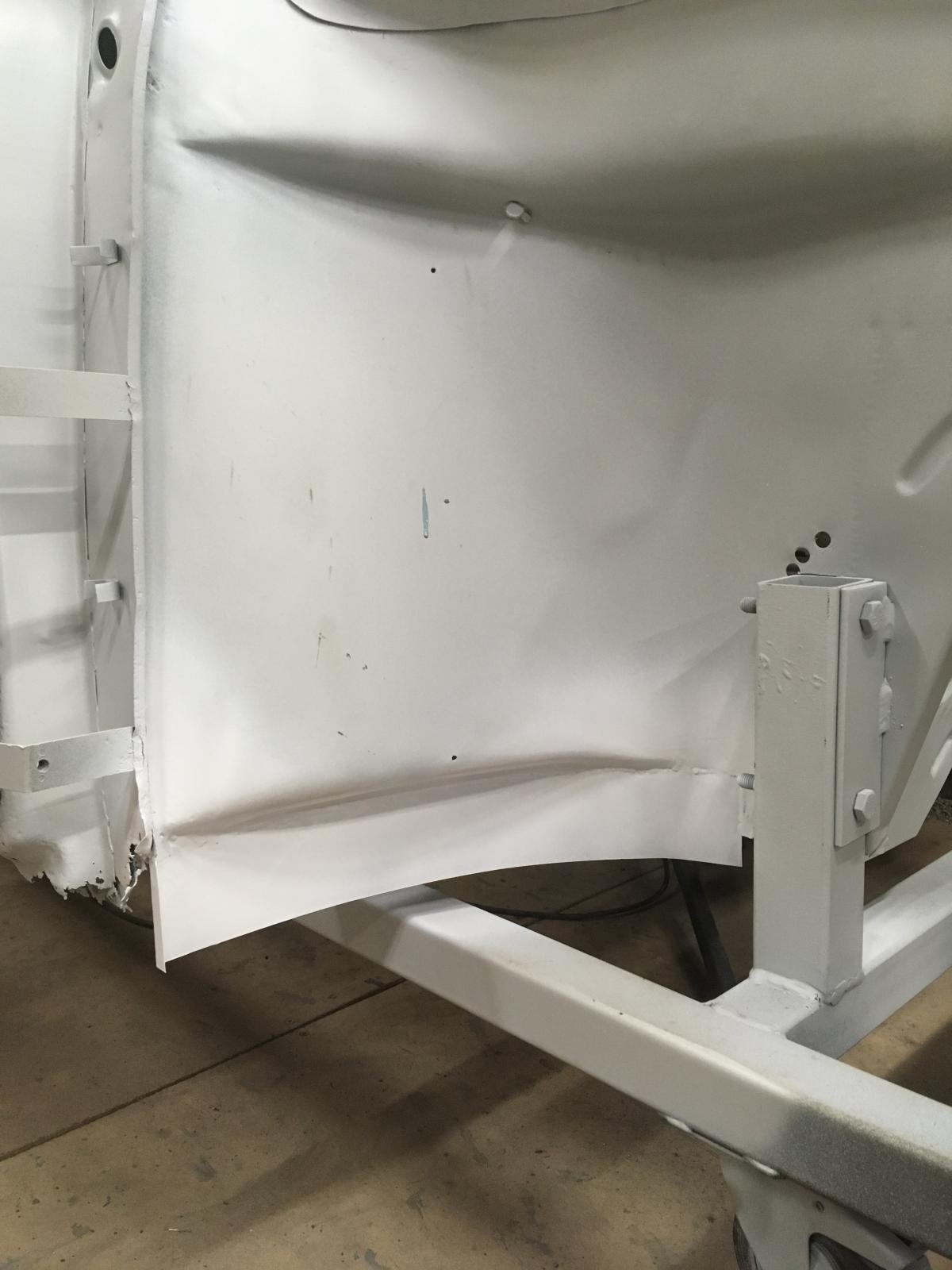

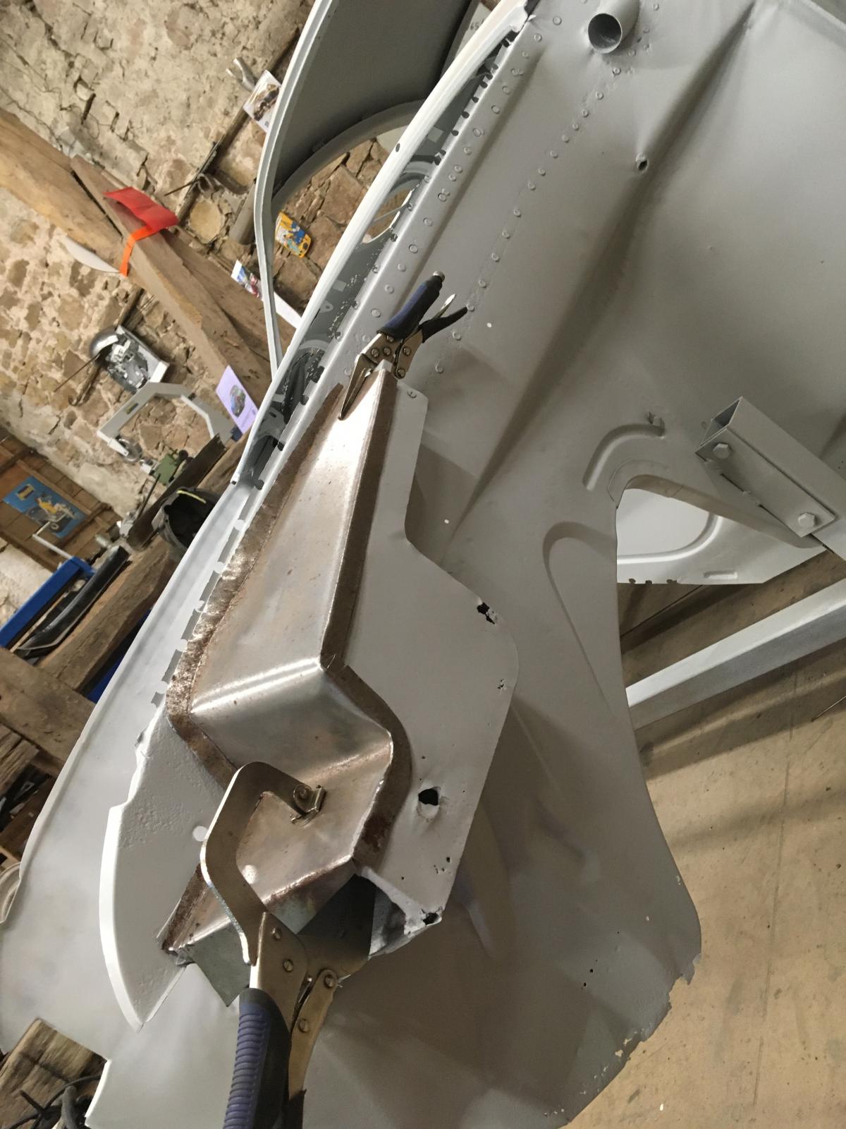

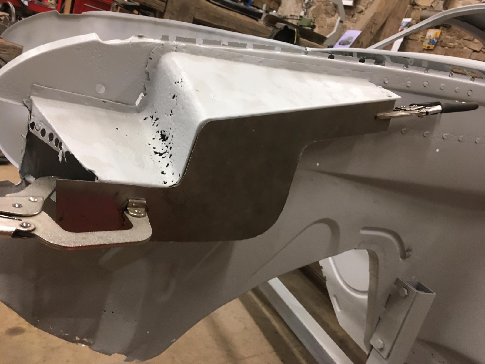

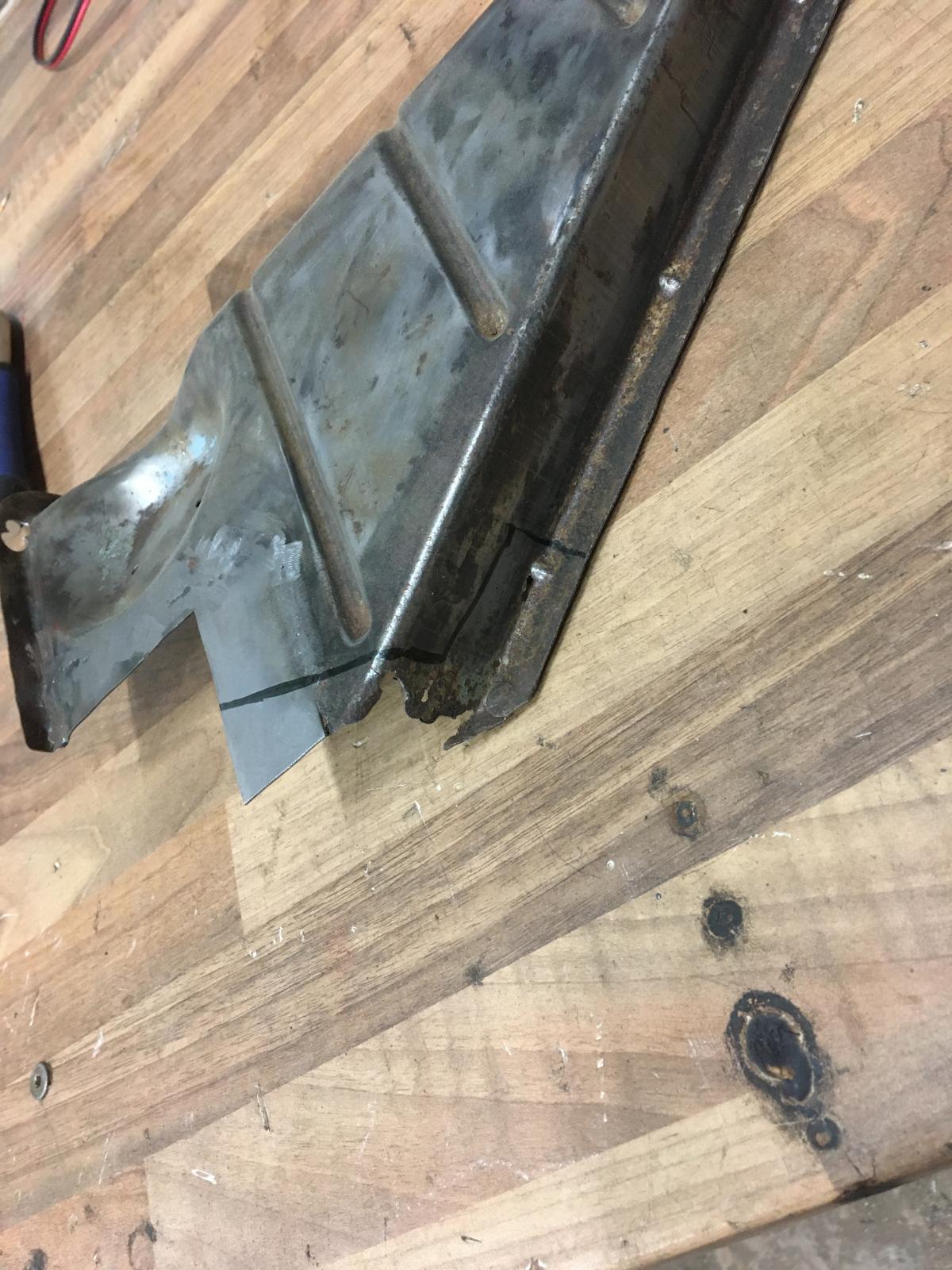

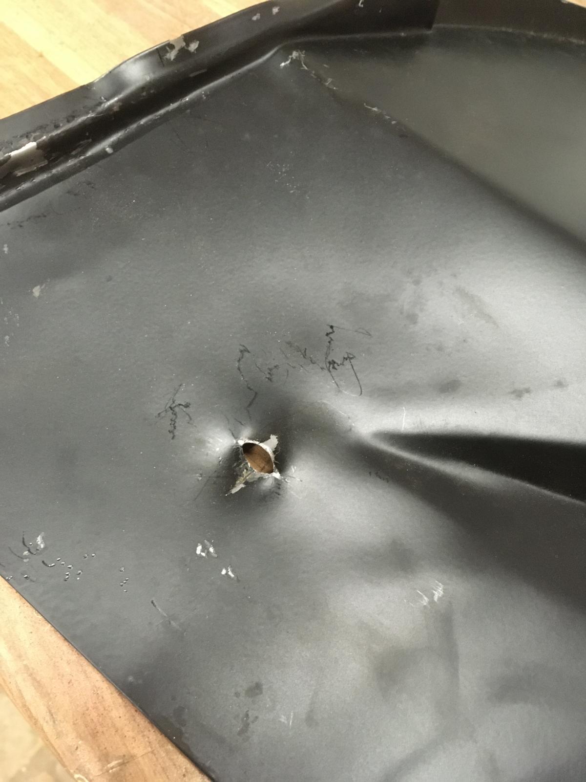

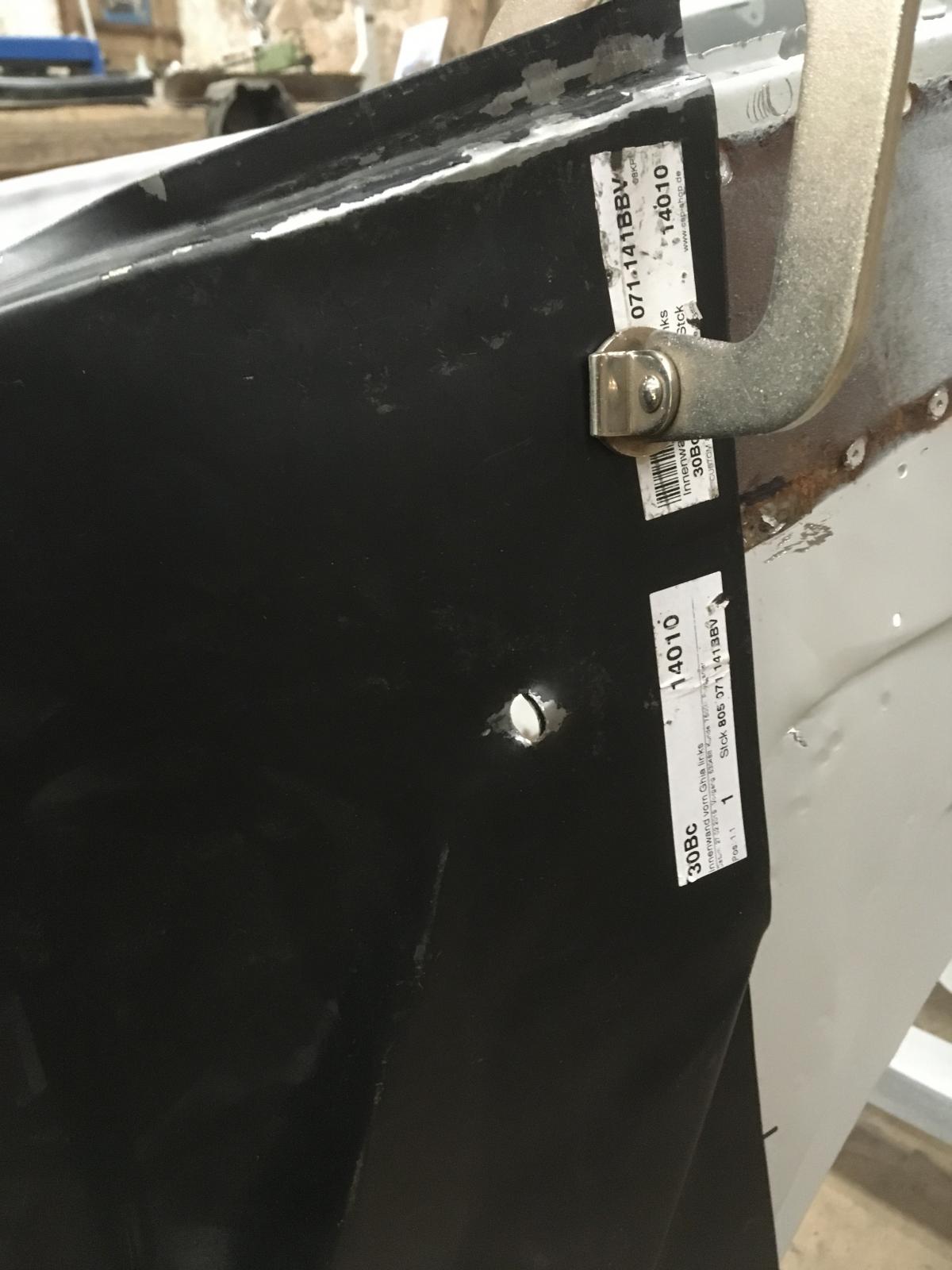

So I started checking the replacement panel:
As for the other side, the top curve doesn’t fit:
So I corrected it:
And also made the hole for the wiring:

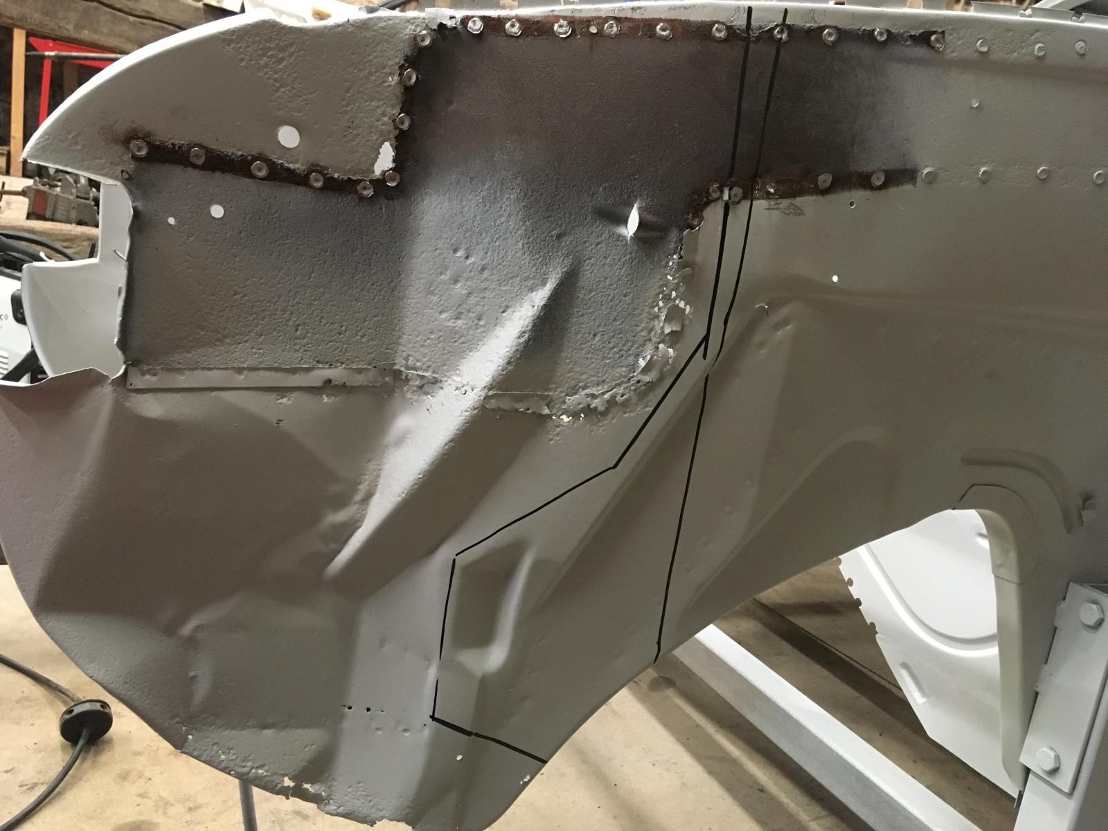

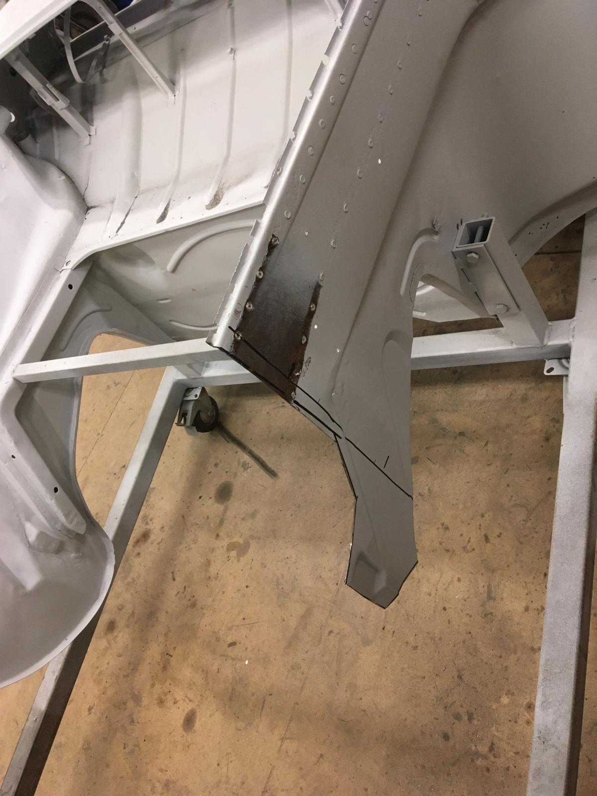

Then marked how big this panel is:
And where I should cut to remove all the rust but keep the original indent:
Then.. cut!
And putting the panel to cut it precisely, cut and adjusted for welding:
Sadly I then discovered that my argon bottle is empty.. so welding next time!
I also prepared the next steps by grinding down the old welding points:

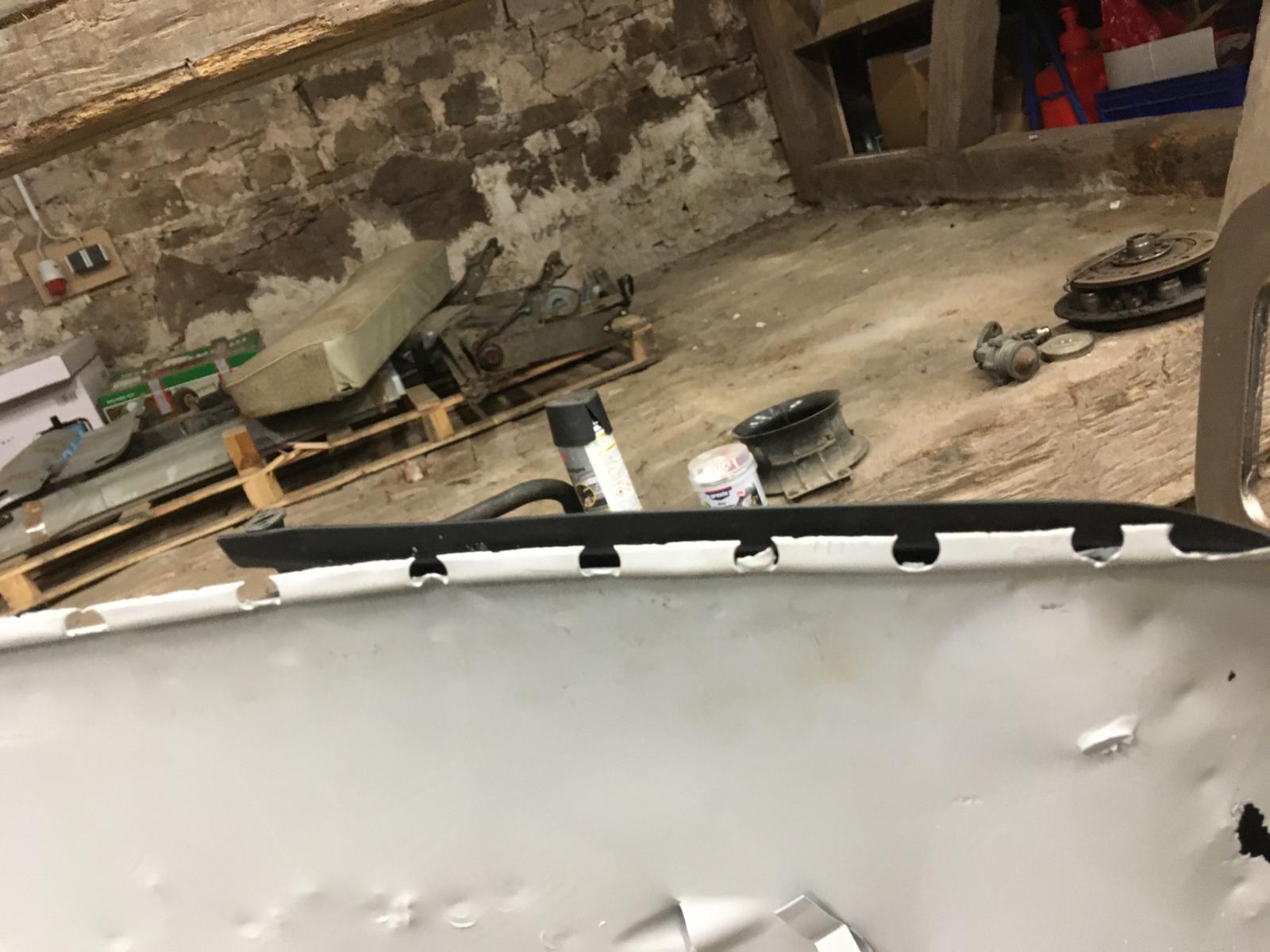

Don’t forget to put your rubber trim on the front edge of the inner wing !.... as per factory it should have overspray on it.

Matt: thanks for the advice, I will mount them before paint!

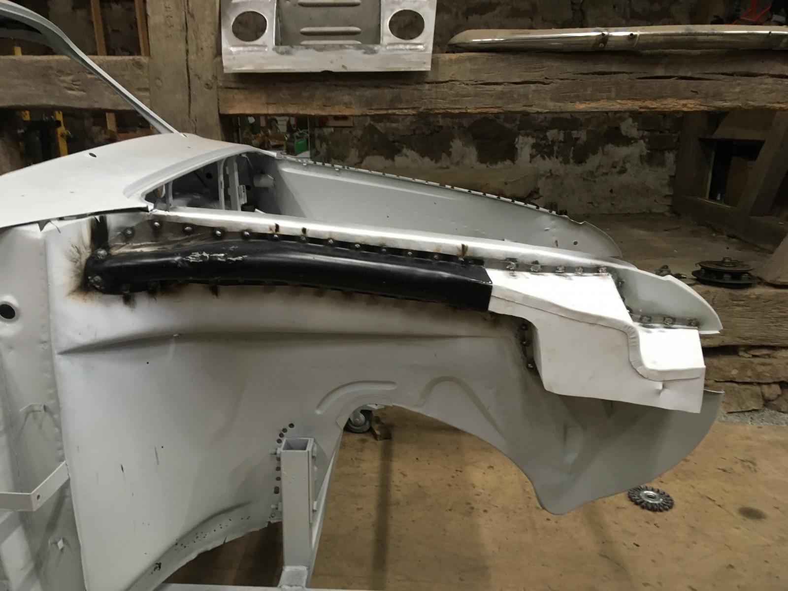

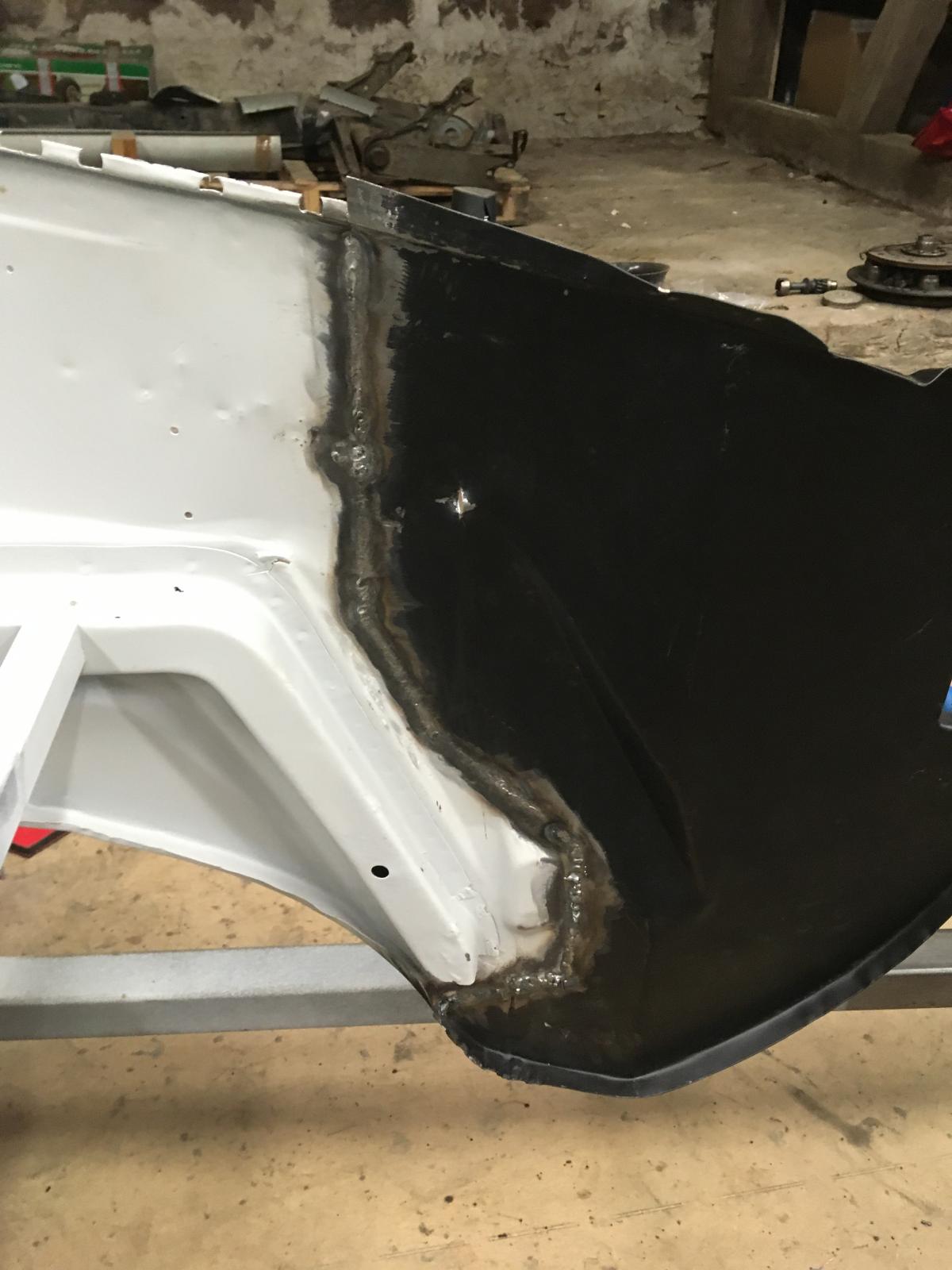

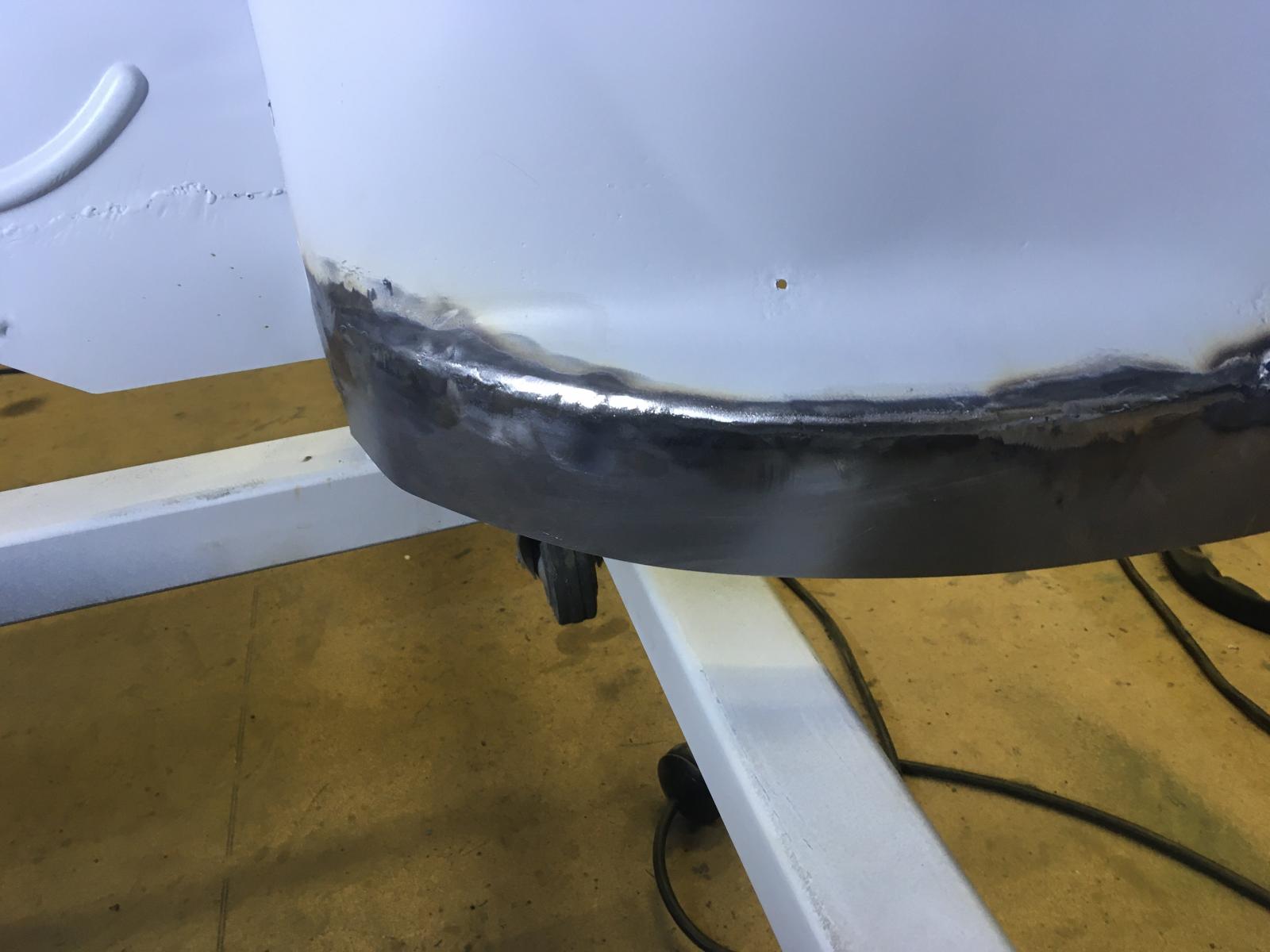

So, I finished welding my panel after picking up a new bottle of Argon:
And after planishing:

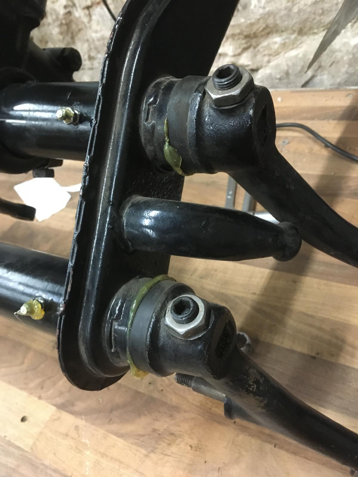

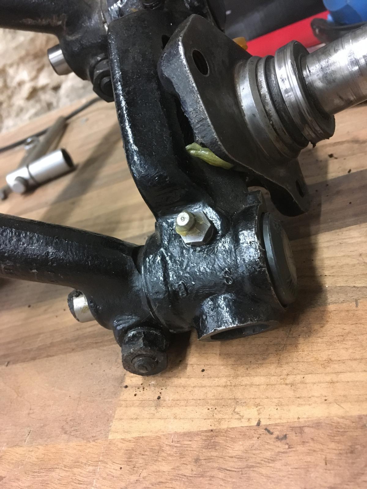

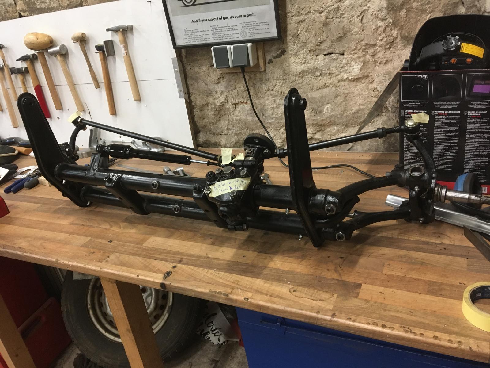

I also continued the front axle assembly:
Putting grease wherever needed:

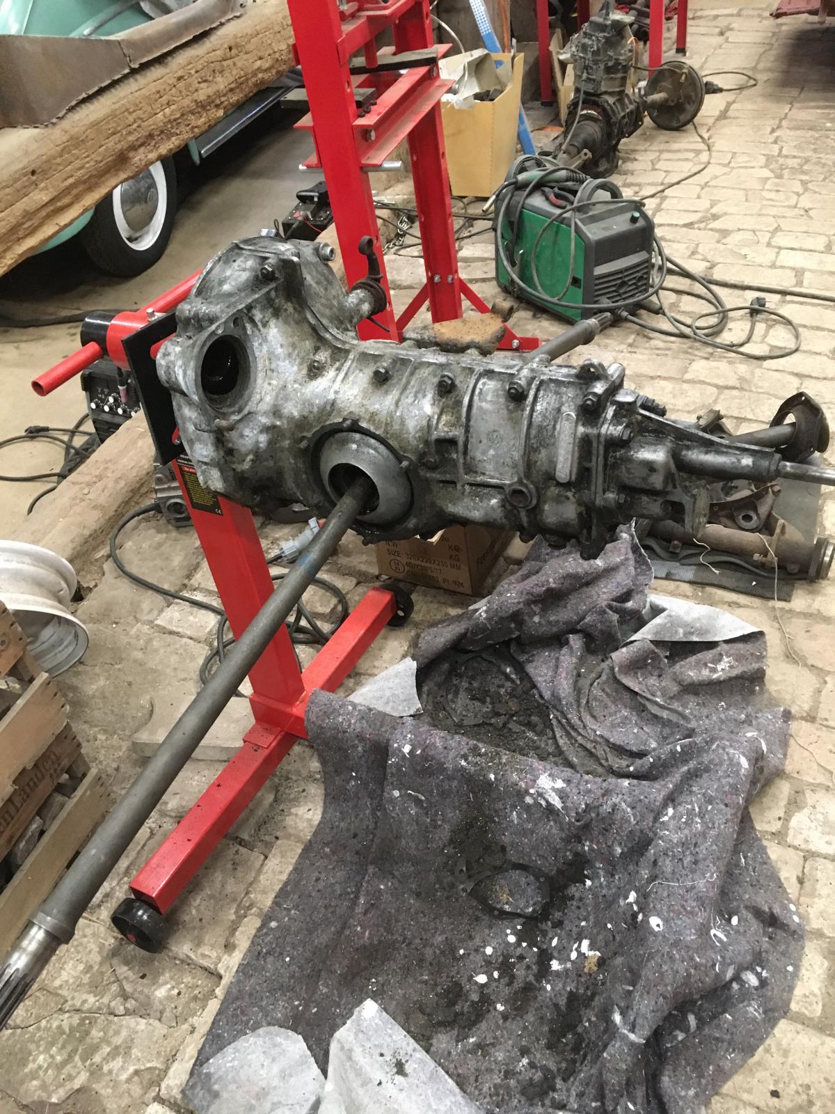

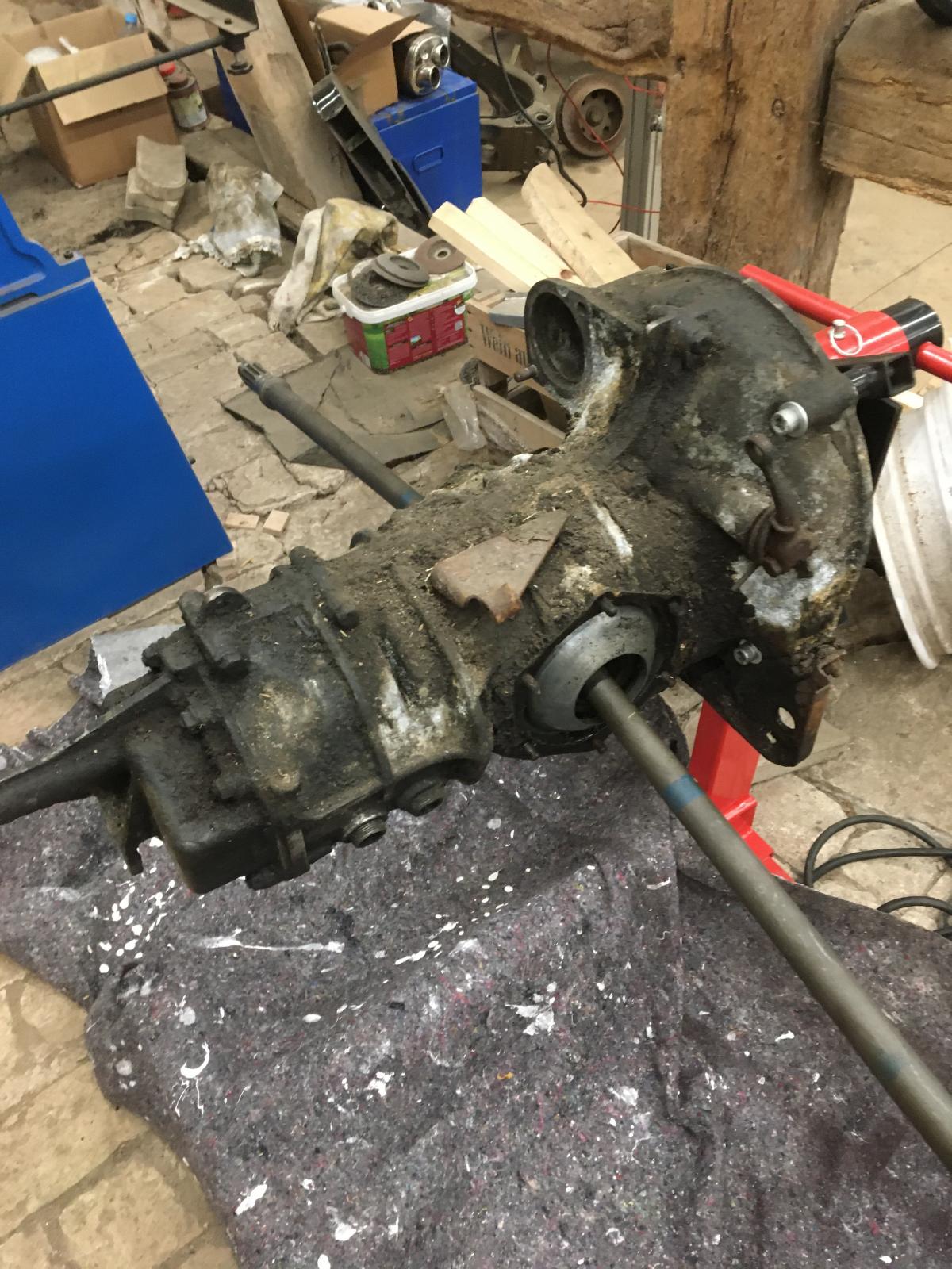

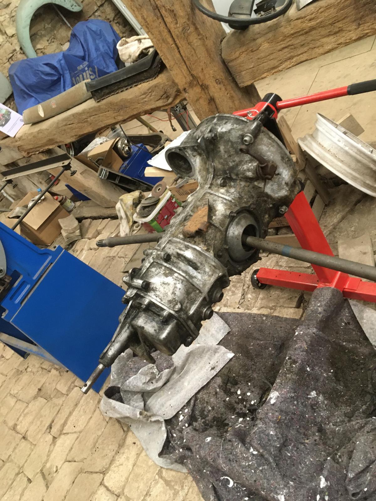

And started cleaning the 60 only gearbox:
-before:
-Current Status:
