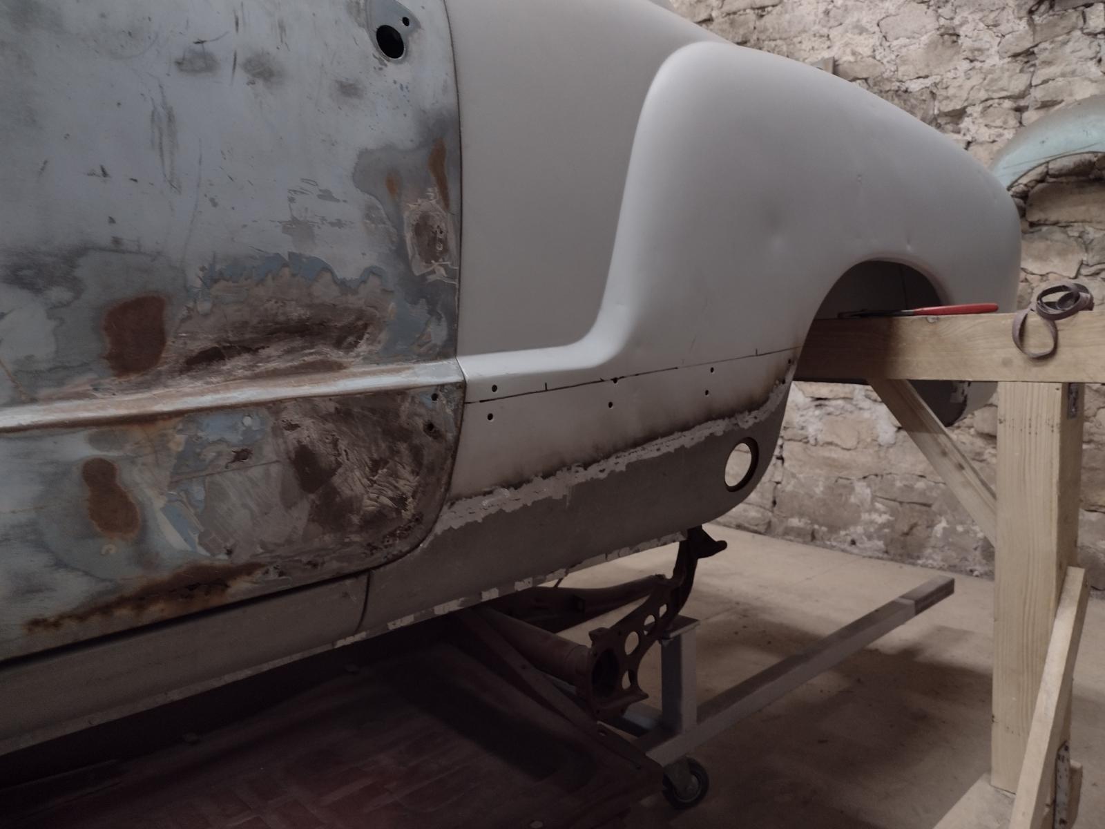

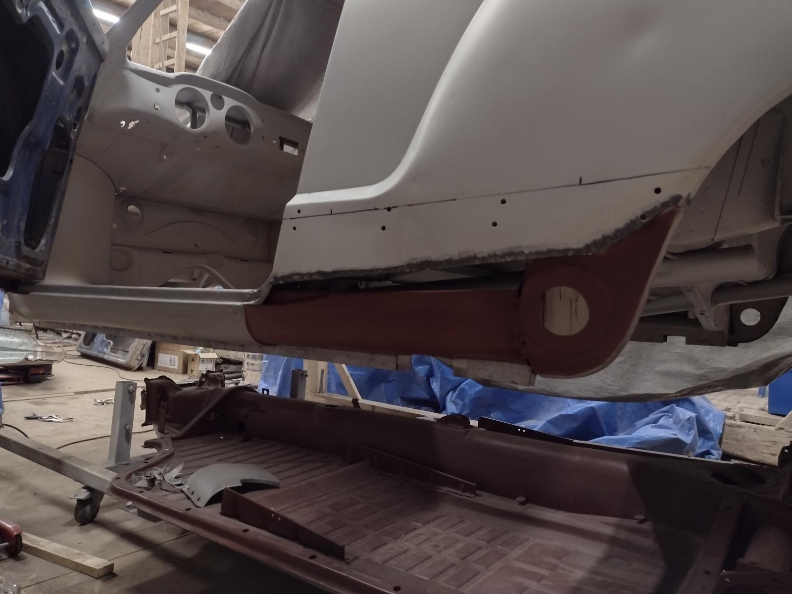

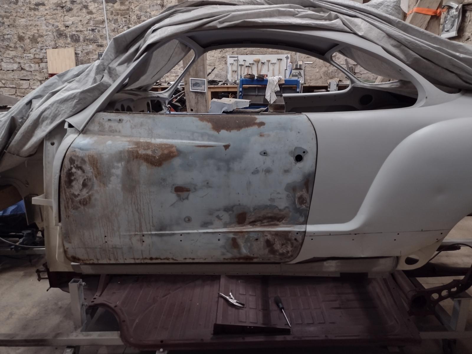

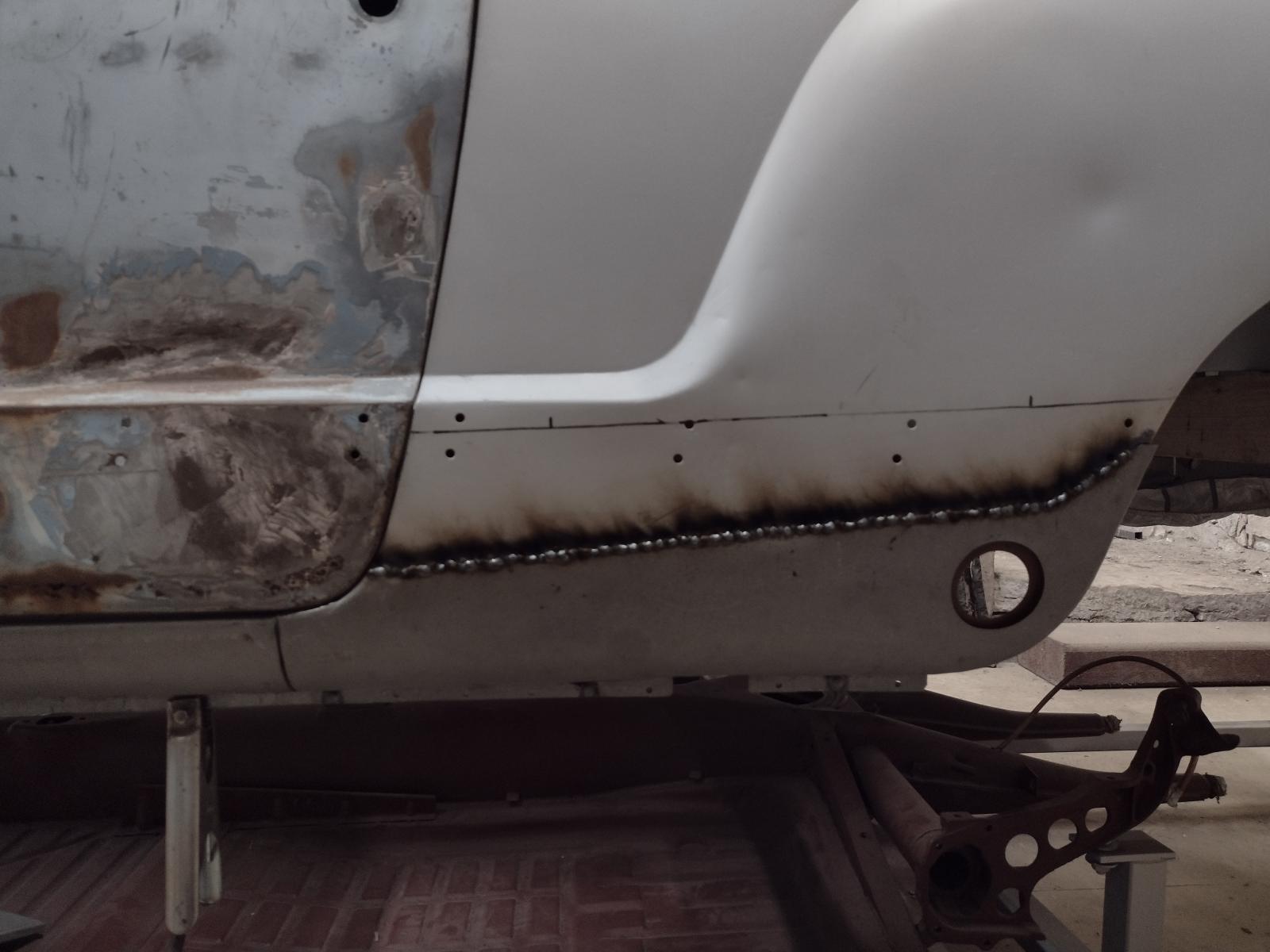

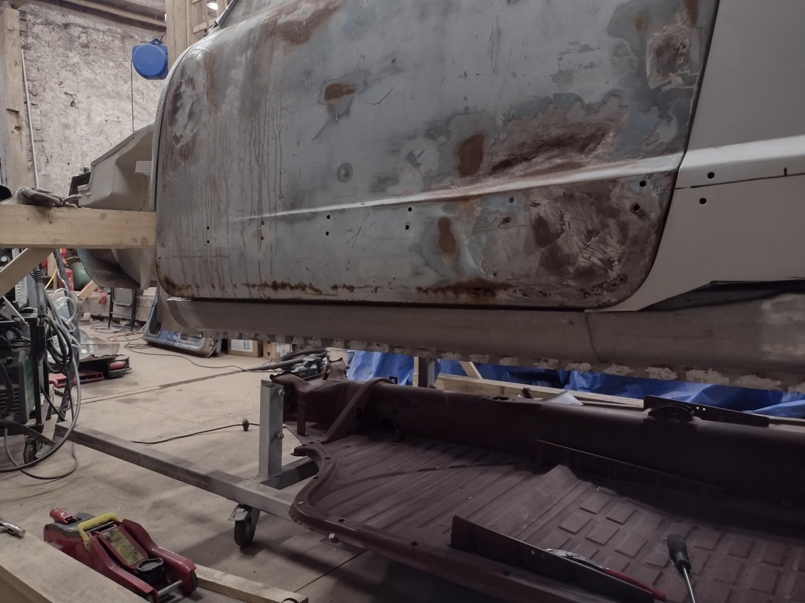

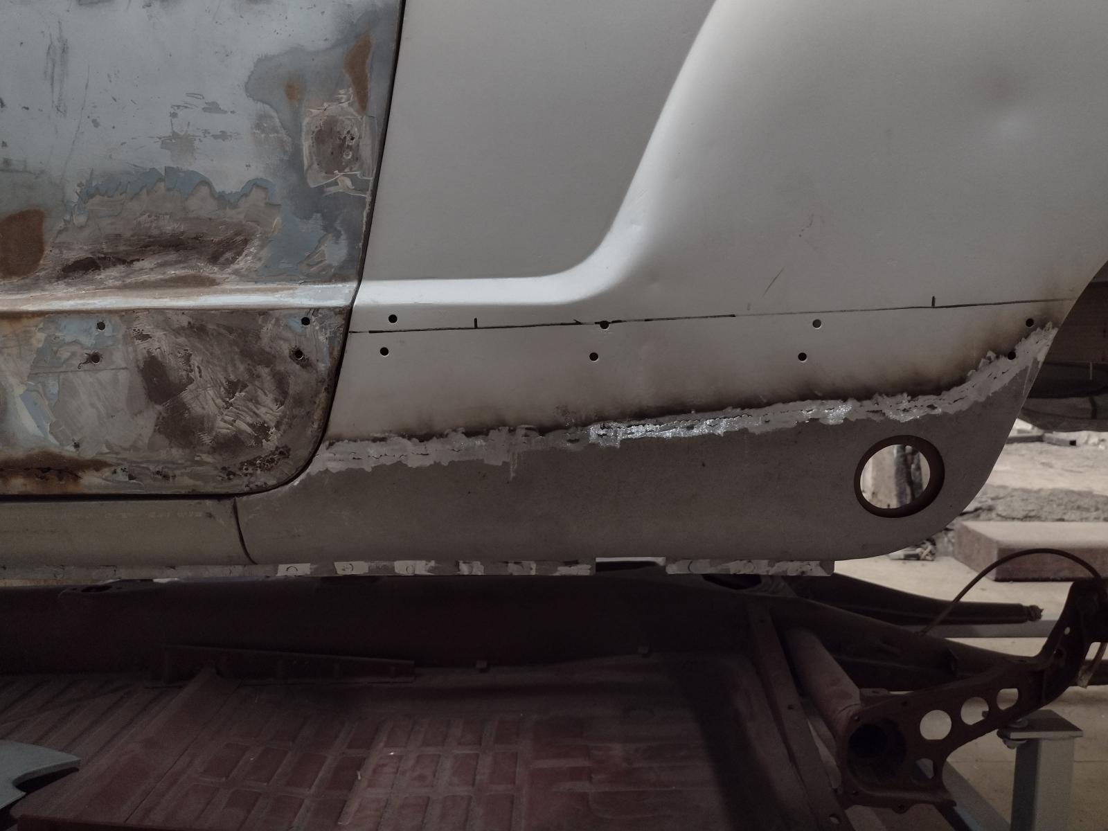

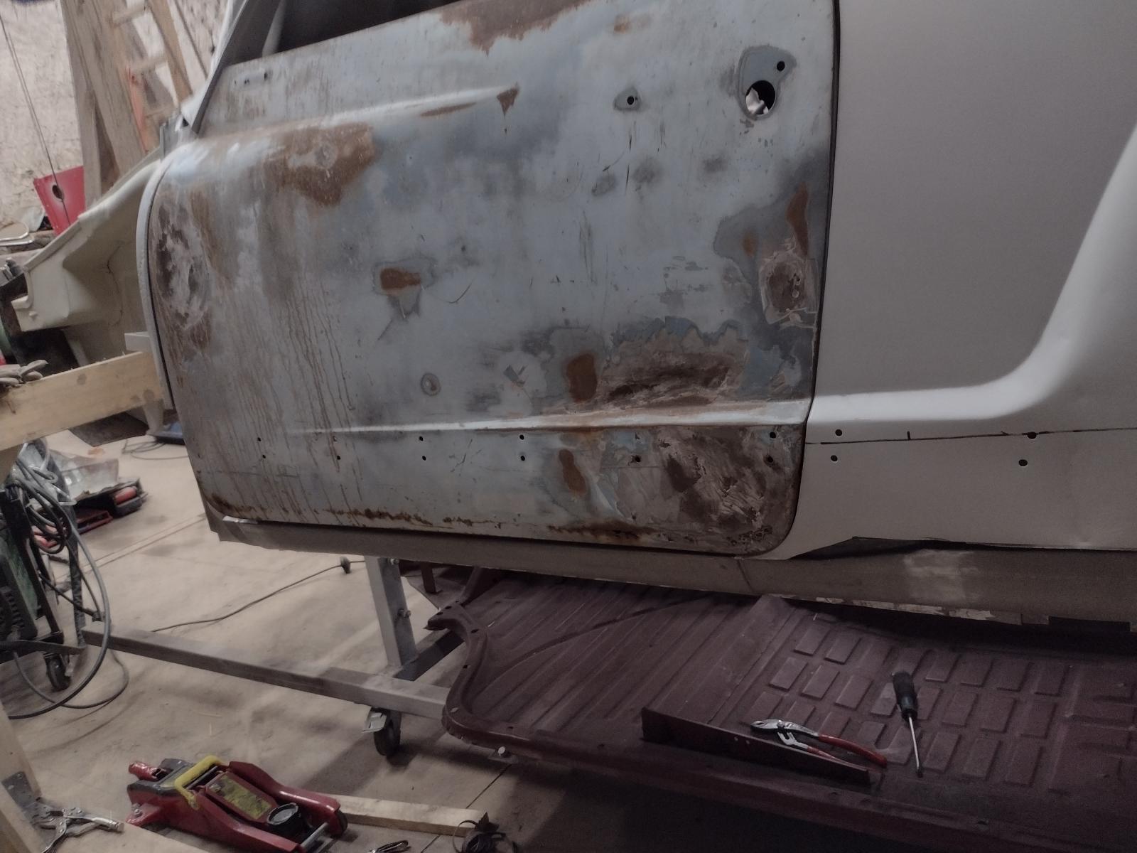

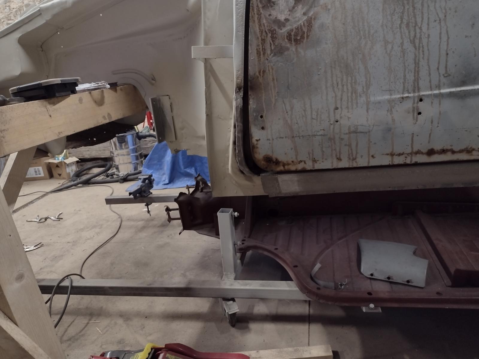

It was time for the left sill, so as for the right, adjusting with the door :
And after welding:
  #232

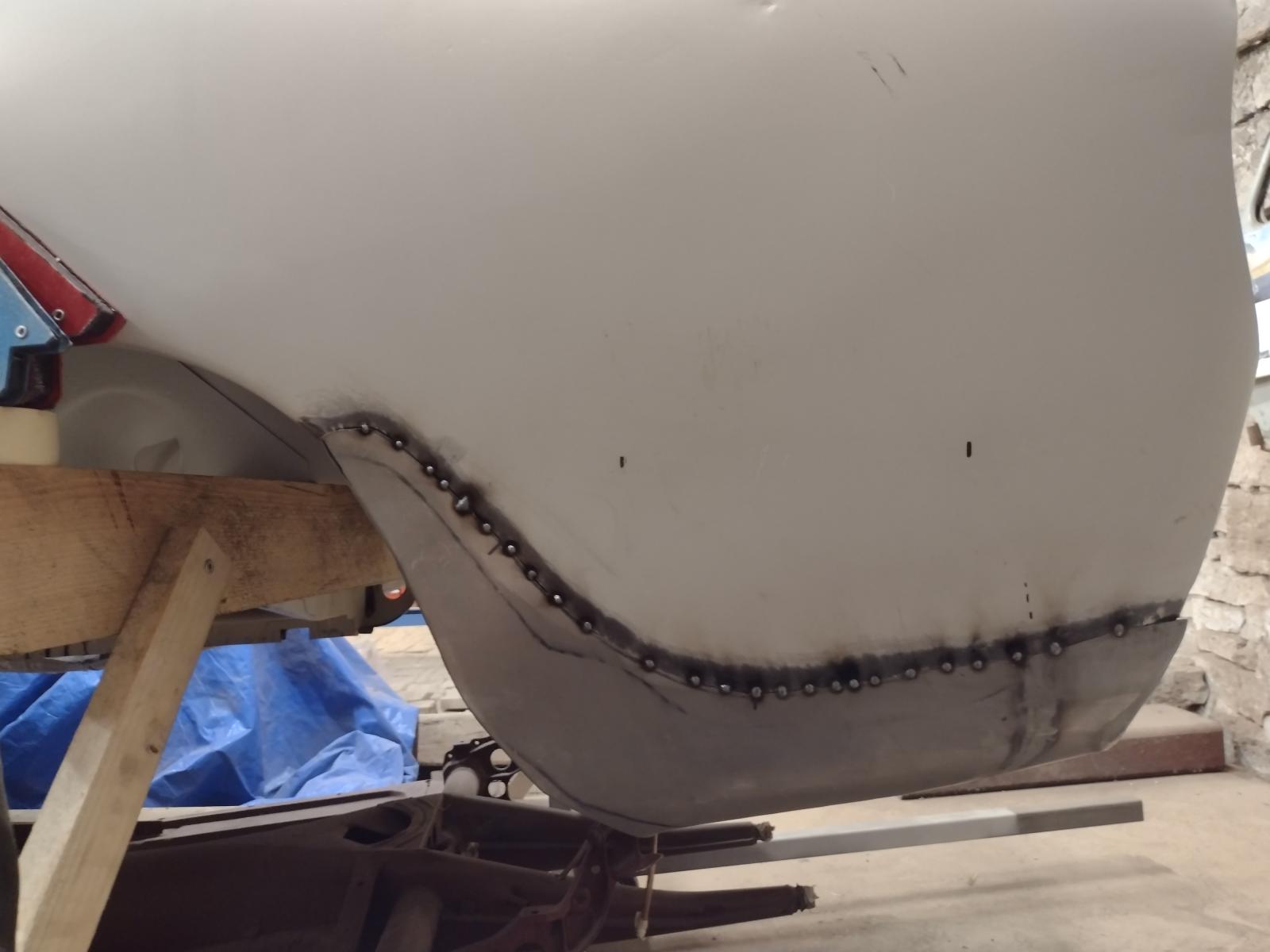

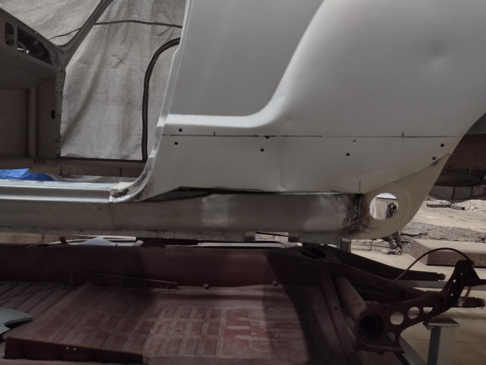

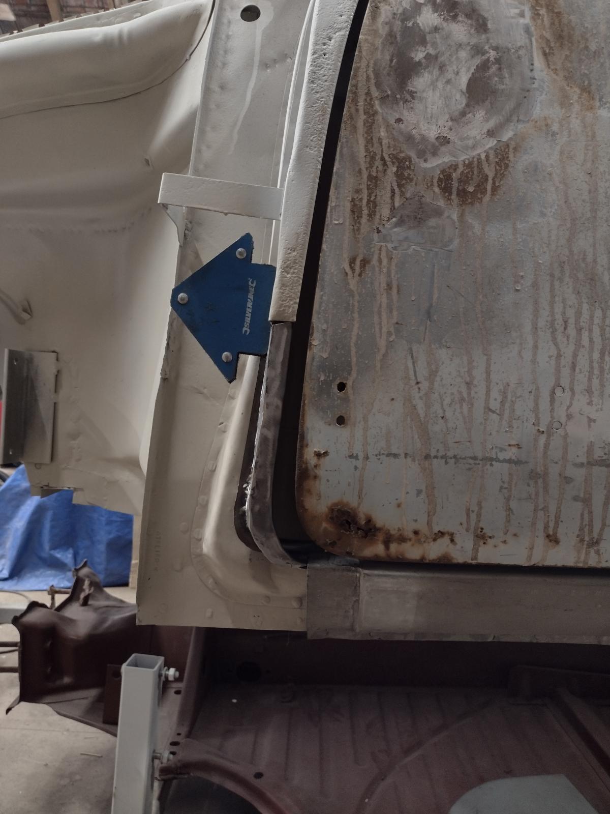

So, after welding the left sill..A-Post was next:
And then the quarter panel:
Paint where I won't access anymore:

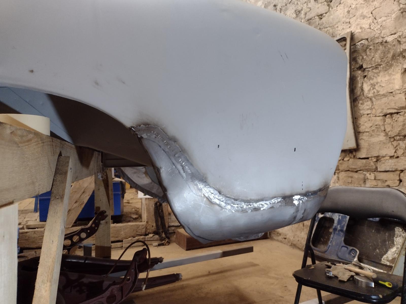

And welding:
And finished :
Stay tuned!

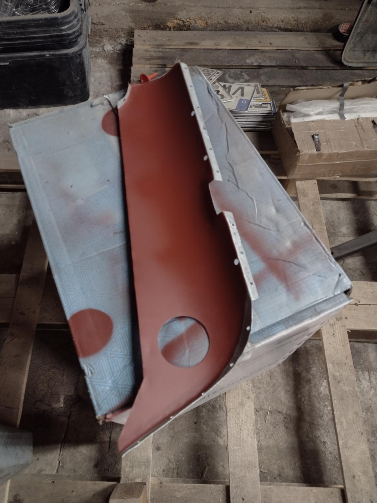

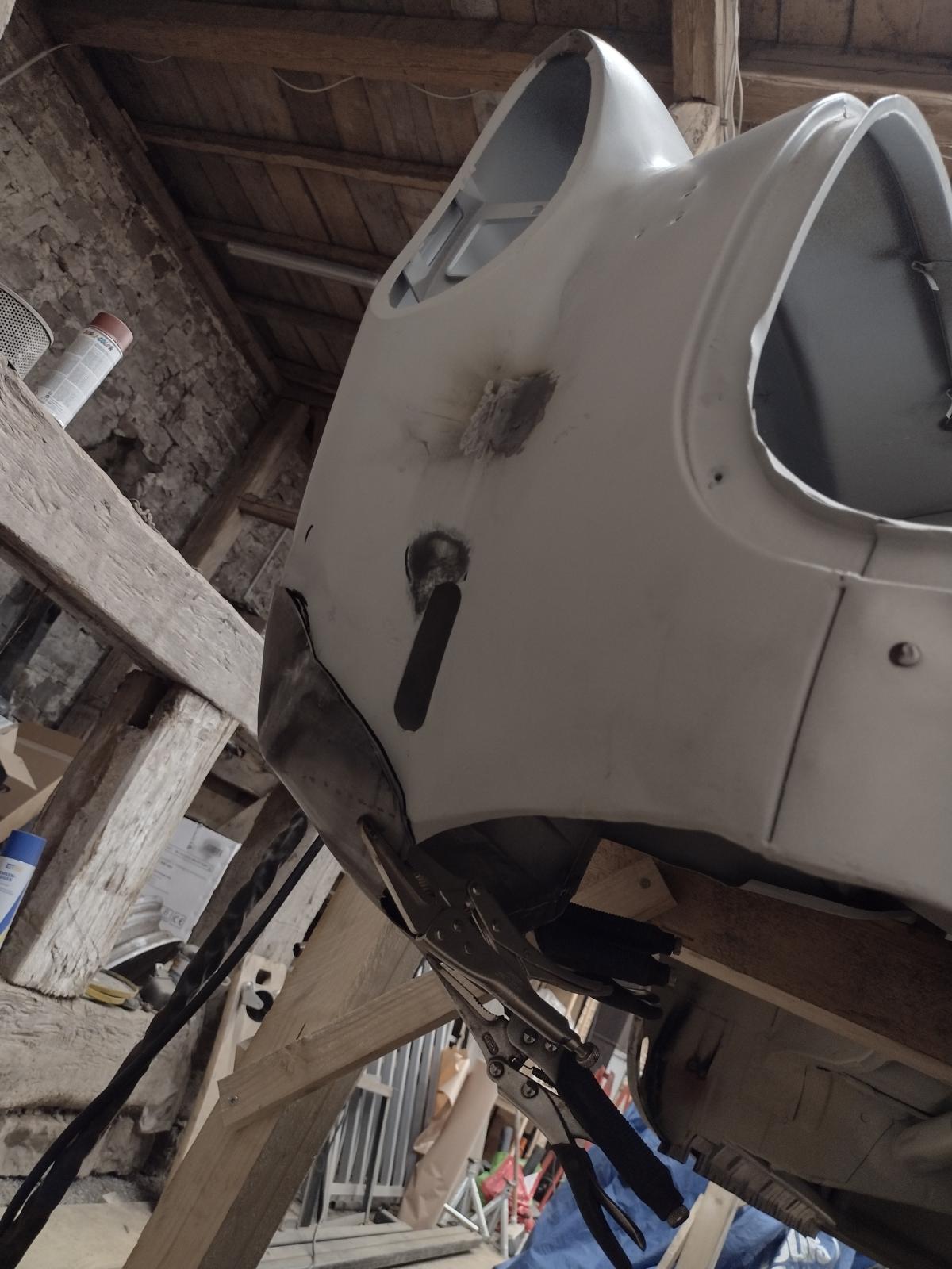

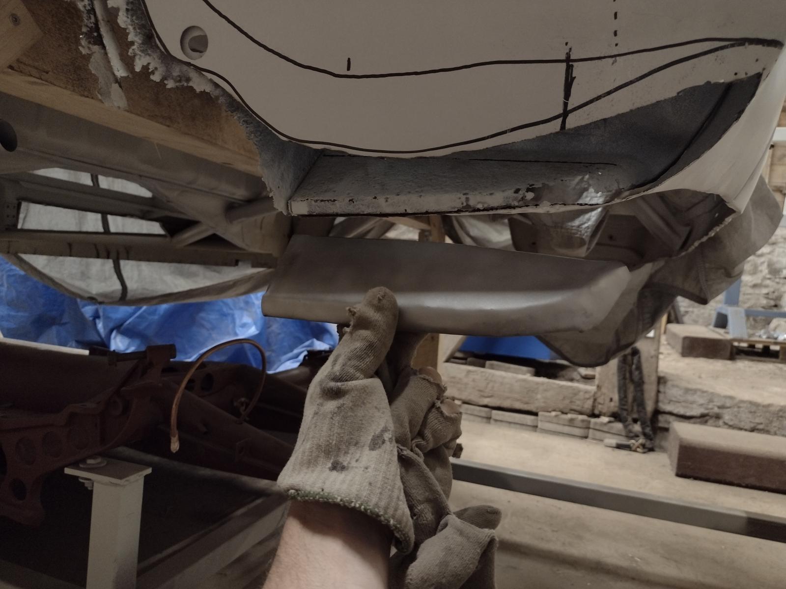

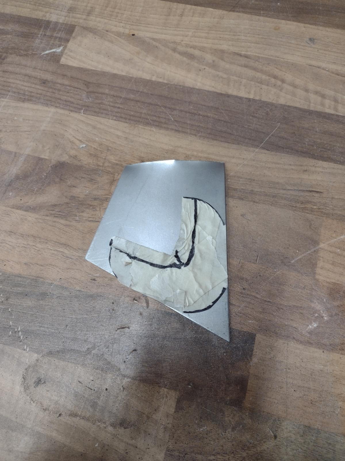

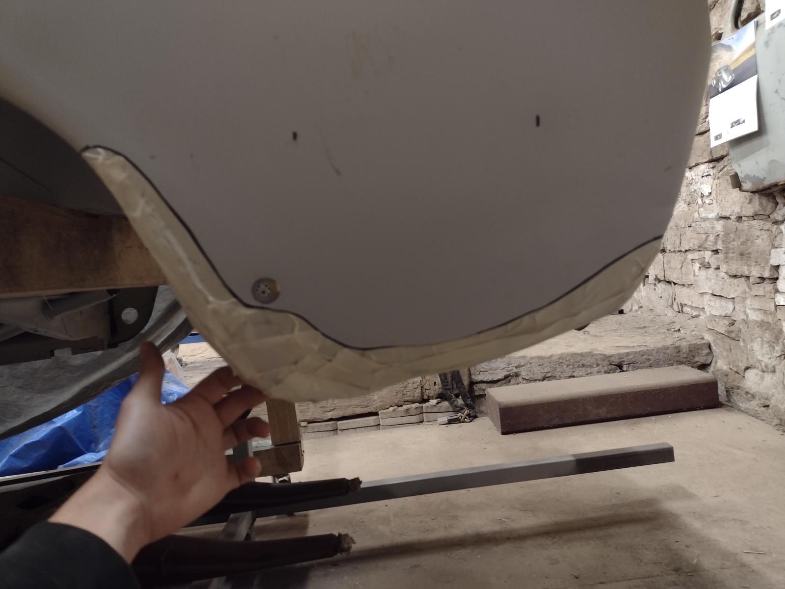

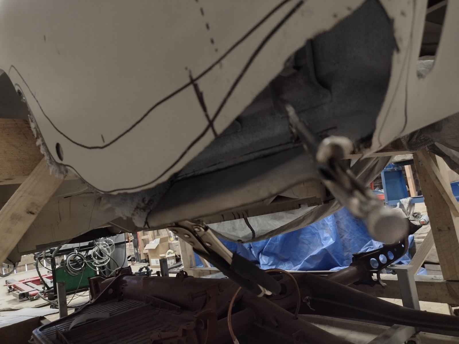

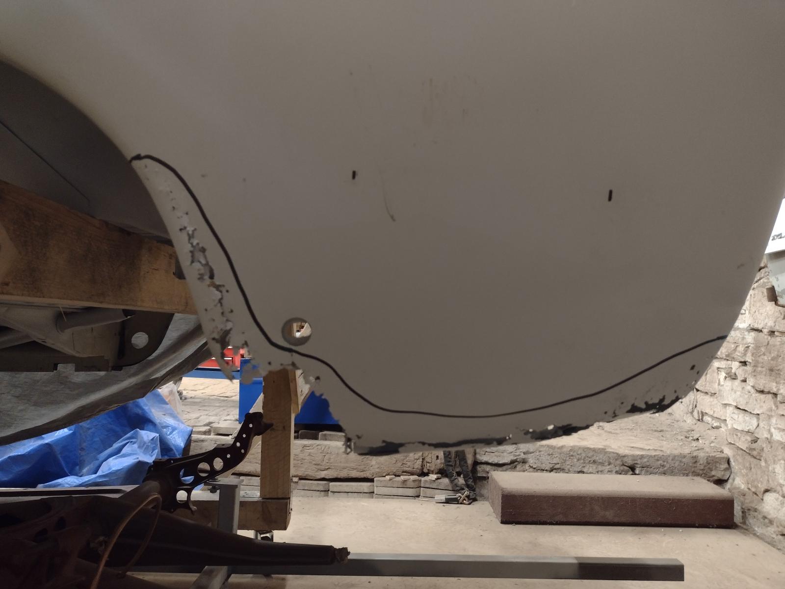

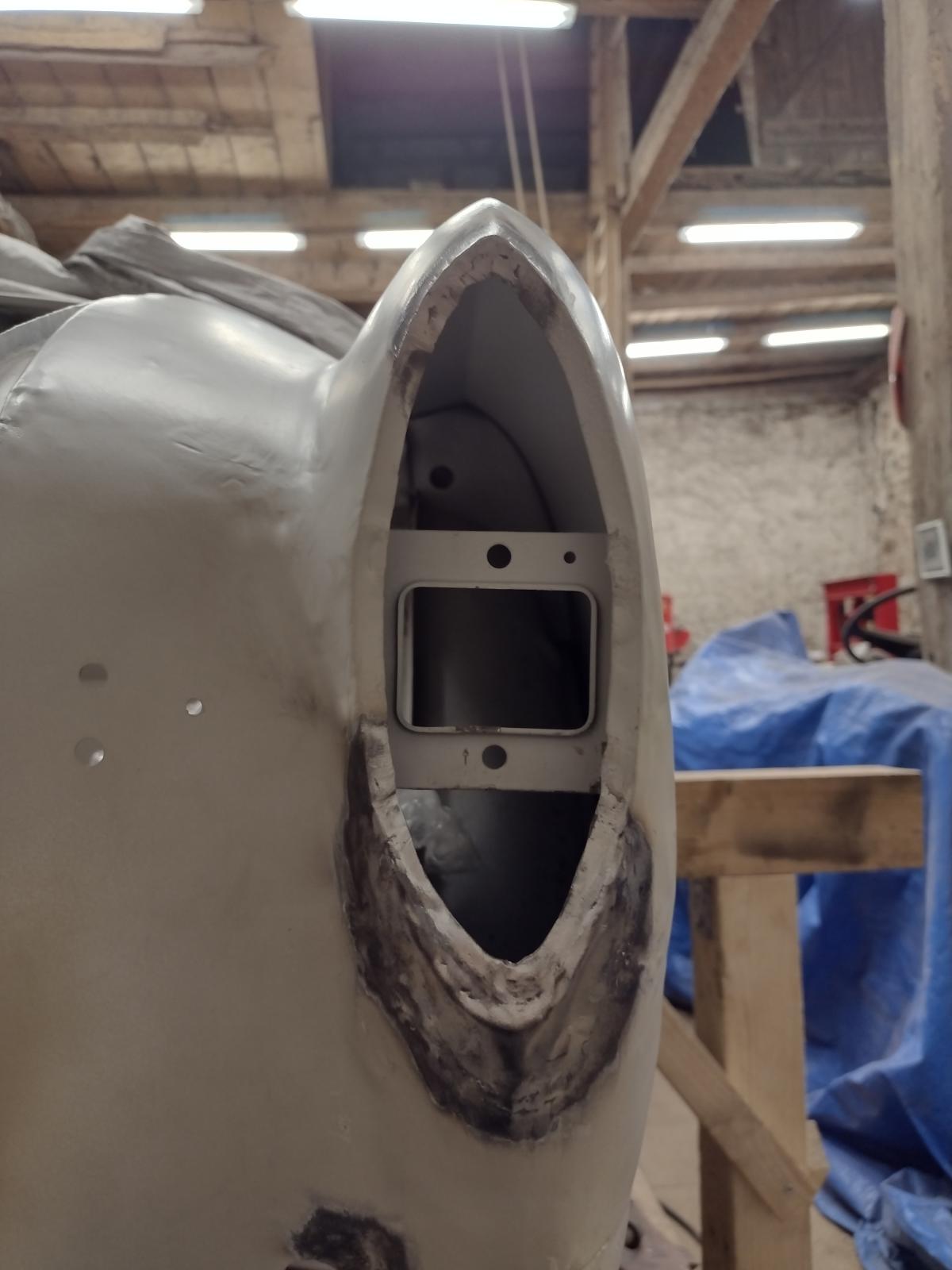

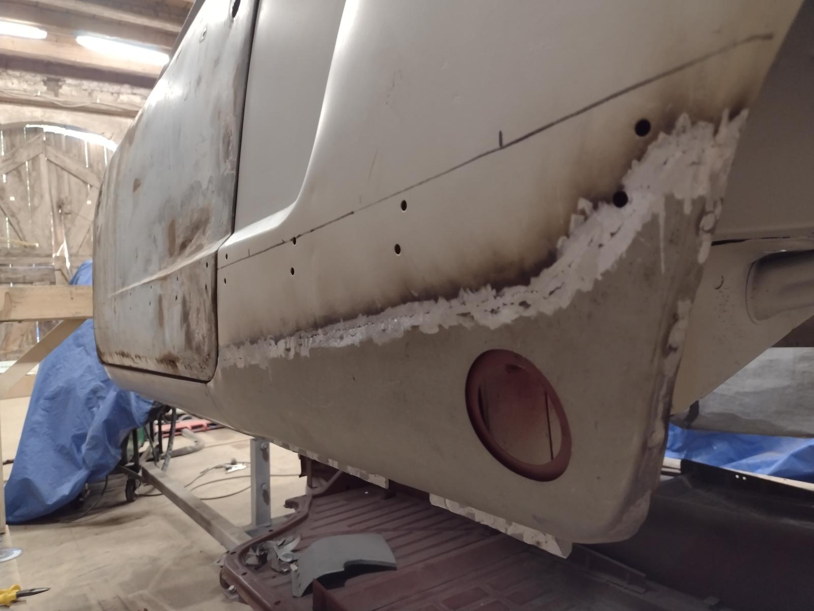

So, after that I turned my attention to the driver's back side:

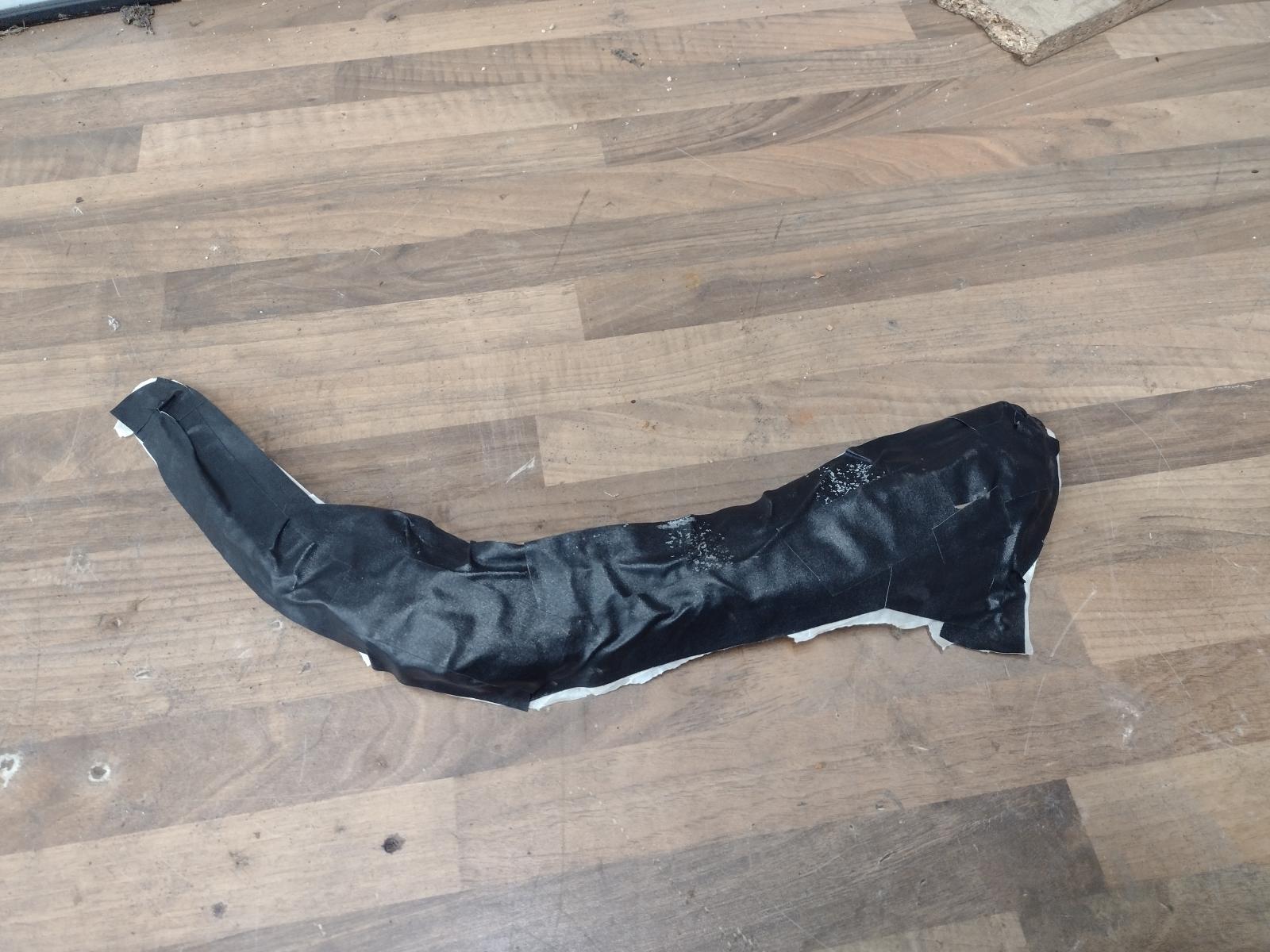

Creating a template:
And starting on the part:

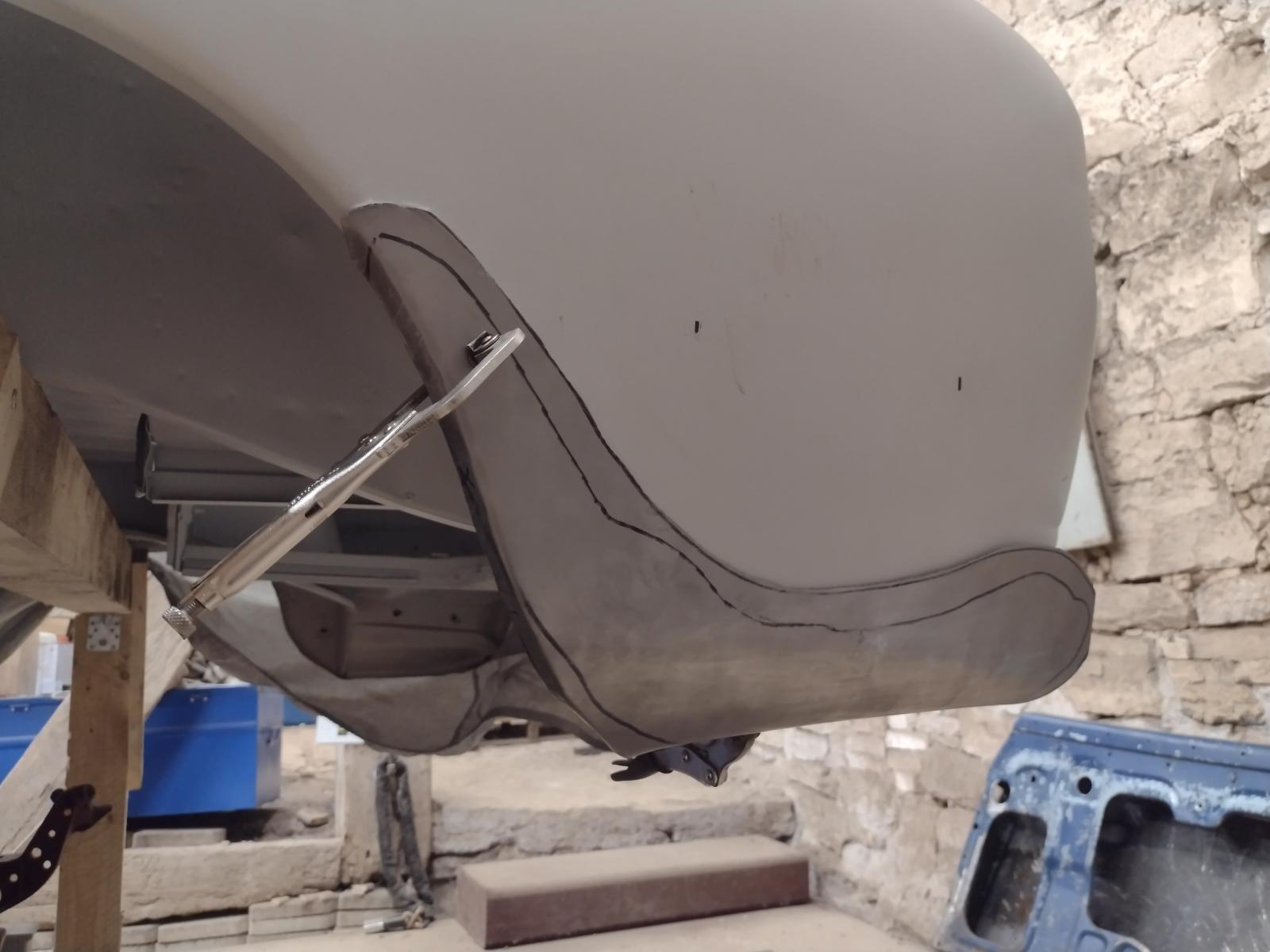

After a lot of massaging and finally doing it in 2 parts, it is ready:

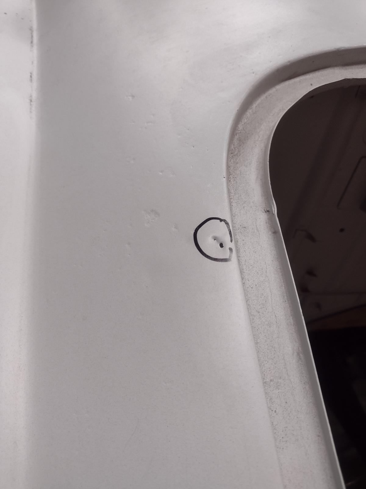

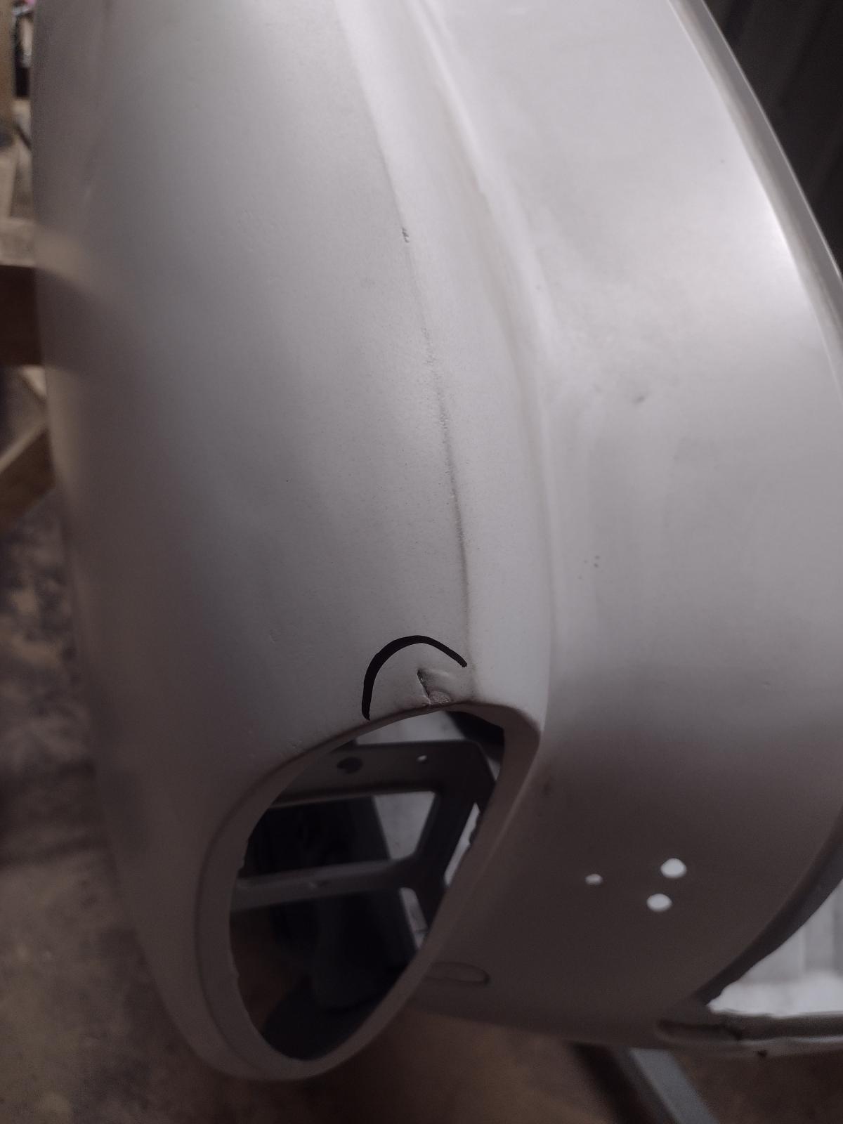

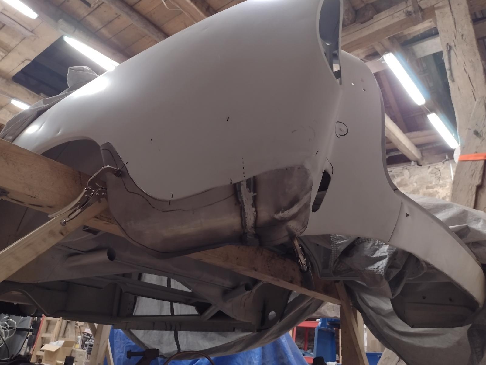

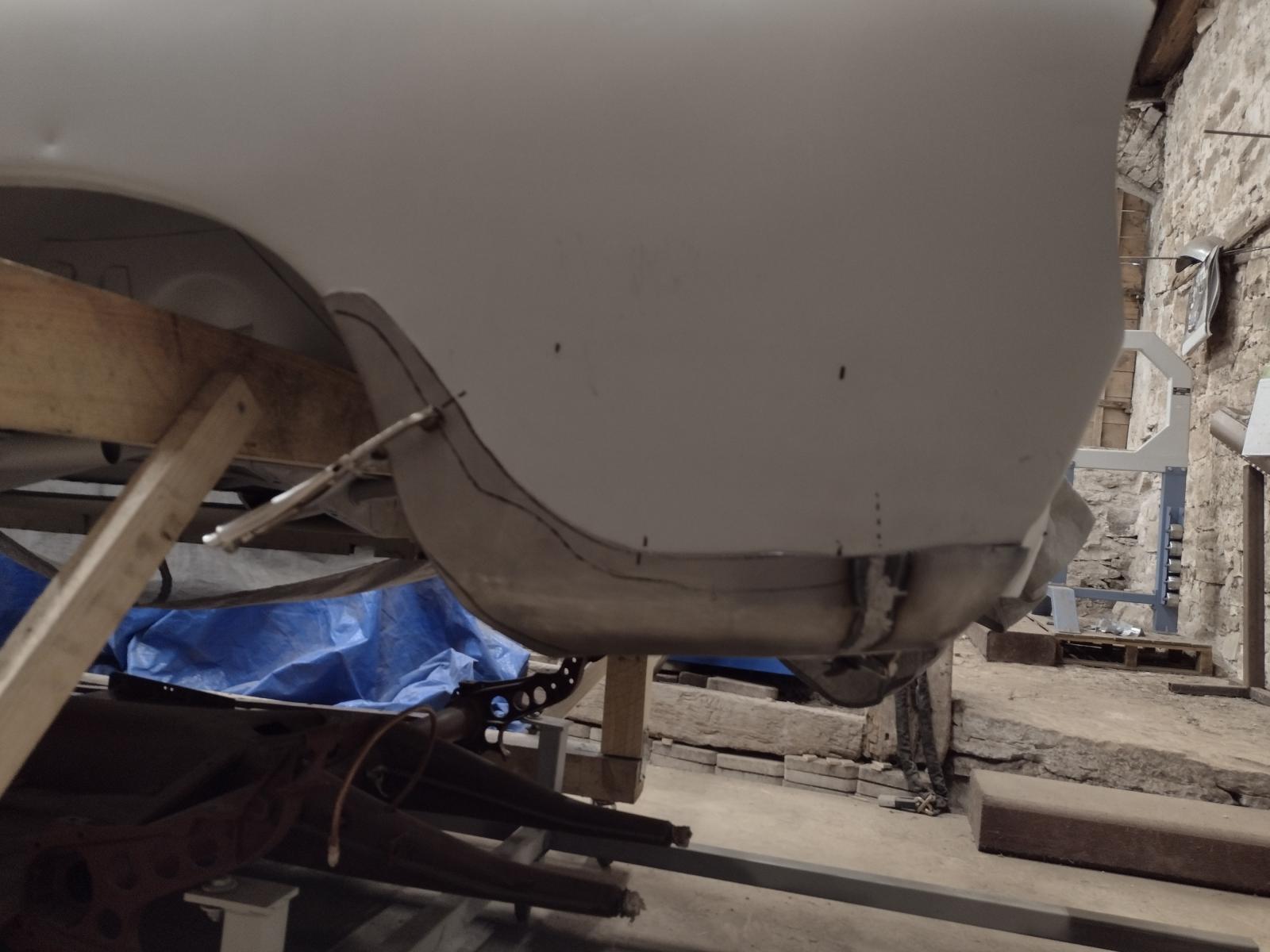

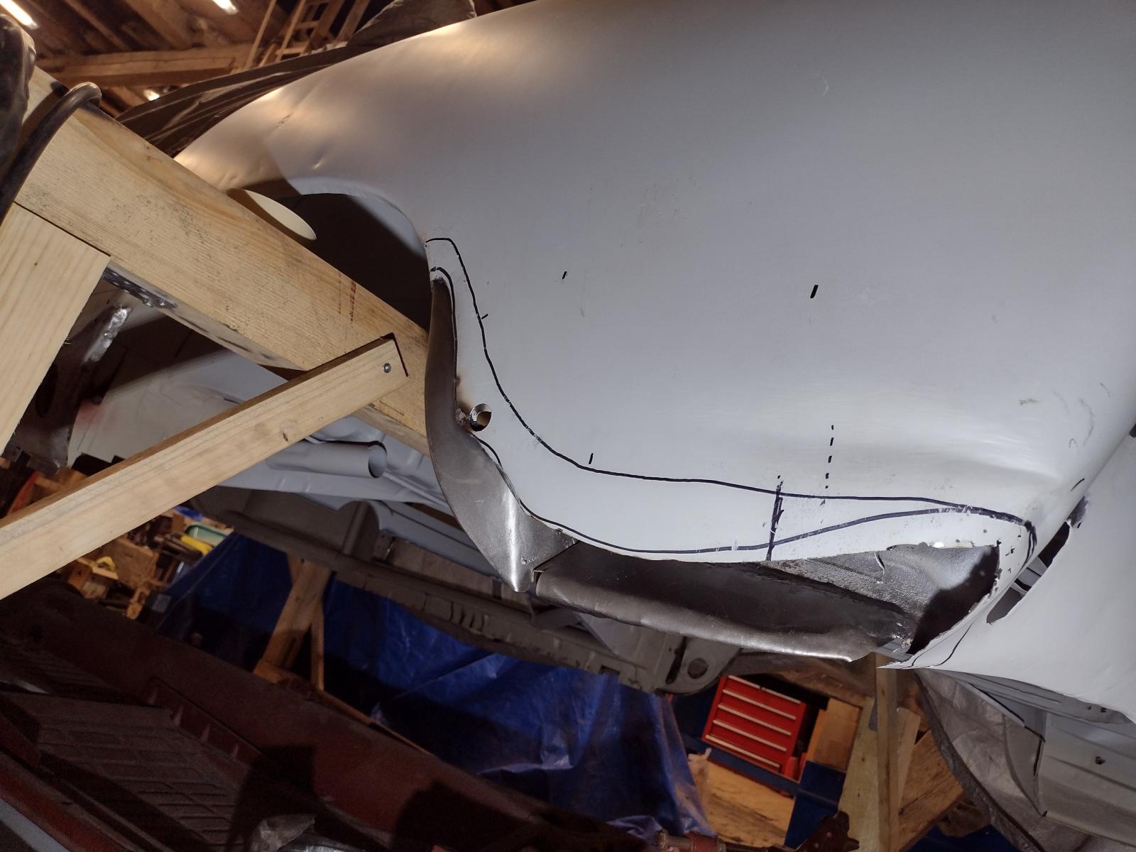

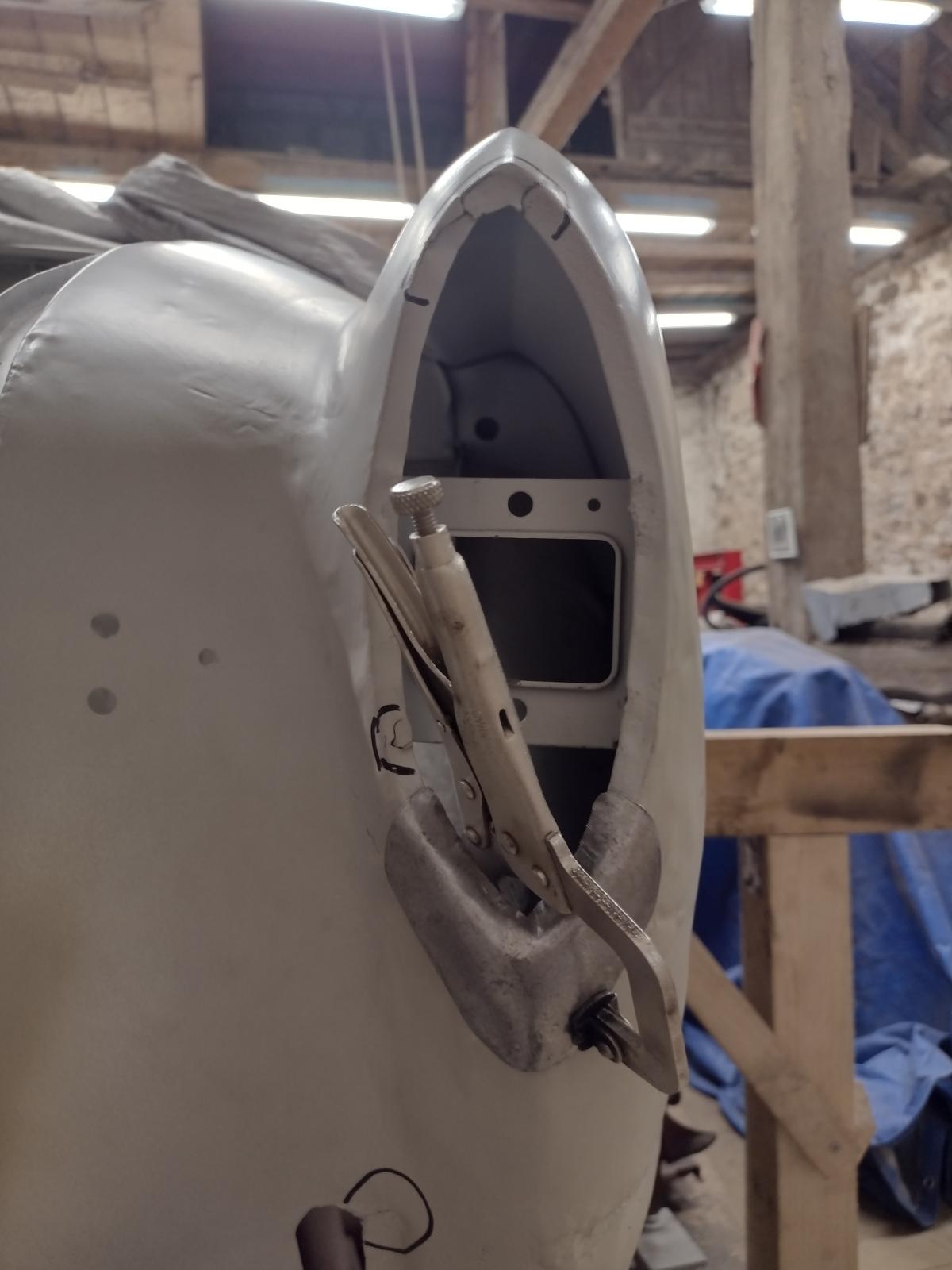

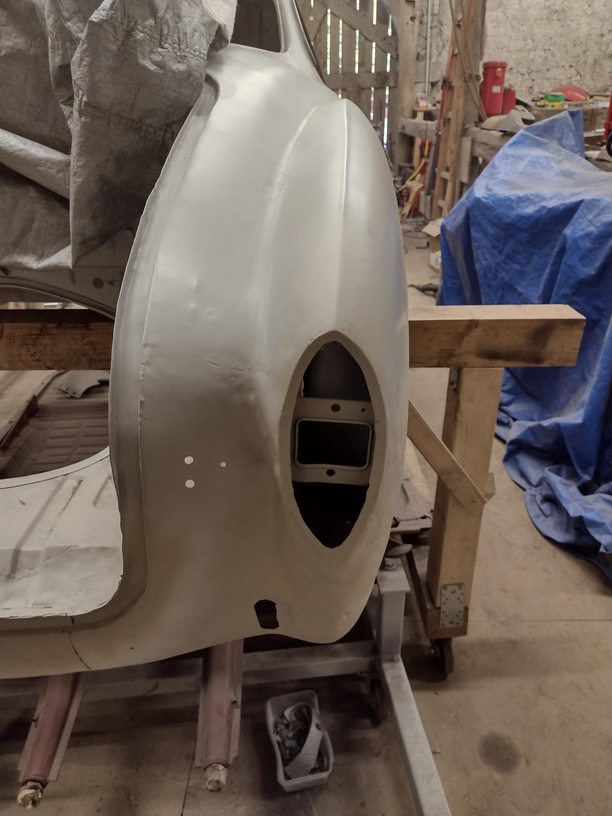

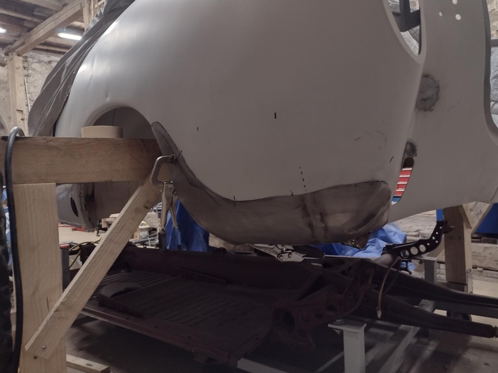

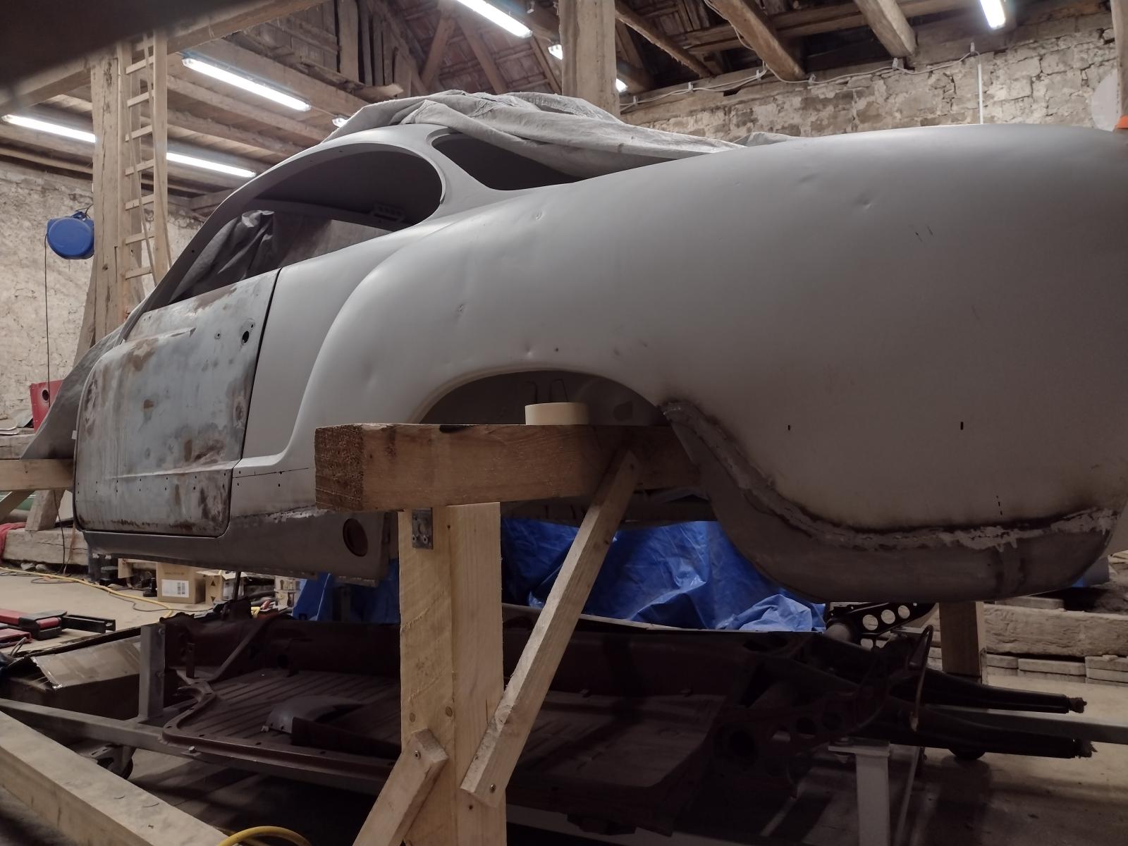

I then cut the rear quarter accordingly to check behind:
And repaired the necessary:
And then final adjustment, welding, and this part of the quarter panel is done :
Couple holes/defects also have been fixed:
What a view :

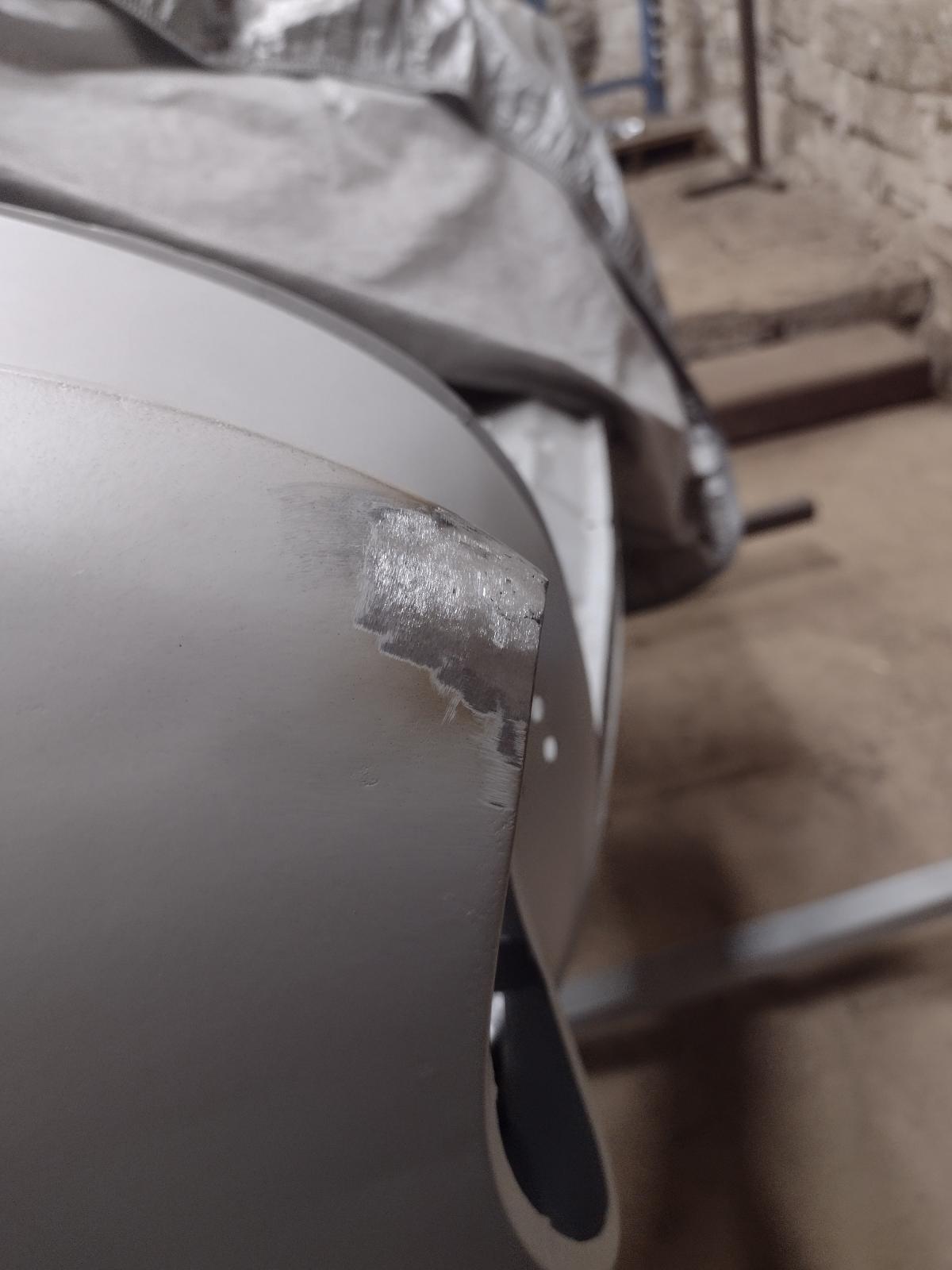

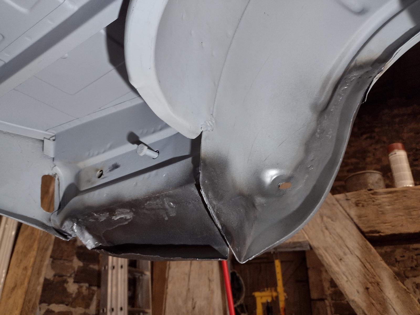

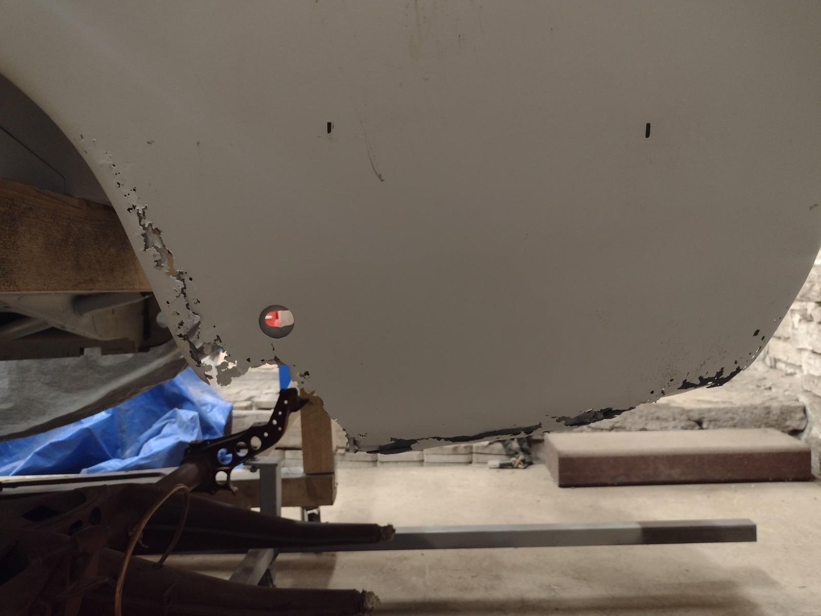

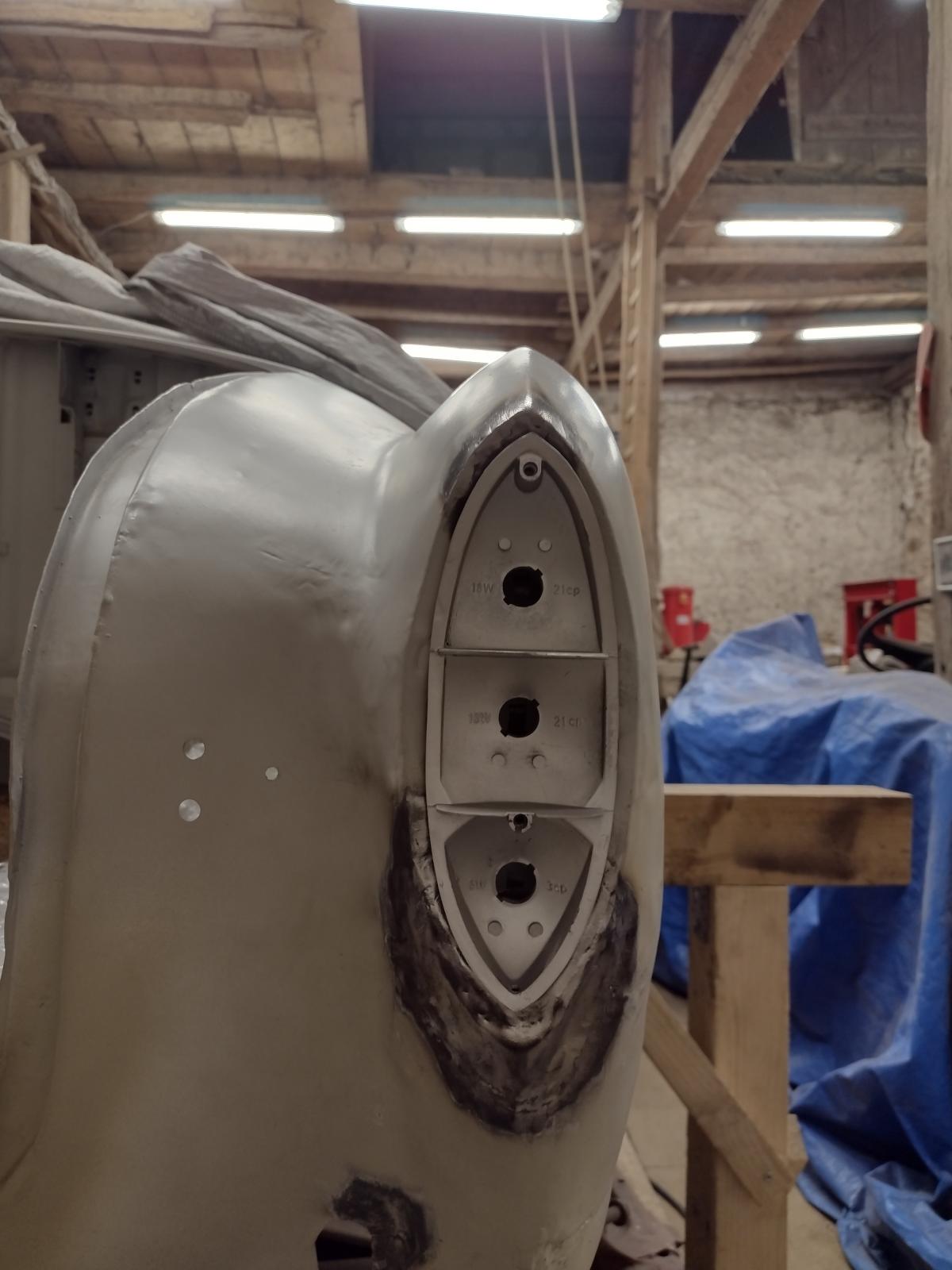

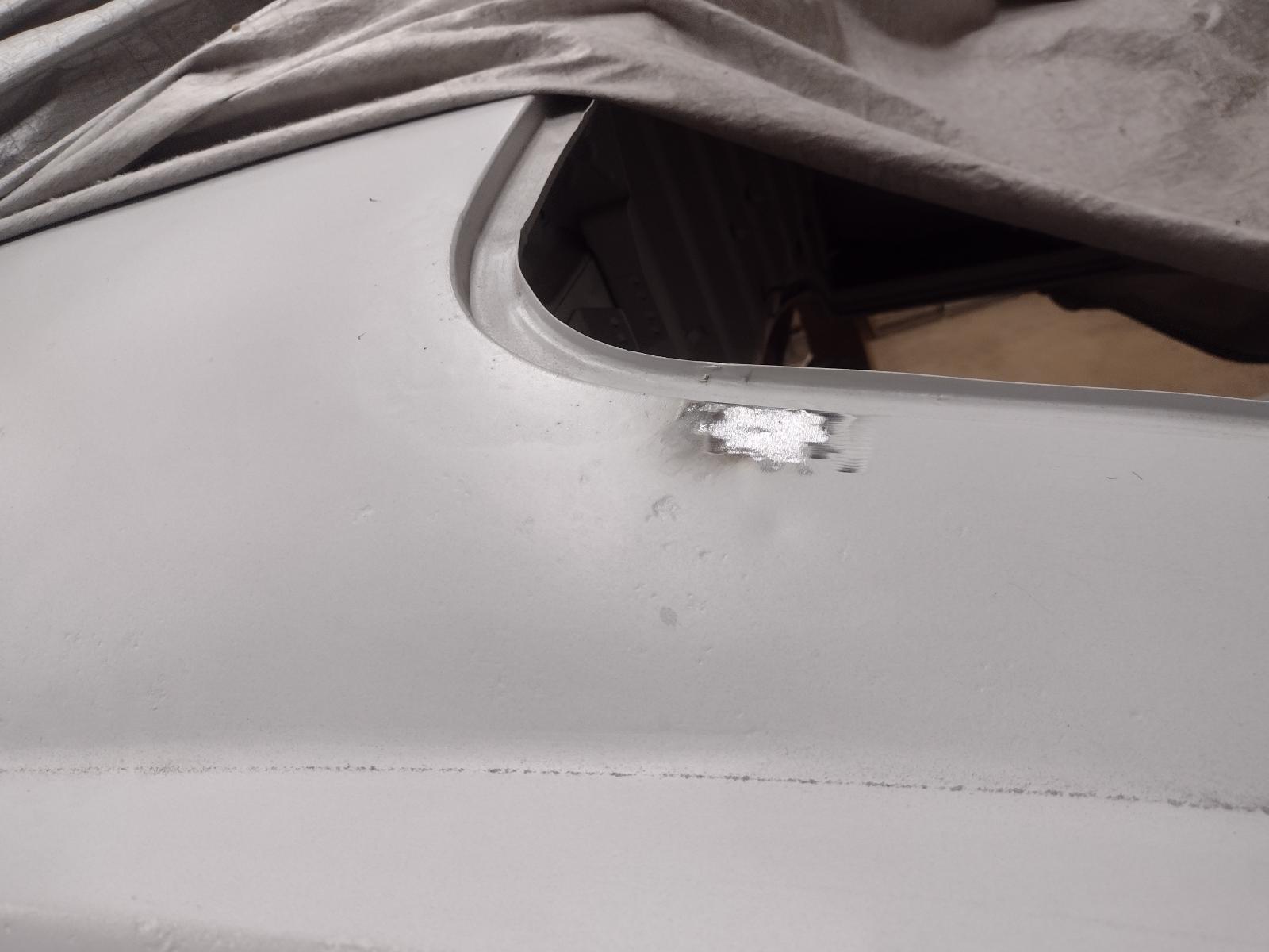

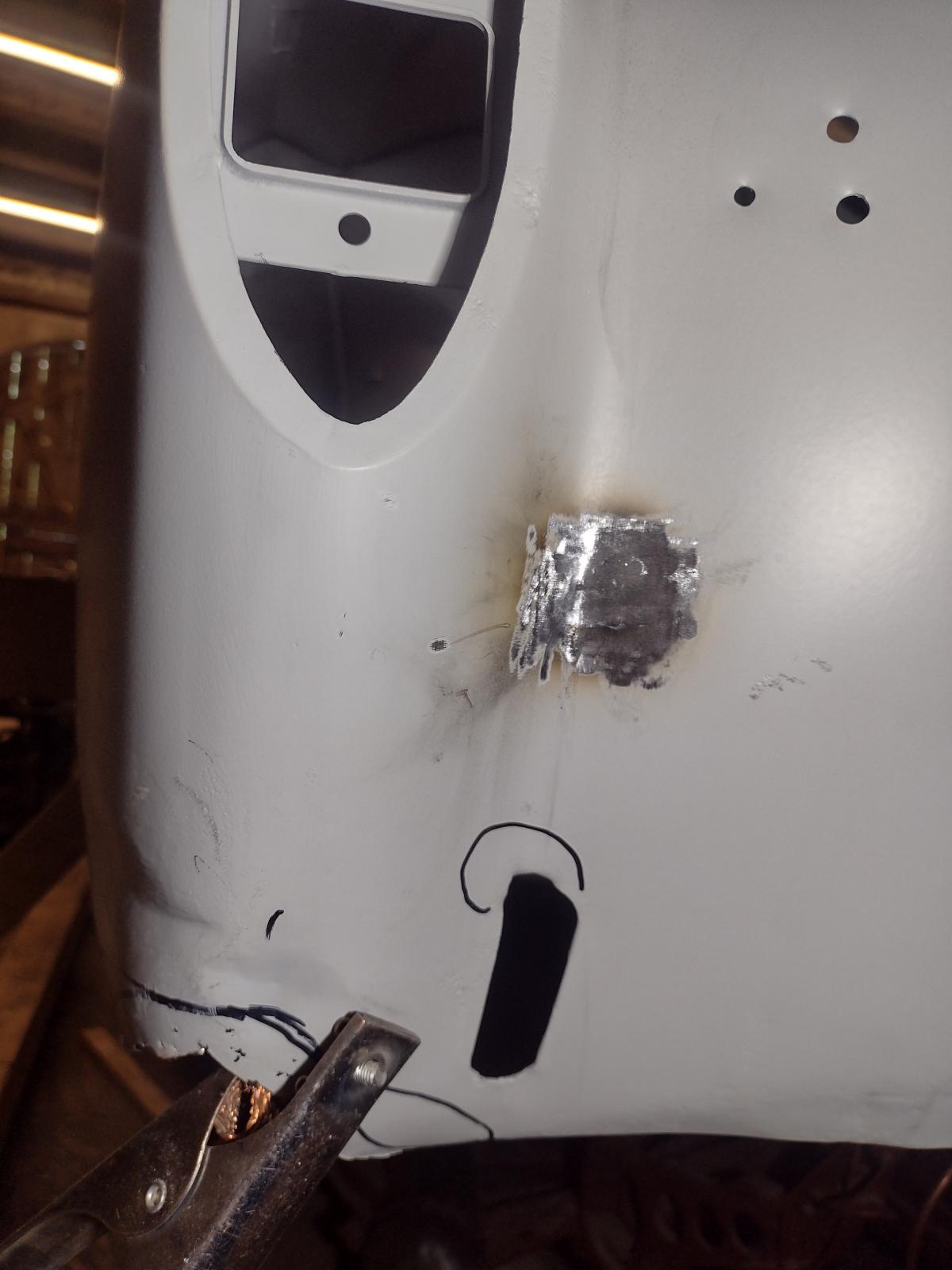

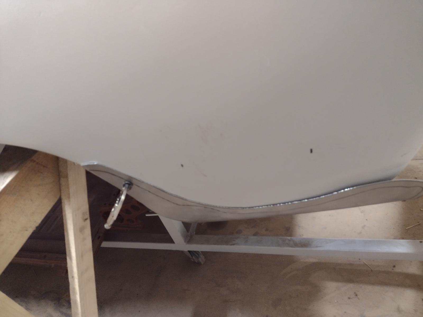

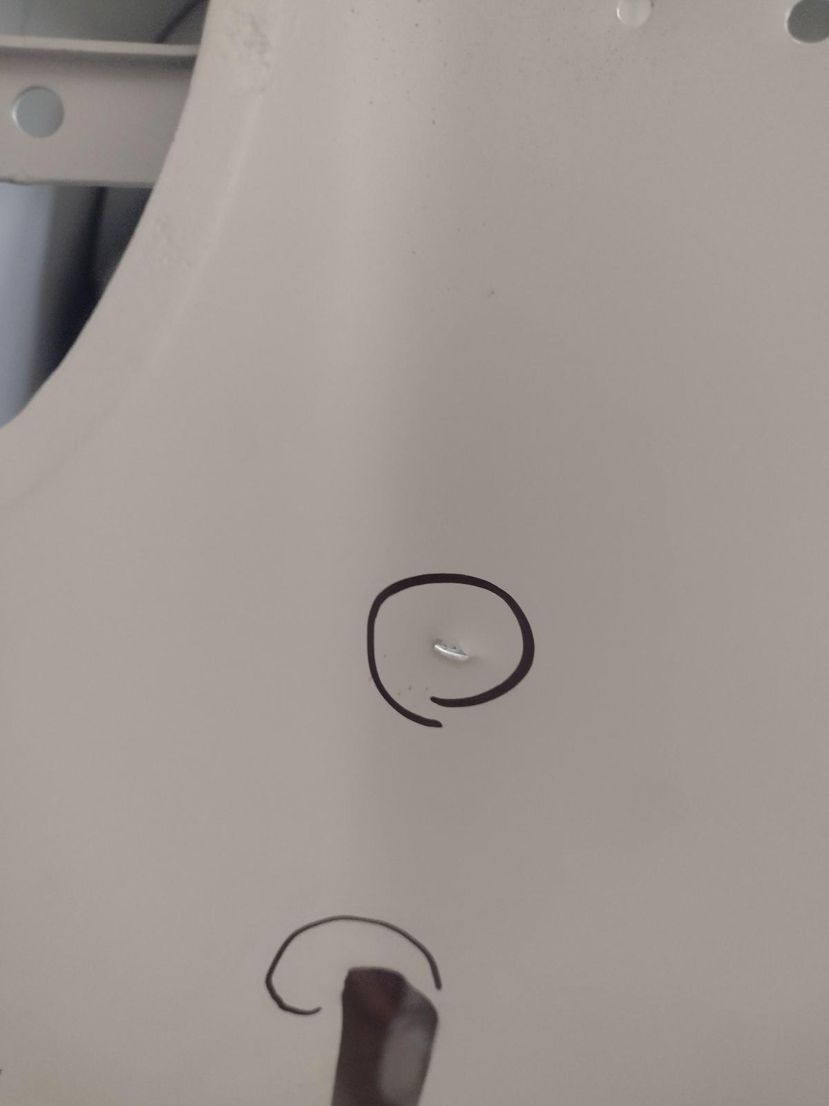

So, last necessary repair for the rear was here:

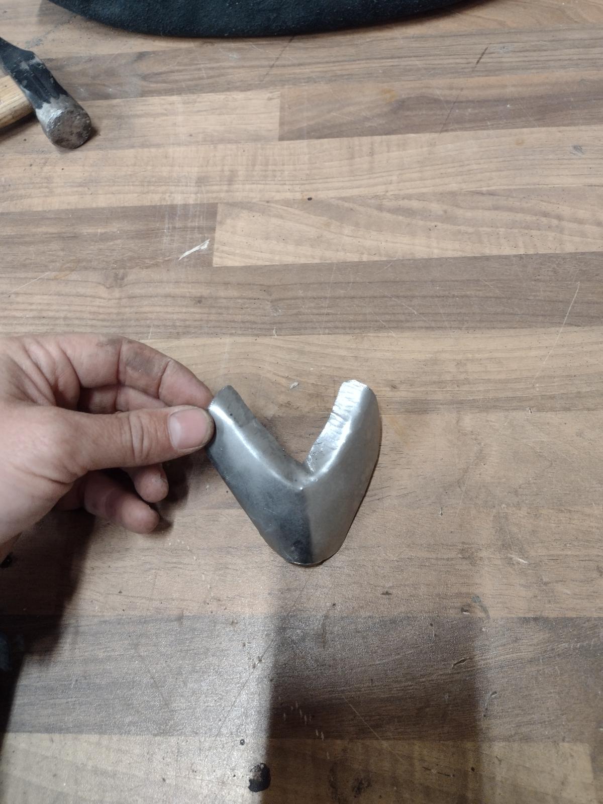

So I made a patch:
And in primer:
  #238

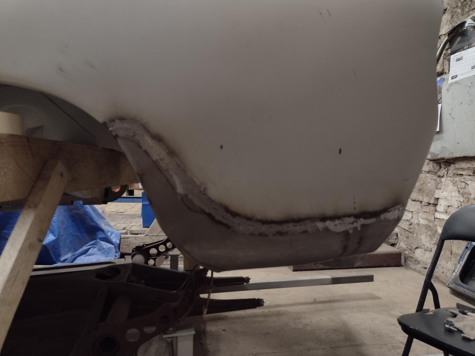

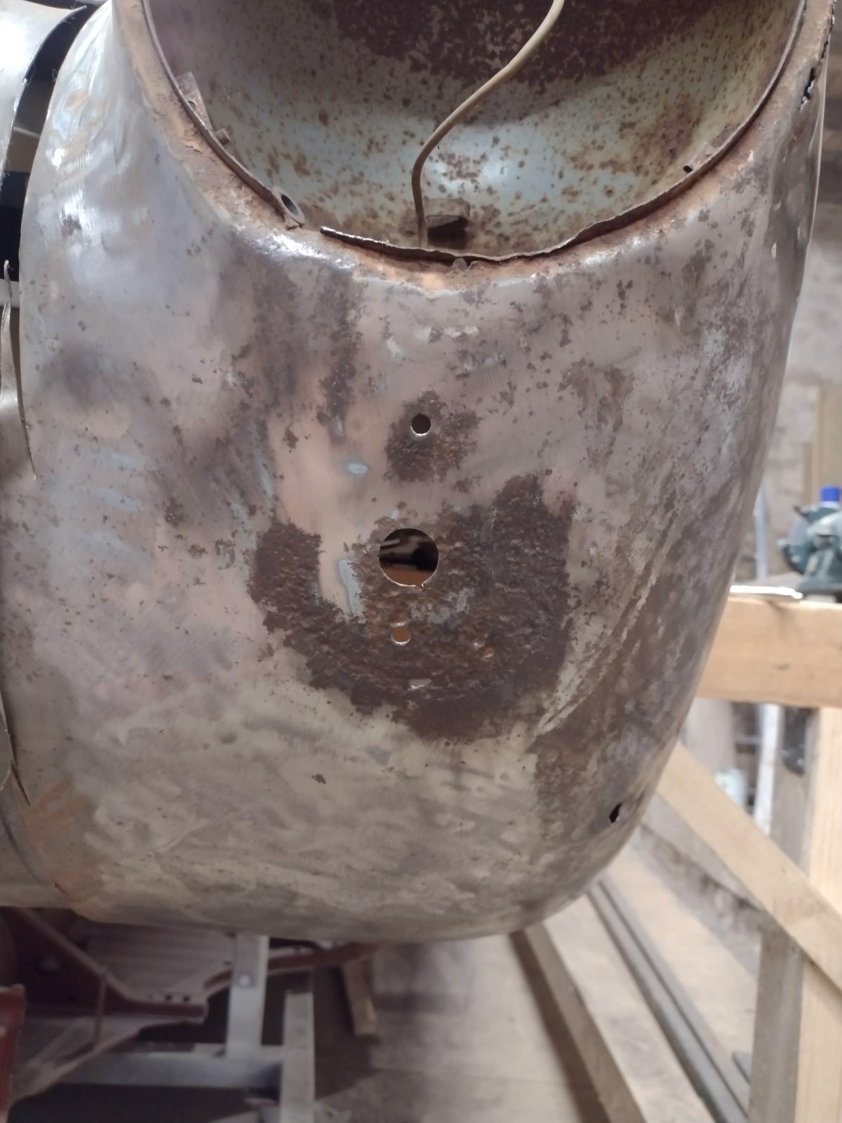

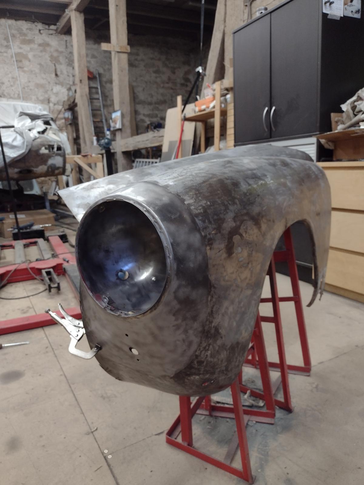

So, I then turned my attention to the front.

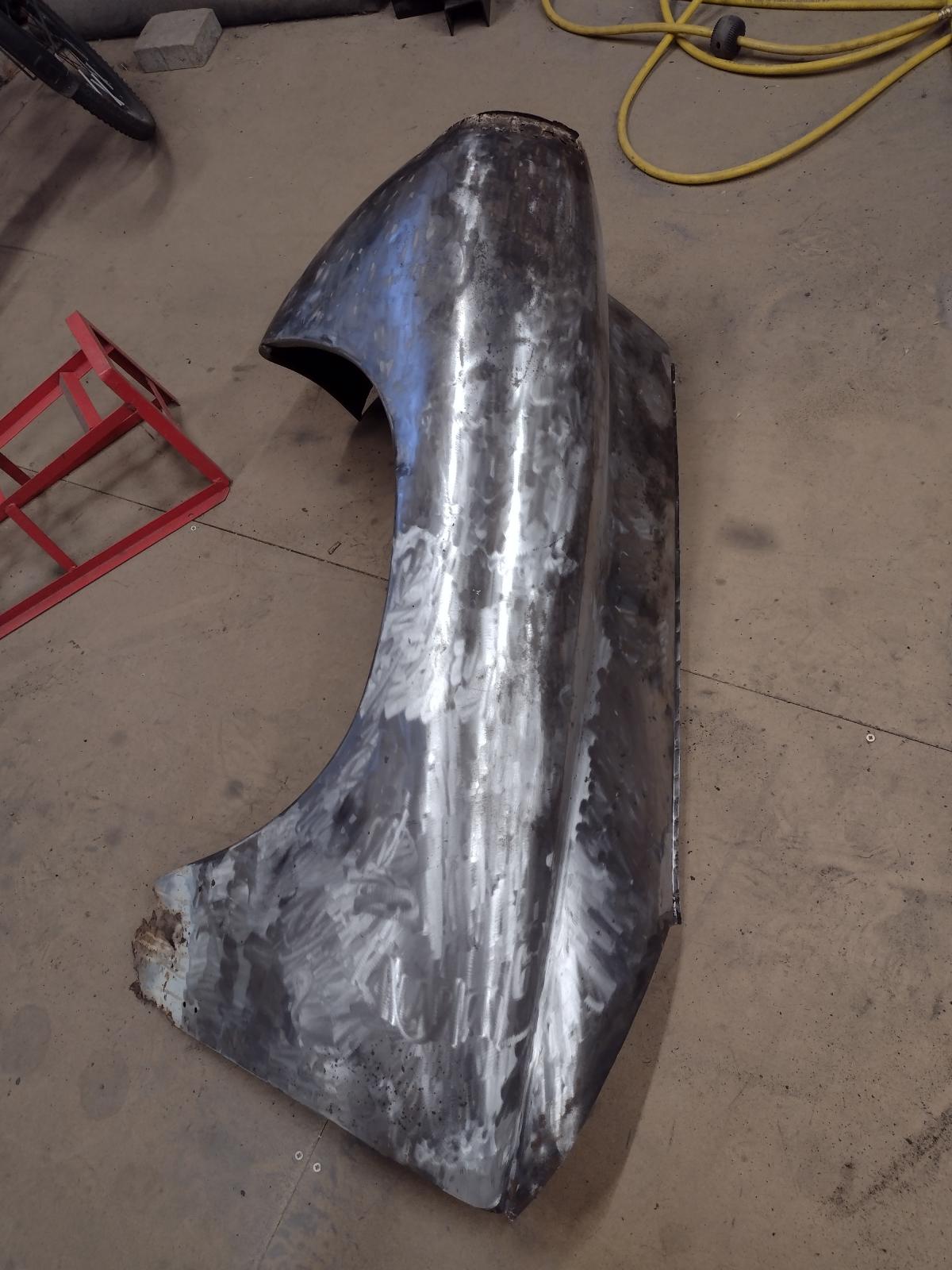

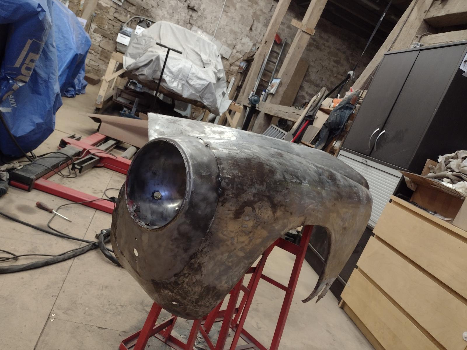

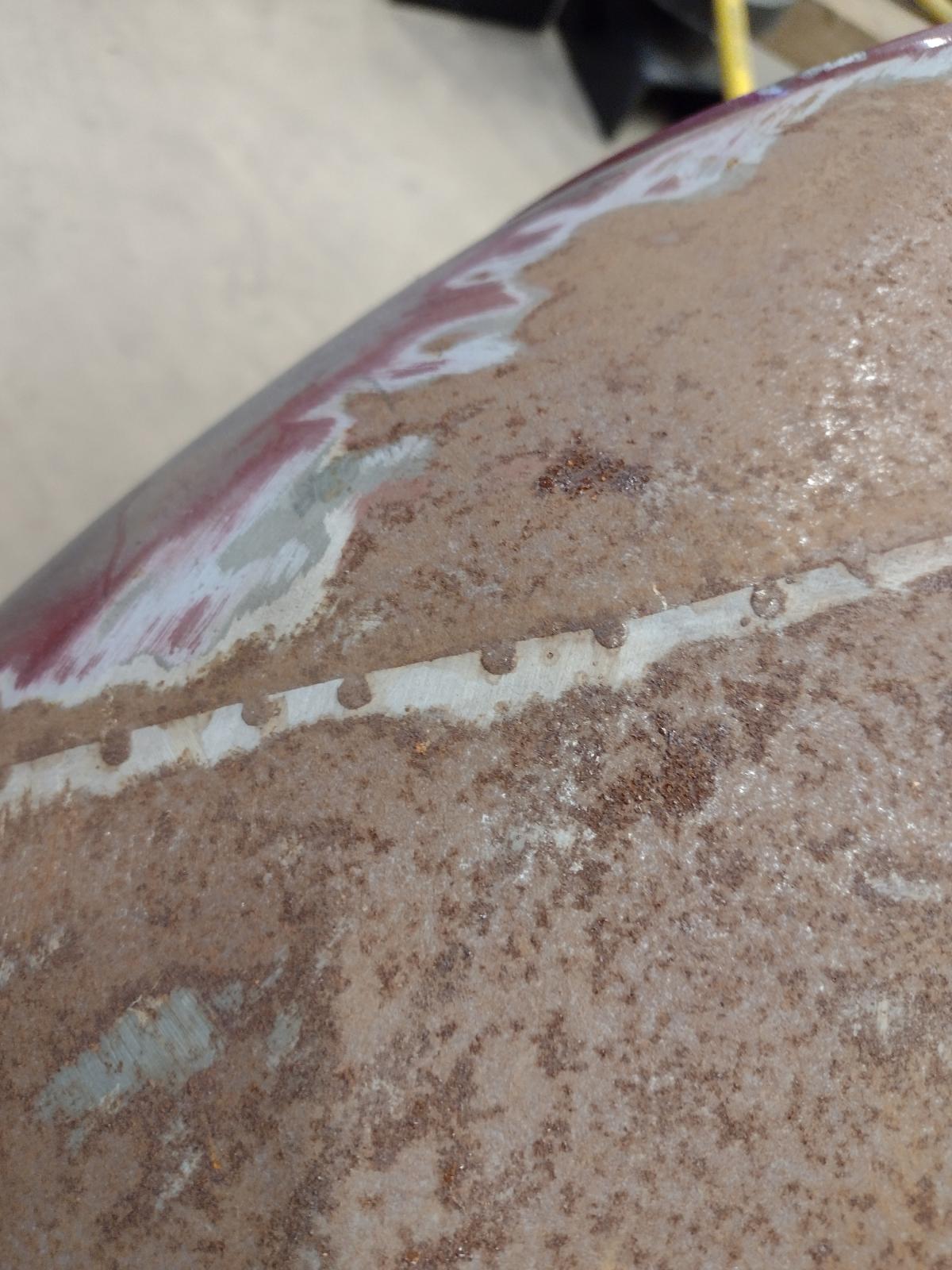

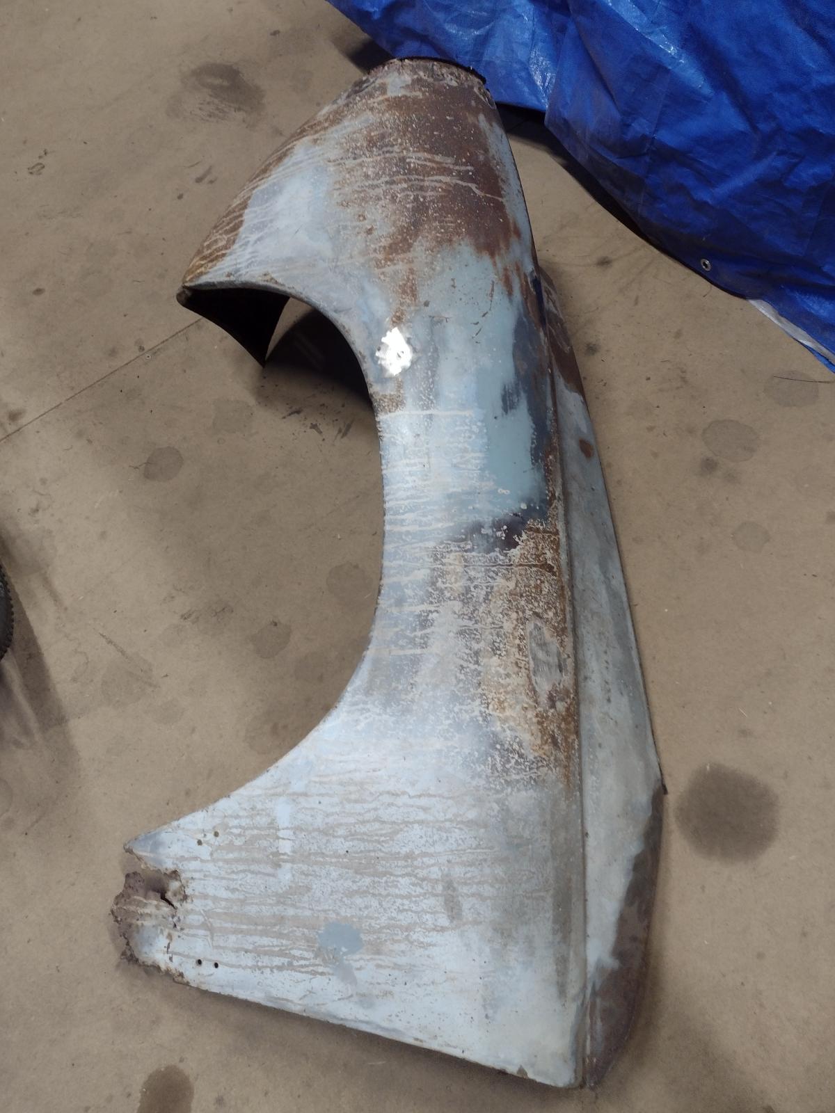

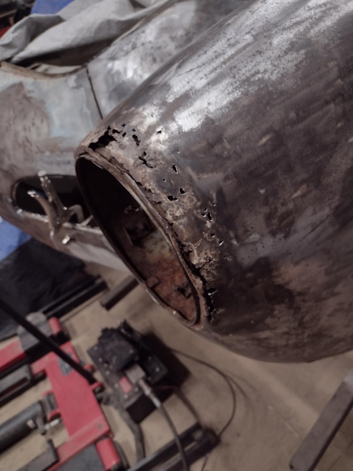

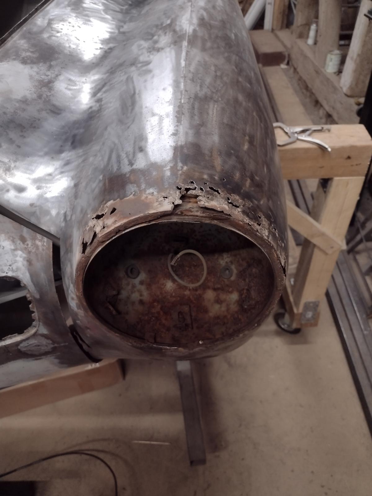

This fender was in need of attentions:
So first was to get it to bare metal to check the extend of fixes needed:

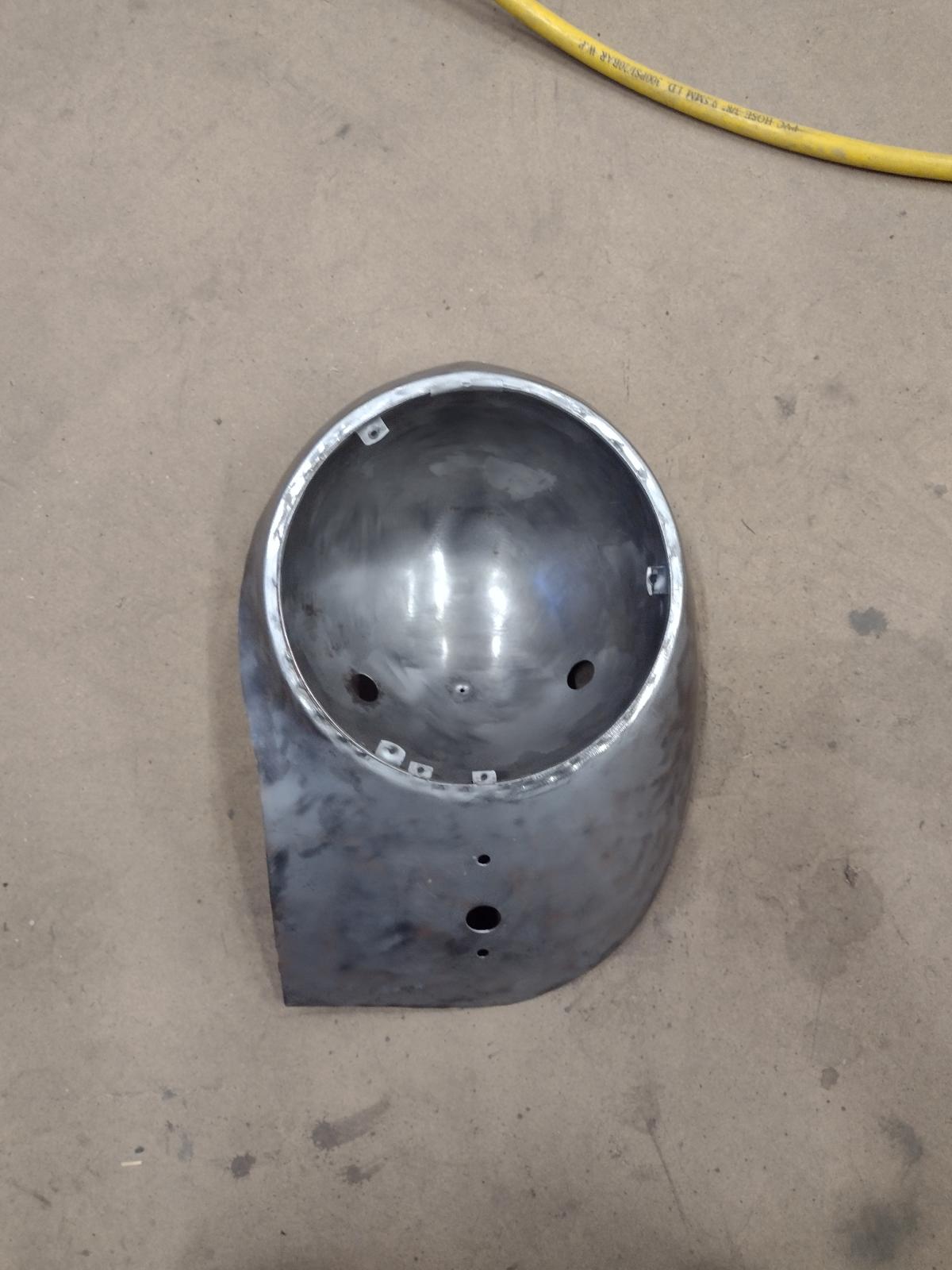

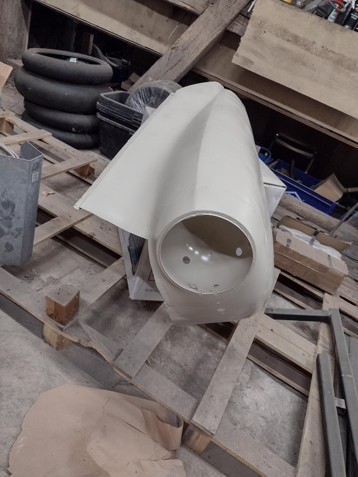

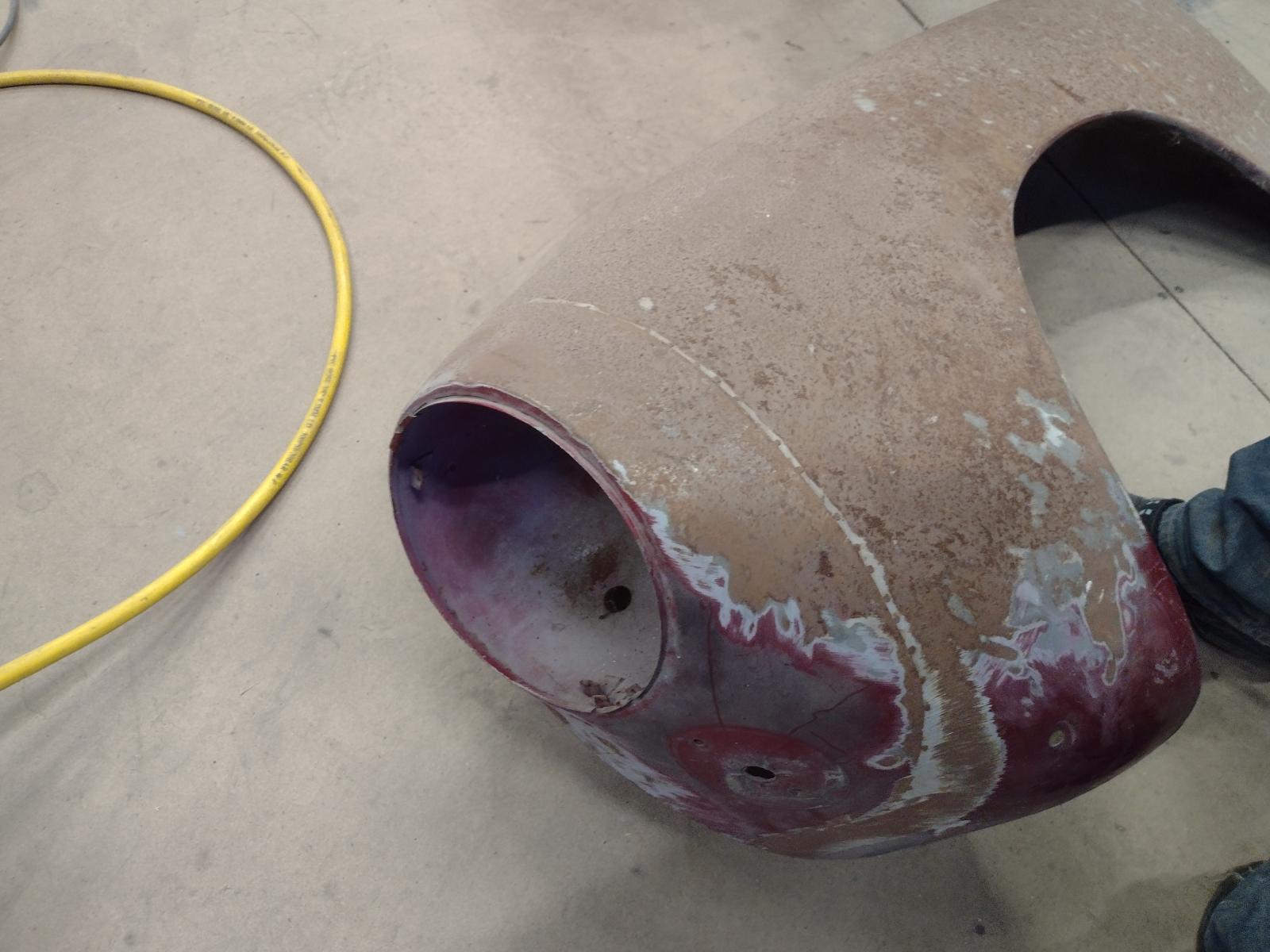

The bottom of the back part will be done later when adjusting on the car but for the front part, to win some time I checked which part I had as extra and.. bingo :

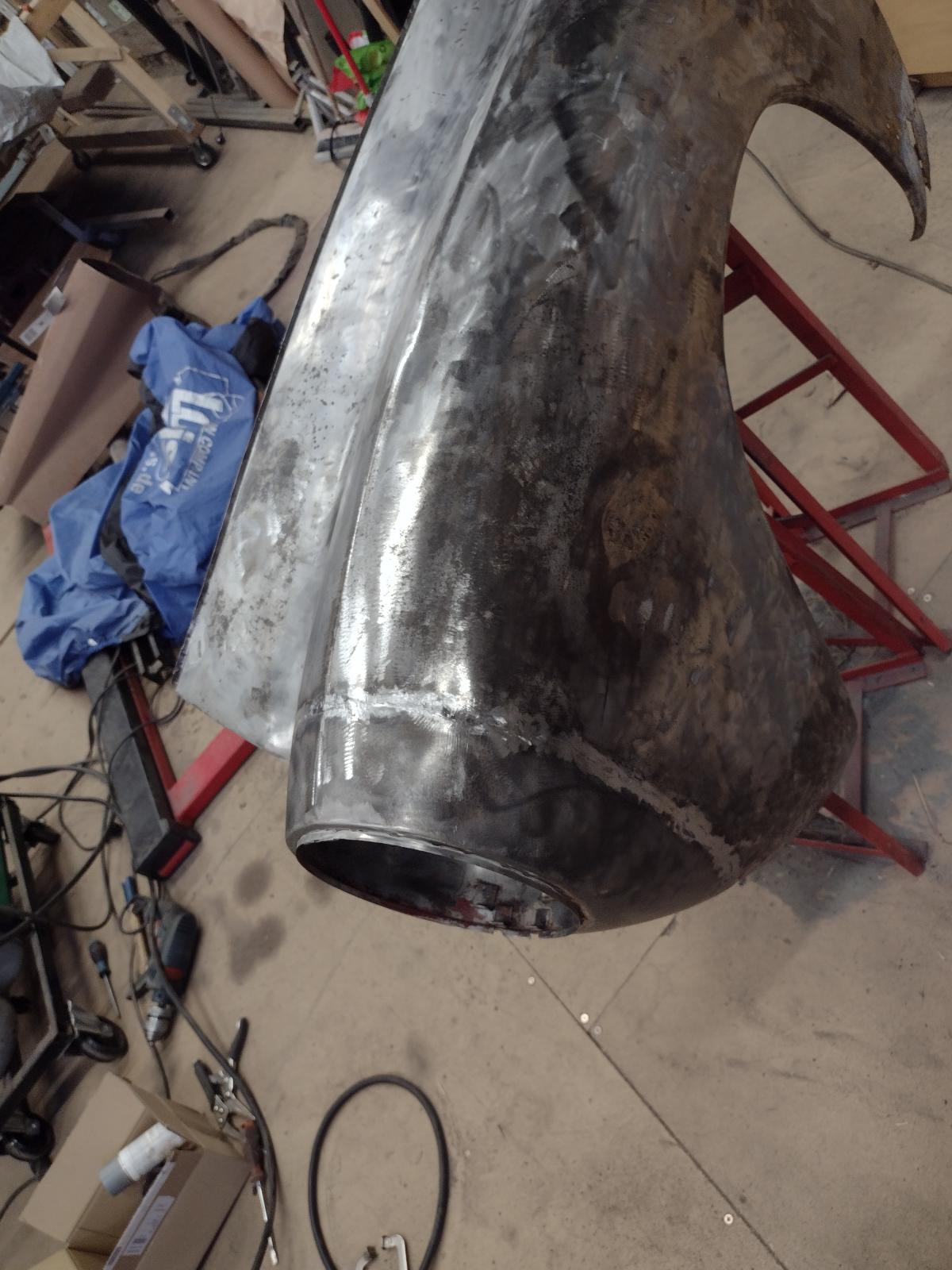

This fender was ugly:

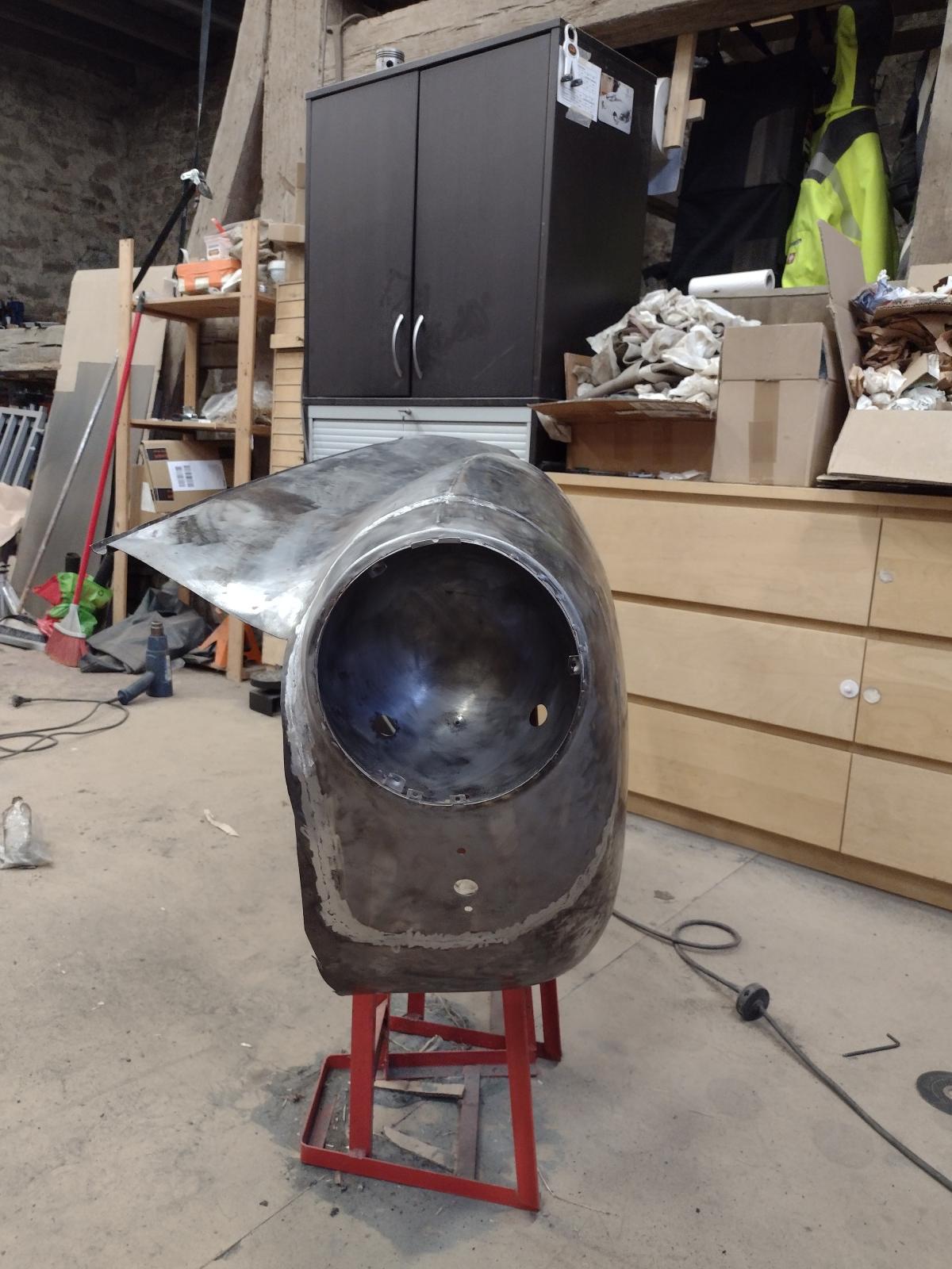

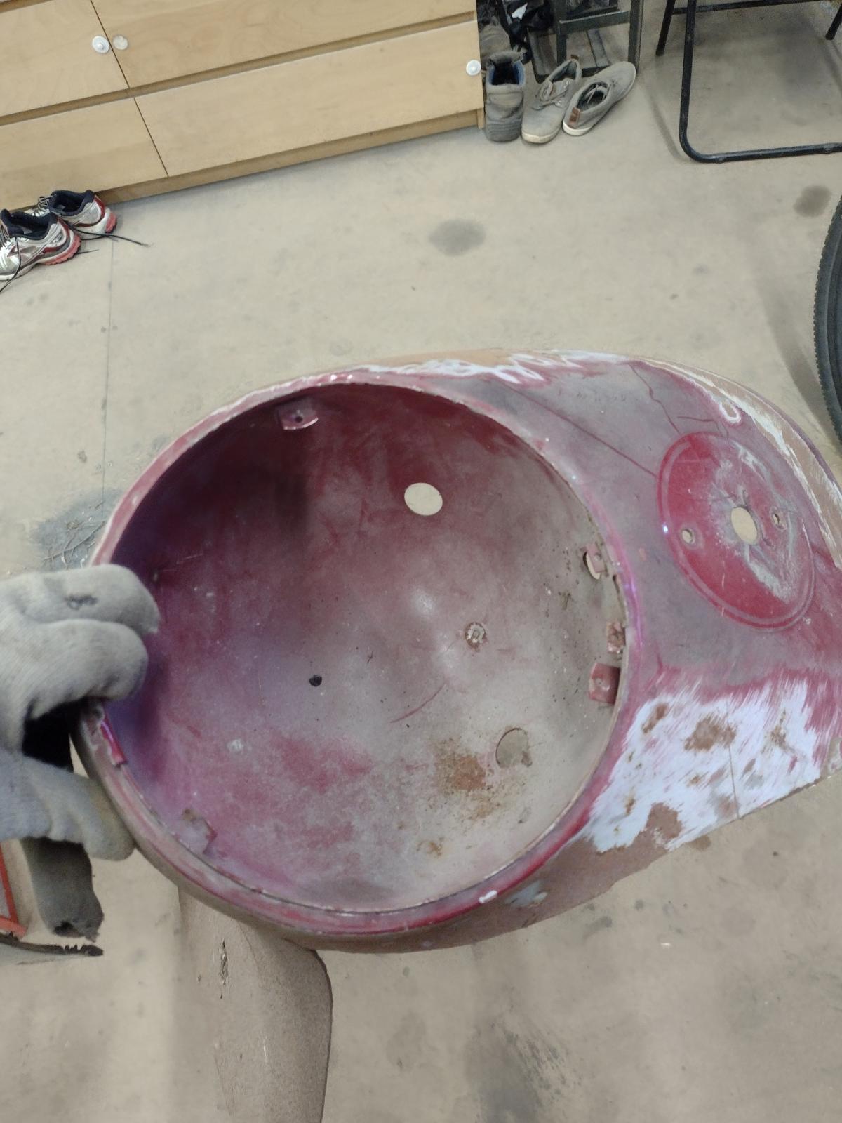

But looked like a front part was saveable as it had been badly patched over :
So I removed it:
Cleaned it :

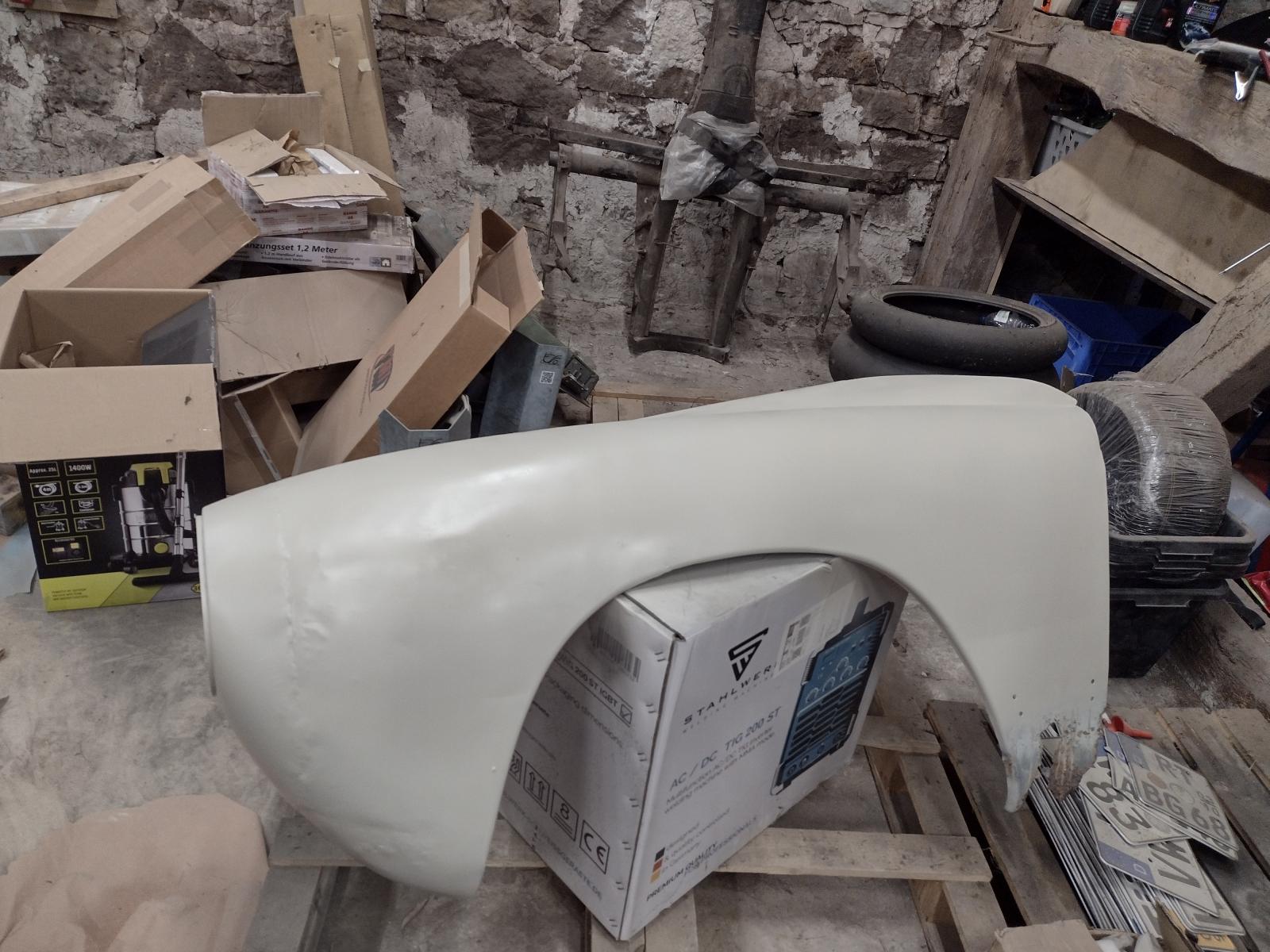

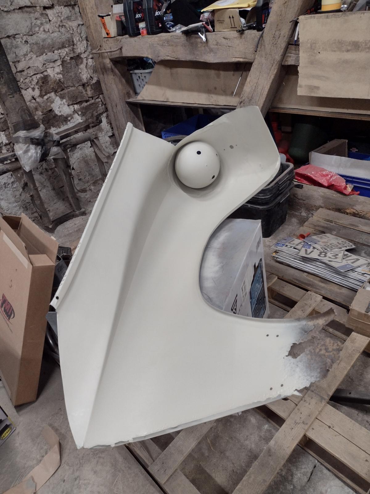

And then it was a matter of ajusting, cutting, welding:
Tacked in place:

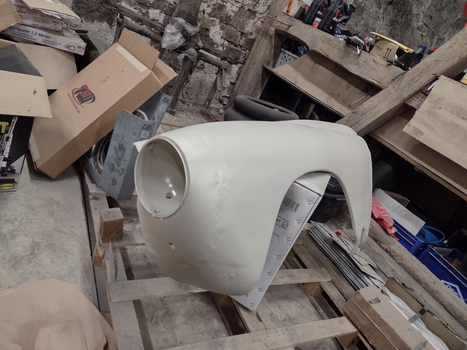

Welded:
And primered:
Back part will be done as mentionned when adjusting the front block but it's already looking way better!

Great luck on that one Antoine. When I saw the rust, I was feeling sorry for you. I scrolled down and bam, spare parts.
