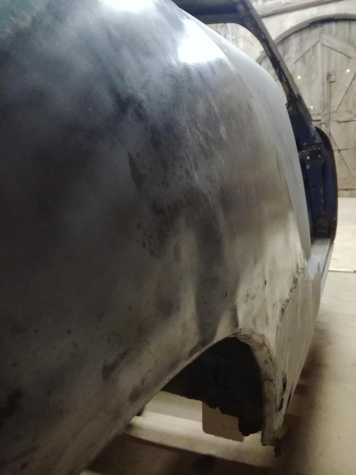

Small update on the right rear quarter panel..

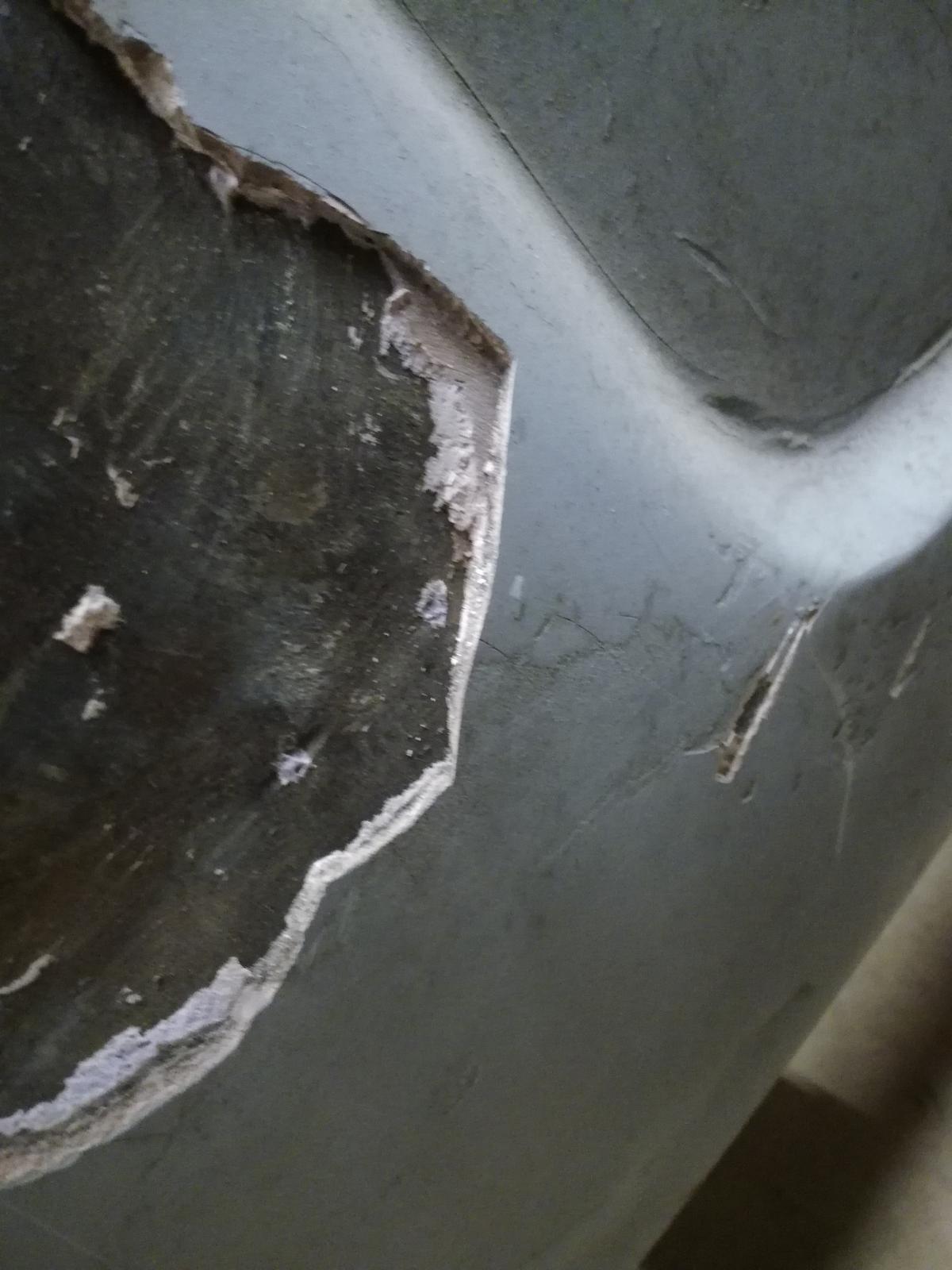

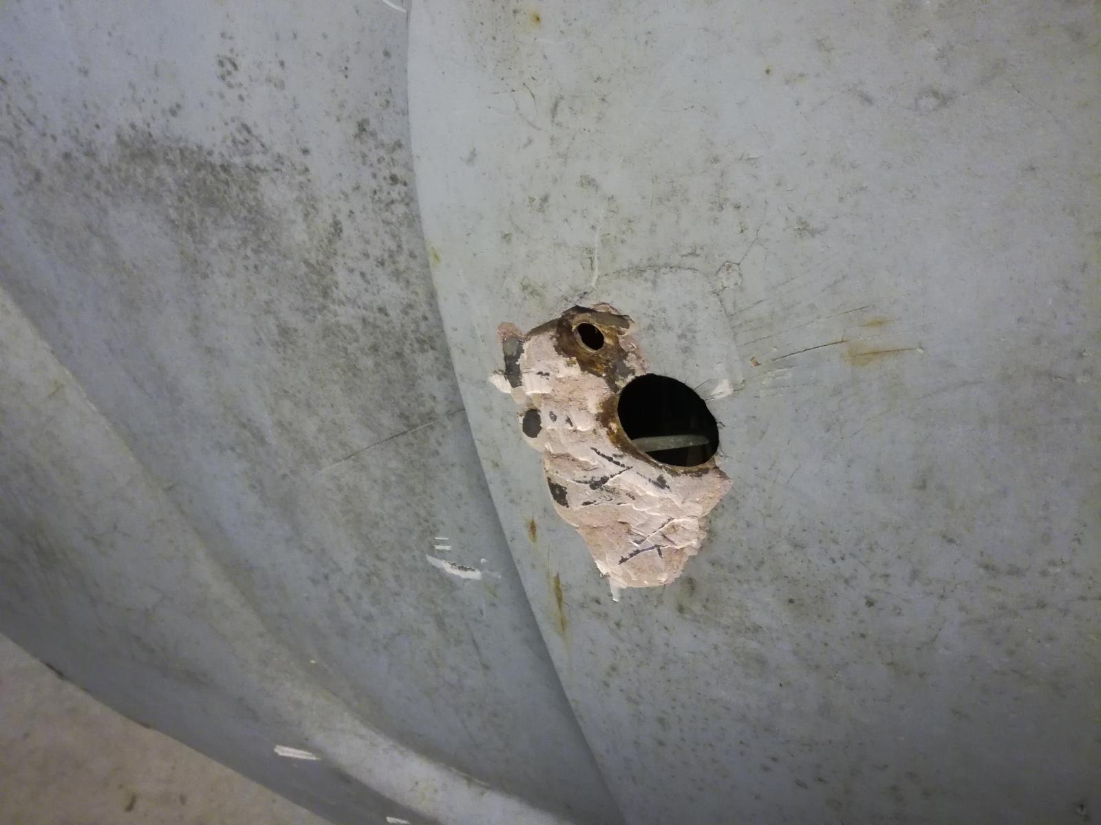

When I did receive it, it was clear that it was full of bondo like the door:
So I started to remove it, with the fear of what is underneath:
But in fact it's better than I thought, only one dent some waves in the front where you can access from behind so I can save it:
Stay tuned,

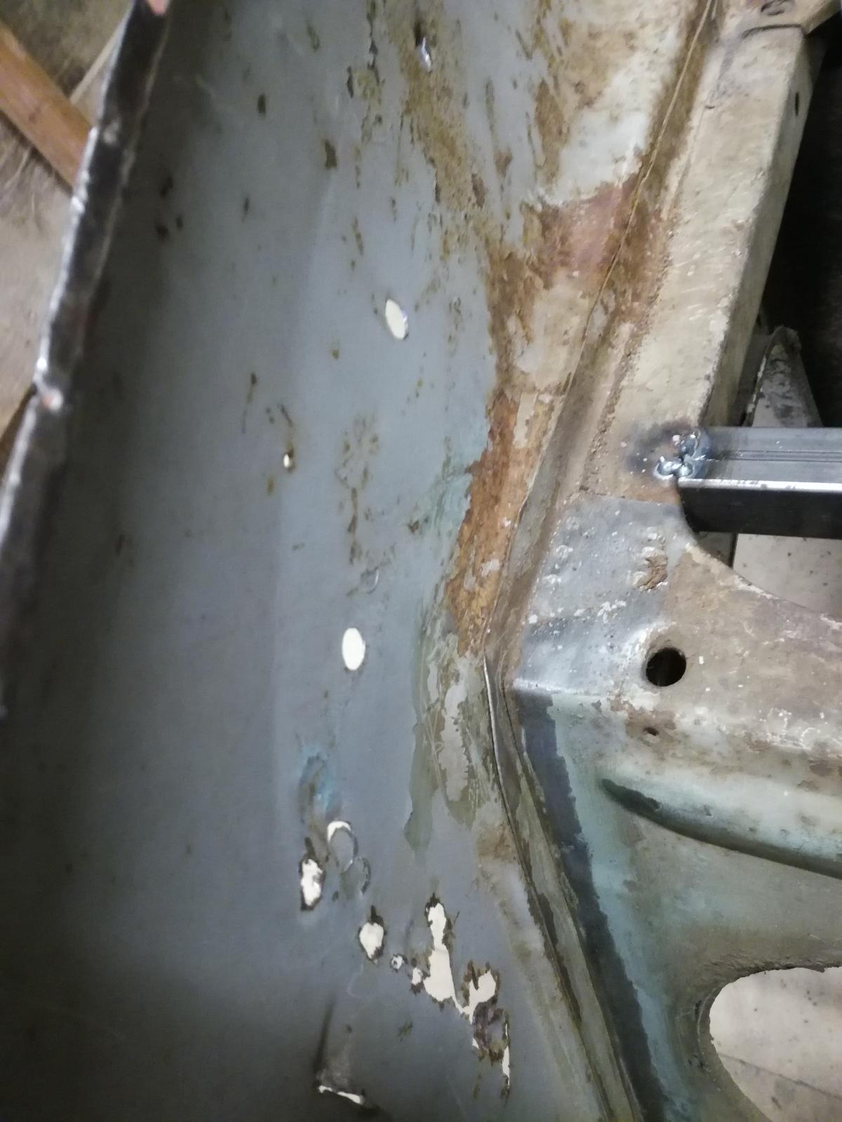

Well, while I was already working on this side, I also put a part of the front inner fender wheel back into shape
You can see here a dent in the middle:
After a bit of hammerwork:
And same here with the collision damage:
After a bit of planishing:
The rusted through front part will of course be replaced..

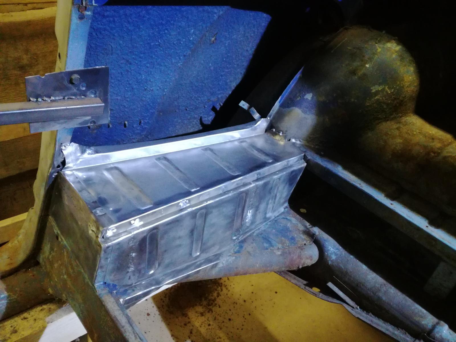

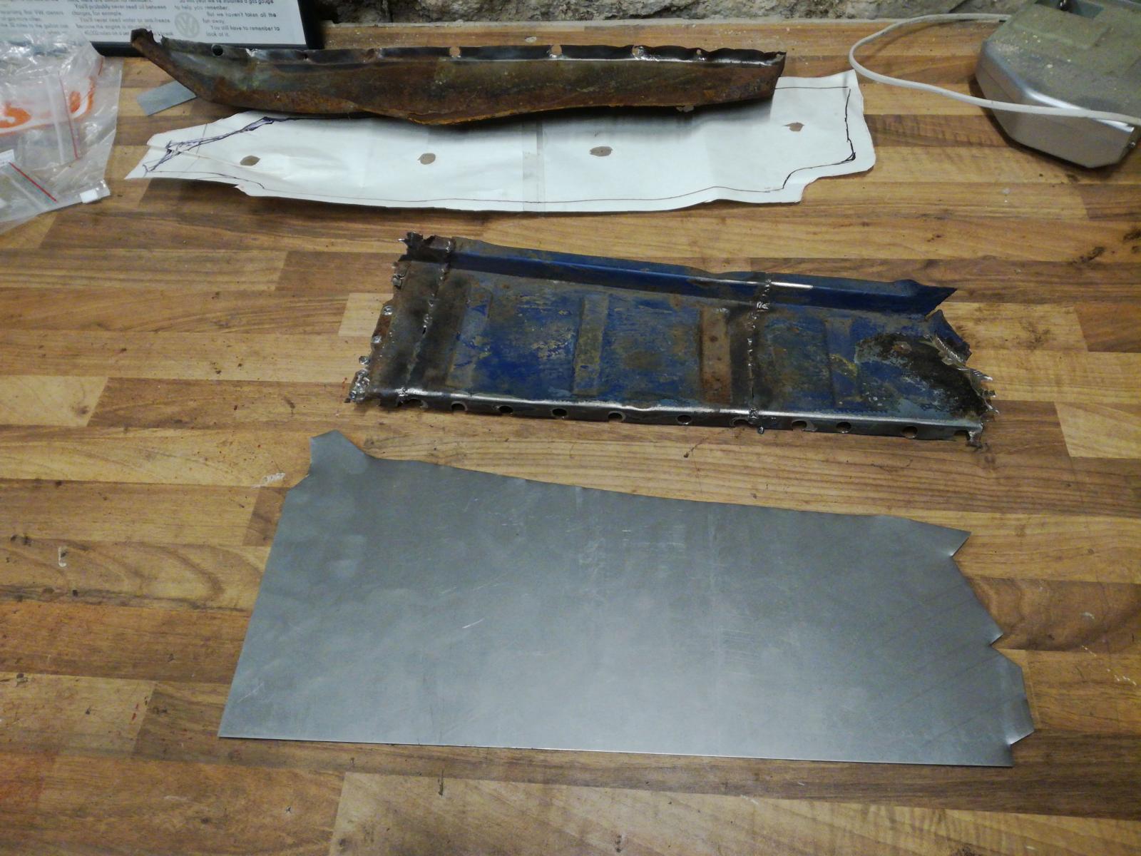

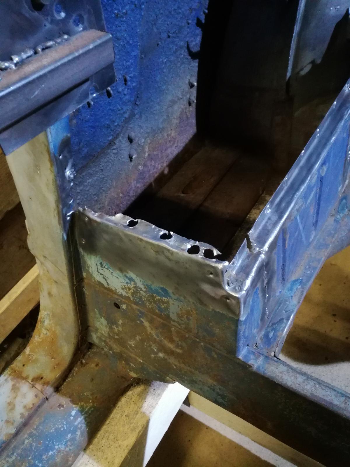

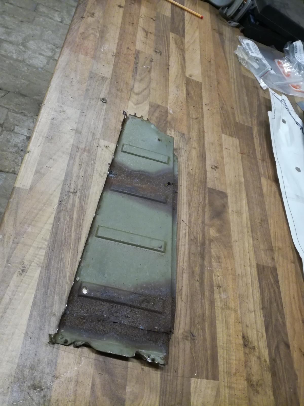

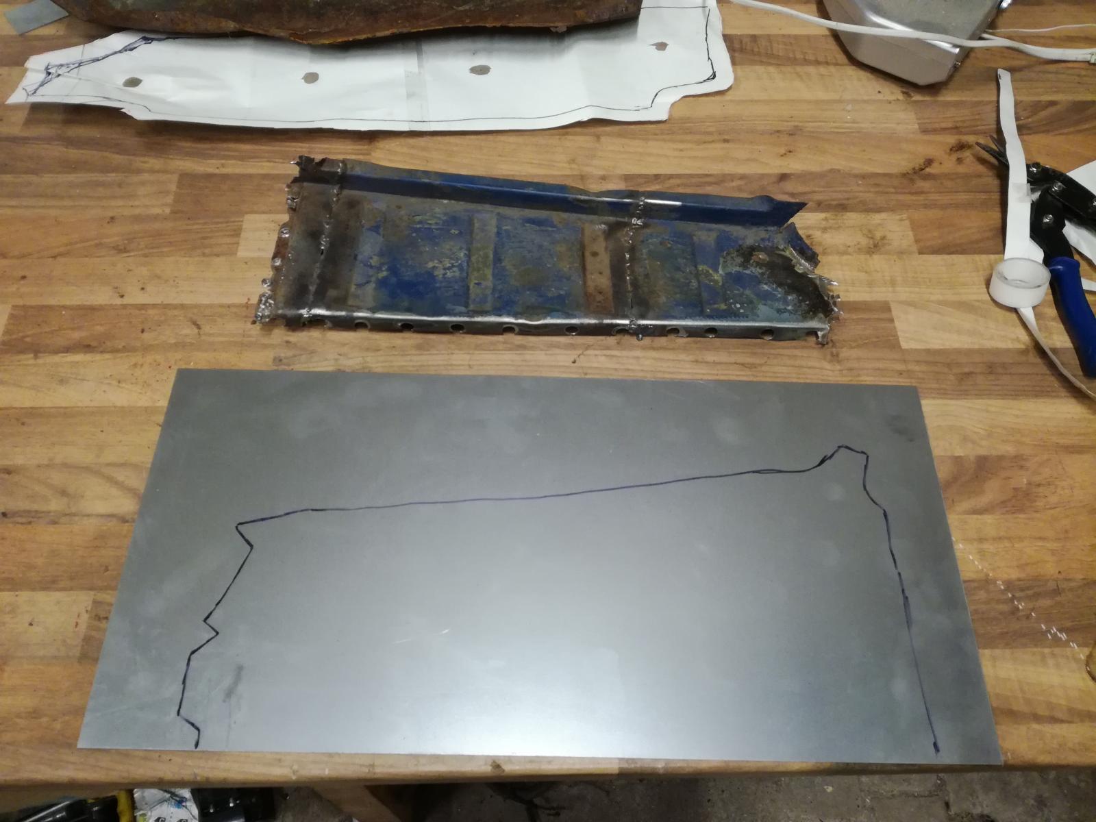

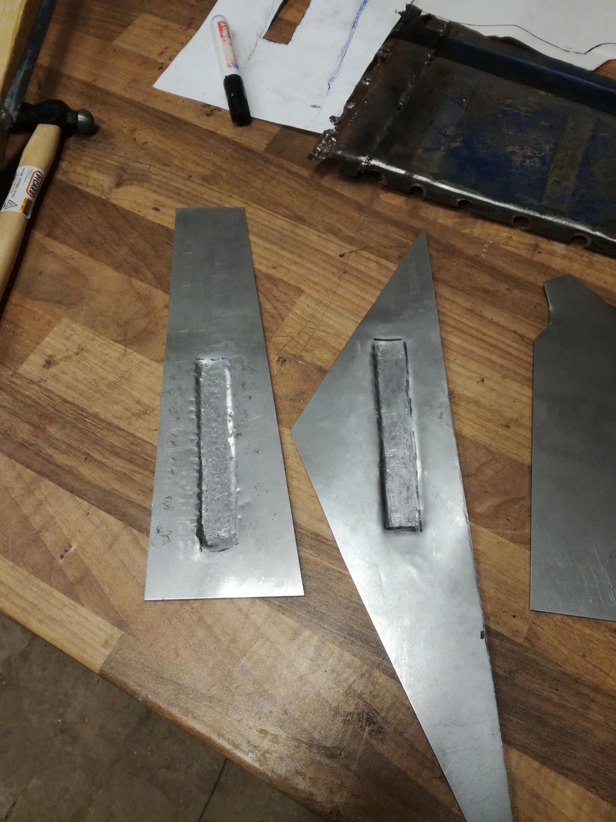

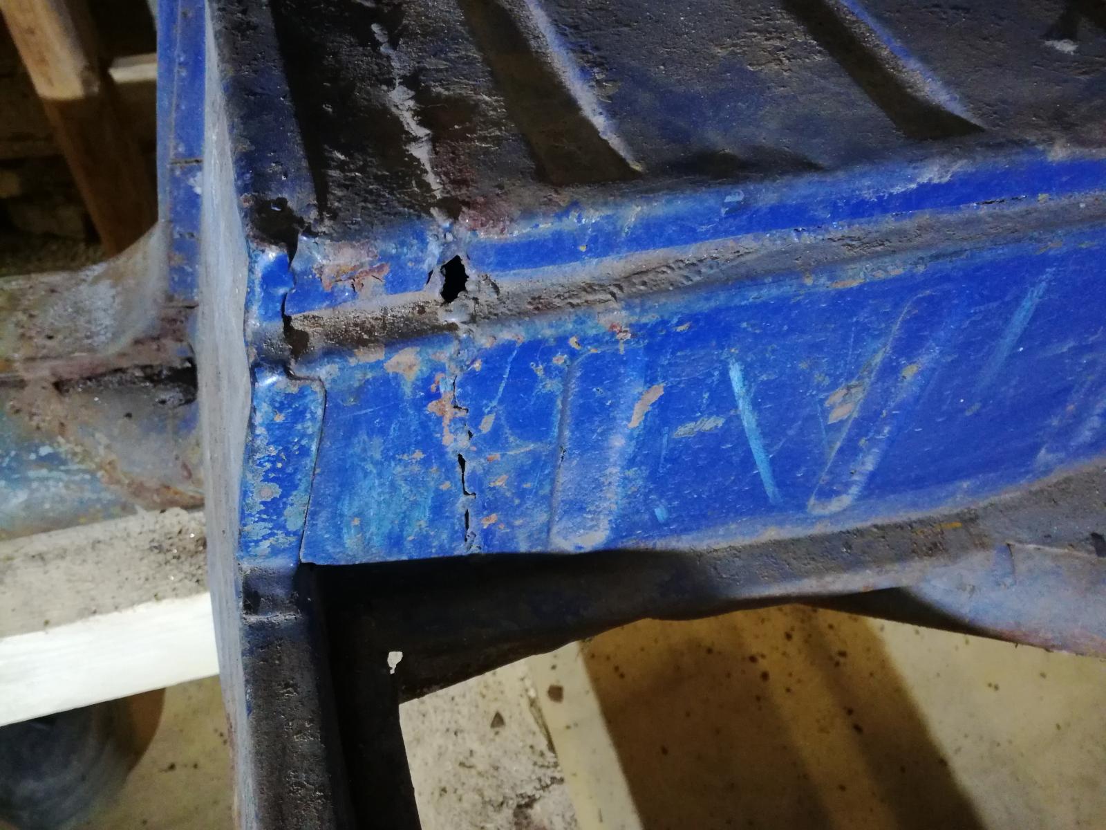

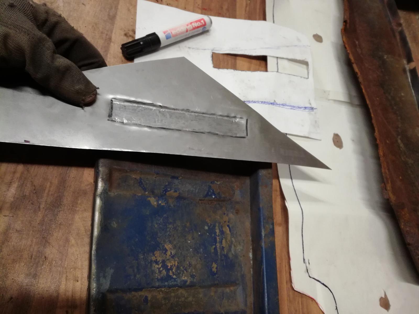

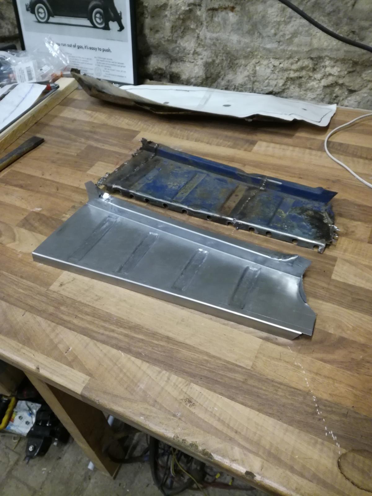

Last update here and we are more or less up to date

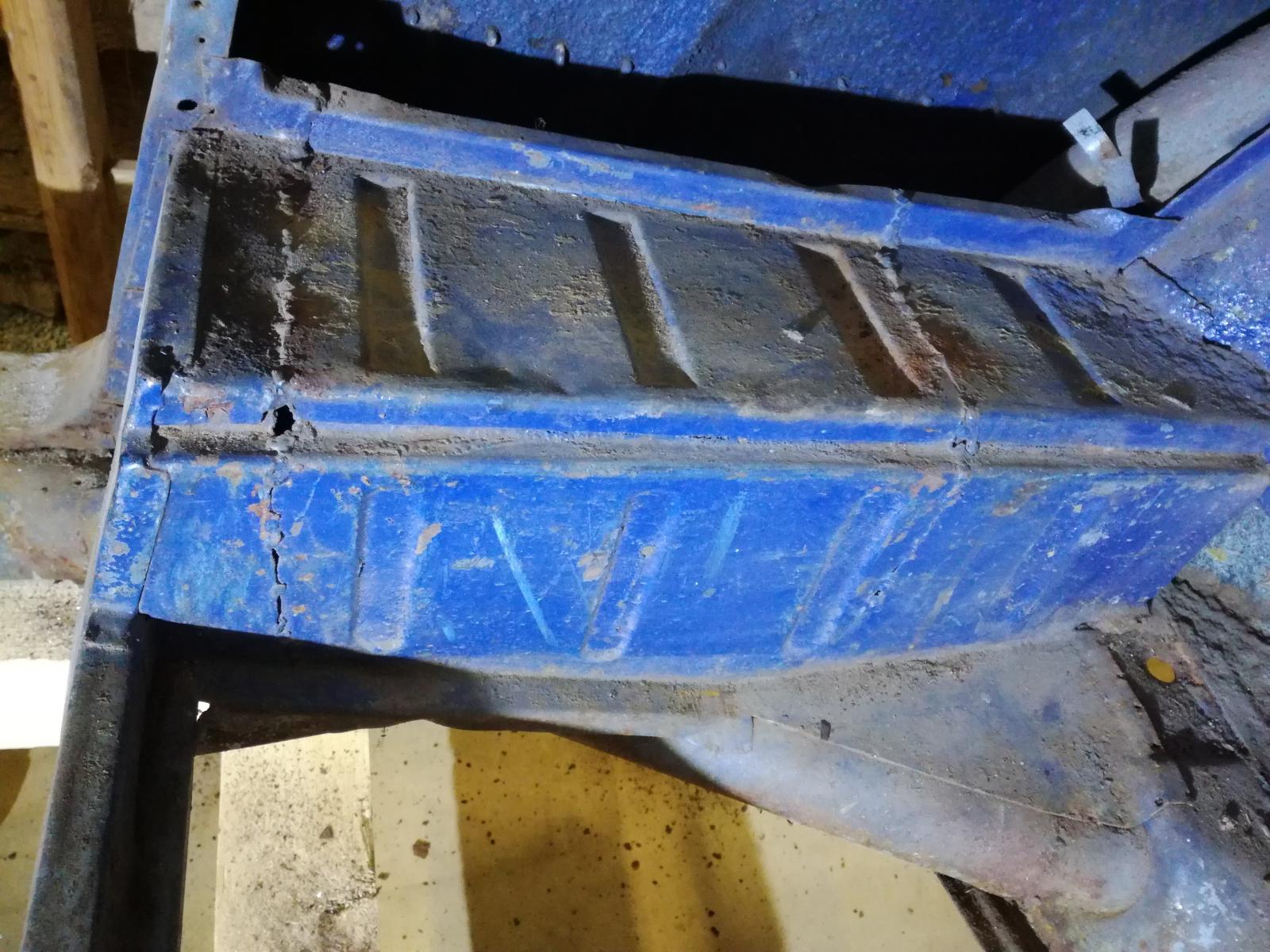

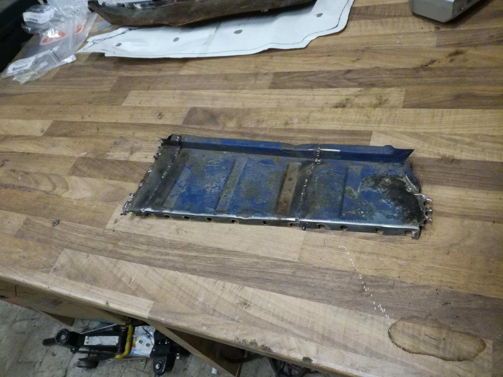

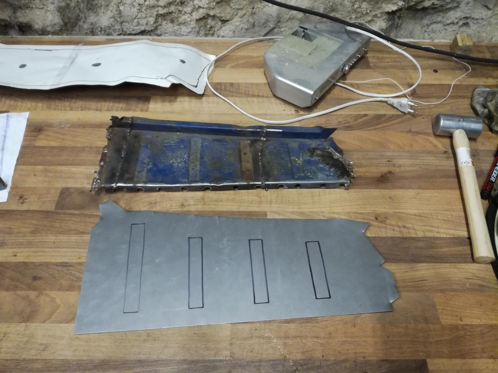

This part on the right of the rear seat had been cut and poorly "welded" together by a previous owner:
The bottom could be saved but the top was never gonna be nice enough so I decided to rebuild it from scratch 8)
First the removal:
And here we go:

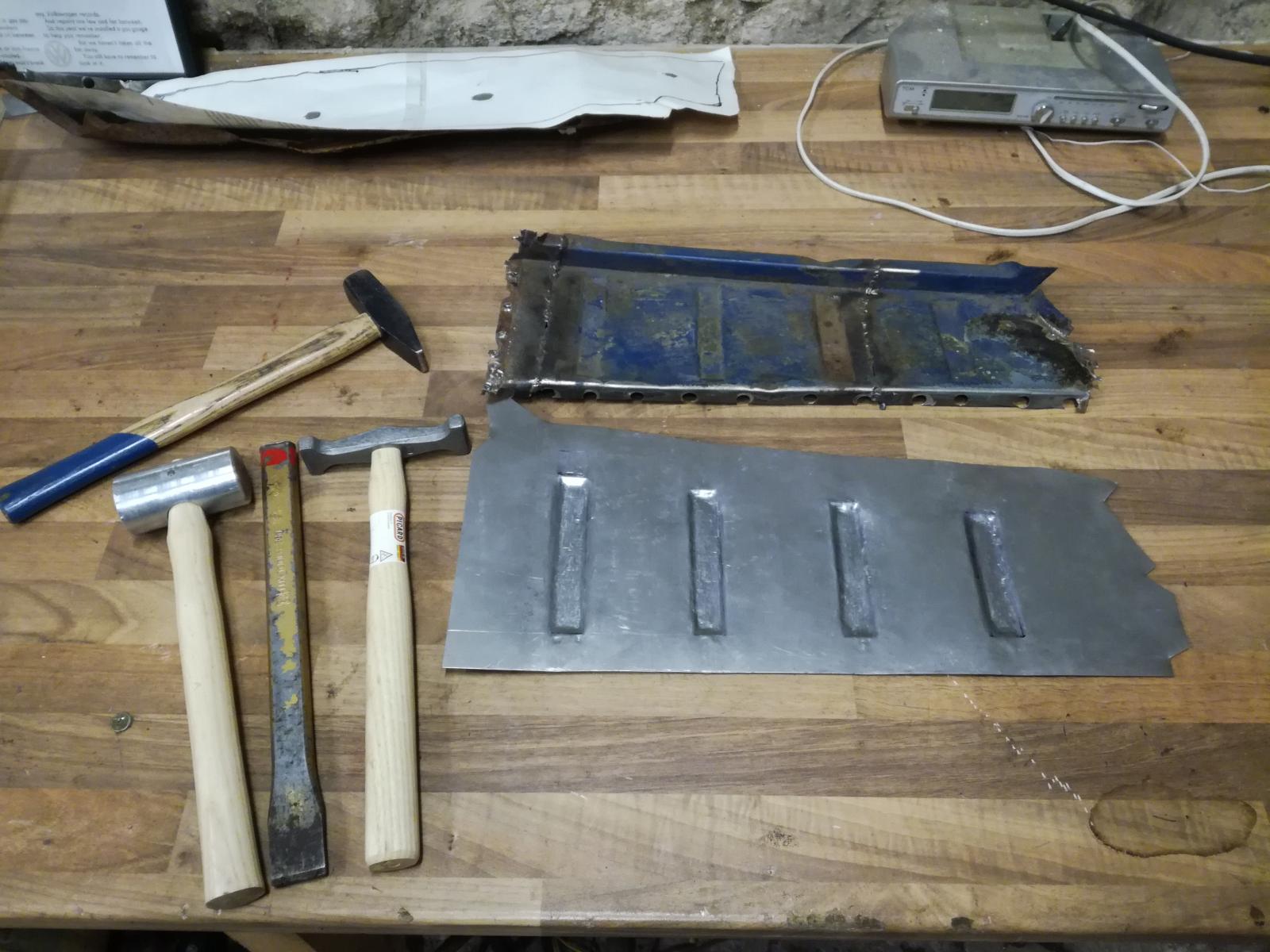

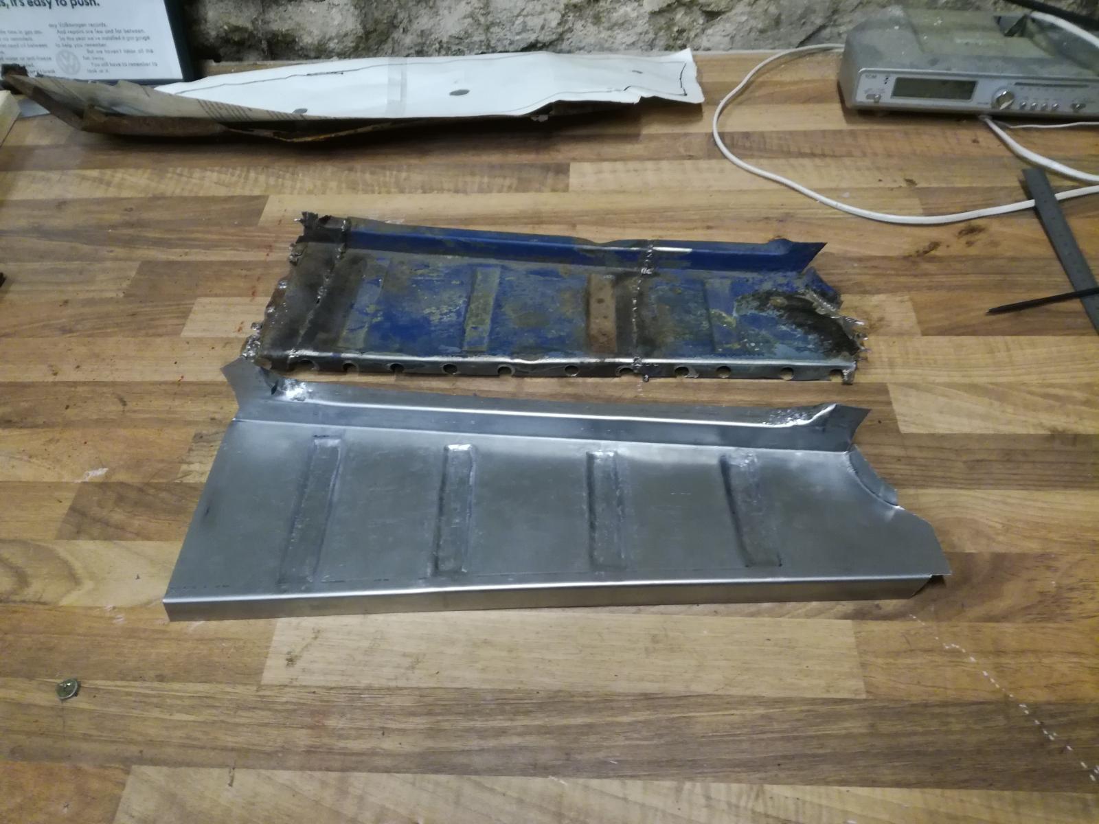

Let's draw it:
A few tests for the beads:

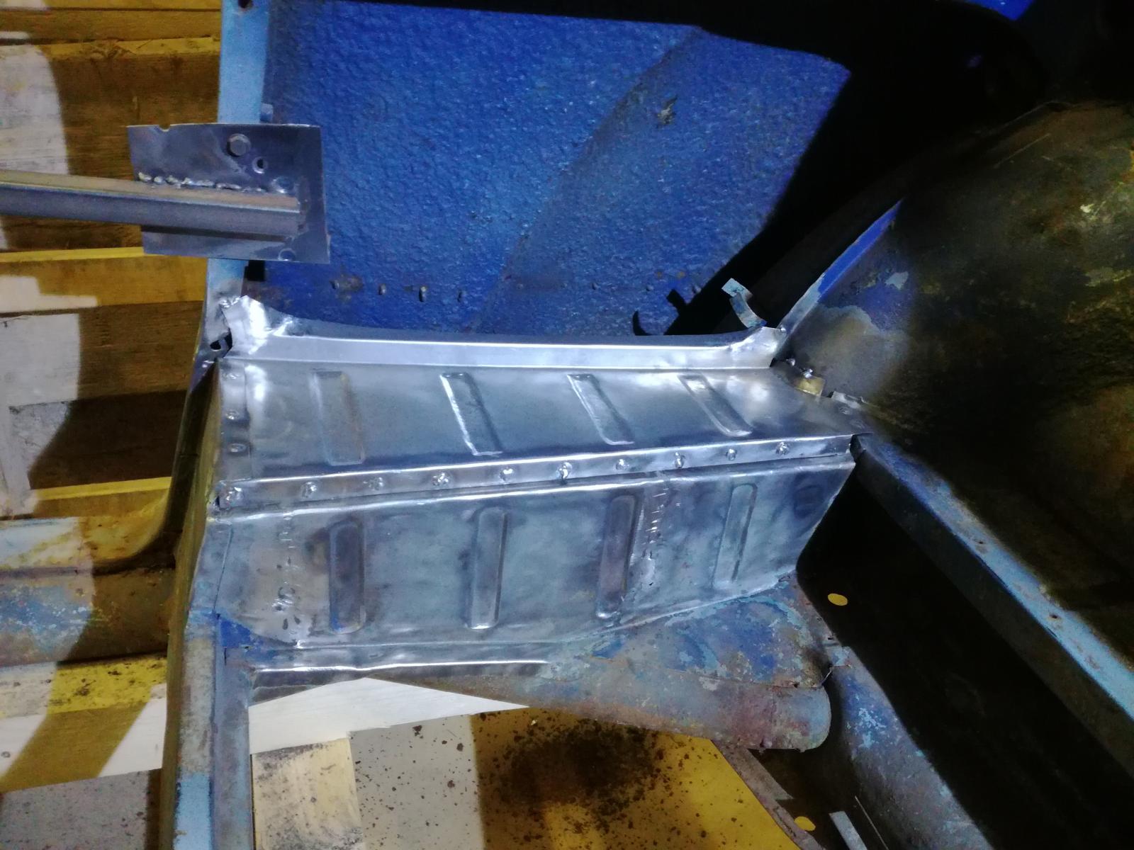

And it was time to start:
Taking shape:
Fitting test:
Of course I repaired also the front part:
And it was time to weld all back together:
And in primer:
Stay tuned

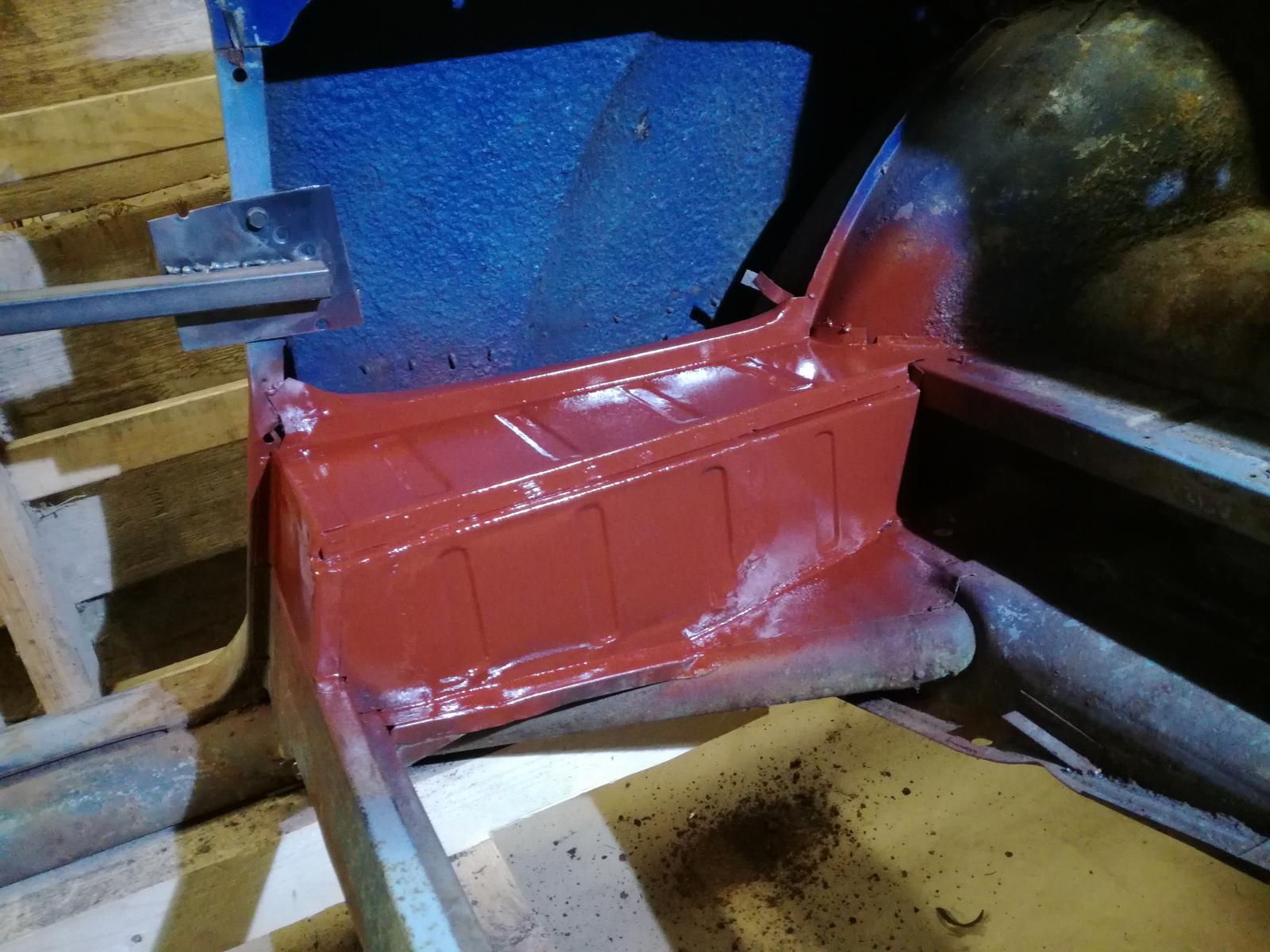

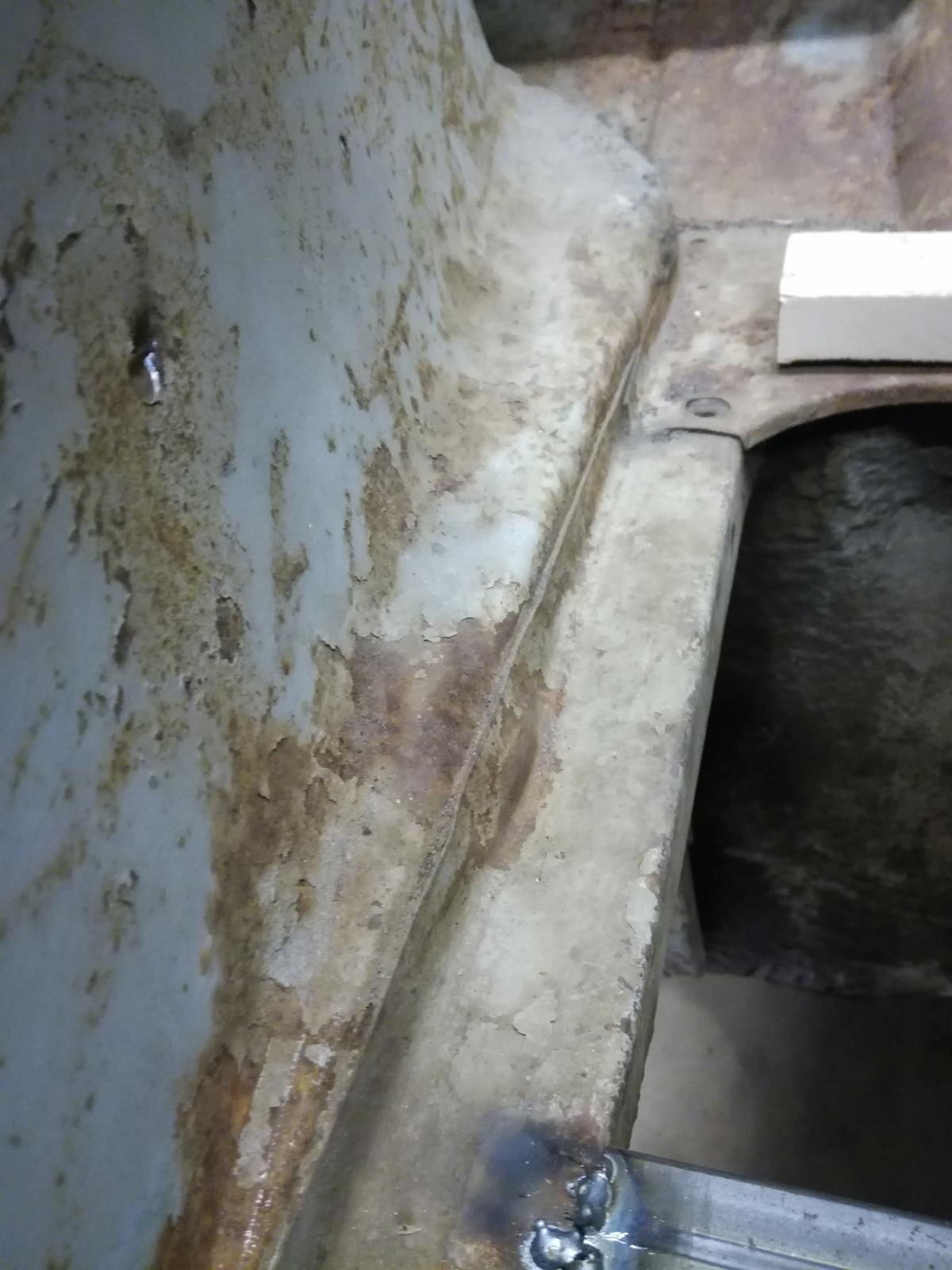

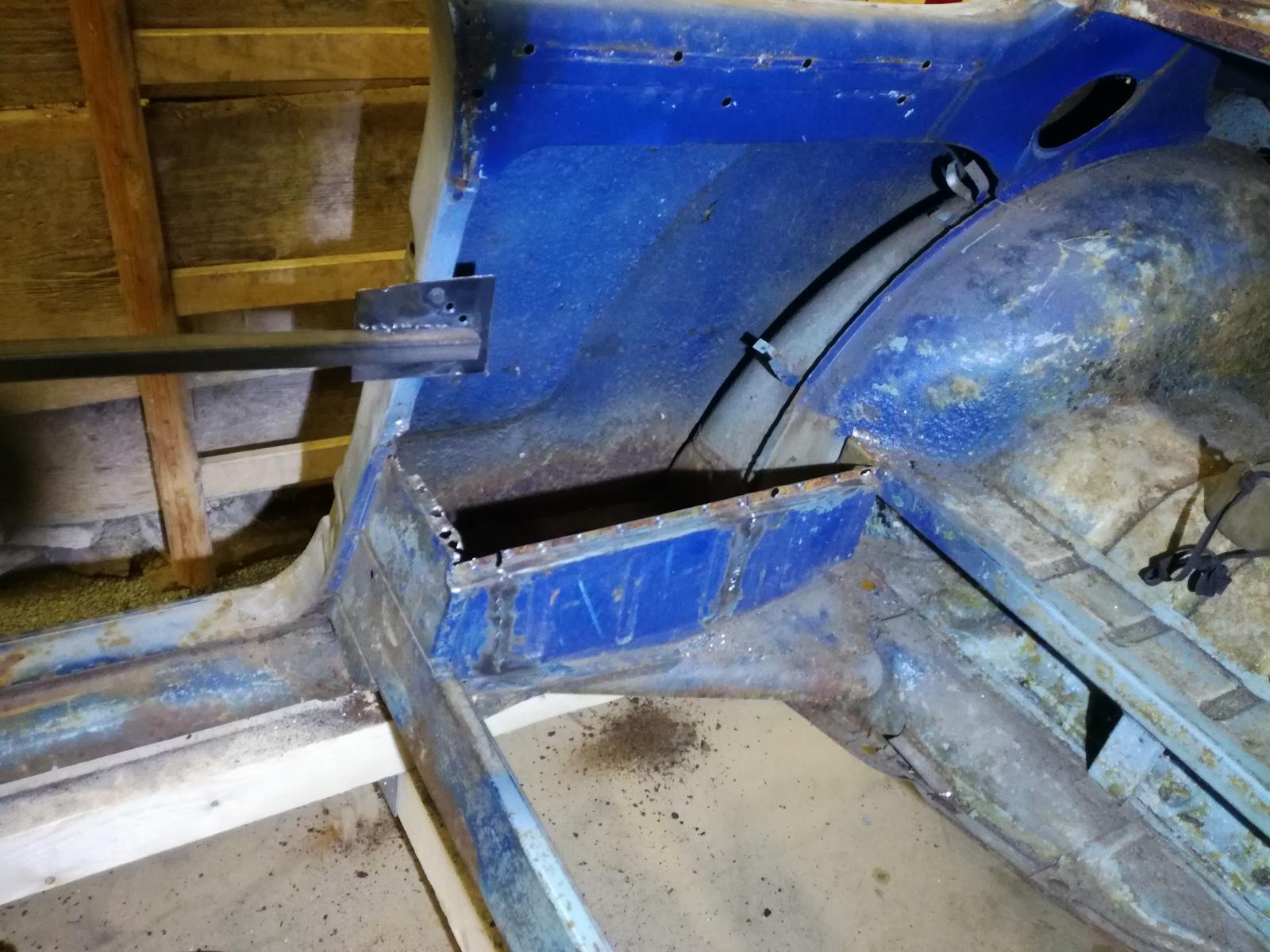

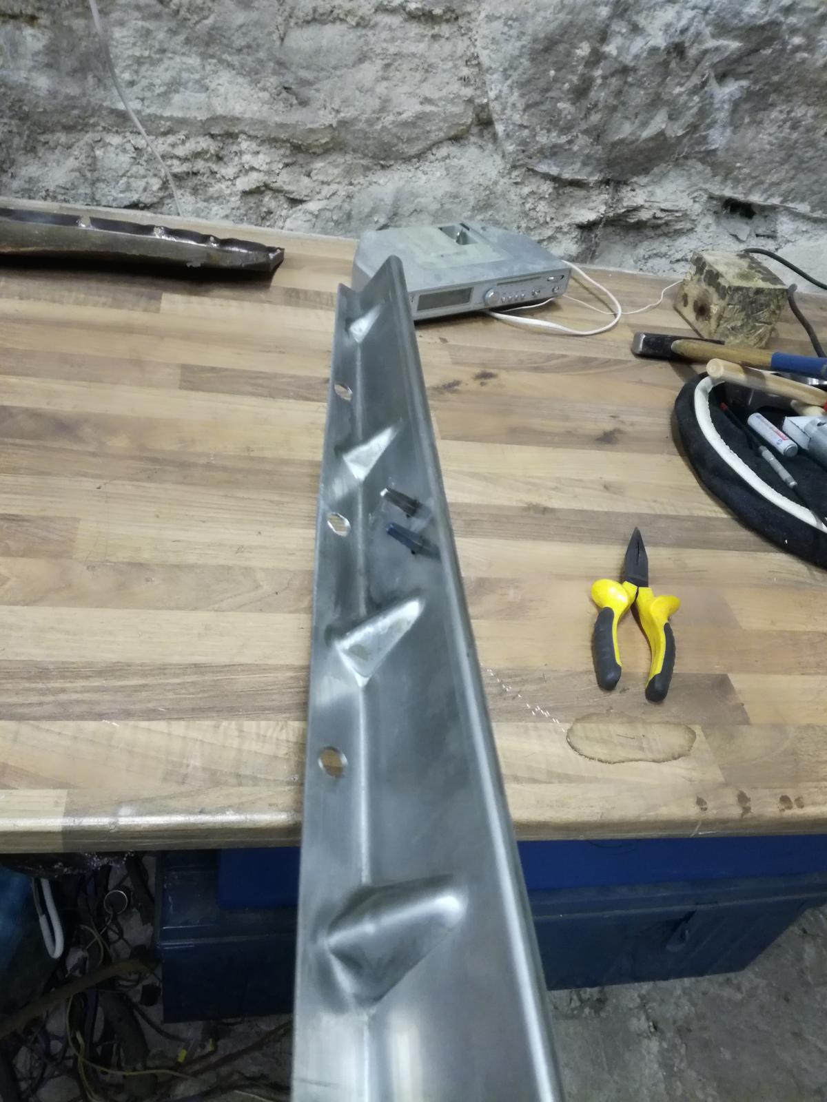

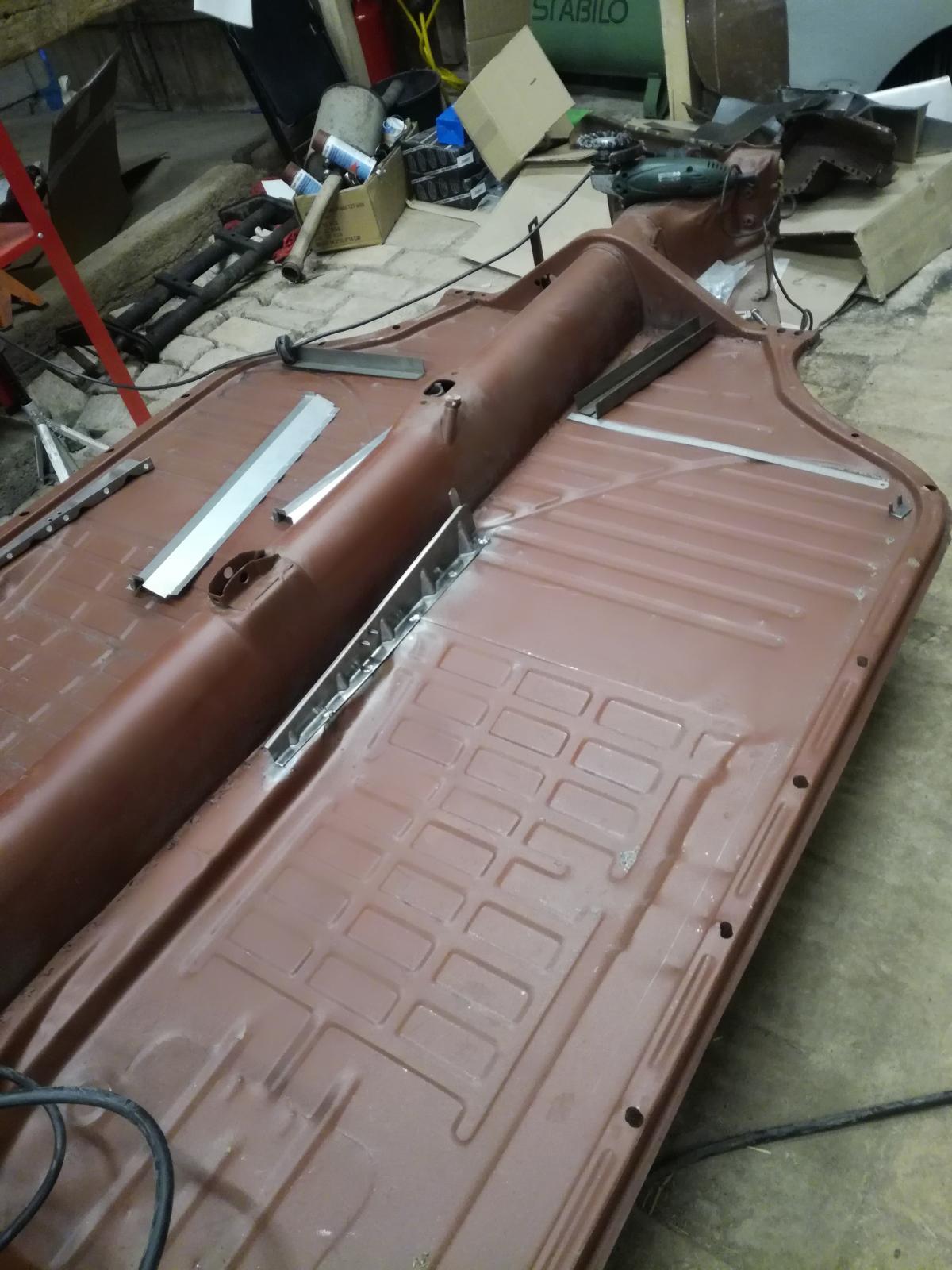

Let' start with one more step on the pan: the passenger side now can have a seat
First step was taking care of the seat position adjuster:
Positioned:
Welding phase:

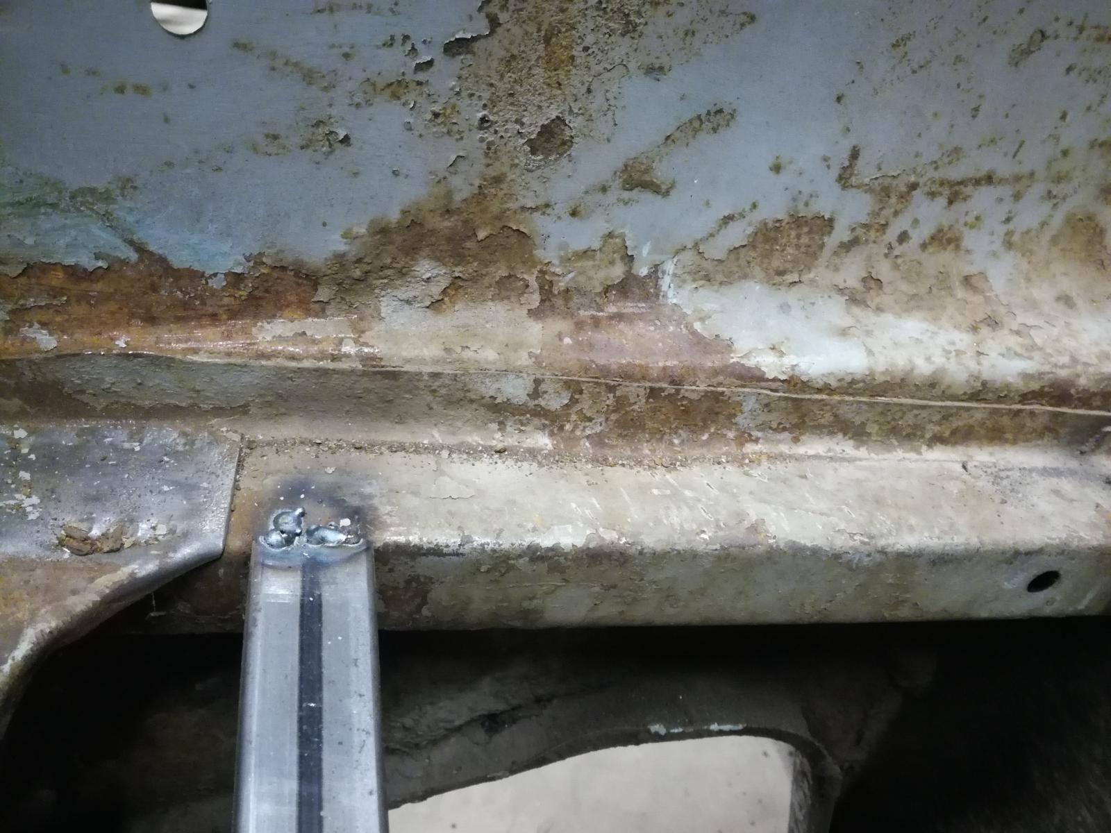

Then it was time to weld the rail on the pan:
Then adjusting the second rail using the seat:
Welding:
Checking.. it fits
Now in primer:
