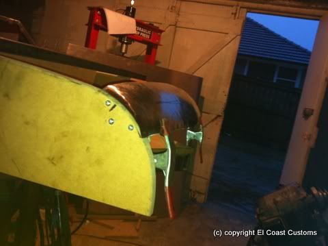

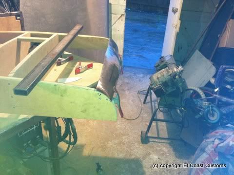

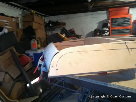

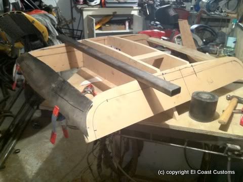

Hi, I love the process of metal shaping. I've mainly just repaired cars, but the last few years I have gotten into motorcycle part fabrication. Left my management job a few months ago to go full time welding/fabricating custom motorcycle parts. I've attached a couple photos of my current project, which is a 304 1.2mm stainless steel dune buggy hardtop. The design brief from the customer was 'SEXY', so hopefully I'll deliver on that for him. It's be all hammer formed...and maybe even hand hammer finished as I may not get access to an english wheel. I look forward to seeing what everyone else is up too.

Thats a seriously nice part! I love seeing parts formed over wood.
Good luck with it and welcome to the forum!

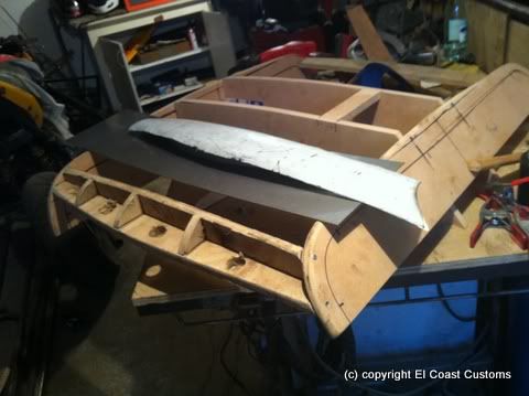

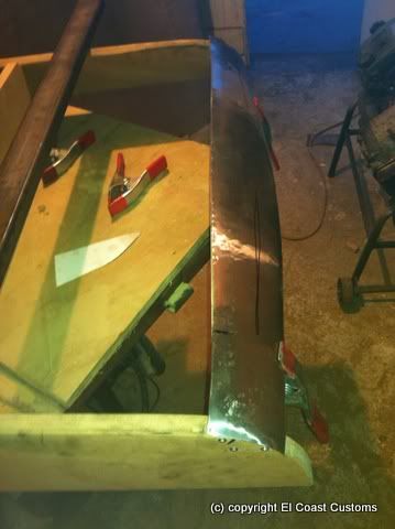

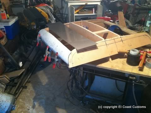

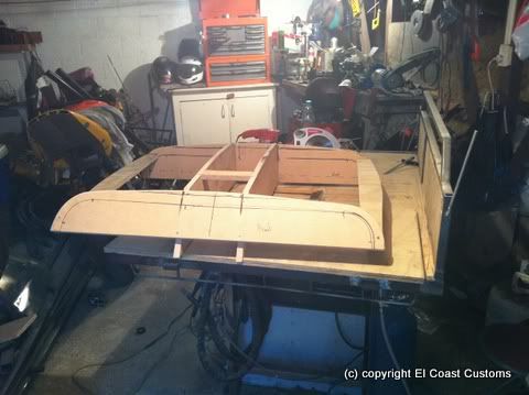

I'm using the wood buck as a reference as the buggy I'm making it for is out of the country in Tonga...I have access to other buggies but they are an hours drive away. I saw Ron Covell do it on one of his Videos..and it worked for me on other projects...seems to be a good way to make your card board templates, if it's something totally orginal, if nothing else.

The actual piece will be more shapely as you can see by the progress so far.
My biggest concern is the stainless doesn't buckle up beyond repair when I weld it up.
